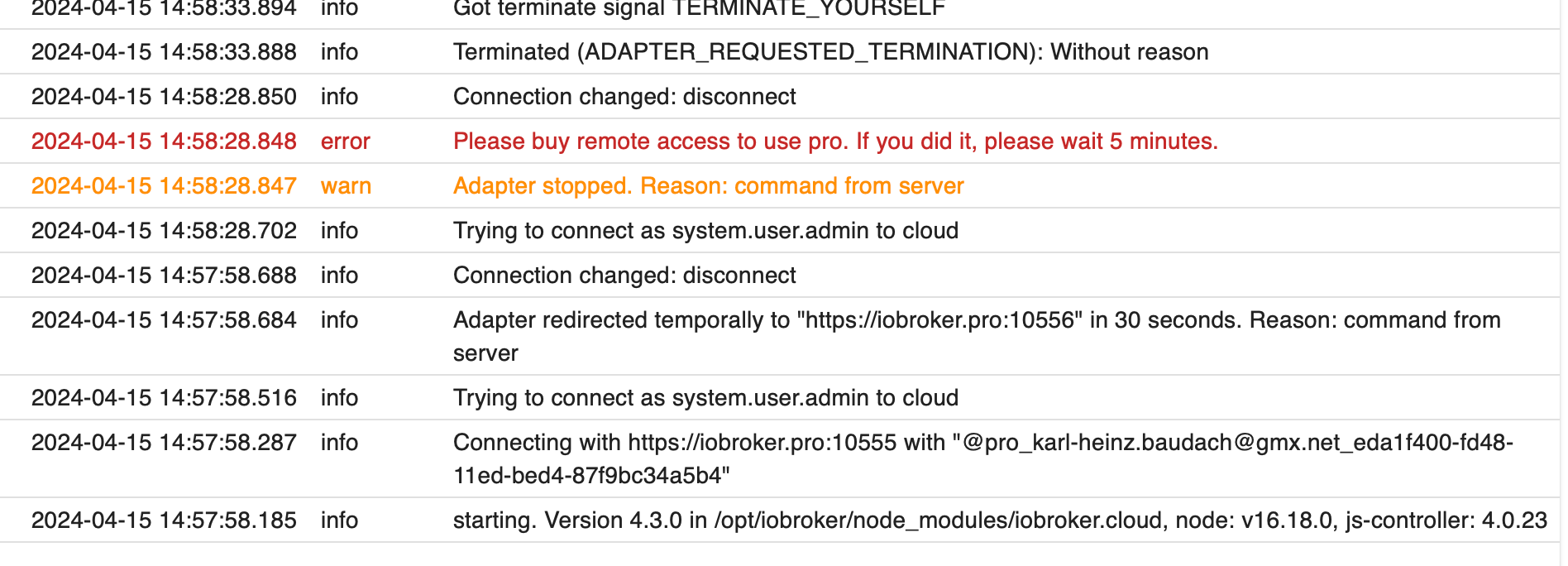

        Das hier:
          Thomas Braun Most Active @Karl-Heinz1 last edited by
          @karl-heinz1
          In Textform in CodeTags eingebettet, nicht als buntes Bildchen.

            ![Bildschirmfoto 2024-04-15 um 14.58.37.png](/assets/uploads/files/1713198319968-bildschirmfoto-2024-04-15-um-14.58.37.png) code_text

                  @djmarc75
                  code_	2024-04-15 20:03:41.558	info	Got terminate signal TERMINATE_YOURSELF
                  cloud.0
                  2024-04-15 20:03:41.555	info	Terminated (ADAPTER_REQUESTED_TERMINATION): Without reason
                  cloud.0
                  2024-04-15 20:03:36.527	info	Connection changed: disconnect
                  cloud.0
                  2024-04-15 20:03:36.525	error	Please buy remote access to use pro. If you did it, please wait 5 minutes.
                  cloud.0
                  2024-04-15 20:03:36.524	warn	Adapter stopped. Reason: command from server
                  cloud.0
                  2024-04-15 20:03:36.205	info	Trying to connect as system.user.admin to cloud
                  cloud.0
                  2024-04-15 20:03:06.190	info	Connection changed: disconnect
                  cloud.0
                  2024-04-15 20:03:06.186	info	Adapter redirected temporally to "https://iobroker.pro:10556" in 30 seconds. Reason: command from server
                  cloud.0
                  2024-04-15 20:03:06.028	info	Trying to connect as system.user.admin to cloud
                  cloud.0
                  cloud.0
                  2024-04-15 20:03:05.818	info	Connecting with https://iobroker.pro:10555 with "@pro_karl-heinz.baudach@gmx.net_eda1f400-fd48-11ed-bed4-87f9bc34a5b4"
                  cloud.0
                  2024-04-15 20:03:05.739	info	starting. Version 4.3.0 in /opt/iobroker/node_modules/iobroker.cloud, node: v16.18.0, js-controller: 4.0.23
                  text
                    Thomas Braun Most Active @Karl-Heinz1 last edited by Thomas Braun
                    @karl-heinz1 sagte in Kein Zugriff auf Admin von iobroker mit Pro:
                    Beides veraltet, beides updaten.
                    Den Rest vom Fest dann auch gleich. Da ist erfahrungsgemäß dann auch Update-Stau.
