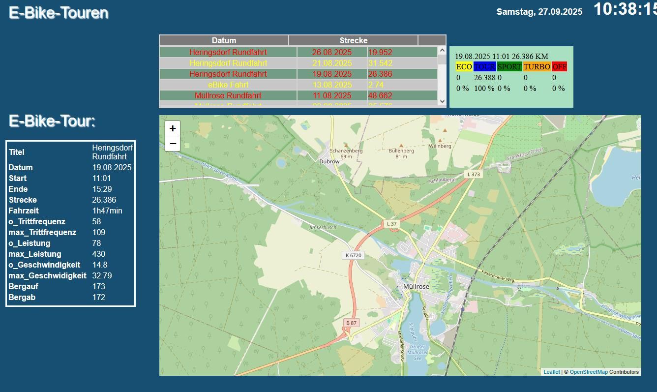

                              Das ist das Bild und die html für die Route, wo der Mittelpunkt nicht mit dem in der Datei eingetragenem übereinstimmt.
                              <!DOCTYPE html>
                              <html>
                              <head>
                              <title>Simple Leaflet Map</title>
                              <meta charset="utf-8" />
                              <link rel="stylesheet" href="https://unpkg.com/leaflet@1.6.0/dist/leaflet.css"integrity="sha512-xwE/Az9zrjBIphAcBb3F6JVqxf46+CDLwfLMHloNu6KEQCAWi6HcDUbeOfBIptF7tcCzusKFjFw2yuvEpDL9wQ=="crossorigin=""/></head>
                              <body>
                              <div id="map" style="width: 980px; height: 530px"></div>
                              <script src="https://unpkg.com/leaflet@1.6.0/dist/leaflet.js"integrity="sha512-gZwIG9x3wUXg2hdXF6+rVkLF/0Vi9U8D2Ntg4Ga5I5BZpVkVxlJWbSQtXPSiUTtC0TjtGOmxa1AJPuV0CPthew=="crossorigin=""></script>
                              <script>
                              var map = L.map('map').setView([53.94125,14.19014], 13);
                              mapLink = '<a href="http://openstreetmap.org">OpenStreetMap</a>';
                              L.tileLayer( 'http://{s}.tile.openstreetmap.org/{z}/{x}/{y}.png', {attribution: '&copy; ' + mapLink + ' Contributors', maxZoom: 18,}).addTo(map);
                              var polyline = L.polyline([
                              [53.94125, 14.19014],[53.9413, 14.19045],[53.94141, 14.18996],[53.94177, 14.1901],[53.94191, 14.19043],[53.94171, 14.1909],[53.94149, 14.19132],[53.94124, 14.19177],[53.94099, 14.19223],[53.94076, 14.19271],[53.94054, 14.19311],[53.94033, 14.19355],[53.9401, 14.194],[53.93983, 14.19445],[53.9396, 14.19491],[53.9394, 14.19538],[53.93914, 14.19582],[53.9389, 14.19627],[53.93869, 14.19669],[53.9385, 14.19715],[53.9383, 14.19767],[53.93809, 14.19818],[53.93792, 14.19858],[53.9377, 14.19911],[53.93754, 14.19949],[53.93731, 14.20002],[53.93706, 14.20057],[53.9369, 14.20097],[53.93671, 14.20141],[53.93648, 14.20196],[53.93629, 14.20239],[53.93604, 14.20295],[53.93586, 14.20335],[53.93567, 14.20376],[53.93541, 14.20428],[53.9352, 14.20478],[53.93502, 14.20518],[53.93483, 14.20557],[53.93459, 14.20611],[53.93435, 14.20663],[53.93417, 14.20704],[53.93397, 14.20744],[53.93377, 14.20797],[53.93356, 14.2084],[53.93332, 14.20893],[53.93315, 14.20936],[53.93293, 14.20983],[53.9327, 14.21035],[53.93254, 14.21078],[53.93232, 14.21134],[53.93218, 14.21171],[53.93196, 14.21228],[53.93182, 14.21267],[53.93155, 14.21329],[53.93134, 14.21377],[53.93115, 14.21422],[53.93092, 14.21479],[53.9307, 14.21526],[53.93052, 14.21578],[53.93035, 14.21625],[53.93018, 14.21669],[53.93, 14.21714],[53.92977, 14.2177],[53.92961, 14.2181],[53.92937, 14.21864],[53.9292, 14.2191],[53.929, 14.21962],[53.92881, 14.22015],[53.9286, 14.22066],[53.92841, 14.22118],[53.92825, 14.22151],[53.92807, 14.22202],[53.92788, 14.2225],[53.92764, 14.22317],[53.92752, 14.2235],[53.92736, 14.22401],[53.92709, 14.2246],[53.92688, 14.22515],[53.92669, 14.22553],[53.92648, 14.22598],[53.92638, 14.22651],[53.92621, 14.22715],[53.92605, 14.22765],[53.9259, 14.22814],[53.92573, 14.22869],[53.92556, 14.22915],[53.9253, 14.22952],[53.92517, 14.22997],[53.92505, 14.23042],[53.92492, 14.23088],[53.92472, 14.23155],[53.92456, 14.23205],[53.92439, 14.23251],[53.92427, 14.23296],[53.92408, 14.23352],[53.92394, 14.23399],[53.92376, 14.23451],[53.92358, 14.23514],[53.92341, 14.2356],[53.92321, 14.2362],[53.92312, 14.23661],[53.92295, 14.23724],[53.9228, 14.23769],[53.92266, 14.23818],[53.92248, 14.23873],[53.92232, 14.23921],[53.92216, 14.23975],[53.92198, 14.24034],[53.92183, 14.24087],[53.92168, 14.24136],[53.92154, 14.24191],[53.92136, 14.24247],[53.92121, 14.24301],[53.92107, 14.24356],[53.92098, 14.24407],[53.92088, 14.24465],[53.92078, 14.2452],[53.92068, 14.24579],[53.92059, 14.24635],[53.92049, 14.24689],[53.92036, 14.24754],[53.92026, 14.24808],[53.92017, 14.24857],[53.92023, 14.24903],[53.92027, 14.24954],[53.92018, 14.25011],[53.92011, 14.25066],[53.91999, 14.25118],[53.91993, 14.25182],[53.91981, 14.25242],[53.91973, 14.25302],[53.91964, 14.25319],[53.91961, 14.25343],[53.91972, 14.25293],[53.9198, 14.25227],[53.9199, 14.25167],[53.91998, 14.25109],[53.92012, 14.25052],[53.92023, 14.24992],[53.9203, 14.24936],[53.9204, 14.24878],[53.92051, 14.24819],[53.9206, 14.24758],[53.9207, 14.24705],[53.92073, 14.24649],[53.92059, 14.24612],[53.92071, 14.24548],[53.92081, 14.24498],[53.92091, 14.24444],[53.92101, 14.24381],[53.92112, 14.24332],[53.92126, 14.24274],[53.92142, 14.24224],[53.92157, 14.24169],[53.92174, 14.24113],[53.92188, 14.24065],[53.92205, 14.24007],[53.92217, 14.23963],[53.92234, 14.23905],[53.92249, 14.23857],[53.92265, 14.23799],[53.92278, 14.2375],[53.92294, 14.23696],[53.92313, 14.23641],[53.92329, 14.23587],[53.92339, 14.23548],[53.92358, 14.23489],[53.92378, 14.23433],[53.92392, 14.23389],[53.9241, 14.23333],[53.92427, 14.23277],[53.92441, 14.23236],[53.92459, 14.23181],[53.92477, 14.23126],[53.92492, 14.23073],[53.9251, 14.23017],[53.92518, 14.22961],[53.92544, 14.22941],[53.92561, 14.22892],[53.92575, 14.22843],[53.92591, 14.2279],[53.92603, 14.22753],[53.92626, 14.22684],[53.92637, 14.22635],[53.92651, 14.22589],[53.92677, 14.22538],[53.927, 14.22481],[53.92715, 14.22435],[53.9273, 14.22394],[53.92751, 14.22337],[53.92767, 14.22289],[53.92783, 14.22241],[53.928, 14.22202],[53.92817, 14.22151],[53.92839, 14.22093],[53.92862, 14.22037],[53.92876, 14.21998],[53.92896, 14.21947],[53.92912, 14.21907],[53.9293, 14.21854],[53.9295, 14.21799],[53.92971, 14.21753],[53.9299, 14.21704],[53.93011, 14.21652],[53.9303, 14.21604],[53.93052, 14.21552],[53.93071, 14.21505],[53.93092, 14.21453],[53.93108, 14.21412],[53.93132, 14.21359],[53.9315, 14.21321],[53.93169, 14.21267],[53.9319, 14.2122],[53.9321, 14.2117],[53.9323, 14.2112],[53.93251, 14.21068],[53.9327, 14.21025],[53.93291, 14.20976],[53.93313, 14.20925],[53.93332, 14.2088],[53.93354, 14.20828],[53.93376, 14.20783],[53.93396, 14.20735],[53.93418, 14.20688],[53.93439, 14.2064],[53.93457, 14.20598],[53.9348, 14.20549],[53.93503, 14.205],[53.93525, 14.20452],[53.93548, 14.20405],[53.93572, 14.20353],[53.93596, 14.20307],[53.93611, 14.20271],[53.93637, 14.20212],[53.93655, 14.20175],[53.93677, 14.20127],[53.93697, 14.20072],[53.93719, 14.20023],[53.93734, 14.19987],[53.93757, 14.19936],[53.9378, 14.19879],[53.93798, 14.19837],[53.93818, 14.19789],[53.93835, 14.19747],[53.93857, 14.19694],[53.93879, 14.19647],[53.93903, 14.19598],[53.93923, 14.19559],[53.93949, 14.1951],[53.93969, 14.19469],[53.9399, 14.19431],[53.94016, 14.1938],[53.94042, 14.19332],[53.94061, 14.19293],[53.94086, 14.19244],[53.94107, 14.19204],[53.94133, 14.19151],[53.94153, 14.19112],[53.94175, 14.19066],[53.942, 14.1902],[53.94221, 14.1898],[53.94244, 14.18937],[53.94269, 14.18889],[53.9429, 14.18847],[53.94315, 14.18811],[53.94341, 14.18779],[53.9437, 14.1873],[53.94393, 14.1869],[53.94417, 14.18647],[53.94442, 14.18604],[53.94461, 14.18571],[53.94485, 14.18527],[53.9451, 14.18484],[53.94534, 14.18443],[53.94558, 14.18402],[53.94583, 14.1836],[53.94613, 14.18307],[53.94635, 14.18264],[53.94662, 14.1823],[53.94687, 14.18187],[53.94707, 14.18154],[53.94733, 14.18109],[53.94758, 14.18066],[53.9478, 14.18032],[53.94806, 14.17987],[53.94833, 14.17943],[53.9486, 14.17898],[53.94881, 14.17864],[53.94909, 14.17818],[53.94933, 14.17782],[53.9496, 14.17736],[53.94981, 14.17702],[53.95008, 14.17661],[53.95036, 14.17626],[53.95065, 14.17584],[53.95092, 14.17542],[53.95113, 14.17513],[53.95142, 14.17474],[53.95169, 14.17437],[53.95195, 14.17399],[53.95224, 14.17356],[53.95243, 14.17328],[53.95271, 14.17286],[53.95296, 14.17249],[53.95328, 14.1721],[53.95358, 14.1719],[53.95394, 14.17151],[53.95426, 14.17127],[53.95448, 14.17158],[53.95475, 14.1719],[53.95512, 14.17175],[53.95538, 14.17145],[53.95565, 14.17115],[53.95585, 14.17067],[53.95612, 14.1702],[53.95637, 14.16991],[53.9567, 14.16956],[53.95697, 14.16937],[53.95716, 14.1689],[53.95731, 14.16849],[53.95766, 14.16808],[53.95794, 14.16774],[53.9582, 14.16736],[53.95846, 14.167],[53.95866, 14.16657],[53.95889, 14.16606],[53.95912, 14.16564],[53.9593, 14.16513],[53.9595, 14.1648],[53.95977, 14.16438],[53.96006, 14.16394],[53.96026, 14.16361],[53.96056, 14.16316],[53.96077, 14.16281],[53.96105, 14.16234],[53.96125, 14.16203],[53.96153, 14.1616],[53.96183, 14.16114],[53.96195, 14.1606],[53.96213, 14.16012],[53.96242, 14.1597],[53.96261, 14.15939],[53.96291, 14.15895],[53.96316, 14.15856],[53.96343, 14.15816],[53.9637, 14.15775],[53.96396, 14.15735],[53.96422, 14.15697],[53.96451, 14.15653],[53.96477, 14.15614],[53.96498, 14.15584],[53.96525, 14.15543],[53.96553, 14.15502],[53.96582, 14.15458],[53.96605, 14.15424],[53.96628, 14.15391],[53.96655, 14.15341],[53.96675, 14.15303],[53.96702, 14.15255],[53.96726, 14.15208],[53.96745, 14.15175],[53.96781, 14.15127],[53.96807, 14.15099],[53.9683, 14.15071],[53.96863, 14.15035],[53.96894, 14.15],[53.96915, 14.1497],[53.96946, 14.14931],[53.96977, 14.14892],[53.97, 14.14862],[53.9703, 14.14823],[53.9706, 14.14784],[53.97083, 14.14754],[53.97113, 14.14714],[53.97143, 14.14674],[53.97168, 14.14641],[53.97195, 14.14607],[53.97201, 14.14598],[53.97206, 14.14589],[53.97175, 14.14631],[53.97149, 14.14663],[53.97116, 14.14705],[53.97094, 14.14734],[53.97066, 14.14772],[53.97041, 14.14804],[53.97009, 14.14849],[53.96986, 14.14879],[53.9696, 14.14913],[53.96934, 14.14946],[53.969, 14.14989],[53.96874, 14.15021],[53.96839, 14.1506],[53.96819, 14.15082],[53.96788, 14.15117],[53.96759, 14.15154],[53.96729, 14.152],[53.96711, 14.15236],[53.96687, 14.15281],[53.96661, 14.1533],[53.96639, 14.15369],[53.96613, 14.15413],[53.96588, 14.15449],[53.96564, 14.15483],[53.96532, 14.15529],[53.9651, 14.15566],[53.96488, 14.15599],[53.96461, 14.1564],[53.96434, 14.15679],[53.96408, 14.15718],[53.96381, 14.15759],[53.96354, 14.158],[53.96327, 14.1584],[53.96301, 14.15882],[53.96275, 14.1592],[53.9625, 14.15958],[53.96224, 14.15996],[53.962, 14.16041],[53.96189, 14.16098],[53.96167, 14.16141],[53.96141, 14.16181],[53.96115, 14.16226],[53.96093, 14.1626],[53.96064, 14.16304],[53.96037, 14.16347],[53.96016, 14.1638],[53.95988, 14.16426],[53.95966, 14.1646],[53.95937, 14.16503],[53.95918, 14.16553],[53.95903, 14.16597],[53.95872, 14.16632],[53.95855, 14.16685],[53.9583, 14.16721],[53.958, 14.16761],[53.95771, 14.16799],[53.95748, 14.16827],[53.95721, 14.16867],[53.95709, 14.16921],[53.95679, 14.1695],[53.95649, 14.16979],[53.9564, 14.16985],[53.95595, 14.17047],[53.95581, 14.17098],[53.95552, 14.17135],[53.95523, 14.17172],[53.95491, 14.17191],[53.95459, 14.17173],[53.95435, 14.17128],[53.95411, 14.17137],[53.95374, 14.17177],[53.95352, 14.17196],[53.95319, 14.17232],[53.95297, 14.17257],[53.95267, 14.17298],[53.95238, 14.17341],[53.95215, 14.17373],[53.95185, 14.17418],[53.95163, 14.17451],[53.95131, 14.17492],[53.95108, 14.17522],[53.95076, 14.17567],[53.95052, 14.17605],[53.95027, 14.17641],[53.95002, 14.17676],[53.9497, 14.17724],[53.94943, 14.17768],[53.94919, 14.17806],[53.94898, 14.17839],[53.94872, 14.17884],[53.94848, 14.17922],[53.94823, 14.17964],[53.94797, 14.18006],[53.94771, 14.18046],[53.94748, 14.18083],[53.9472, 14.1813],[53.94695, 14.18173],[53.94672, 14.18214],[53.94645, 14.18252],[53.94621, 14.18287],[53.94599, 14.18328],[53.94576, 14.18367],[53.94503, 14.18489],[53.94479, 14.1853],[53.94453, 14.18574],[53.94429, 14.18621],[53.94405, 14.18661],[53.94381, 14.18708],[53.94357, 14.18748],[53.94331, 14.1879],[53.94308, 14.18829],[53.94286, 14.18872],[53.94256, 14.18924],[53.94234, 14.1896],[53.94212, 14.19007],[53.9418, 14.19007],[53.94149, 14.18993],[53.94129, 14.19042],[53.94125, 14.19021]
                              ], { color: "blue", weight: 3, opacity: .7, lineJoin: "round" } ).addTo(map);
                              </script>
                              </body>
                              </html>
                              Und das ist das Bild und die html, wo der Mittelpunkt der map mit dem in der html übereinstimmt.
