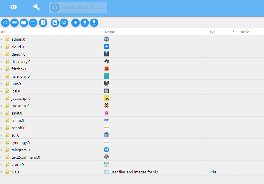

                                      Kueppert last edited by
                                      hab mich auch mal gewagt zu testen (nutze die Version 0.4.1 vom Adapter).
                                      Installieren wollte ich folgendes Plugin: homebridge-mi-aqara-2
                                      Ich nutze folgenden json-Code aktuell (MAC-Adresse und PW gemäß Anleitung gefunden und eingetragen, hier ausge-x-t):
                                      "description": "This is an example configuration file with one fake accessory and one fake platform. You can use this as a template for creating your own configuration file containing devices you actually own.",
                                      "accessories": [
                                      "accessory": "WeMo",
                                      "name": "Coffee Maker"
                                      "platforms": [
                                      "platform": "MiAqaraPlatform",
                                      "gateways": {
                                      "34xxxxxxxxxx": "ecxxxxxxxxxxxxxx"
                                      Ich erhalte folgende Fehlermeldung beim Starten der ham-Instanz:
                                      host.iobrokerNUC	2018-06-23 14:18:54.653	error	instance system.adapter.ham.0 terminated with code 0 (OK)
                                      Caught	2018-06-23 14:18:54.653	error	by controller[2]: at Socket.onpacket (/opt/iobroker/node_modules/socket.io-client/lib/socket.js:244:12)
                                      Caught	2018-06-23 14:18:54.653	error	by controller[2]: at Socket.onack (/opt/iobroker/node_modules/socket.io-client/lib/socket.js:319:9)
                                      Caught	2018-06-23 14:18:54.653	error	by controller[2]: at Socket. <anonymous>(/opt/iobroker/node_modules/iobroker.js-controller/lib/adapter.js:2434:25)
                                      Caught	2018-06-23 14:18:54.653	error	by controller[2]: at adapter.getDevices (/opt/iobroker/node_modules/iobroker.ham/main.js:175:27)
                                      Caught	2018-06-23 14:18:54.653	error	by controller[2]: at loadExistingAccessories (/opt/iobroker/node_modules/iobroker.ham/main.js:228:35)
                                      Caught	2018-06-23 14:18:54.653	error	by controller[2]: at Object.start (/opt/iobroker/node_modules/iobroker.ham/lib/wrapper-handler.js:96:23)
                                      Caught	2018-06-23 14:18:54.653	error	by controller[2]: at HomebridgeWrapper.init (/opt/iobroker/node_modules/iobroker.ham/node_modules/homebridge-plugin-wrapper/index.js:190:17)
                                      Caught	2018-06-23 14:18:54.653	error	by controller[2]: at Server.run (/opt/iobroker/node_modules/iobroker.ham/node_modules/homebridge-plugin-wrapper/homebridge/server.js:86:38)
                                      Caught	2018-06-23 14:18:54.653	error	by controller[2]: at Server._loadAccessories (/opt/iobroker/node_modules/iobroker.ham/node_modules/homebridge-plugin-wrapper/homebridge/server.js:284:42)
                                      Caught	2018-06-23 14:18:54.652	error	by controller[2]: at API.accessory (/opt/iobroker/node_modules/iobroker.ham/node_modules/homebridge-plugin-wrapper/homebridge/api.js:64:13)
                                      Caught	2018-06-23 14:18:54.652	error	by controller[2]: Error: The requested accessory 'WeMo' was not registered by any plugin.
                                      Caught	2018-06-23 14:18:54.652	error	by controller[1]: [2018-6-23 14:18:54] Plugin /opt/iobroker/node_modules/homebridge-plugin-wrapper package.json does not contain the keyword 'homebridge-plugin'.
                                      Caught	2018-06-23 14:18:54.652	error	by controller[0]: [2018-6-23 14:18:54] Plugin /opt/iobroker/node_modules/iobroker.ham/node_modules/homebridge-plugin-wrapper package.json does not contain the keyword 'homebridge-plugin'.
                                      ham.0	2018-06-23 14:18:54.615	warn	Exception: Error: The requested accessory 'WeMo' was not registered by any plugin.
                                      ham.0	2018-06-23 14:18:54.611	info	cleaned everything up...
                                      ham.0	2018-06-23 14:18:54.611	error	at Socket.onpacket (/opt/iobroker/node_modules/socket.io-client/lib/socket.js:244:12)
                                      ham.0	2018-06-23 14:18:54.611	error	at Socket.onack (/opt/iobroker/node_modules/socket.io-client/lib/socket.js:319:9)
                                      ham.0	2018-06-23 14:18:54.611	error	at Socket. <anonymous>(/opt/iobroker/node_modules/iobroker.js-controller/lib/adapter.js:2434:25)
                                      ham.0	2018-06-23 14:18:54.611	error	at adapter.getDevices (/opt/iobroker/node_modules/iobroker.ham/main.js:175:27)
                                      ham.0	2018-06-23 14:18:54.611	error	at loadExistingAccessories (/opt/iobroker/node_modules/iobroker.ham/main.js:228:35)
                                      ham.0	2018-06-23 14:18:54.611	error	at Object.start (/opt/iobroker/node_modules/iobroker.ham/lib/wrapper-handler.js:96:23)
                                      ham.0	2018-06-23 14:18:54.611	error	at HomebridgeWrapper.init (/opt/iobroker/node_modules/iobroker.ham/node_modules/homebridge-plugin-wrapper/index.js:190:17)
                                      ham.0	2018-06-23 14:18:54.611	error	at Server.run (/opt/iobroker/node_modules/iobroker.ham/node_modules/homebridge-plugin-wrapper/homebridge/server.js:86:38)
                                      ham.0	2018-06-23 14:18:54.611	error	at Server._loadAccessories (/opt/iobroker/node_modules/iobroker.ham/node_modules/homebridge-plugin-wrapper/homebridge/server.js:284:42)
                                      ham.0	2018-06-23 14:18:54.611	error	at API.accessory (/opt/iobroker/node_modules/iobroker.ham/node_modules/homebridge-plugin-wrapper/homebridge/api.js:64:13)
                                      ham.0	2018-06-23 14:18:54.611	error	Error: The requested accessory 'WeMo' was not registered by any plugin.
                                      ham.0	2018-06-23 14:18:54.610	error	uncaught exception: The requested accessory 'WeMo' was not registered by any plugin.
                                      ham.0	2018-06-23 14:18:53.503	info	starting. Version 0.4.1 in /opt/iobroker/node_modules/iobroker.ham, node: v6.14.2
                                      host.iobrokerNUC	2018-06-23 14:18:52.924	info	instance system.adapter.ham.0 started with pid 1019</anonymous></anonymous>
                                      Schon jmd versucht, das plugin ans Laufen zu bekommen oder einer einen Tip, was ich noch versuchen kann?
                                      Danke und Grüße, Thorsten
                                      PS: Hab vorher nen Snapshot in proxmox gemacht 😉
                                      • apollon77
                                        apollon77 last edited by
                                        Fehler sagt das Wemo von keinem Plugin registriert ist. Wenn du Wemo nicht willst dann raus damit. Das war ggf vom Beispiel vorab noch drin? 😉
                                        Gesendet vom Handy …
                                          Ach,
                                          jau, das war es. Jetzt habe ich nach dem Laden (hab mal nachträglich auf debug gestellt) festgestellt, dass ein gelöschter Adapter trotzdem nachwievor geladen wird…der devolo-Adapter...

                                          Und dann noch eine Frage: wo sollten denn die Objekte jetzt auftauchen? Entweder ich bin blind - oder da sind keine?
                                           ![2700_ham_3.png](/assets/uploads/files/2700_ham_3.png)

                                          • apollon77
                                            Ja wenn du homebridge Plugins installierst bleiben die da und homebridge findet sie. Ist aber nicht schlimm.
                                            Wegbekommen: im Verzeichnis /opt/iobroker/node_modules/iobroker.ham
                                            Ein
                                            npm uninstall homebridge-Name
                                            Machen.
                                            Die datenpunkte sollten intern ham.0 auftauchen. Mal Seite bzw Objekte neu geladen? Sagt das log irgendwas?
