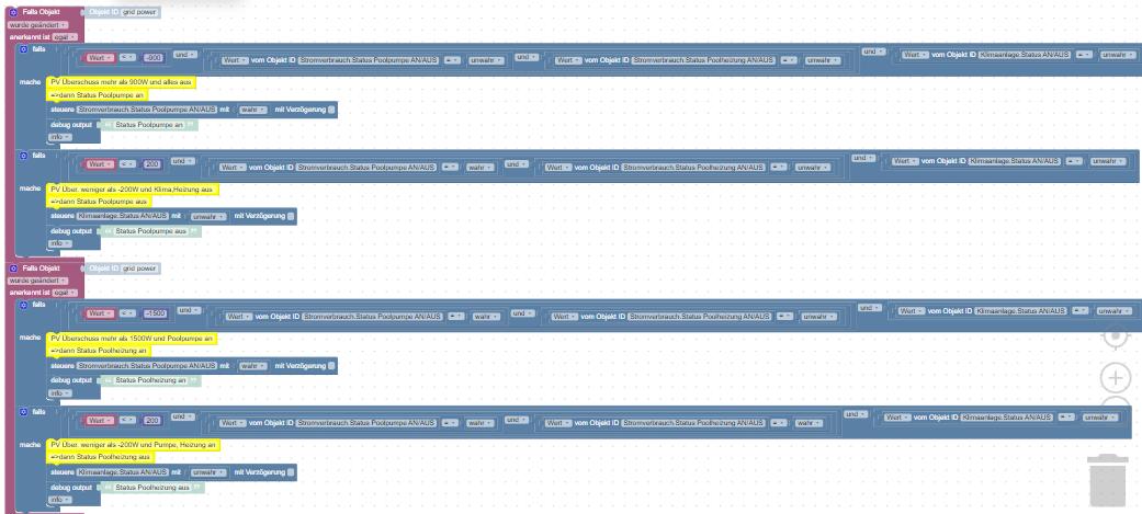

            Hallo
            Ich bin wieder mal etwas am Basteln an einem Blockly….
            Ich möchte eine Abfolge für div Verbraucher machen.
            Das Skript soll folgendes Machen:
            <xml xmlns="http://www.w3.org/1999/xhtml"><block type="create" id="PVt6pm:+m_wO=)Tc*Bm9" x="-587" y="-662"><field name="NAME">Stromverbrauch.Status Poolpumpe AN/AUS</field>
            <statement name="STATEMENT"><block type="create" id="L/0?.~*D|]ZY|y{,^{*"><field name="NAME">Stromverbrauch.Status Poolheizung AN/AUS</field> <statement name="STATEMENT"><block type="create" id="A-in8I}1!v%W9J^B9MW"><field name="NAME">Klimaanlage.Status AN/AUS</field></block></statement></block></statement></block>
            <block type="on_ext" id=";NsZa6!BDd(j|8G^mhTk" x="-1038" y="-412"><mutation items="1"></mutation>
            <value name="OID0"><shadow type="field_oid" id="6Q6L]X-88[xorxW{AGDA"><field name="oid">fronius.0.powerflow.P_Grid</field></shadow></value>
            <statement name="STATEMENT"><block type="controls_if" id="MMbzawMTkcs0r_@9{37W"><value name="IF0"><block type="logic_operation" id="0FNg3F#!4~GAFt[(njh?"><field name="OP">AND</field>
                    <value name="A"><block type="logic_operation" id="-~/im_D;y?S2Zb#9-`M+"><field name="OP">AND</field>
                        <value name="A"><block type="logic_compare" id="gQ2l%)TKD7]nq|9t^wZ@"><field name="OP">LT</field>
                            <value name="A"><block type="on_source" id="[qo:--8I4IKt/p`o/e4["><field name="ATTR">state.val</field></block></value>
                            <value name="B"><block type="math_number" id=";C3@s41A`y:`C2V[T:w["><field name="NUM">-900</field></block></value></block></value>
                        <value name="B"><block type="logic_operation" id="Ynrsh4sT{,TzJ*hQDEEp"><field name="OP">AND</field>
                            <value name="A"><block type="logic_compare" id="rb6M_u(P{+,=5|ozWkq8"><field name="OP">EQ</field>
                                <value name="A"><block type="get_value" id="MfHb2jqBoa272r]Z39tO"><field name="ATTR">val</field>
                                    <field name="OID">javascript.0.Stromverbrauch.Status Poolpumpe AN/AUS</field></block></value>
                                <value name="B"><block type="logic_boolean" id="TYKJF]3y],e7qQ^xF7=v"><field name="BOOL">FALSE</field></block></value></block></value>
                            <value name="B"><block type="logic_compare" id="*yef?1tG/e?xv2pln,/u"><field name="OP">EQ</field>
                                <value name="A"><block type="get_value" id="23LbfLMVQ%=Q9SR)KEzu"><field name="ATTR">val</field>
                                    <field name="OID">javascript.0.Stromverbrauch.Status Poolheizung AN/AUS</field></block></value>
                                <value name="B"><block type="logic_boolean" id="Y0x*~d=xEWiDj,jM:Q7A"><field name="BOOL">FALSE</field></block></value></block></value></block></value></block></value>
                    <value name="B"><block type="logic_compare" id="v~WSbyI58+._U?ZUsQ5X"><field name="OP">EQ</field>
                        <value name="A"><block type="get_value" id="`GJ2d4[.#j^kvB]bXS:["><field name="ATTR">val</field>
                            <field name="OID">javascript.0.Klimaanlage.Status AN/AUS</field></block></value>
                        <value name="B"><block type="logic_boolean" id="YDeGS2[A?TIvgj{2Vt-K"><field name="BOOL">FALSE</field></block></value></block></value></block></value>
                <statement name="DO0"><block type="comment" id="1eTOc8:6G60dIjFu8vs)"><field name="COMMENT">PV Überschuss mehr als 900W und alles aus</field>
                    <next><block type="comment" id="gmjh%CuC,vlQ5@_!Gc1^"><field name="COMMENT">=>dann Status Poolpumpe an</field>
                        <next><block type="control" id="ot8#BU)XiCxK6?lk+Gc_"><mutation delay_input="false"></mutation>
                            <value name="VALUE"><block type="logic_boolean" id="W{{4H%bg)wz?Z,naG`e4"><field name="BOOL">TRUE</field></block></value>
                            <next><block type="debug" id="fsOcS2]S{DbPdn|OJ=8u"><field name="Severity">log</field>
                                <value name="TEXT"><shadow type="text" id="4M-mC8Kw=f?woVC_t)6O"><field name="TEXT">Status Poolpumpe an</field></shadow></value></block></next></block></next></block></next></block></statement>
                <next><block type="controls_if" id="u/qU4Z!fU+*p*v3#?K8;"><value name="IF0"><block type="logic_operation" id="w_q*U=F2wJD=*N_Qj`ap"><field name="OP">AND</field>
                        <value name="A"><block type="logic_operation" id="%:FRu(Dl]qHRW6V_o1BE"><field name="OP">AND</field>
                            <value name="A"><block type="logic_compare" id="uOt6z3%.,rgbypD!0y.q"><field name="OP">LT</field>
                                <value name="A"><block type="on_source" id="y)I#yCy)P0n2!80:!%J7"><field name="ATTR">state.val</field></block></value>
                                <value name="B"><block type="math_number" id="m8eqB8rDAdQ+vFmbIqtt"><field name="NUM">200</field></block></value></block></value>
                            <value name="B"><block type="logic_operation" id="c[sF[yrbZXQQZO[E6l,r"><field name="OP">AND</field>
                                <value name="A"><block type="logic_compare" id="]L,eANnNXWkEJj]=#qrG"><field name="OP">EQ</field>
                                    <value name="A"><block type="get_value" id="UQ,-dckw8]ZHA6%n+rai"><field name="ATTR">val</field>
                                    <value name="B"><block type="logic_boolean" id="Xc|f{Y}je^oA{f_))NJ`"><field name="BOOL">TRUE</field></block></value></block></value>
                                <value name="B"><block type="logic_compare" id="?}luk/R[!]Oa]GWH?wuo"><field name="OP">EQ</field>
                                    <value name="A"><block type="get_value" id="@iH?t)W=pf{7}_*jAsbM"><field name="ATTR">val</field>
                                    <value name="B"><block type="logic_boolean" id="[+,4m1ODt]3gSb*uv!c5"><field name="BOOL">FALSE</field></block></value></block></value></block></value></block></value>
                        <value name="B"><block type="logic_compare" id="dC?3Yy5dh~@JT,lX9*Wh"><field name="OP">EQ</field>
                            <value name="A"><block type="get_value" id="At(5{mX#w;-1gMXJ3R]C"><field name="ATTR">val</field>
                            <value name="B"><block type="logic_boolean" id="Y?z5XNew4%OdPIp]j[-t"><field name="BOOL">FALSE</field></block></value></block></value></block></value>
                    <statement name="DO0"><block type="comment" id="J8pPZpuxHI.tq+~{,Du_"><field name="COMMENT">PV Über. weniger als -200W und Klima,Heizung aus</field>
                        <next><block type="comment" id="9o-2wmdEF7Zd^8g7G60r"><field name="COMMENT">=>dann Status Poolpumpe aus</field>
                            <next><block type="control" id="C1.-A*XN:A.6vIb[f;.S"><mutation delay_input="false"></mutation>
                                <value name="VALUE"><block type="logic_boolean" id="o%_F|=-%8Jw?(fk,:SH2"><field name="BOOL">FALSE</field></block></value>
                                <next><block type="debug" id="Ku{0~uj64u@Q[Br1;%;m"><field name="Severity">log</field>
                                    <value name="TEXT"><shadow type="text" id="HW9=PCUwYSSv}~8hLuX!"><field name="TEXT">Status Poolpumpe aus</field></shadow></value></block></next></block></next></block></next></block></statement></block></next></block></statement>
            <next><block type="on_ext" id="u!17km5ueT5:m8wPm)mB"><mutation items="1"></mutation>
                <value name="OID0"><shadow type="field_oid" id="(szA{bt2.;!.P0;q!v6A"><field name="oid">fronius.0.powerflow.P_Grid</field></shadow></value>
                <statement name="STATEMENT"><block type="controls_if" id=".}jsC|.USj0qvj/6jSXP"><value name="IF0"><block type="logic_operation" id=")[#sG#AsohR0cr]e6YR*"><field name="OP">AND</field>
                        <value name="A"><block type="logic_operation" id="e#UKH?FaOciHi+U~P-TO"><field name="OP">AND</field>
                            <value name="A"><block type="logic_compare" id="Oe.J~cKWZ%x(m}XllA-5"><field name="OP">LT</field>
                                <value name="A"><block type="on_source" id="JGl)ON7_(^hD]N.z]s2v"><field name="ATTR">state.val</field></block></value>
                                <value name="B"><block type="math_number" id="Dw=T]Xo|0wO[B,zy]yRI"><field name="NUM">-1500</field></block></value></block></value>
                            <value name="B"><block type="logic_operation" id="ya/*UTwpEgvFB=@0Cipz"><field name="OP">AND</field>
                                <value name="A"><block type="logic_compare" id=":Ys0|_2Aw@,zdPgO7c3]"><field name="OP">EQ</field>
                                    <value name="A"><block type="get_value" id="d|LoMtpJ1?m_~{sYJvAG"><field name="ATTR">val</field>
                                    <value name="B"><block type="logic_boolean" id="k2Hu%sHxuL_c6EdIMd9k"><field name="BOOL">TRUE</field></block></value></block></value>
                                <value name="B"><block type="logic_compare" id="nC#WBwx`~nJeo}YGnOoL"><field name="OP">EQ</field>
                                    <value name="A"><block type="get_value" id="%@;BfsfoFZ;c@a3kSLg?"><field name="ATTR">val</field>
                                    <value name="B"><block type="logic_boolean" id="V1EpdBcc)*8v?m}|evHY"><field name="BOOL">FALSE</field></block></value></block></value></block></value></block></value>
                        <value name="B"><block type="logic_compare" id=":d_uRy#HTLm;!=dz6j!1"><field name="OP">EQ</field>
                            <value name="A"><block type="get_value" id="1ASf2mfy0!KLxyInCHl%"><field name="ATTR">val</field>
                            <value name="B"><block type="logic_boolean" id="V-,{rfI#f7.uB]?5e^rv"><field name="BOOL">FALSE</field></block></value></block></value></block></value>
                    <statement name="DO0"><block type="comment" id="cJRGsLBkA4mIh~|+*2RW"><field name="COMMENT">PV Überschuss mehr als 1500W und Poolpumpe an</field>
                        <next><block type="comment" id="6E[j!PYBkF{Q6!`=},Xe"><field name="COMMENT">=>dann Status Poolheizung an</field>
                            <next><block type="control" id="dGlKVT;k*}:F^o4;1qX^"><mutation delay_input="false"></mutation>
                                <value name="VALUE"><block type="logic_boolean" id="h~|77p.@ybBZZ(miFT;G"><field name="BOOL">TRUE</field></block></value>
                                <next><block type="debug" id="/XwDQ`z7cTQBf]]T|oOO"><field name="Severity">log</field>
                                    <value name="TEXT"><shadow type="text" id="h-iSo*Qjm~Sl.H{WMii."><field name="TEXT">Status Poolheizung an</field></shadow></value></block></next></block></next></block></next></block></statement>
                    <next><block type="controls_if" id="Pj|laHv*3VSE%1+0AK5J"><value name="IF0"><block type="logic_operation" id="v)TqjJY3vAMtg}zR#64!"><field name="OP">AND</field>
                            <value name="A"><block type="logic_operation" id="+w:VaF2fKaI5|^eU`nM4"><field name="OP">AND</field>
                                <value name="A"><block type="logic_compare" id="dHYXfD=,+GY0,nF%TpNW"><field name="OP">LT</field>
                                    <value name="A"><block type="on_source" id="+Htmfbk)9frWSt5-d7s9"><field name="ATTR">state.val</field></block></value>
                                    <value name="B"><block type="math_number" id="%{ye[[g/zd}sPPA7zb-g"><field name="NUM">200</field></block></value></block></value>
                                <value name="B"><block type="logic_operation" id="P(TjbJznaA-~~9lxzvG)"><field name="OP">AND</field>
                                    <value name="A"><block type="logic_compare" id="FId(Snrp}}0SX/VCdrYe"><field name="OP">EQ</field>
                                        <value name="A"><block type="get_value" id="T43Uv8gj[U~nzOq!)*9)"><field name="ATTR">val</field>
                                        <value name="B"><block type="logic_boolean" id="r5%LAvYfCH!5C~;^yWxP"><field name="BOOL">TRUE</field></block></value></block></value>
                                    <value name="B"><block type="logic_compare" id="AjbjLMN6Gvf?B(v]+^aT"><field name="OP">EQ</field>
                                        <value name="A"><block type="get_value" id="xKCG9|0C9CbZDWvM[t~J"><field name="ATTR">val</field>
                                        <value name="B"><block type="logic_boolean" id="vCQm*a[Kl(At7Gm000JC"><field name="BOOL">TRUE</field></block></value></block></value></block></value></block></value>
                            <value name="B"><block type="logic_compare" id="ZgsGk:TF^DZX=/|Az,2U"><field name="OP">EQ</field>
                                <value name="A"><block type="get_value" id="Oa3=21h:LJ`u`J+z=2wV"><field name="ATTR">val</field>
                                <value name="B"><block type="logic_boolean" id="N#tFO}W~*-ThJSER5c,{"><field name="BOOL">FALSE</field></block></value></block></value></block></value>
                        <statement name="DO0"><block type="comment" id="103F|ij;#aS(^j?!MOa/"><field name="COMMENT">PV Über. weniger als -200W und Pumpe, Heizung an</field>
                            <next><block type="comment" id="ySl*bhgt|ynR_Y0eVGq["><field name="COMMENT">=>dann Status Poolheizung aus</field>
                                <next><block type="control" id=":cLxUwfhY0[,StnAz7W8"><mutation delay_input="false"></mutation>
                                    <value name="VALUE"><block type="logic_boolean" id=":eXkL=v|dTZbRk(*xCl("><field name="BOOL">FALSE</field></block></value>
                                    <next><block type="debug" id="Ch55N#+yJpjgq7:C{#.k"><field name="Severity">log</field>
                                        <value name="TEXT"><shadow type="text" id="fXPP(mO]G|wgr=t[v-@C"><field name="TEXT">Status Poolheizung aus</field></shadow></value></block></next></block></next></block></next></block></statement></block></next></block></statement>
                <next><block type="on_ext" id="OAr4#ZGnVbE35~[!GOsa"><mutation items="1"></mutation>
                    <value name="OID0"><shadow type="field_oid" id="8e|#EZ1R=sTW[P}kfdSm"><field name="oid">fronius.0.powerflow.P_Grid</field></shadow></value>
                    <statement name="STATEMENT"><block type="controls_if" id="]MM0hJ!GvQ;(Th.rS{BE"><value name="IF0"><block type="logic_operation" id="!sP}9aD)7xRx%lS6@Gvz"><field name="OP">AND</field>
                            <value name="A"><block type="logic_operation" id="^Kk(wsnQ4Wt4ET=Jg?tb"><field name="OP">AND</field>

            ..wenn PV Überschuss mehr als 900W ist und alle Datenpunkte aus…
            =>dann schalte Status Poolpumpe ein.
            …wenn ich mehr als 200W Strom beziehe und Klimaanlage und Poolheizung aus
            =>dann schalte Status Poolpumpe aus.
            …wenn PV Überschuss mehr als 1500W und Poolpumpe an
            =>dann schalte Status Poolheizung an.
            …. wenn ich mehr als 200W Strom beziehe und Klimaanlage aus und Poolheizung aus
            Usw….
            Aber irgendwie geht das nicht ganz so wie ich will!
            Habe ich da wieder mal was falsch gemacht?
            Wie soll das Blockly aussehen??
             ![4668_k640_unbenannt_016.jpg](/assets/uploads/files/4668_k640_unbenannt_016.jpg)

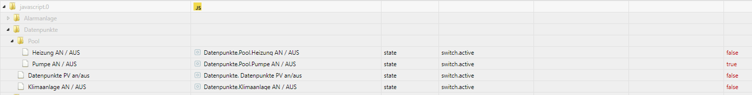

              Nur schaltet es den Datenpunkt nur so
               ![4668_unbenannt_018.png](/assets/uploads/files/4668_unbenannt_018.png)

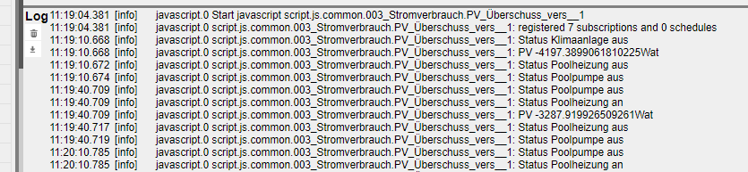

              aber im Log schreibt er was anderes!!
               ![4668_unbenannt_019.png](/assets/uploads/files/4668_unbenannt_019.png)
              Die Pumpe beleibt immer an und die Heizung schaltet er immer aus!
              Die Klimaanlage schaltet er gar nicht?
              warum
              Bitte um Hilfe.

                ich glaube ich habe…..
                habe das Blockly noch etwas angepasst...
                und die Datenpunkte mal alle auf false gestellt...
                Und die Vorzeichen > und < waren auch noch falsch.

                    <value name="IF2"><block type="logic_operation" id=")[#sG#AsohR0cr]e6YR*"><field name="OP">AND</field>
                                        <field name="OID">javascript.0.Datenpunkte.Pool.Pumpe AN / AUS</field></block></value>
                                        <field name="OID">javascript.0.Datenpunkte.Pool.Heizung AN / AUS</field></block></value>
                                <field name="OID">javascript.0.Datenpunkte.Klimaanlage AN / AUS</field></block></value>
                    <statement name="DO2"><block type="comment" id="cJRGsLBkA4mIh~|+*2RW"><field name="COMMENT">...wennPV Überschuss mehr als 1500W</field>
                        <next><block type="comment" id="9H36{o?bd*:a*_nPnqwr"><field name="COMMENT">Datenpunkt= Pumpe an</field>
                            <next><block type="comment" id="Vf%9V`k(f83j.@01q+Z!"><field name="COMMENT">Datenpunkt= Heizung aus</field>
                                <next><block type="comment" id="uxe|D})F8lA6?e4hsFTR"><field name="COMMENT">Datenpunkt= Klimaanlage aus</field>
                                                <value name="TEXT"><shadow type="text" id="h-iSo*Qjm~Sl.H{WMii."><field name="TEXT">Status Poolheizung an</field></shadow></value></block></next></block></next></block></next></block></next></block></next></block></next></block></statement>
                    <value name="IF3"><block type="logic_operation" id="v)TqjJY3vAMtg}zR#64!"><field name="OP">AND</field>
                            <value name="A"><block type="logic_compare" id="dHYXfD=,+GY0,nF%TpNW"><field name="OP">GT</field>
                                <value name="B"><block type="math_number" id="%{ye[[g/zd}sPPA7zb-g"><field name="NUM">400</field></block></value></block></value>
                    <statement name="DO3"><block type="comment" id="103F|ij;#aS(^j?!MOa/"><field name="COMMENT">..wenn Bezug vom Netz mehl als 400W</field>
                        <next><block type="comment" id="Z(N.fp^Gd;W|}|79~N0G"><field name="COMMENT">Datenpunkt= Pumpe an</field>
                            <next><block type="comment" id="A6UNlEySB=_d-U5F_cx-"><field name="COMMENT">Datenpunkt= Heizung an</field>
                                <next><block type="comment" id="9:op5u[Y(b.JJW2^59w!"><field name="COMMENT">Datenpunkt= Klimaanlage aus</field>
                                        <next><block type="control" id="HrRVGs+_+,GKpfQ~}mEp"><mutation delay_input="false"></mutation>
                                            <value name="VALUE"><block type="logic_boolean" id="Av3kDamJe#7_k+Km0yWP"><field name="BOOL">FALSE</field></block></value>
                                                <value name="TEXT"><shadow type="text" id="fXPP(mO]G|wgr=t[v-@C"><field name="TEXT">Status Poolheizung aus</field></shadow></value></block></next></block></next></block></next></block></next></block></next></block></next></block></statement>
                    <value name="IF4"><block type="logic_operation" id="!sP}9aD)7xRx%lS6@Gvz"><field name="OP">AND</field>
                            <value name="A"><block type="logic_compare" id="`6zQ5TM|U`{(LKkEyW?8"><field name="OP">LT</field>
                                <value name="A"><block type="on_source" id="d7R/SvBT0N5#C;D7Yqxc"><field name="ATTR">state.val</field></block></value>
                                <value name="B"><block type="math_number" id="7od=:khG99C:PDQq2B:q"><field name="NUM">-500</field></block></value></block></value>
                            <value name="B"><block type="logic_operation" id="C;+jrR4T?;D|QLSW1w-;"><field name="OP">AND</field>
                                <value name="A"><block type="logic_compare" id="3`Ce0dy%X:`..G/WrTyr"><field name="OP">EQ</field>
                                    <value name="A"><block type="get_value" id="9TI.b:w;sRw8i#?g;U)~"><field name="ATTR">val</field>
                                    <value name="B"><block type="logic_boolean" id="_CbHQ8)OE0_6]C:k[C()"><field name="BOOL">TRUE</field></block></value></block></value>
                                <value name="B"><block type="logic_compare" id="WM}XNruS0ZvAnkVf*CeC"><field name="OP">EQ</field>
                                    <value name="A"><block type="get_value" id="*NAzXNlkzf+eXhhbYAEH"><field name="ATTR">val</field>
                                    <value name="B"><block type="logic_boolean" id="yGh5C%j!OD(TwTa?v37="><field name="BOOL">TRUE</field></block></value></block></value></block></value></block></value>
                        <value name="B"><block type="logic_compare" id="e`}|N3JOXr|}Vt1(Y^no"><field name="OP">EQ</field>
                            <value name="A"><block type="get_value" id="OY3PE3JG*h=?+Ly^7jxH"><field name="ATTR">val</field>
                            <value name="B"><block type="logic_boolean" id="e~^=+h7,;eJh]+aZ:a:Y"><field name="BOOL">FALSE</field></block></value></block></value></block></value>
                    <statement name="DO4"><block type="comment" id="PRCdoC)n|_*%piP]Zl~K"><field name="COMMENT">...wenn PV Über. mehr als 500W</field>
                        <next><block type="comment" id="ex1[ljI@YPvsV)~P#]MV"><field name="COMMENT">Datenpunkt= Pumpe an</field>
                            <next><block type="comment" id="[ji5)}77Yh_2=UhHjsg5"><field name="COMMENT">Datenpunkt= Heizung an</field>
                                <next><block type="comment" id="EeY9/7M1XlSYnR%Bn(ec"><field name="COMMENT">Datenpunkt= Klimaanlage aus</field>
                                    <next><block type="comment" id="uK:sq-A:[;i!{W[kqeU3"><field name="COMMENT">=>dann Status Klimaanlage an</field>
                                        <next><block type="control" id="(8|:h}y!,]Z:jxaw(O+K"><mutation delay_input="false"></mutation>
                                            <value name="VALUE"><block type="logic_boolean" id="ANQ/mUj@^_@U,j+bW0Yz"><field name="BOOL">TRUE</field></block></value>
                                            <next><block type="debug" id="0=Ss6RUPx}u!]n,?FD=i"><field name="Severity">log</field>
                                                <value name="TEXT"><shadow type="text" id="Jg_sK=/p:kfGAlMxRAvQ"><field name="TEXT">Status Klimaanalge an</field></shadow></value></block></next></block></next></block></next></block></next></block></next></block></next></block></statement>
                    <value name="IF5"><block type="logic_operation" id="M%%~ElItW7IFy.9n.h0J"><field name="OP">AND</field>
                        <value name="A"><block type="logic_operation" id="|UPQlF*RU(5PtbmKt|Q["><field name="OP">AND</field>
                            <value name="A"><block type="logic_compare" id="O]ykv@o[8z#*CVfKCb]j"><field name="OP">GT</field>
                                <value name="A"><block type="on_source" id="/V7,3j[mv-55Ud_vfQ(0"><field name="ATTR">state.val</field></block></value>
                                <value name="B"><block type="math_number" id="w4zlqGrOwu6om3@0;Cfc"><field name="NUM">400</field></block></value></block></value>
                            <value name="B"><block type="logic_operation" id="FsjFs9ST77(B3b.;PVp_"><field name="OP">AND</field>
                                <value name="A"><block type="logic_compare" id="T#0+p:XRzjGjV97@01]J"><field name="OP">EQ</field>
                                    <value name="A"><block type="get_value" id="yQN,}A-(P_YZKNhJxMJK"><field name="ATTR">val</field>
                                    <value name="B"><block type="logic_boolean" id="EI!G:uwszN4Vz5aN]aNj"><field name="BOOL">TRUE</field></block></value></block></value>
                                <value name="B"><block type="logic_compare" id="7imPCcK3yL!-,Xy]e`uz"><field name="OP">EQ</field>
                                    <value name="A"><block type="get_value" id="|Ei]K;dUI+spuG~E;A6;"><field name="ATTR">val</field>
                                    <value name="B"><block type="logic_boolean" id="|fCV=O*-2[88t~uY@A,2"><field name="BOOL">TRUE</field></block></value></block></value></block></value></block></value>
                        <value name="B"><block type="logic_compare" id="Jg)tQgU6jONzp!Gm.?O."><field name="OP">EQ</field>
                            <value name="A"><block type="get_value" id="?Bjr}LgFM3?TF8e],5]k"><field name="ATTR">val</field>
                            <value name="B"><block type="logic_boolean" id="ZpOe!UM8)n5S@_w[dPP4"><field name="BOOL">TRUE</field></block></value></block></value></block></value>
                    <statement name="DO5"><block type="comment" id="CZkM2l,034}/O?9DcnS4"><field name="COMMENT">..wenn Bezug vom Netz mehl als 400W</field>
                        <next><block type="comment" id="8PwBYsbsajaXv-^~kP5C"><field name="COMMENT">Datenpunkt= Pumpe an</field>
                            <next><block type="comment" id="m0ue);(BgTh|,8H(s6dm"><field name="COMMENT">Datenpunkt= Heizung an</field>
                                <next><block type="comment" id="-1:/7Lz,#dP{FG!]^n[j"><field name="COMMENT">Datenpunkt= Klimaanlage aus</field>
                                    <next><block type="comment" id="eCus%)3%te^OXNXf8,oM"><field name="COMMENT">=>dann Status Klimaanlage aus</field>
                                        <next><block type="control" id="RZ}d4Quk#Hgt.@SC.oij"><mutation delay_input="false"></mutation>
                                            <value name="VALUE"><block type="logic_boolean" id="(QU,iVa]3snjDI~|bbT@"><field name="BOOL">FALSE</field></block></value>
                                            <next><block type="debug" id="wy)2)(u2]H3ZgRQ_NHTZ"><field name="Severity">log</field>
                                                <value name="TEXT"><shadow type="text" id="d=.1vI1;:%W.8`+1+tgx"><field name="TEXT">Status Klimaanalge an</field></shadow></value></block></next></block></next></block></next></block></next></block></next></block></next></block></statement></block></statement></block></xml>

                      Hallo nun ist mein Blockly fertig
                      Habe das schon eine weile laufen und funktioniert sehr gut!
                      • SmarthomeMF
                        SmarthomeMF last edited by
                        Skript PV Überschuss

                                  ich habe mich an diesem Beitrag orientiert und wollte eine Steuerung für die Heizung unseres Intex Whirlpools realisieren.
                                  Allerdings habe ich Probleme mit dem generierten Datenpunkt.
                                  Ich vermute, da sich der Wert des PV Überschusses ständig über dem eingestellten Wert (>=2500) ändert, wechselt der Status "Pool_Heizung_möglich" zwischen "True" und "False".
                                  Habe ich einen Fehler im Blockly Skript oder kann dieses Verhalten verhindert werden?
                                    berndsolar13 @AndreasW63 last edited by berndsolar13
                                    @andreasw63
                                    da fehlt eine Hysterese, damit das Script nicht beim Vorbeizug von Wolken an und aus geht.
                                    Dazu gibt es hier einige Beiträge, wo ich auch mein Script her habe 😉
                                    Das gelbe ist die Hysterese, die auf 2 Minuten eingestellt ist
                                    Das ist mein Infrarot Script, die bei 150 Watt Überschuss Lampe 1 aktiviert, bei weiteren 150 Lampe2 aktiviert. Im Bild ist nur der Einschalt Rythmuss, der Auschalt Befehl ist identisch, nur dann auf den Wert Bezug größer 50 Watt, dann Steckdosen aus.
                                      AndreasW63 @berndsolar13 last edited by
                                      @berndsolar13
                                      Danke für den Hinweis.
                                      Ich werde es testen 😉
