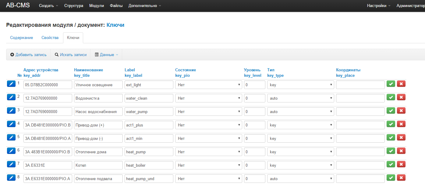

                            Ab-CMS
                            >!  ![443_ab-cms-index-php-1469517956127.png](/assets/uploads/files/443_ab-cms-index-php-1469517956127.png)
