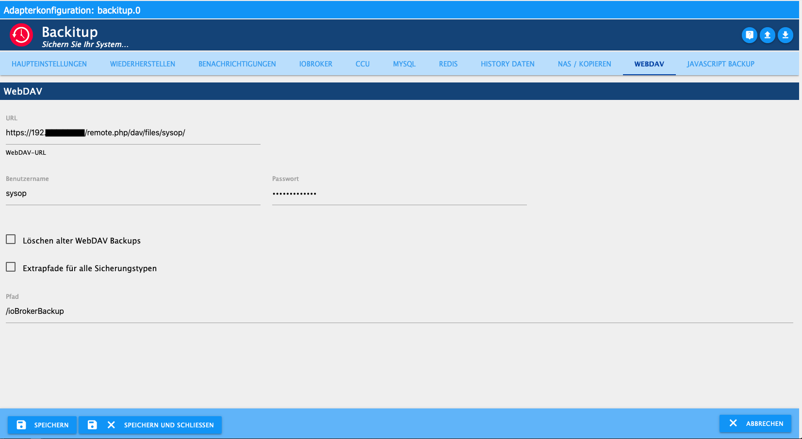

                    Fenriswolf @amg_666 last edited by
                    @simatec
                    Habe auch deinen neuen Adapter direkt mal installiert und probiert. Bekomme aber noch Fehler im Logbuch.
                    So wie es aussieht, scheint es vom WebDav zu kommen. Wollte auf einen seperaten Raspi bei mir sichern auf dem Nextcloud läuft.
                    backitup.0	2021-02-01 19:55:19.148	debug	(4282) mount successfully completed
                    backitup.0	2021-02-01 19:55:19.133	warn	(4282) Terminated (UNCAUGHT_EXCEPTION): Without reason
                    backitup.0	2021-02-01 19:55:19.132	debug	(4282) Plugin sentry destroyed
                    backitup.0	2021-02-01 19:55:19.131	info	(4282) terminating
                    backitup.0	2021-02-01 19:55:19.130	info	(4282) cleaned everything up...
                    backitup.0	2021-02-01 19:55:19.102	error	(4282) Exception-Code: DEPTH_ZERO_SELF_SIGNED_CERT: self signed certificate
                    backitup.0	2021-02-01 19:55:19.101	error	(4282) Error: self signed certificate at TLSSocket.onConnectSecure (_tls_wrap.js:1502:34) at TLSSocket.emit (events.js:314:20) at TLSSocket.EventEmitter.emit (domain.js:483:12) at TLSS
                    backitup.0	2021-02-01 19:55:19.101	error	(4282) unhandled promise rejection: self signed certificate
                    backitup.0	2021-02-01 19:55:19.100	error	(4282) Unhandled promise rejection. This error originated either by throwing inside of an async function without a catch block, or by rejecting a promise which was not handled with .catch().
                    backitup.0	2021-02-01 19:55:18.820	info	(4282) [ccu] backup was activated at 01:30 every 2 day(s)
                    backitup.0	2021-02-01 19:55:18.807	info	(4282) [iobroker] backup was activated at 02:00 every 1 day(s)
                    backitup.0	2021-02-01 19:55:18.730	info	(4282) starting. Version 2.0.0-beta.1 in /opt/iobroker/node_modules/iobroker.backitup, node: v12.20.1, js-controller: 3.2.12
                    • crunchip

                      • simatec
                        simatec Developer Most Active @Fenriswolf last edited by
                        @fenriswolf
                        Bitte poste mal den kompletten debug Log und dein Config
                        Fenriswolf R 2 Replies Last reply Reply Quote 0

                                    • Fenriswolf
                                      Fenriswolf @simatec last edited by
                                      @simatec sagte in Betatester für Backitup 2.0.0 gesucht:
                                      @fenriswolf
                                      Aber gerne doch ....
                                      backitup.0	2021-02-02 06:45:28.244	warn	(9308) Terminated (UNCAUGHT_EXCEPTION): Without reason
                                      backitup.0	2021-02-02 06:45:28.244	debug	(9308) Plugin sentry destroyed
                                      backitup.0	2021-02-02 06:45:28.243	info	(9308) terminating
                                      backitup.0	2021-02-02 06:45:28.242	info	(9308) cleaned everything up...
                                      backitup.0	2021-02-02 06:45:28.193	error	(9308) Exception-Code: DEPTH_ZERO_SELF_SIGNED_CERT: self signed certificate
                                      backitup.0	2021-02-02 06:45:28.193	error	(9308) Error: self signed certificate at TLSSocket.onConnectSecure (_tls_wrap.js:1502:34) at TLSSocket.emit (events.js:314:20) at TLSSocket.EventEmitter.emit (domain.js:483:12) at TLSS
                                      backitup.0	2021-02-02 06:45:28.190	error	(9308) unhandled promise rejection: self signed certificate
                                      backitup.0	2021-02-02 06:45:28.189	error	(9308) Unhandled promise rejection. This error originated either by throwing inside of an async function without a catch block, or by rejecting a promise which was not handled with .catch().
                                      backitup.0	2021-02-02 06:45:28.126	debug	(9308) first mount attempt with smb option failed. try next mount attempt without smb option ...
                                      backitup.0	2021-02-02 06:45:27.841	debug	(9308) [ccu] 10 30 01 */2 * *
                                      backitup.0	2021-02-02 06:45:27.837	info	(9308) [ccu] backup was activated at 01:30 every 2 day(s)
                                      backitup.0	2021-02-02 06:45:27.836	debug	(9308) [iobroker] 10 00 02 */1 * *
                                      backitup.0	2021-02-02 06:45:27.821	info	(9308) [iobroker] backup was activated at 02:00 every 1 day(s)
                                      backitup.0	2021-02-02 06:45:27.739	info	(9308) starting. Version 2.0.0-beta.1 in /opt/iobroker/node_modules/iobroker.backitup, node: v12.20.1, js-controller: 3.2.12
                                      backitup.0	2021-02-02 06:45:27.490	debug	(9308) Plugin sentry Initialize Plugin (enabled=true)
                                      backitup.0	2021-02-02 06:44:52.856	warn	(8256) Terminated (UNCAUGHT_EXCEPTION): Without reason
                                      backitup.0	2021-02-02 06:44:52.856	debug	(8256) Plugin sentry destroyed
                                      backitup.0	2021-02-02 06:44:52.855	info	(8256) terminating
                                      backitup.0	2021-02-02 06:44:52.854	info	(8256) cleaned everything up...
                                      backitup.0	2021-02-02 06:44:52.827	error	(8256) Exception-Code: DEPTH_ZERO_SELF_SIGNED_CERT: self signed certificate
                                      backitup.0	2021-02-02 06:44:52.826	error	(8256) Error: self signed certificate at TLSSocket.onConnectSecure (_tls_wrap.js:1502:34) at TLSSocket.emit (events.js:314:20) at TLSSocket.EventEmitter.emit (domain.js:483:12) at TLSS
                                      backitup.0	2021-02-02 06:44:52.826	error	(8256) unhandled promise rejection: self signed certificate
                                      backitup.0	2021-02-02 06:44:52.825	error	(8256) Unhandled promise rejection. This error originated either by throwing inside of an async function without a catch block, or by rejecting a promise which was not handled with .catch().
                                      backitup.0	2021-02-02 06:44:52.752	debug	(8256) mount successfully completed
                                      backitup.0	2021-02-02 06:44:52.426	debug	(8256) [ccu] 10 30 01 */2 * *
                                      backitup.0	2021-02-02 06:44:52.421	info	(8256) [ccu] backup was activated at 01:30 every 2 day(s)
                                      backitup.0	2021-02-02 06:44:52.420	debug	(8256) [iobroker] 10 00 02 */1 * *
                                      backitup.0	2021-02-02 06:44:52.407	info	(8256) [iobroker] backup was activated at 02:00 every 1 day(s)
                                      backitup.0	2021-02-02 06:44:52.329	info	(8256) starting. Version 2.0.0-beta.1 in /opt/iobroker/node_modules/iobroker.backitup, node: v12.20.1, js-controller: 3.2.12
                                      ![Bildschirmfoto 2021-02-02 um 06.42.10.png](/assets/uploads/files/1612244831143-bildschirmfoto-2021-02-02-um-06.42.10.png)
                                        Thomas Braun Most Active @simatec last edited by
                                        Ist aktuell nur ne Vermutung und ich werde das morgen mal nachstellen
                                        Hat sich wohl erledigt. Das automatische Nacht-Backup ist durchgelaufen. War wohl irgendwie Schluckauf bei Google Drive.
                                        • simatec
                                          @fenriswolf
                                          Dein Screenshot reicht leider nicht. Dort sehe ich nur die Haupteinstellungen. Lade mir mal über die Pfeiltasten deine Config runter und poste sie hier. Passwörter und Keys natürlich dann mit ein paar Sternchen versehen ... 😉
                                          Fenriswolf 1 Reply Last reply Reply Quote 0
                                          • Fenriswolf
                                            @fenriswolf
                                            gerne
                                            system.adapter.backitup.0.json
                                            simatec Fenriswolf 2 Replies Last reply Reply Quote 0
