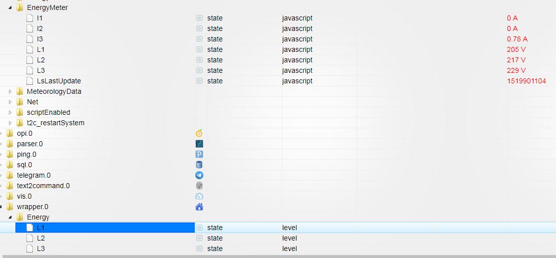

                                          Добрый день. Пытаюсь запустить драйвер, но что-то никак не получается, не появляются данные в объектах драйвера.
                                          Настройки драйвера:
                                          Настройка одного из связанных объектов:

                                          Данные в "Связанных" объектах есть и меняются, а в объектах Wrapper'а пусто:
                                           ![5355_wrapper3.jpg](/assets/uploads/files/5355_wrapper3.jpg)
                                          В логах вот так:
                                          wrapper.0	2018-03-01 13:51:00.622	debug	stateChange javascript.0.EnergyMeter.L3: {"val":229,"ack":false,"ts":1519901460584,"q":0,"from":"system.adapter.javascript.0","lc":1519901160585}
                                          wrapper.0	2018-03-01 13:51:00.621	debug	stateChange javascript.0.EnergyMeter.L2: {"val":217,"ack":false,"ts":1519901460583,"q":0,"from":"system.adapter.javascript.0","lc":1519901160584}
                                          wrapper.0	2018-03-01 13:51:00.620	debug	stateChange javascript.0.EnergyMeter.L1: {"val":205,"ack":false,"ts":1519901460582,"q":0,"from":"system.adapter.javascript.0","lc":1519901160583}
                                          wrapper.0	2018-03-01 13:50:00.650	debug	stateChange javascript.0.EnergyMeter.L3: {"val":229,"ack":false,"ts":1519901400592,"q":0,"from":"system.adapter.javascript.0","lc":1519901160585}
                                          wrapper.0	2018-03-01 13:50:00.649	debug	stateChange javascript.0.EnergyMeter.L2: {"val":217,"ack":false,"ts":1519901400591,"q":0,"from":"system.adapter.javascript.0","lc":1519901160584}
                                          wrapper.0	2018-03-01 13:50:00.648	debug	stateChange javascript.0.EnergyMeter.L1: {"val":205,"ack":false,"ts":1519901400589,"q":0,"from":"system.adapter.javascript.0","lc":1519901160583}
                                          wrapper.0	2018-03-01 13:49:00.635	debug	stateChange javascript.0.EnergyMeter.L3: {"val":229,"ack":false,"ts":1519901340585,"q":0,"from":"system.adapter.javascript.0","lc":1519901160585}
                                          wrapper.0	2018-03-01 13:49:00.634	debug	stateChange javascript.0.EnergyMeter.L2: {"val":217,"ack":false,"ts":1519901340584,"q":0,"from":"system.adapter.javascript.0","lc":1519901160584}
                                          wrapper.0	2018-03-01 13:49:00.633	debug	stateChange javascript.0.EnergyMeter.L1: {"val":205,"ack":false,"ts":1519901340582,"q":0,"from":"system.adapter.javascript.0","lc":1519901160583}
                                          wrapper.0	2018-03-01 13:48:00.624	debug	stateChange javascript.0.EnergyMeter.L3: {"val":229,"ack":false,"ts":1519901280578,"q":0,"from":"system.adapter.javascript.0","lc":1519901160585}
                                          wrapper.0	2018-03-01 13:48:00.616	debug	stateChange javascript.0.EnergyMeter.L2: {"val":217,"ack":false,"ts":1519901280575,"q":0,"from":"system.adapter.javascript.0","lc":1519901160584}
                                          wrapper.0	2018-03-01 13:48:00.614	debug	stateChange javascript.0.EnergyMeter.L1: {"val":205,"ack":false,"ts":1519901280574,"q":0,"from":"system.adapter.javascript.0","lc":1519901160583}
                                          wrapper.0	2018-03-01 13:47:00.649	debug	stateChange javascript.0.EnergyMeter.L3: {"val":229,"ack":false,"ts":1519901220605,"q":0,"from":"system.adapter.javascript.0","lc":1519901160585}
                                          wrapper.0	2018-03-01 13:47:00.647	debug	stateChange javascript.0.EnergyMeter.L2: {"val":217,"ack":false,"ts":1519901220604,"q":0,"from":"system.adapter.javascript.0","lc":1519901160584}
                                          wrapper.0	2018-03-01 13:47:00.646	debug	stateChange javascript.0.EnergyMeter.L1: {"val":205,"ack":false,"ts":1519901220602,"q":0,"from":"system.adapter.javascript.0","lc":1519901160583}
                                          wrapper.0	2018-03-01 13:46:00.706	debug	stateChange javascript.0.EnergyMeter.L3: {"val":229,"ack":false,"ts":1519901160585,"q":0,"from":"system.adapter.javascript.0","lc":1519901160585}
                                          wrapper.0	2018-03-01 13:46:00.705	debug	stateChange javascript.0.EnergyMeter.L2: {"val":217,"ack":false,"ts":1519901160584,"q":0,"from":"system.adapter.javascript.0","lc":1519901160584}
                                          wrapper.0	2018-03-01 13:46:00.692	debug	stateChange javascript.0.EnergyMeter.L1: {"val":205,"ack":false,"ts":1519901160583,"q":0,"from":"system.adapter.javascript.0","lc":1519901160583}
                                          wrapper.0	2018-03-01 13:45:00.631	debug	stateChange javascript.0.EnergyMeter.L3: {"val":230,"ack":false,"ts":1519901100564,"q":0,"from":"system.adapter.javascript.0","lc":1519900620650}
                                          wrapper.0	2018-03-01 13:45:00.631	debug	stateChange javascript.0.EnergyMeter.L2: {"val":226,"ack":false,"ts":1519901100563,"q":0,"from":"system.adapter.javascript.0","lc":1519900620649}
                                          wrapper.0	2018-03-01 13:45:00.629	debug	stateChange javascript.0.EnergyMeter.L1: {"val":199,"ack":false,"ts":1519901100561,"q":0,"from":"system.adapter.javascript.0","lc":1519900620648}

                                          sql.0	2018-03-01 13:42:13.686	info	enabled logging of wrapper.0.Energy.L1
                                          wrapper.0	2018-03-01 13:42:00.650	debug	stateChange javascript.0.EnergyMeter.L3: {"val":230,"ack":false,"ts":1519900920588,"q":0,"from":"system.adapter.javascript.0","lc":1519900620650}
                                          wrapper.0	2018-03-01 13:42:00.649	debug	stateChange javascript.0.EnergyMeter.L2: {"val":226,"ack":false,"ts":1519900920587,"q":0,"from":"system.adapter.javascript.0","lc":1519900620649}
                                          wrapper.0	2018-03-01 13:42:00.648	debug	stateChange javascript.0.EnergyMeter.L1: {"val":199,"ack":false,"ts":1519900920585,"q":0,"from":"system.adapter.javascript.0","lc":1519900620648}
                                          wrapper.0	2018-03-01 13:41:00.729	debug	stateChange javascript.0.EnergyMeter.L3: {"val":230,"ack":false,"ts":1519900860653,"q":0,"from":"system.adapter.javascript.0","lc":1519900620650}
                                          wrapper.0	2018-03-01 13:41:00.704	debug	stateChange javascript.0.EnergyMeter.L2: {"val":226,"ack":false,"ts":1519900860652,"q":0,"from":"system.adapter.javascript.0","lc":1519900620649}
                                          wrapper.0	2018-03-01 13:41:00.701	debug	stateChange javascript.0.EnergyMeter.L1: {"val":199,"ack":false,"ts":1519900860651,"q":0,"from":"system.adapter.javascript.0","lc":1519900620648}
                                          sql.0	2018-03-01 13:40:54.644	info	enabled logging of wrapper.0.Energy.L3
                                          sql.0	2018-03-01 13:40:54.642	info	enabled logging of wrapper.0.Energy.L2
                                          sql.0	2018-03-01 13:40:54.619	info	enabled logging of wrapper.0.Energy.L1
                                          wrapper.0	2018-03-01 13:40:54.379	info	starting. Version 0.1.6 in /opt/iobroker/node_modules/iobroker.wrapper, node: v4.8.7
                                          Что я делаю не так?
                                            Haus last edited by
                                            Драйвер создаёт логические переменные и если нужна связывает с физическими.
                                            state, temperature, humidity, indikator, conter - отображают значение при изменении связанных физических переменных.
                                            switch, value, blinds - управляют связанными физическими переменными.
