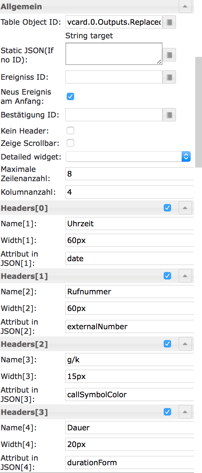

      [{"tpl":"tplTableBody","data":{"visibility-cond":"==","visibility-val":1,"static_value":"","table_oid":"vcard.0.Outputs.ReplacedPhoneNumbersCh5","colCount":"4","colWidth1":"60px","colWidth2":"60px","colWidth3":"15px","colName1":"Uhrzeit","colName2":"Rufnummer","colName3":"g/k","colAttr1":"date","colAttr2":"externalNumber","colAttr3":"callSymbolColor","colName5":"Dauer","colWidth5":"40px","colAttr5":"durationForm","visibility-groups-action":"hide","signals-cond-0":"==","signals-val-0":true,"signals-icon-0":"/vis/signals/lowbattery.png","signals-icon-size-0":0,"signals-blink-0":false,"signals-horz-0":0,"signals-vert-0":0,"signals-hide-edit-0":false,"signals-cond-1":"==","signals-val-1":true,"signals-icon-1":"/vis/signals/lowbattery.png","signals-icon-size-1":0,"signals-blink-1":false,"signals-horz-1":0,"signals-vert-1":0,"signals-hide-edit-1":false,"signals-cond-2":"==","signals-val-2":true,"signals-icon-2":"/vis/signals/lowbattery.png","signals-icon-size-2":0,"signals-blink-2":false,"signals-horz-2":0,"signals-vert-2":0,"signals-hide-edit-2":false,"g_header_§3":true,"max_rows":"8","new_on_top":true,"hide_header":false,"detailed_wid":"","colName4":"Dauer","colAttr4":"durationForm","colWidth4":"20px","g_css_background":true,"g_css_border":false,"g_css_shadow_padding":false,"g_gestures":false,"show_scroll":false},"style":{"left":"585px","top":"66px","width":"513px","height":"181px","text-align":"center","font-size":"14px","z-index":"9","background":"","font-family":"","color":"white","background-color":"black"},"widgetSet":"basic"}]
      meintest du das so mit den Einstellungen (Hardcopy)?
       ![1024_bildschirmfoto_2017-01-21_um_14.34.35.png](/assets/uploads/files/1024_bildschirmfoto_2017-01-21_um_14.34.35.png)

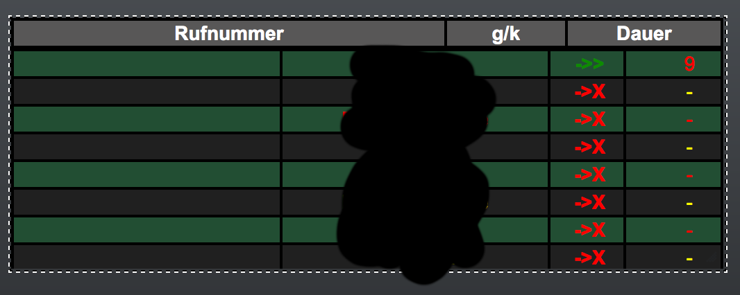

      so wird es dargestellt.
       ![1024_bildschirmfoto_2017-01-21_um_14.43.17.png](/assets/uploads/files/1024_bildschirmfoto_2017-01-21_um_14.43.17.png)

              jensus11 last edited by
              dadran hat es wirklich gelegen.
              Wie kann man denn jetzt beim TV Widget die Spaltenhöhe verringern?
              Jetzt ist die Übersicht schon arg groß.

                ich bekomme es einfach nicht hin, dass die Anrufe sauber dargestellt werden.
                Hat jemand eine Idee?

                    Am liebsten so:
                    Name Nummer Zeit
                    Xyz. 9098@8. 18:00 Uhr
                    Momentan wird alles durcheinander angezeigt.

                        ja beim ersten mal habe ich die größe verändert….habe dann aber das widget wieder neu importiert und immer noch so.
                        jetzt habe ich etwas rum gespielt..es sieht etwas besser aus siehe foto.Nur bekomme ich die eigene Nummer (eigenes Amt) nicht nach oben.
                        Das obere durchgestrichene ist die verpasste Nummer, das untere die eigene.

                            danke für die schnelle Antwort. Das mit der Schriftgröße habe ich versucht nur bringt das nicht viel. Erst wenn ich die Breite verändere wird die eigene Nummer nach oben verlegt, leider nur viel zu weit rechts. Wie bekomme ich (rot markiert) die Nummer nach links? Ich habe schon alles verändert.?
                            Beni
                              @xADDRx:
                              Wie bekomme ich (rot markiert) die Nummer nach links? `
                              gar nicht.
                              Die Spalten sind zu schmal für deine Schriftgröße. Die externe Rufnummer hängt schon in der für die eigene Rufnummer gedachte spalte, dadurch ruscht die eigene Nummer eine Spalte weiter.

                                      Kam mir doch gleich bekannt vor :), wollte gerade vom PC posten. Im Vcard sind die Spalten wie folgt eingestellt:
                                      Ich denke mal da ist der Fehler.

                                          @Brati:
                                          Ich denke mal da ist der Fehler. `
                                          Ich auch.
