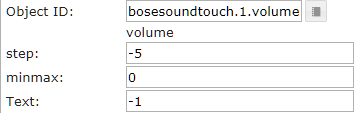

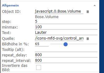

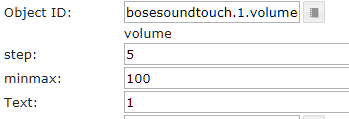

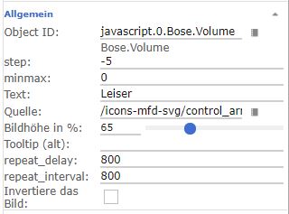

        mit diesen Einstellungen funktioniert das Widget bei mir Super
        und die Einstellungen für Leiser…

            [{"tpl":"tplIconInc","data":{"oid":"bosesoundtouch.0.volume","visibility-cond":"==","visibility-val":1,"step":"5","minmax":"100","text":"Lauter","repeat_delay":"800","repeat_interval":"800","src":"/icons-mfd-svg/control_arrow_up.svg","imageHeight":"65","invert_icon":false,"signals-cond-0":"==","signals-val-0":true,"signals-icon-0":"/vis/signals/lowbattery.png","signals-icon-size-0":0,"signals-blink-0":false,"signals-horz-0":0,"signals-vert-0":0,"signals-hide-edit-0":false,"signals-cond-1":"==","signals-val-1":true,"signals-icon-1":"/vis/signals/lowbattery.png","signals-icon-size-1":0,"signals-blink-1":false,"signals-horz-1":0,"signals-vert-1":0,"signals-hide-edit-1":false,"signals-cond-2":"==","signals-val-2":true,"signals-icon-2":"/vis/signals/lowbattery.png","signals-icon-size-2":0,"signals-blink-2":false,"signals-horz-2":0,"signals-vert-2":0,"signals-hide-edit-2":false,"visibility-groups-action":"hide","name":"Medien_Lauter_Z0","lc-type":"last-change","lc-is-interval":true,"lc-is-moment":false,"lc-format":"","lc-position-vert":"top","lc-position-horz":"right","lc-offset-vert":0,"lc-offset-horz":0,"lc-font-size":"12px","lc-font-family":"","lc-font-style":"","lc-bkg-color":"","lc-color":"","lc-border-width":"0","lc-border-style":"","lc-border-color":"","lc-border-radius":10,"lc-zindex":0},"style":{"left":"1010px","top":"460px","width":"80px","height":"80px","background":"black","background-color":"black","font-family":"RobotoCondensed-Light","font-style":"normal","font-variant":"normal","font-weight":"lighter","font-size":"16px","line-height":"20px"},"widgetSet":"jqui"}]
            hier nochmal das gesamte Widget für "Lauter" eingestellt auf den Datenpunkt "volume" vom Bose Adapter.
            Vielleicht hilft es ja. Ich hatte gerade nochmal getestet, in meiner Installation funktioniert das so.

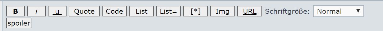

                wenn DU auf einen Beitrag antwortest bzw. einen neuen Beitrag vefasst, dann hast DU oberhalb von Deinem Eingabefenster diesen Bereich.
                und dort klickst Du auf "Code" und alles was Du zwischen die beiden Tags schreibst erscheint als Code im Beitrag.

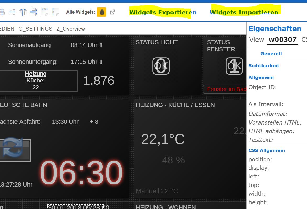

                    ach so…
                    im VIS gibt es die Möglichkeit Widgets zu Importieren.
                    Dort muss du diesen Code mit Copy und Paste einfügen.
                    Zum Schluss musst du dann nur noch den/die Datenpunkte überarbeiten, denn die passen ja nicht zu deiner Installation.
