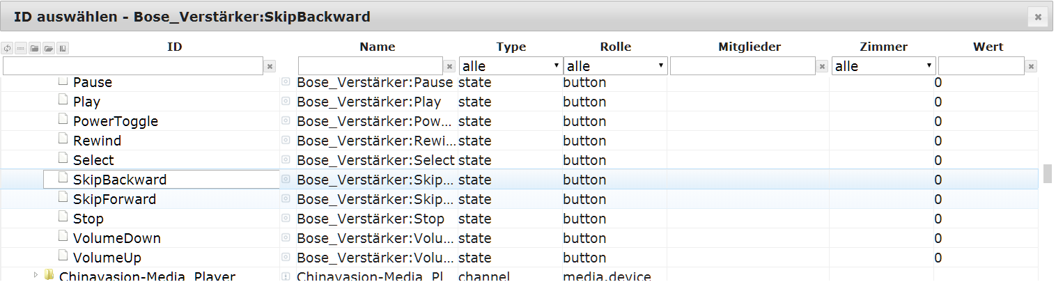

            • 0
              0018 last edited by
              Ist ctrl - icon increment dazu das richtige? Hiermit kann man doch zB Lautstärke +/- X regeln oder?
              Musst du nicht für Skip eine Aktion ausführen, also einen Taster dafür verwenden?
              Was hat der der Datenpunkt "harmony.0.Hub_Wohnzimmer.Bose_Verstärker.SkipBackward" für eine Eigenschaft? (bool/number etc)
                senger1985 last edited by
                im Anhang die Bilder.

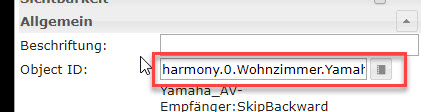

                    • wendy2702
                      wendy2702 last edited by
                      Das ist doch ein ganz normaler Button den du dann nur auf deinen Harmony Datenpunkt ändern musst:
                      Jetzt mal als "Skip xx an meinem Yamaha Verstärker über Harmony:
                      ! > [{"tpl":"tplJquiToogle","data":{"oid":"harmony.0.Wohnzimmer.Yamaha_AV-Empfänger.SkipBackward","g_fixed":true,"g_visibility":false,"g_css_font_text":false,"g_css_background":false,"g_css_shadow_padding":false,"g_css_border":false,"g_gestures":false,"g_signals":false,"g_last_change":false,"signals-cond-0":"==","signals-val-0":true,"signals-icon-0":"/vis/signals/lowbattery.png","signals-icon-size-0":0,"signals-blink-0":false,"signals-horz-0":0,"signals-vert-0":0,"signals-hide-edit-0":false,"signals-cond-1":"==","signals-val-1":true,"signals-icon-1":"/vis/signals/lowbattery.png","signals-icon-size-1":0,"signals-blink-1":false,"signals-horz-1":0,"signals-vert-1":0,"signals-hide-edit-1":false,"signals-cond-2":"==","signals-val-2":true,"signals-icon-2":"/vis/signals/lowbattery.png","signals-icon-size-2":0,"signals-blink-2":false,"signals-horz-2":0,"signals-vert-2":0,"signals-hide-edit-2":false,"lc-type":"last-change","lc-is-interval":true,"lc-is-moment":false,"lc-format":"","lc-position-vert":"top","lc-position-horz":"right","lc-offset-vert":0,"lc-offset-horz":0,"lc-font-size":"12px","lc-font-family":"","lc-font-style":"","lc-bkg-color":"","lc-color":"","lc-border-width":"0","lc-border-style":"","lc-border-color":"","lc-border-radius":10,"lc-zindex":0,"src_true":"/icons-material-png/av/ic_skip_next_white_48dp.png","class":"","src_false":"/icons-material-png/av/ic_skip_next_white_48dp.png","visibility-cond":"==","visibility-val":1,"visibility-groups-action":"hide"},"style":{"left":"349px","top":"360px","width":"40px","height":"40px"},"widgetSet":"jqui"}]
                      Den Datenpunkt muss du nur auf deinen Harmony Datenpunkt ändern:
