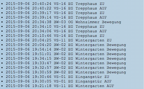

    4. Ereignisliste erzeugen
    • sissiwup
      sissiwup last edited by
      um eine Ereignisliste:
      zu erzeugen, kann man folgendes Skript verwenden:
      `createState("vEreignisse","
      *   first
      var sensorsST = $('channel[state.id=*.STATE](functions=ST)').each(function(id) {
          var val = getObject(id).common.name;
          log("DeviceST=" + val);
      var sensorsVS = $('channel[state.id=*.STATE](functions=VS)').each(function(id) {
          log("DeviceVS=" + val);
      var sensorsBW = $('channel[state.id=*.MOTION](functions=BW)').each(function(id) {
          log("DeviceBW=" + val);
      var vAlarmanlage = $('state[id="hm-rega.0.3747"]').each(function(id) {
          log("Alarmanlage=" + val);
      function ereignis(text) {
          log("ereignis "+text);
          var ereignisStr = getState("vEreignisse").val;
          var ereignisArr;
          ereignisArr = ereignisStr.replace(/`
      `*   /, "").replace(/<\/li><\/ul>/, "").split("*   ");
              ereignisArr = ereignisArr.reverse();
              ereignisArr.push(text);
              ereignisArr.reverse().splice(99); // Liste auf 20 Einträge beschränken
              var str = ereignisArr.join("`
              setState("vEreignisse", "
          *   "+str+"
          function timestamp(ts) {
              var now=new Date(ts);
              var day = now.getDate();
              var month = now.getMonth() + 1;
              var year = now.getFullYear();
              var weekday = now.getDay();
              var hours = now.getHours();
              var minutes = now.getMinutes();
              var seconds = now.getSeconds();
              var day0  = ((day < 10) ? "0" : "");
              var month0  = ((month < 10) ? "0" : "");
              var hours0  = ((hours < 10) ? "0" : "");
              var minutes0  = ((minutes < 10) ? "0" : "");
              var seconds0  = ((seconds < 10) ? "0" : "");
              var output = year + "-" + month0 + month + "-" + day0 + day + " " + hours0 + hours + ":" + minutes0 + minutes + ":" + seconds0 + seconds;
              return output;
          function room(obj) {
              var devname=obj.deviceName;
              var dp = getObject(obj.id,"rooms");
              var raum=dp.enumNames;
          //    var raum="---";
              var rooms ={"ST-05" : "OG Balkontür", "ST-02" : "OG Wohnzimmer BW", "ST-03" : "EG Treppenhaustür"
                , "ST-01" : "EG Wintergarten" , "ST-04" : "EG Eingangstür"
                , "BW-01" : "UG Garage" , "BW-02" : "EG Wintergarten" , "BW-03" : "OG Wohnzimmer"
                , "VS-01" : "EG Eingangstür" , "VS-02" : "UG Eingangstür" , "VS-03" : "UG Waschküche"
                , "VS-04" : "UG Garagentor" , "VS-05" : "EG Balkontür Atrium" , "VS-06" : "EG Relaxraum"
                , "VS-07" : "OG Balkontür" , "VS-08" : "OG Dachfenster" , "VS-09" : "EG Katzen R"
                , "VS-10" : "EG Katzen L" , "VS-11" : "EG Wintergarten" , "VS-12" : "EG Wohnzimmerfenster"
                , "VS-13" : "EG Küche L" , "VS-14" : "EG Küche R" , "VS-15" : "EG Abstellkammer"
                , "VS-16" : "EG Trepphaus" , "VS-17" : "OG Gästezimmer" , "VS-18" : "OG Ankleidezimmer"
              if (devname in rooms) {
                  return rooms[devname];
              return raum;
          sensorsST.on(function(obj) {
            var aktion="AUTO";
            if (obj.newState.val == 1) {
              aktion="OFF";
            var ts=timestamp(obj.newState.ts);
              ereignis(ts + " " + obj.deviceName + " " + room(obj) + " " + aktion);
          //    log("OBJ=" + JSON.stringify(obj,null,2));
          sensorsVS.on(function(obj) {
            var aktion="ZU";
              aktion="AUF";
          sensorsBW.on(function(obj) {
              ereignis(ts + " " + obj.deviceName + " " + room(obj) + " " + "Bewegung");
          vAlarmanlage.on(function(obj) {
            var aktion="Haus alles gesichert";
              aktion="im Haus/Lüften";
            if (obj.newState.val == 2) {
              aktion="OFF";
              ereignis(ts + " Alarmstatus: " + aktion);
          mit den Funktionen sensorsXX Frage ich alle Sensoren, die zu einer Gruppe gehören ab,
          bei VS = Verschluß, BW = Bewegung und ST = Statusänderung/Schalter
          mit vAlarmanlage Frage ich einen einzelnen Datenpunkt ab, hier eine Variable.
          Im unteren Bereich des Skriptes muss zu jeder Funktion eine *.on Funktion dazu erstellt werden.
          Diese kann je nach Geräteart die Ausgabe umformulieren.
          UPDATE: Angepasst an neue Timestamps!

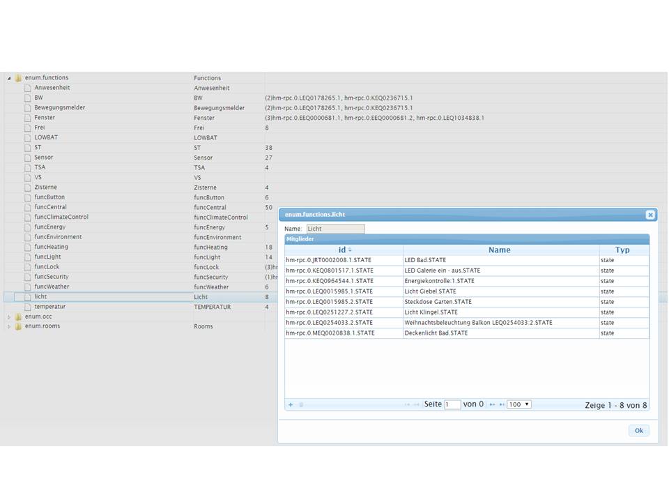

                        Habe ein Problem mit den functions.
                        Ich habe die Kanäle entsprechend manuell über "Aufzählung" hinzugefügt und zuvor die Kategorie Licht angelegt
                        Wenn ich (functions=Licht) weg lasse geht alles.
                            var sensorsLicht = $('channel[state.id=*.STATE]').each(function(id) {  //(functions=Licht)
                            log("===> Ereignisliste Licht=" + val);
                        möchte ich nach STATE und Functions selektieren gehts nicht mehr.
                           var sensorsLicht = $('channel[state.id=*.STATE](functions=Licht)').each(function(id) {  //(functions=Licht)
                        Ich hab schon LIcht oder licht probiert aber es kommt kein Ergebnis.
                        QWie gesagt lass ich es weg bekomme ich einen Eintrag so dass das Skript ja funktioniert.
                        Was mach ich falsch / übersehe ich?
                          paul53 last edited by
                          @HKF8770:
                          Wenn ich (functions=Licht) weg lasse geht alles. `
                          Hast Du es mal mit (functions=licht) versucht ?
                            HKF8770 last edited by
                            geht leider weder noch….Mach ich irgendwo nen Fehler?
                            Ich lege die funtions auf dem Reiter "Aufzählunbgen" manuell an. unter enum.funtions mit dem + lege ich die Unterkategorie an die ja im Skript auch abgefragt wird. Dann in der Unterkategorie ganz rechts über das Buch ergänze ich die entsprechenden Datenpunkte. z.B.xxxxxx.state oder xxxxxx.motion, immer das was ich abfragen möchte.
                            Das ist so doch richtig, oder?
                              Hab Lösung gefunden.
                              • alle functions manuell gelöscht (Papierkorb rechts)
                              • Adapter hm-rega neu synchronisiert
                              Dachte wenn ich Änderungen an edn Gewerken der CCU2 mache wird dies mit iobrokler synchronisiert, wenn ich hm-rega neu starte….dem ist aber wohl nicht so. Erst nachdem ich alle functions gelöscht hatte und neu synchronisiert hatte, war dies identisch zu der CCU2.

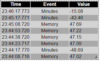

                                      Vielleicht wird so was interessant.
                                      Alle events werden aus dem history/sql Adapter gelesen.
                                      `/* Read events from history adapter.
                                         Define the list of IDs, that must be shown.
                                         Additionally for every ID the display name and number of events can be defined.
                                      var historyInstance = 'sql.0'; // can be history adapter too
                                      // ofcourse all IDs must be enabled for history
                                      var states = {
                                          "javascript.0.graph.minutes"/*graph.minutes*/:      { name: 'Minutes', count: 15},
                                          "system.adapter.admin.0.memRss"/*admin.0.memRss*/ : { name: 'Memory'}
                                      var timeout = null; // de-bounce
                                      // create variable, where the list will be stored
                                      createState('eventList', '', function () {
                                          //first execute
                                          readAllEvents();
                                      function publishEvents(events) {
                                          // AS HTML
                                          /*var table = '';
                                          for (var e = 0; e < events.length; e++) {
                                              table += '';
                                          table += '
                                      | ' + formatDate(events[e].time, 'hh:mm:ss.sss') + ' | ' + states[events[e].id].name + ' | ' + events[e].val + ' |
                                          // as JSON
                                             events[e].time = formatDate(events[e].time, 'hh:mm:ss.sss');
                                             events[e].id   = states[events[e].id].name || events[e].id;
                                          setState('eventList', JSON.stringify(events), true);
                                      function readOneId(id, number, events, cb) {
                                          var end = new Date().getTime();
                                          sendTo(historyInstance, 'getHistory', {
                                              options: {
                                                  end:        end,
                                                  aggregate: 'none',
                                                  count:      number || 10
                                          }, function (result) {
                                              if (result.result) {
                                                  for (var i = 0; i < result.result.length; i++) {
                                                      events.push({id: id, time: result.result[i].ts, val: result.result[i].val});

                                          Wenn du dir nun die Ausgabe ansiehst: 261_bildschirmfoto_202015-09-06_20um_2020.46.22.png Es sind also nur Bezeichnungen.
                                          Das Skript lauscht auf deine Sensoren an anderer Stelle:
                                          Es lauscht in den Gewerken ST, BW, VS (vermute BW= Bewegungsmelder, VS= Verschluss, ST ???), ob die angegebenen Datenpunkte sich ändern. Dazu wird auf die REGA-Variable Alarmanlage gelauscht.
