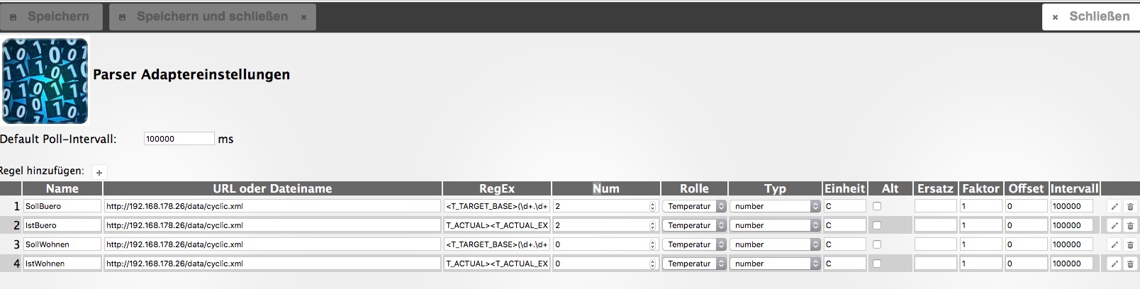

            Ich habe nun endeckt, dass mir die Daten auch über XML zur Verfügung gestellt werden. Somit kann ich das XML File mit dem Parser einlesen 🙂
            Das Problem ist aber jetzt, dass ich die Werte teilweise orange sind und den Fehler 0x44 device error melden.
            Ist hier evtl meine RegEx Funktion schuld?
            <t_target_base>(\d+.\d+)</t_target_base>
            T_ACTUAL><t_actual_ext>(\d+.\d+)</t_actual_ext>
            <heatarea nr="1"><heatarea_mode>0</heatarea_mode><t_actual>23.5</t_actual><t_actual_ext>23.5</t_actual_ext><t_target>22.6</t_target><t_target_base>22.6</t_target_base><heatarea_state>0</heatarea_state><program_source>0</program_source><program_week>0</program_week><program_weekend>0</program_weekend><party>0</party><party_remainingtime>0</party_remainingtime><presence>0</presence><islocked>0</islocked></heatarea><heatarea nr="4"><heatarea_mode>0</heatarea_mode><t_actual>22.0</t_actual><t_actual_ext>22.0</t_actual_ext><t_target>22.0</t_target><t_target_base>22.0</t_target_base><heatarea_state>0</heatarea_state><program_source>0</program_source><program_week>0</program_week><program_weekend>0</program_weekend><party>0</party><party_remainingtime>0</party_remainingtime><presence>0</presence><islocked>0</islocked></heatarea><heatarea nr="6"><heatarea_mode>0</heatarea_mode><t_actual>22.7</t_actual><t_actual_ext>22.7</t_actual_ext><t_target>21.4</t_target><t_target_base>21.4</t_target_base><heatarea_state>0</heatarea_state><program_source>0</program_source><program_week>0</program_week><program_weekend>0</program_weekend><party>0</party><party_remainingtime>0</party_remainingtime><presence>0</presence><islocked>0</islocked></heatarea><heatarea nr="7"><heatarea_mode>0</heatarea_mode><t_actual>21.8</t_actual><t_actual_ext>21.8</t_actual_ext><t_target>20.0</t_target><t_target_base>20.0</t_target_base><heatarea_state>0</heatarea_state><program_source>0</program_source><program_week>0</program_week><program_weekend>0</program_weekend><party>0</party><party_remainingtime>0</party_remainingtime><presence>0</presence><islocked>0</islocked></heatarea><heatarea nr="8"><heatarea_mode>0</heatarea_mode><t_actual>23.5</t_actual><t_actual_ext>23.5</t_actual_ext><t_target>21.0</t_target><t_target_base>21.0</t_target_base><heatarea_state>0</heatarea_state><program_source>0</program_source><program_week>0</program_week><program_weekend>0</program_weekend><party>0</party><party_remainingtime>0</party_remainingtime><presence>0</presence><islocked>0</islocked></heatarea>

              Was willst du denn auslesen?
              Dein Regex funktioniert nicht, wenn es denn eins ist.
              Aufgeteilt in 2 Teile ergibt jeder 5 Ergebnisse.
              Rainer

                wie sieht die xml aus? kannst die mal posten?
                es reicht schon meist den wert anzugeben zwischen dem der wert steht
                  @mikiline:
                  wie sieht die xml aus? kannst die mal posten? `
                  Hat er bereits oben 😉
                  etwas kürzer geht es auch mit
                  SE>([^<]+)
                  Rainer

                    Es soll der TARGET BASE und den ACTUAL EXT für jede Nr. ausgelesen werden.
                    Ich dachte die Spalte Num bedeutet, dass ich den erkannten 1 und den 3 erkannten Wert auslese.
                      @0815broker:
                      Ich dachte die Spalte Num bedeutet, dass ich den erkannten 1 und den 3 erkannten Wert auslese. `
                      korrekt!
                      Ich habe dir jetzt auch nur den RegEx für Target Base gegeben, der für Actual_ext sähe verkürzt so aus:
                      XT>([^<]+)

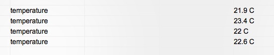

                      Was die "Gelbfärbung" deiner Werte angeht bin ich mir nicht sicher.
                      Ich selber habe das nicht, habe aber auch keine Dezimalwerte.
                      Wie ist denn der Datentyp des STATEs
                      Rainer

                        TOP !!!
                        Vielen Dank und schon läufts 😄
                        • 0
                          0815broker last edited by
                          Die Werte werden nun auch ganz normal angezeigt
