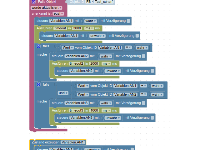

                  So geht es bei meiner Fernbedienung. Diese kennt nur false und reagiert deswegen auf Aktualierung und nicht auf Änderung.
                  3x drücken funktioniert so.
                  Blockly Export:
                  ! <xml 1999/xmlns="<URL url=" http:/www.w3.org/xhtml"="">http://www.w3.org/1999/xhtml">
                  ! <block type="on_ext" id="|vx#z_nfoa:7BzXGkx#r" x="38" y="38"><mutation items="1"></mutation>
                  ! <field name="CONDITION">any</field>
                  ! <value name="OID0"><shadow type="field_oid" id="ZA2v0kyH!rYhv7J9Wt"><field name="oid">rflink.0.channels.Eurodomest_7.SWITCH_03</field></shadow></value>
                  ! <statement name="STATEMENT"><block type="control" id="y[}[%{N9m%NL.U14X}Q}"><mutation delay_input="false"></mutation>
                  ! <field name="OID">javascript.0.Variablen.AN1</field>
                  ! <field name="WITH_DELAY">FALSE</field>
                  ! <value name="VALUE"><block type="logic_boolean" id="Dc-AQwx57glow1YNx8f;"><field name="BOOL">TRUE</field></block></value>
                  ! <next><block type="timeouts_settimeout" id="9vRp=u!.q;[jX:LOV+8~"><field name="NAME">timeout</field>
                  ! <field name="DELAY">3000</field>
                  ! <field name="UNIT">ms</field>
                  ! <statement name="STATEMENT"><block type="control" id="N73MosEd!#N4KJ2?uDGL"><mutation delay_input="false"></mutation>
                  ! <value name="VALUE"><block type="logic_boolean" id="3mWLFn;]6uixO#B7ZT:{"><field name="BOOL">FALSE</field></block></value></block></statement>
                  ! <next><block type="controls_if" id="WexYaaJ_Gry8n5?219fA"><value name="IF0"><block type="logic_compare" id=")|AlZp[]G5iXVAng~Ft"><field name="OP">EQ</field>
                  ! <value name="A"><block type="get_value" id="6pu})}P50QKvkZmUNFg"><field name="ATTR">val</field>
                  ! <field name="OID">javascript.0.Variablen.AN1</field></block></value>
                  ! <value name="B"><block type="logic_boolean" id="@A4.C^]^UfuHU[aDc
                  [0"><field name="BOOL">TRUE</field></block></value></block></value>
                  ! <statement name="DO0"><block type="control" id="tkv@4cPjjkRqGTLTuUwA"><mutation delay_input="false"></mutation>
                  ! <field name="OID">javascript.0.Variablen.AN2</field>
                  ! <value name="VALUE"><block type="logic_boolean" id="{^ZPZxcDD|csn78}|w2b"><field name="BOOL">TRUE</field></block></value>
                  ! <next><block type="timeouts_settimeout" id="Jt3
                  (AEUnFV9.(G3a7]C"><field name="NAME">timeout2</field>
                  ! <field name="DELAY">2000</field>
                  ! <statement name="STATEMENT"><block type="control" id="bZ|Fd{U1qc-R_k%6(~G3"><mutation delay_input="false"></mutation>
                  ! <value name="VALUE"><block type="logic_boolean" id="jAEC1nsX~!Hq/iJ-mKH0"><field name="BOOL">FALSE</field></block></value></block></statement></block></next></block></statement>
                  ! <next><block type="controls_if" id="4BopoP{+(V3AX;ZWU~Rs"><value name="IF0"><block type="logic_operation" id="zGH:K4[)~Pk+ZKg)FzN" inline="false"><field name="OP">AND</field>
                  ! <value name="A"><block type="logic_compare" id="Hpij
                  anuCrJ;Nqgd3QKV"><field name="OP">EQ</field>
                  ! <value name="A"><block type="get_value" id="F{euvZo]CBaq|(JAAek%"><field name="ATTR">val</field>
                  ! <value name="B"><block type="logic_boolean" id="CL~M||lF)g)projG7?,V"><field name="BOOL">TRUE</field></block></value></block></value>
                  ! <value name="B"><block type="logic_compare" id="/%S[NIO.dXj4Q6LgL%"><field name="OP">EQ</field>
                  ! <value name="A"><block type="get_value" id="7FA,n.;4j/whS{b@a;K"><field name="ATTR">val</field>
                  ! <field name="OID">javascript.0.Variablen.AN2</field></block></value>
                  ! <value name="B"><block type="logic_boolean" id="kde^z@
                  ;SCE]f5phD:b"><field name="BOOL">TRUE</field></block></value></block></value></block></value>
                  ! <statement name="DO0"><block type="control" id="#L~KIn~/WG+{0AUL:nCc"><mutation delay_input="false"></mutation>
                  ! <field name="OID">javascript.0.Variablen.AN3</field>
                  ! <value name="VALUE"><block type="logic_boolean" id="[kH:oyprc;.lS8/lacq+"><field name="BOOL">TRUE</field></block></value>
                  ! <next><block type="timeouts_settimeout" id="[J)mFFE-nSWu{9*1{wpA"><field name="NAME">timeout3</field>
                  ! <field name="DELAY">1000</field>
                  ! <statement name="STATEMENT"><block type="control" id="Z,IAgvv9Q2K_FvA!DtK
                  ! <value name="VALUE"><block type="logic_boolean" id="c7SuO=~YZnL):UgiRH{u"><field name="BOOL">FALSE</field></block></value></block></statement></block></next></block></statement></block></next></block></next></block></next></block></statement></block>
                  ! <block type="create" id="QjT:#~%{pPx3N2kIU*]" x="38" y="638"><field name="NAME">Variablen.AN1</field> ! <statement name="STATEMENT"><block type="control" id="h#(apW)D-s1Pwq,c9pj"><mutation delay_input="false"></mutation>
                  ! <value name="VALUE"><block type="logic_boolean" id="BacD+yoIH!zwLAv43O?#"><field name="BOOL">FALSE</field></block></value></block></statement>
                  ! <next><block type="create" id="NSh5p#9z7[qWxbkiKwe"><field name="NAME">Variablen.AN2</field>
                  ! <statement name="STATEMENT"><block type="control" id="[-;%FM^o~kiS.i.^Zi?Q"><mutation delay_input="false"></mutation>
                  ! <value name="VALUE"><block type="logic_boolean" id="eOl:gwfbPhdfs]BOfME
                  ! <next><block type="create" id="oHSHYTDI6?CX!#qdr8rF"><field name="NAME">Variablen.AN3</field>
                  ! <statement name="STATEMENT"><block type="control" id="QPvKJAX}aba(%WX*n=9a"><mutation delay_input="false"></mutation>
                  ! <value name="VALUE"><block type="logic_boolean" id="Hdc9Avf^|3K#%2[7gi]k"><field name="BOOL">FALSE</field></block></value></block></statement>
                  ! <next><block type="create" id="K.-9gK+T^c[iE4yh#RRH"><field name="NAME">Variablen.AN4</field>
                  ! <statement name="STATEMENT"><block type="control" id="TpV:jw9HyY1d9}v9Ye9%"><mutation delay_input="false"></mutation>
                  ! <field name="OID">javascript.0.Variablen.AN4</field>
                  ! <value name="VALUE"><block type="logic_boolean" id="T^GmMezaxhb4pA_/o`Y6"><field name="BOOL">FALSE</field></block></value></block></statement></block></next></block></next></block></next></block></xml>
