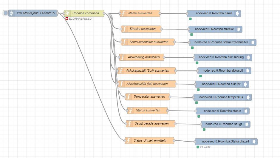

      Der dritte und letzte Flow ist der "Roomba Status". Hiermit wird zeitgesteuert (ich habe derzeit jede Minute eingestellt) der Status des Roomba abgefragt und in die entsprechenden Datenpunkte geschrieben.
      [{"id":"a5a2adf.f5a5d5","type":"inject","name":"Full Status jede 1 Minute","topic":"","payload":"","payloadType":"date","repeat":"60","crontab":"","once":true,"x":180,"y":62,"z":"7859072e.87a6f8","wires":[["504181f6.afbe8","182e191.fe7d1e7"]]},{"id":"504181f6.afbe8","type":"http request","name":"Roomba command","method":"GET","ret":"txt","url":"http://192.168.178.55/full_status.xml","x":408,"y":63,"z":"7859072e.87a6f8","wires":[["b7123aff.48edc8","3050ead5.cfaf16","6c22b045.93dd5","c8c15059.373eb","205772fb.dfa88e","bee92f3c.4116d","f8aef704.075108","a899536.f5766b","666e081d.9991f8"]]},{"id":"b7123aff.48edc8","type":"function","name":"Name auswerten","func":"var quelle = msg.payload;\n\nmsg1 = {};\n\nsuche = \"<name>\";\nsuche_laenge = (suche && suche.length);\n\n//  Suchwort \"suche\" finden \n// var daten_startpos = quelle.indexOf('cleaning_distance');\nvar daten_startpos = quelle.indexOf(suche);\nvar daten = quelle.substr(daten_startpos + suche_laenge, 50);\n\n\n// Finde \"<\" und merke dir die Position. Schneide aus von 0 bis Position\nvar daten_endpos = daten.indexOf('<');\ndaten = daten.substring(0, daten_endpos);\nmsg1.payload = daten; // String\n\nreturn [msg1];","outputs":"1","noerr":0,"x":658,"y":63,"z":"7859072e.87a6f8","wires":[["5f503576.a0afcc"]]},{"id":"5f503576.a0afcc","type":"ioBroker out","name":"","topic":"node-red.0.Roomba.name","ack":"false","autoCreate":"true","x":990,"y":64,"z":"7859072e.87a6f8","wires":[]},{"id":"3050ead5.cfaf16","type":"function","name":"Strecke auswerten","func":"var quelle = msg.payload;\n\nmsg1 = {};\n\nsuche = \"<cleaning_distance>\";\nsuche_laenge = (suche && suche.length);\n\n//  Suchwort \"suche\" finden \n// var daten_startpos = quelle.indexOf('cleaning_distance');\nvar daten_startpos = quelle.indexOf(suche);\nvar daten = quelle.substr(daten_startpos + suche_laenge, 50);\n\n\n// Finde \"<\" und merke dir die Position. Schneide aus von 0 bis Position\nvar daten_endpos = daten.indexOf('<');\ndaten = daten.substring(0, daten_endpos);\nmsg1.payload = daten; // String\n\nreturn [msg1];","outputs":"1","noerr":0,"x":664,"y":133,"z":"7859072e.87a6f8","wires":[["b475f945.4b8a08"]]},{"id":"b475f945.4b8a08","type":"ioBroker out","name":"","topic":"node-red.0.Roomba.strecke","ack":"false","autoCreate":"true","x":996,"y":134,"z":"7859072e.87a6f8","wires":[]},{"id":"6c22b045.93dd5","type":"function","name":"Schmutzbehälter auswerten","func":"var quelle = msg.payload;\n\nmsg1 = {};\n\nsuche = \"<bin_status>\";\nsuche_laenge = (suche && suche.length);\n\n//  Suchwort \"suche\" finden \n// var daten_startpos = quelle.indexOf('cleaning_distance');\nvar daten_startpos = quelle.indexOf(suche);\nvar daten = quelle.substr(daten_startpos + suche_laenge, 50);\n\n\n// Finde \"<\" und merke dir die Position. Schneide aus von 0 bis Position\nvar daten_endpos = daten.indexOf('<');\ndaten = daten.substring(0, daten_endpos);\nmsg1.payload = daten; // String\n\nreturn [msg1];","outputs":"1","noerr":0,"x":693,"y":191,"z":"7859072e.87a6f8","wires":[["11db5550.ee24ab"]]},{"id":"11db5550.ee24ab","type":"ioBroker out","name":"","topic":"node-red.0.Roomba.schmutzbehaelter","ack":"false","autoCreate":"true","x":1029,"y":193,"z":"7859072e.87a6f8","wires":[]},{"id":"c8c15059.373eb","type":"function","name":"Akkuladung auswerten","func":"var quelle = msg.payload;\n\nmsg1 = {};\n\nsuche = \"<battery_charge>\";\nsuche_laenge = (suche && suche.length);\n\n//  Suchwort \"suche\" finden \n// var daten_startpos = quelle.indexOf('cleaning_distance');\nvar daten_startpos = quelle.indexOf(suche);\nvar daten = quelle.substr(daten_startpos + suche_laenge, 50);\n\n\n// Finde \"<\" und merke dir die Position. Schneide aus von 0 bis Position\nvar daten_endpos = daten.indexOf('<');\ndaten = daten.substring(0, daten_endpos);\nmsg1.payload = daten; // String\n\nreturn [msg1];","outputs":"1","noerr":0,"x":666,"y":259,"z":"7859072e.87a6f8","wires":[["8c8c5798.7373a8"]]},{"id":"8c8c5798.7373a8","type":"ioBroker out","name":"","topic":"node-red.0.Roomba.akkuladung","ack":"false","autoCreate":"true","x":1030,"y":260,"z":"7859072e.87a6f8","wires":[]},{"id":"205772fb.dfa88e","type":"function","name":"Akkukapazität (Soll) auswerten","func":"var quelle = msg.payload;\n\nmsg1 = {};\n\nsuche = \"<capacity>\";\nsuche_laenge = (suche && suche.length);\n\n//  Suchwort \"suche\" finden \n// var daten_startpos = quelle.indexOf('cleaning_distance');\nvar daten_startpos = quelle.indexOf(suche);\nvar daten = quelle.substr(daten_startpos + suche_laenge, 50);\n\n\n// Finde \"<\" und merke dir die Position. Schneide aus von 0 bis Position\nvar daten_endpos = daten.indexOf('<');\ndaten = daten.substring(0, daten_endpos);\nmsg1.payload = daten; // String\n\nreturn [msg1];","outputs":"1","noerr":0,"x":688,"y":319,"z":"7859072e.87a6f8","wires":[["5c1179c1.a3ee88"]]},{"id":"5c1179c1.a3ee88","type":"ioBroker out","name":"","topic":"node-red.0.Roomba.akkusoll","ack":"false","autoCreate":"true","x":1036,"y":319,"z":"7859072e.87a6f8","wires":[]},{"id":"bee92f3c.4116d","type":"function","name":"Akkukapazität (Ist) auswerten","func":"var quelle = msg.payload;\n\nmsg1 = {};\n\nsuche = \"<charge>\";\nsuche_laenge = (suche && suche.length);\n\n//  Suchwort \"suche\" finden \n// var daten_startpos = quelle.indexOf('cleaning_distance');\nvar daten_startpos = quelle.indexOf(suche);\nvar daten = quelle.substr(daten_startpos + suche_laenge, 50);\n\n\n// Finde \"<\" und merke dir die Position. Schneide aus von 0 bis Position\nvar daten_endpos = daten.indexOf('<');\ndaten = daten.substring(0, daten_endpos);\nmsg1.payload = daten; // String\n\nreturn [msg1];","outputs":"1","noerr":0,"x":690,"y":378,"z":"7859072e.87a6f8","wires":[["334dc150.ccb23e"]]},{"id":"334dc150.ccb23e","type":"ioBroker out","name":"","topic":"node-red.0.Roomba.akkuist","ack":"false","autoCreate":"true","x":1026,"y":380,"z":"7859072e.87a6f8","wires":[]},{"id":"f8aef704.075108","type":"function","name":"Temperatur auswerten","func":"var quelle = msg.payload;\n\nmsg1 = {};\n\nsuche = \"<temperature>\";\nsuche_laenge = (suche && suche.length);\n\n//  Suchwort \"suche\" finden \n// var daten_startpos = quelle.indexOf('cleaning_distance');\nvar daten_startpos = quelle.indexOf(suche);\nvar daten = quelle.substr(daten_startpos + suche_laenge, 50);\n\n\n// Finde \"<\" und merke dir die Position. Schneide aus von 0 bis Position\nvar daten_endpos = daten.indexOf('<');\ndaten = daten.substring(0, daten_endpos);\nmsg1.payload = daten; // String\n\nreturn [msg1];","outputs":"1","noerr":0,"x":692,"y":436,"z":"7859072e.87a6f8","wires":[["2712b369.d8ed4c"]]},{"id":"2712b369.d8ed4c","type":"ioBroker out","name":"","topic":"node-red.0.Roomba.temperatur","ack":"false","autoCreate":"true","x":1028,"y":438,"z":"7859072e.87a6f8","wires":[]},{"id":"a899536.f5766b","type":"function","name":"Status auswerten","func":"var quelle = msg.payload;\n\nmsg1 = {};\n\nsuche = \"<cleaner_state>\";\nsuche_laenge = (suche && suche.length);\n\n//  Suchwort \"suche\" finden \n// var daten_startpos = quelle.indexOf('cleaning_distance');\nvar daten_startpos = quelle.indexOf(suche);\nvar daten = quelle.substr(daten_startpos + suche_laenge, 50);\n\n\n// Finde \"<\" und merke dir die Position. Schneide aus von 0 bis Position\nvar daten_endpos = daten.indexOf('<');\ndaten = daten.substring(0, daten_endpos);\n\nif (daten == \"st_base\"){\n    daten = \"Auf Basis, nicht ladend\";\n}\n\nif (daten == \"st_base_recon\"){\n    daten = \"Auf Basis, Auffrischungsladung\";\n}\n\nif (daten == \"st_base_full\"){\n    daten = \"Auf Basis, normal aufladend\";\n}\n\nif (daten == \"st_base_trickle\"){\n    daten = \"Auf Basis, Erhaltungsladung\";\n}\n\nif (daten == \"st_base_wait\"){\n    daten = \"Auf Basis, wartend\";\n}\n\nif (daten == \"st_plug\"){\n    daten = \"Eingesteckt, nicht ladend\";\n}\n\nif (daten == \"st_plug_recon\"){\n    daten = \"Eingesteckt, Auffrischungsladung\";\n}\n\nif (daten == \"st_plug_full\"){\n    daten = \"Eingesteckt, normal aufladend\";\n}\n\nif (daten == \"st_plug_trickle\"){\n    daten = \"Eingesteckt, Erhaltungsladung\";\n}\n\nif (daten == \"st_plug_wait\"){\n    daten = \"Eingesteckt, wartend\";\n}\n\nif (daten == \"st_stopped\"){\n    daten = \"Angehalten\";\n}\n\nif (daten == \"st_clean\"){\n    daten = \"Reinigung läuft\";\n}\n\nif (daten == \"st_cleanstop\"){\n    daten = \"Reinigung gestoppt\";\n}\n\nif (daten == \"st_clean_spot\"){\n    daten = \"Spot-Reinigung\";\n}\n\nif (daten == \"st_clean_max\"){\n    daten = \"Max-Reinigung\";\n}\n\nif (daten == \"st_delayed\"){\n    daten = \"Reinigung verzögert, startet gleich\";\n}\n\nif (daten == \"st_dock\"){\n    daten = \"Suche Basis\";\n}\n\nif (daten == \"st_pickup\"){\n    daten = \"Roomba hochgehoben\";\n}\n\nif (daten == \"st_remote\"){\n    daten = \"Ferngesteuertes fahren\";\n}\n\nif (daten == \"st_wait\"){\n    daten = \"Warte auf Befehle\";\n}\n\nif (daten == \"st_off\"){\n    daten = \"Aus\";\n}\n\nif (daten == \"st_error\"){\n    daten = \"Fehler\";\n}\n\nif (daten == \"st_locate\"){\n    daten = \"Finde mich\";\n}\n\nif (daten == \"st_unknown\"){\n    daten = \"Status unbekannt\";\n}\n\n\nmsg1.payload = daten; // String\n\nreturn [msg1];","outputs":"1","noerr":0,"x":692,"y":497,"z":"7859072e.87a6f8","wires":[["f6e00de3.091ff"]]},{"id":"f6e00de3.091ff","type":"ioBroker out","name":"","topic":"node-red.0.Roomba.status","ack":"false","autoCreate":"true","x":1028,"y":499,"z":"7859072e.87a6f8","wires":[]},{"id":"666e081d.9991f8","type":"function","name":"Saugt gerade auswerten","func":"var quelle = msg.payload;\n\nmsg1 = {};\n\nsuche = \"<cleaning>\";\nsuche_laenge = (suche && suche.length);\n\n//  Suchwort \"suche\" finden \n// var daten_startpos = quelle.indexOf('cleaning_distance');\nvar daten_startpos = quelle.indexOf(suche);\nvar daten = quelle.substr(daten_startpos + suche_laenge, 50);\n\n// Finde \"<\" und merke dir die Position. Schneide aus von 0 bis Position\nvar daten_endpos = daten.indexOf('<');\ndaten = daten.substring(0, daten_endpos);\nmsg1.payload = daten; // String\n\nreturn [msg1];","outputs":"1","noerr":0,"x":706,"y":556,"z":"7859072e.87a6f8","wires":[["c7157fc8.38ea8"]]},{"id":"c7157fc8.38ea8","type":"ioBroker out","name":"","topic":"node-red.0.Roomba.saugt","ack":"false","autoCreate":"true","x":1042,"y":558,"z":"7859072e.87a6f8","wires":[]},{"id":"182e191.fe7d1e7","type":"function","name":"Status-Uhrzeit ermitteln","func":"msg = {};\n\n\nfunction addZero(i) {\n    if (i < 10) {\n        i = \"0\" + i;\n    }\n    return i;\n}\n\n\nvar currentdate = new Date(); \nvar h = addZero(currentdate.getHours());\nvar m = addZero(currentdate.getMinutes());\nvar s = addZero(currentdate.getSeconds());\n\n\nvar datetime = h + \":\" + m + \":\" + s;\n\nmsg.payload = datetime;\nreturn msg;\n","outputs":1,"noerr":0,"x":701,"y":631,"z":"7859072e.87a6f8","wires":[["57efa4f2.a8105c"]]},{"id":"57efa4f2.a8105c","type":"ioBroker out","name":"","topic":"node-red.0.Roomba.Statusuhrzeit","ack":"false","autoCreate":"true","x":1044,"y":636,"z":"7859072e.87a6f8","wires":[]}]</cleaning></cleaner_state></temperature></charge></capacity></battery_charge></bin_status></cleaning_distance></name>
      Auch hier muss UNBEDINGT im Aufruf "Roomba command" die IP-Adresse des Roomba eingetragen werden.
      Folgende Datenpunkte stehen zur Verfügung:
      node-red.0.Roomba.name => Der vergebene Name der Roomba
      node-red.0.Roomba.strecke => Gefahrene Strecke
      node-red.0.Roomba.schmutzbehaelter => Schmutzbehälter voll
      node-red.0.Roomba.akkuladung => Akkuladung in Prozent
      node-red.0.Roomba.akkusoll => Akkuleistung (Soll-Wert, ausgelesen) im mA
      node-red.0.Roomba.akkuist => Akkuleistung (Ist-Wert, gemessen) im mA
      node-red.0.Roomba.temperatur => Temperatur im Roomba
      node-red.0.Roomba.status => Status des Roomba (in Klartext)
      node-red.0.Roomba.saugt => Soll angeben, ob der Roomba gerade saugt (funktioniert aber irgendwie nicht, stattdessen besser den Datenpunkt "node-red.0.Roomba.status" benutzen)
      node-red.0.Roomba.Statusuhrzeit => Uhrzeit der Statusabfrage

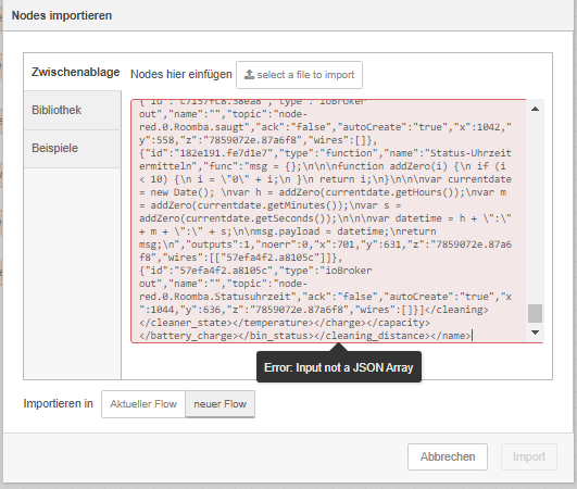

                                          Hallo @eric2905,
                                          beim Importieren des Roomba Status Flows in NodeRed kommt bei mir folgende Fehlermeldung:
                                          Was mache ich da falsch? Wo liegt der Fehler?
                                          EDIT:
                                          Es darf
                                          nicht enthalten sein.
                                          Ein Problem habe ich aber trotzdem noch.

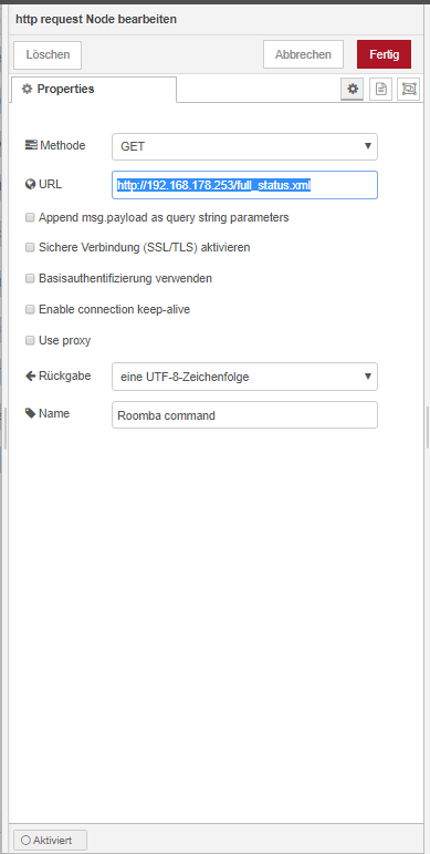

                                          Ich habe wie beschrieben unter "Roomba command" meine IP Adresse des Saugroboters eingetragen, aber nach dem Deployen bekommt Node Red keine Verbindung. (siehe Bild) So wie es aussieht ist diese Verbindung nicht möglich.
                                          Der Aufruf dieses Links http://192.168.178.253/full_status.xml ist nicht möglich.
                                          Im Log steht folgende Fehlermeldung:
                                          node-red.0	2020-02-22 21:45:41.561	error	at TCPConnectWrap.afterConnect [as oncomplete] (net.js:1107:14)
                                          node-red.0	2020-02-22 21:45:41.561	error	(2903) 22 Feb 21:45:41 - [error] [http request:Roomba command] Error: connect ECONNREFUSED 192.168.178.253:80
                                          node-red.0	2020-02-22 21:44:41.552	error	at TCPConnectWrap.afterConnect [as oncomplete] (net.js:1107:14)
                                          node-red.0	2020-02-22 21:44:41.552	error	(2903) 22 Feb 21:44:41 - [error] [http request:Roomba command] Error: connect ECONNREFUSED 192.168.178.253:80
                                          node-red.0	2020-02-22 21:43:41.581	error	at TCPConnectWrap.afterConnect [as oncomplete] (net.js:1107:14)
                                          node-red.0	2020-02-22 21:43:41.581	error	(2903) 22 Feb 21:43:41 - [error] [http request:Roomba command] Error: connect ECONNREFUSED 192.168.178.253:80
                                          node-red.0	2020-02-22 21:42:41.561	error	at TCPConnectWrap.afterConnect [as oncomplete] (net.js:1107:14)
                                          node-red.0	2020-02-22 21:42:41.561	error	(2903) 22 Feb 21:42:41 - [error] [http request:Roomba command] Error: connect ECONNREFUSED 192.168.178.253:80
                                          node-red.0	2020-02-22 21:41:41.576	error	at TCPConnectWrap.afterConnect [as oncomplete] (net.js:1107:14)
                                          node-red.0	2020-02-22 21:41:41.576	error	(2903) 22 Feb 21:41:41 - [error] [http request:Roomba command] Error: connect ECONNREFUSED 192.168.178.253:80
                                          node-red.0	2020-02-22 21:41:12.308	error	at TCPConnectWrap.afterConnect [as oncomplete] (net.js:1107:14)
                                          node-red.0	2020-02-22 21:41:12.308	error	(2903) 22 Feb 21:41:12 - [error] [http request:Roomba command] Error: connect ECONNREFUSED 192.168.178.253:80
                                          node-red.0	2020-02-22 21:41:12.138	error	at TCPConnectWrap.afterConnect [as oncomplete] (net.js:1107:14)
                                          node-red.0	2020-02-22 21:41:12.138	error	(2903) 22 Feb 21:41:12 - [error] [http request:Roomba command] Error: connect ECONNREFUSED 192.168.178.253:80
                                          node-red.0	2020-02-22 21:40:12.307	error	at TCPConnectWrap.afterConnect [as oncomplete] (net.js:1107:14)
                                          node-red.0	2020-02-22 21:40:12.307	error	(2903) 22 Feb 21:40:12 - [error] [http request:Roomba command] Error: connect ECONNREFUSED 192.168.178.253:80
                                          node-red.0	2020-02-22 21:40:12.160	error	at TCPConnectWrap.afterConnect [as oncomplete] (net.js:1107:14)
                                          node-red.0	2020-02-22 21:40:12.160	error	(2903) 22 Feb 21:40:12 - [error] [http request:Roomba command] Error: connect ECONNREFUSED 192.168.178.253:80
                                          node-red.0	2020-02-22 21:39:12.353	error	at TCPConnectWrap.afterConnect [as oncomplete] (net.js:1107:14)
                                          node-red.0	2020-02-22 21:39:12.353	error	(2903) 22 Feb 21:39:12 - [error] [http request:Roomba command] Error: connect ECONNREFUSED 192.168.178.253:80
                                          node-red.0	2020-02-22 21:39:12.324	error	at TCPConnectWrap.afterConnect [as oncomplete] (net.js:1107:14)
                                          node-red.0	2020-02-22 21:39:12.324	error	(2903) 22 Feb 21:39:12 - [error] [http request:Roomba command] Error: connect ECONNREFUSED 192.168.178.253:80
                                          Was ist da falsch? Was muss ich da machen?
