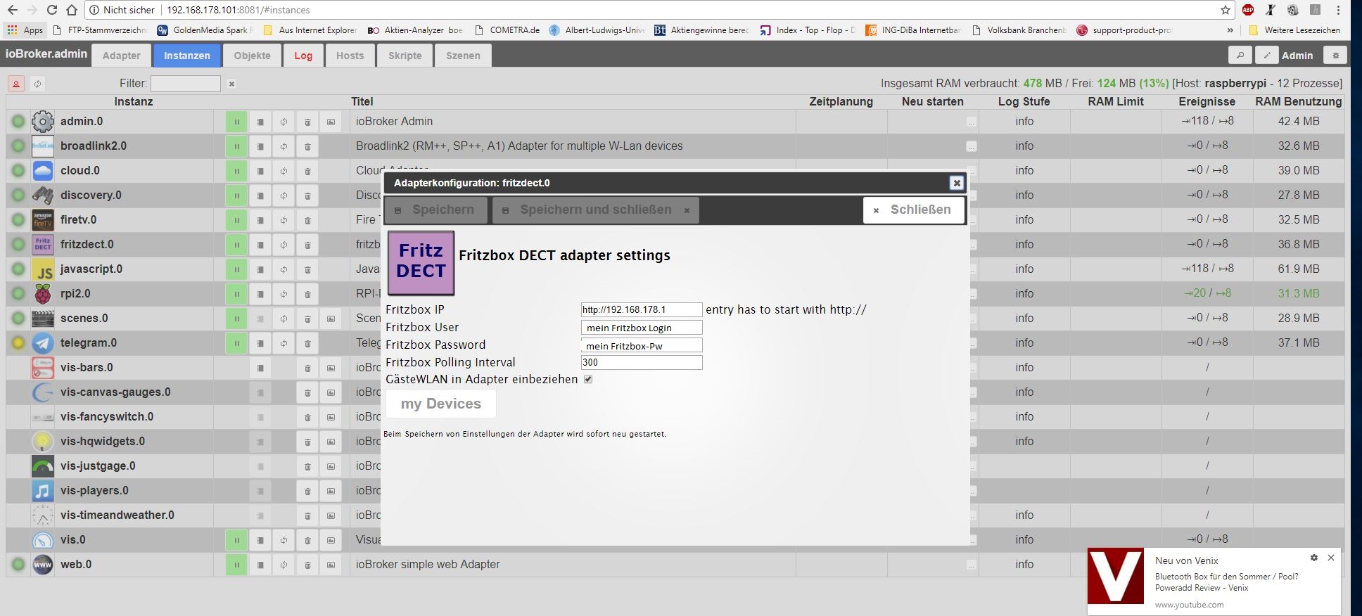

            @ Eric:
            Hier noch das Log (ich hoffe mal, ich habe das Richtige kopiert):
            fritzdect.0 2018-03-19 10:31:53.259 error error calling the fritzbox {"error":null,"response":{"statusCode":503,"body":"
            503 Service Unavailable
            ! ERR_NO
            fritzdect.0 2018-03-19 10:31:53.258 error statuscode not in errorhandler
            fritzdect.0 2018-03-19 10:31:53.255 error error calling the fritzbox {"error":null,"response":{"statusCode":503,"body":"
            ! ERR_NO
            fritzdect.0 2018-03-19 10:31:53.254 error statuscode not in errorhandler
            fritzdect.0 2018-03-19 10:26:53.222 error error calling the fritzbox {"error":null,"response":{"statusCode":503,"body":"
            ! ERR_NO
            fritzdect.0 2018-03-19 10:26:53.222 error statuscode not in errorhandler
            fritzdect.0 2018-03-19 10:26:53.218 error error calling the fritzbox {"error":null,"response":{"statusCode":503,"body":"
            ! ERR_NO
            fritzdect.0 2018-03-19 10:26:53.217 error statuscode not in errorhandler
            web.0 2018-03-19 10:26:11.732 info 2018-03-19T09:26:11.732Z Connected system.user.admin
            fritzdect.0 2018-03-19 10:21:53.209 error error calling the fritzbox {"error":null,"response":{"statusCode":503,"body":"
            ! ERR_NO
            fritzdect.0 2018-03-19 10:21:53.208 error statuscode not in errorhandler
            fritzdect.0 2018-03-19 10:16:53.216 error error calling the fritzbox {"error":null,"response":{"statusCode":503,"body":"
            ! ERR_NO
            fritzdect.0 2018-03-19 10:16:53.215 error statuscode not in errorhandler
            fritzdect.0 2018-03-19 10:16:53.207 error error calling the fritzbox {"error":null,"response":{"statusCode":503,"body":"
            ! ERR_NO
            fritzdect.0 2018-03-19 10:16:53.206 error statuscode not in errorhandler
            broadlink2.0 2018-03-19 10:13:03.894 warn Device RM:Broadlink-RMPROSUB-8e-fb-32 not reachable
            fritzdect.0 2018-03-19 10:11:53.190 error error calling the fritzbox {"error":null,"response":{"statusCode":503,"body":"
            ! ERR_NO
            fritzdect.0 2018-03-19 10:11:53.189 error statuscode not in errorhandler
            fritzdect.0 2018-03-19 10:06:53.236 error error calling the fritzbox {"error":null,"response":{"statusCode":503,"body":"
            ! ERR_NO
            fritzdect.0 2018-03-19 10:06:53.235 error statuscode not in errorhandler
            fritzdect.0 2018-03-19 10:06:53.231 error error calling the fritzbox {"error":null,"response":{"statusCode":503,"body":"
            ! ERR_NO
            fritzdect.0 2018-03-19 10:06:53.229 error statuscode not in errorhandler
            fritzdect.0 2018-03-19 10:01:53.186 error error calling the fritzbox {"error":null,"response":{"statusCode":503,"body":"
            ! ERR_NO
            fritzdect.0 2018-03-19 10:01:53.185 error statuscode not in errorhandler
            fritzdect.0 2018-03-19 10:01:53.183 error error calling the fritzbox {"error":null,"response":{"statusCode":503,"body":"
            ! ERR_NO
            fritzdect.0 2018-03-19 10:01:53.182 error statuscode not in errorhandler
            fritzdect.0 2018-03-19 09:56:53.186 error error calling the fritzbox {"error":null,"response":{"statusCode":503,"body":"
            ! ERR_NO
            fritzdect.0 2018-03-19 09:56:53.185 error statuscode not in errorhandler

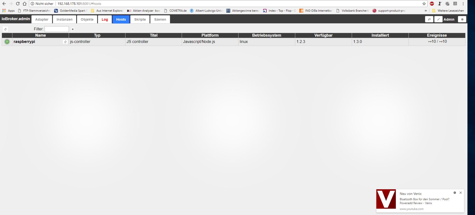

                    @P-A-L-A-D-I-N:
                    js-controller (host): Gibt es bei mir irgendwie nicht `
                    Di Version des js-controllers findest du im Reiter Hosts
                    Rainer

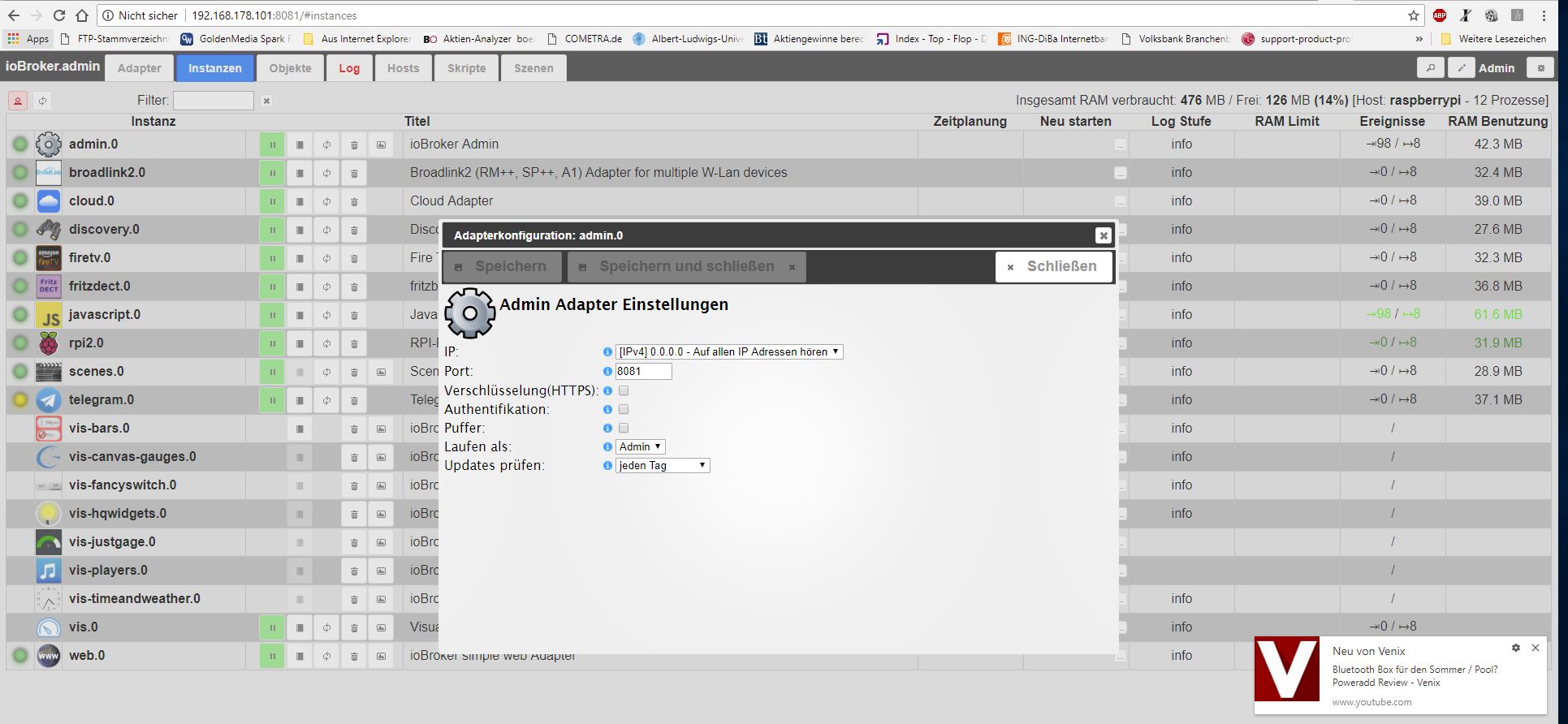

                        Danke für die Anleitung zu den Hosts! Ich habe den Reiter jetzt einblenden können und auch "js-controller" dort gefunden. Verfügbar 1.2.3, installiert ist 1.3.0.
                        Beim Versuch, alle Adapter zu aktualisieren ("alle Adapter upgraden", viertes Icon von links), werden anscheinend teilweise Fehlermeldungen ausgespuckt. Auch wenn ich es von Hand mache, kommen bisweilen Meldungen mit "ERR" (= error, oder?). Allerdings steht hinter allen Adaptern die aktuellste Version bzw. es fehlt das Icon zum aktualisieren, sodaß ich davon ausgehe, daß ich überall die neueste Version installiert habe.
                        Wenn ich die Befehle in die Konsole des Pi eingebe, wird folgendes angezeigt:
                        node -v: 6.13.1
                        npm-v: 3.10.10
                        Screenshots folgen!

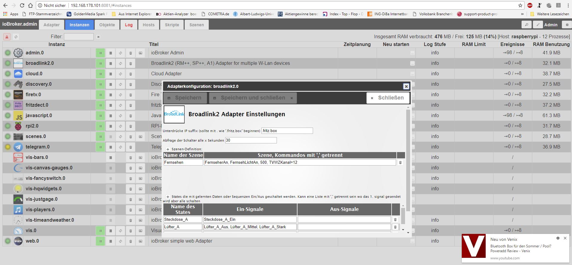

                          P-A-L-A-D-I-N last edited by
                          Hier noch die Screenshots!
