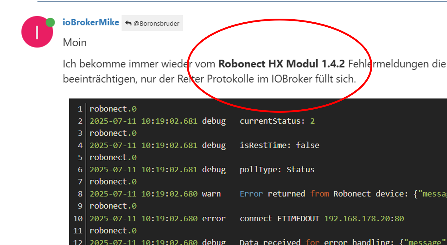

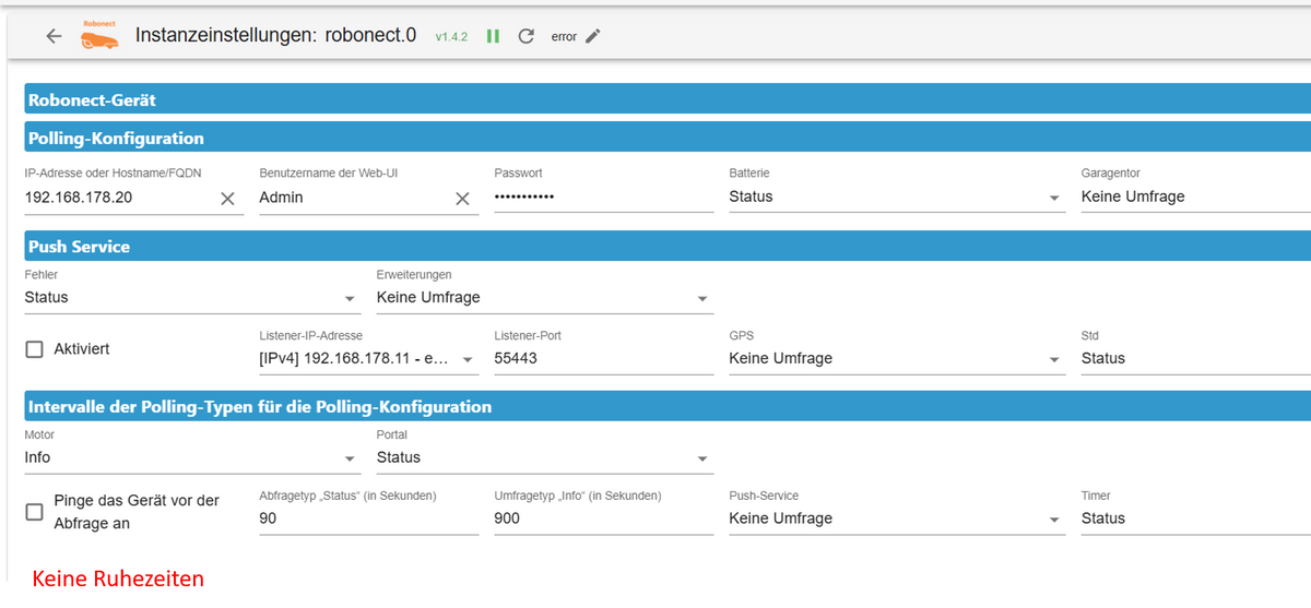

Ich bekomme immer wieder vom Robonect HX Modul 1.4.2 Fehlermeldungen die aber die Funktion nicht beeinträchtigen, nur der Reiter Protokolle im IOBroker füllt sich.
robonect.0 2025-07-11 10:19:02.681 debug currentStatus: 2 robonect.0 2025-07-11 10:19:02.681 debug isRestTime: false robonect.0 2025-07-11 10:19:02.681 debug pollType: Status robonect.0 2025-07-11 10:19:02.680 warn Error returned from Robonect device: {"message":"connect ETIMEDOUT 192.168.178.20:80","name":"Error","stack":"Error: connect ETIMEDOUT 192.168.178.20:80\n at Function.AxiosError.from (/opt/iobroker/node_modules/axios/lib/core/AxiosError.js:92:14)\n at RedirectableRequest.handleRequestError (/opt/iobroker/node_modules/axios/lib/adapters/http.js:620:25)\n at RedirectableRequest.emit (node:events:524:28)\n at RedirectableRequest.emit (node:domain:489:12)\n at ClientRequest.eventHandlers.<computed> (/opt/iobroker/node_modules/follow-redirects/index.js:38:24)\n at ClientRequest.emit (node:events:536:35)\n at ClientRequest.emit (node:domain:489:12)\n at emitErrorEvent (node:_http_client:101:11)\n at Socket.socketErrorListener (node:_http_client:504:5)\n at Socket.emit (node:events:524:28)\n at Axios.request (/opt/iobroker/node_modules/axios/lib/core/Axios.js:45:41)\n at processTicksAndRejections (node:internal/process/task_queues:95:5)","config":{"transitional":{"silentJSONParsing":true,"forcedJSONParsing":true,"clarifyTimeoutError":false},"adapter":["xhr","http","fetch"],"transformRequest":[null],"transformResponse":[null],"timeout":0,"xsrfCookieName":"XSRF-TOKEN","xsrfHeaderName":"X-XSRF-TOKEN","maxContentLength":-1,"maxBodyLength":-1,"env":{},"headers":{"Accept":"application/json, text/plain, */*","User-Agent":"axios/1.10.0","Accept-Encoding":"gzip, compress, deflate, br"},"auth":{"username":"xxxxx","password":"yyyyy"},"params":{"cmd":"status"},"method":"get","url":"http://192.168.178.20/api/json","allowAbsoluteUrls":true},"code":"ETIMEDOUT"} robonect.0 2025-07-11 10:19:02.680 error connect ETIMEDOUT 192.168.178.20:80 robonect.0 2025-07-11 10:19:02.680 debug Data received for error handling: {"message":"connect ETIMEDOUT 192.168.178.20:80","name":"Error","stack":"Error: connect ETIMEDOUT 192.168.178.20:80\n at Function.AxiosError.from (/opt/iobroker/node_modules/axios/lib/core/AxiosError.js:92:14)\n at RedirectableRequest.handleRequestError (/opt/iobroker/node_modules/axios/lib/adapters/http.js:620:25)\n at RedirectableRequest.emit (node:events:524:28)\n at RedirectableRequest.emit (node:domain:489:12)\n at ClientRequest.eventHandlers.<computed> (/opt/iobroker/node_modules/follow-redirects/index.js:38:24)\n at ClientRequest.emit (node:events:536:35)\n at ClientRequest.emit (node:domain:489:12)\n at emitErrorEvent (node:_http_client:101:11)\n at Socket.socketErrorListener (node:_http_client:504:5)\n at Socket.emit (node:events:524:28)\n at Axios.request (/opt/iobroker/node_modules/axios/lib/core/Axios.js:45:41)\n at processTicksAndRejections (node:internal/process/task_queues:95:5)","config":{"transitional":{"silentJSONParsing":true,"forcedJSONParsing":true,"clarifyTimeoutError":false},"adapter":["xhr","http","fetch"],"transformRequest":[null],"transformResponse":[null],"timeout":0,"xsrfCookieName":"XSRF-TOKEN","xsrfHeaderName":"X-XSRF-TOKEN","maxContentLength":-1,"maxBodyLength":-1,"env":{},"headers":{"Accept":"application/json, text/plain, */*","User-Agent":"axios/1.10.0","Accept-Encoding":"gzip, compress, deflate, br"},"auth":{"username":"xxxxx","password":"yyyyy"},"params":{"cmd":"status"},"method":"get","url":"http://192.168.178.20/api/json","allowAbsoluteUrls":true},"code":"ETIMEDOUT"} robonect.0 2025-07-11 10:18:23.383 debug Polling API for data [{"cmd":"status"}] started

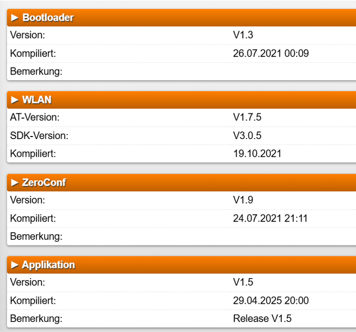

Habe ein Update der Application von 1.3b auf 1.5 gemacht.
Bei beiden Version war es dasselbe. -

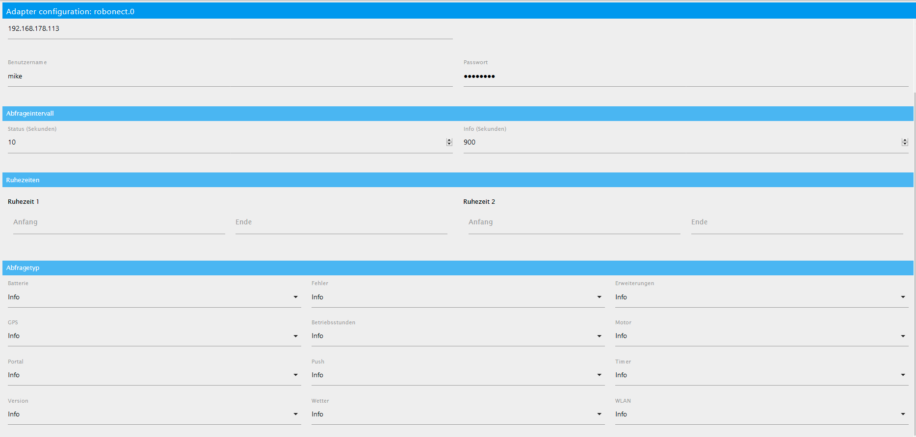

Hast du den Robonect-Adapter auf "DEBUG" laufen?

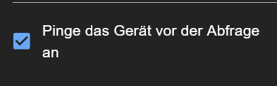

Bei mir kommen nur hin und wieder mal Warnungen, dass kein Ping möglich war:2025-07-11 07:29:26.818 - warn: robonect.0 (1998307) No connection to lawn mower (Not able to ping it). Check network connection.
Moin
Entschuldige erst ein mal.
Dieser Beitrag sollte an @braindead gehen.... Hast du den Robonect-Adapter auf "DEBUG" laufen?
Nur während der Ursachenfindung, ansonsten auf Error.PS. Habe den WLAN Teil vom Rebonect HX auch nochmal von 1.7.5 auf 1.7.6 Upgedatet.
Mal sehen was Montag geschied wenn der Robi wieder ran muss. -
