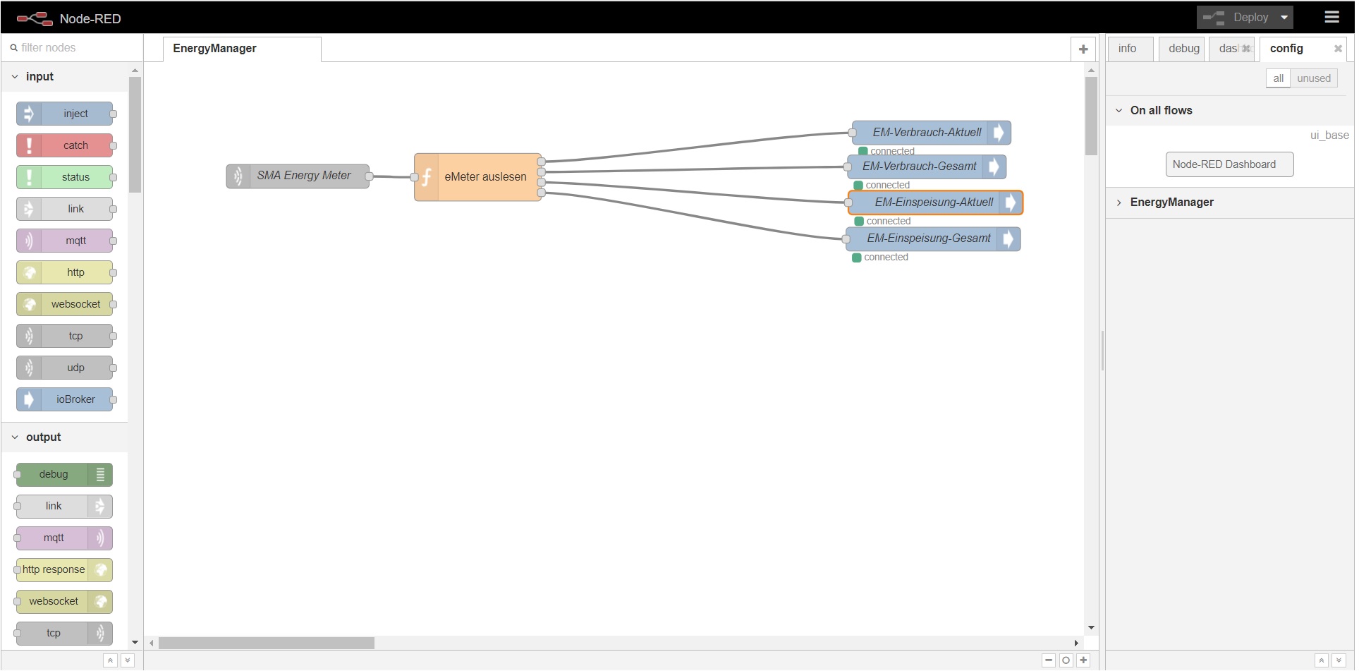

      Hallo Werte Gemeinde,
      hier kommt von mir ein Node-Red-Flow für den Energy Meter. Dieser empfängt und übergibt die Daten an die Homematic CCU2.
      [{"id":"92bd2097.3853a8","type":"udp in","name":"SMA Energy Meter","iface":"","port":"9522","ipv":"udp4","multicast":"true","group":"239.12.255.254","datatype":"buffer","x":92.88333129882812,"y":305.8833312988281,"z":"851687cc.dd6d58","wires":[["66eba2d2.54f614"]]},{"id":"66eba2d2.54f614","type":"function","name":"eMeter auslesen","func":"// Script von Marco Jäger\n// Aktueller Verbrauch\nvar eMeter = msg.payload;\nvar AktVerbrauch = {};\nmsg = {};\nvar deco = eMeter.toString('hex');\nAktVerbrauch=deco.substr(64,8);\nAktVerbrauch=parseInt(AktVerbrauch,16)/10;\nmsg.payload = AktVerbrauch;\n// Gesamtverbrauch\nvar GesVerbrauch = {};\nmsg2 = {};\nGesVerbrauch=deco.substr(80,16);\nGesVerbrauch=parseInt(GesVerbrauch,16)/3600000;\nmsg2.payload = GesVerbrauch;\n// Aktuelle Einspeisung\nvar AktEin = {};\nmsg3 = {};\nAktEin=deco.substr(104,8);\nAktEin=parseInt(AktEin,16)/10;\nmsg3.payload = AktEin;\n// Gesamt Einspeisung\nvar GesEin = {};\nmsg4 = {};\nGesEin=deco.substr(120,16);\nGesEin=parseInt(GesEin,16)/3600000;\nmsg4.payload = GesEin;\nreturn [msg,msg2,msg3,msg4]","outputs":"4","noerr":0,"x":319.8833312988281,"y":306.8833312988281,"z":"851687cc.dd6d58","wires":[["83a55ab8.2d3c8"],["2686c4be.822e94"],["276e6767.d6d4e"],["902fe131.3a4cc8"]]},{"id":"83a55ab8.2d3c8","type":"ioBroker out","name":"Aktueller Verbrauch","topic":"hm-rega.0.7456","ack":"true","autoCreate":"false","x":881.88330078125,"y":250.88333129882812,"z":"851687cc.dd6d58","wires":[]},{"id":"2686c4be.822e94","type":"ioBroker out","name":"Gesamtverbrauch","topic":"hm-rega.0.7457","ack":"true","autoCreate":"false","x":875.88330078125,"y":293.8833312988281,"z":"851687cc.dd6d58","wires":[]},{"id":"276e6767.d6d4e","type":"ioBroker out","name":"Aktuelle Einspeisung","topic":"hm-rega.0.7458","ack":"true","autoCreate":"false","x":886.88330078125,"y":338.8833312988281,"z":"851687cc.dd6d58","wires":[]},{"id":"902fe131.3a4cc8","type":"ioBroker out","name":"Gesamteinspeisung","topic":"hm-rega.0.7459","ack":"true","autoCreate":"false","x":883.88330078125,"y":384.8833312988281,"z":"851687cc.dd6d58","wires":[]}]
      Viel Spaß.

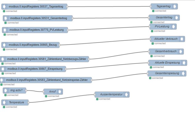

              kann der Wechselrichter ModBus? Dann könntest du dir über den ModBus Adapter alle Daten ziehen. Bei mir kommuniziert der EnergyMeter mit dem Wechselrichter. Dadurch habe ich mir das mit dem NodeRed gespart.
              Gruß Marco

                    der Wechselrichter holt sich sowieso die Daten vom EnergyMeter. Ich habe vor der ModBus-Lösung die Daten auch separat geholt. Kann ja auch jeder machen wir er es mag. 😉 🙂
                    Ich mag es immer am liebsten komplett.
                    Gruß Marco

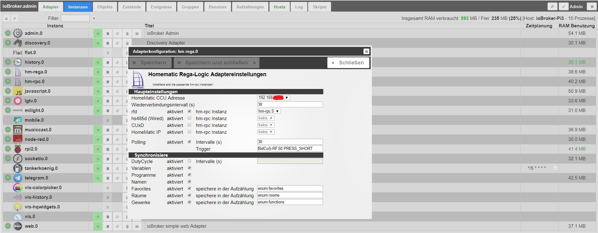

                      Hallo

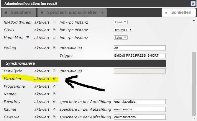

                      das ist ja toll leider sehe ich die Werte im IoBroker doch leider erfolgt kein Eintrag in der CCU2. Welche Systemvariable hast du genommen?
                      HM-REGA liest alle Daten aus der CCU2 aus doch anscheinend werden keine gesendet.

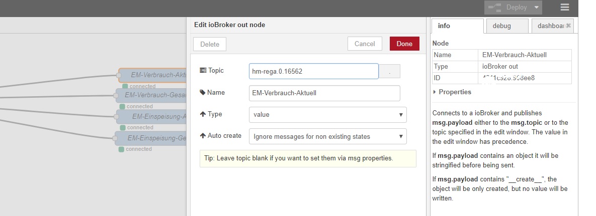

                            Marcolotti last edited by
                            Hi Wobo,
                            ich habe via Node-Red die Werte von Iobroker mit den Werten in der CCU2 verknüpft.
                            Siehe Bild:

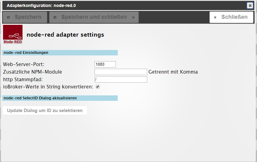

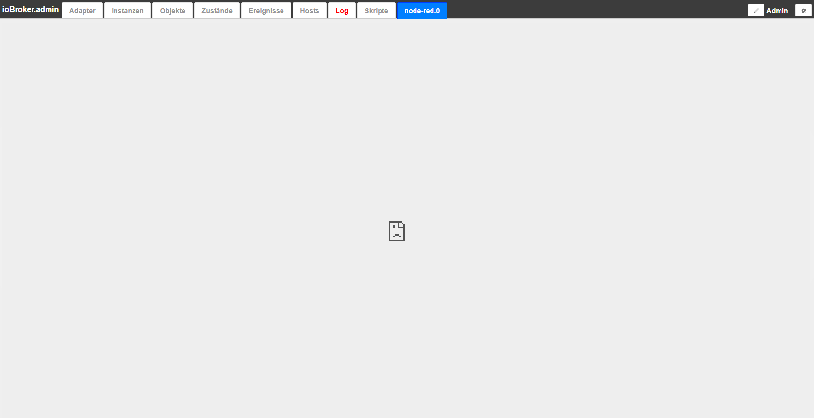

                              Ich habe den node red adapter in iobroker installiert und dann stehe ich auch schon an … 🙂
                              Muss ich etwas konfigurieren ? Wo muss ich dein Script reinkopieren ?
                              Was ist mit http Stammpfad gemeint ? Was mit zusätzliche NPM Module ?
                              Wenn ich den Reiter node-red.0 öffne, dann erscheint nur der weinende Smiley (keine Seite verfügbar)

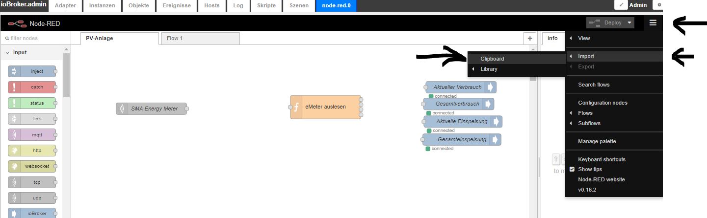

                                Hallo Qlink,
                                ich gehe mal davon aus, dass du bereits über Adapter Node-Red installiert hast. Der weinende Smilie kommt bei mir auch immer, wenn die Node-Red Instanz noch nicht fertig gestartet ist oder man mal die Reiter wechselt. Konfigurieren musst du da eigentlich nichts mehr.
                                Danach gehst du rechts auf das Menüsymbol -> Import -> Clipboard und kopierst das Script hinein.
                                Danach sollte sich alles aufbauen. Beim Doppelklick auf die blauen Felder z.B. Verbrauch kannst du festlegen, mit welchem Objekt du es verknüpfen willst. Kannst dir also auch selber welche anlegen unter Objekte und diese dann verknüpfen.
                                Danach bitte auf Deploy gehen und losgehts schon.
                                Gruß Marco

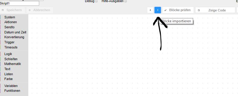

                                            Hallo Qlink,
                                            daher wird der Wert ja erst mit 100 Multipliziert -> gerundet (er rundet nur auf ganze Zahlen) und danach durch 100 subtrahiert.
                                            Ich habe bei mir nochmal nachgesehen, wie es Blockly macht:
                                            Vorher musst du noch deine Umrechnung auf kW machen.
                                            Math.ceil(100 * getState("javascript.0.PV_Anlage.StromkostenanzeigeMonat").val/1000) / 100
                                            Für sowas ist Blockly wirklich wunderbar.
