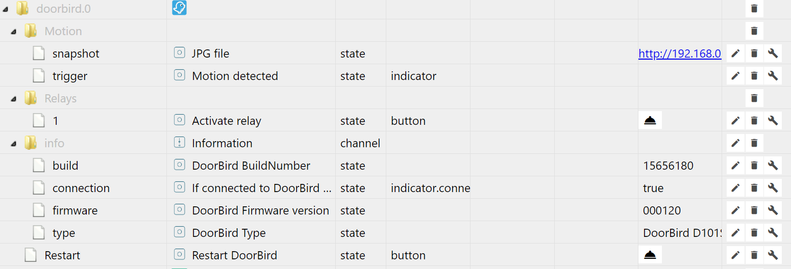

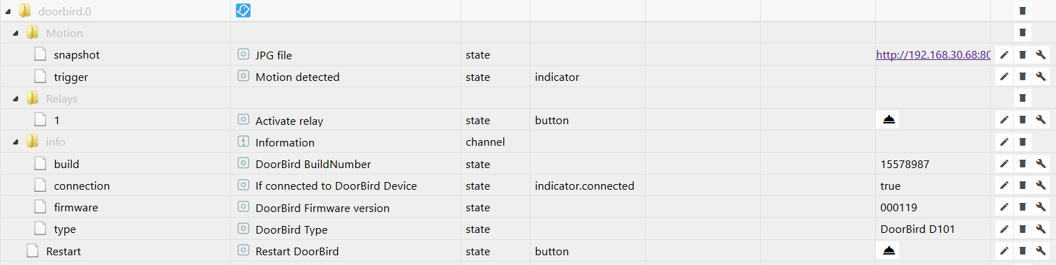

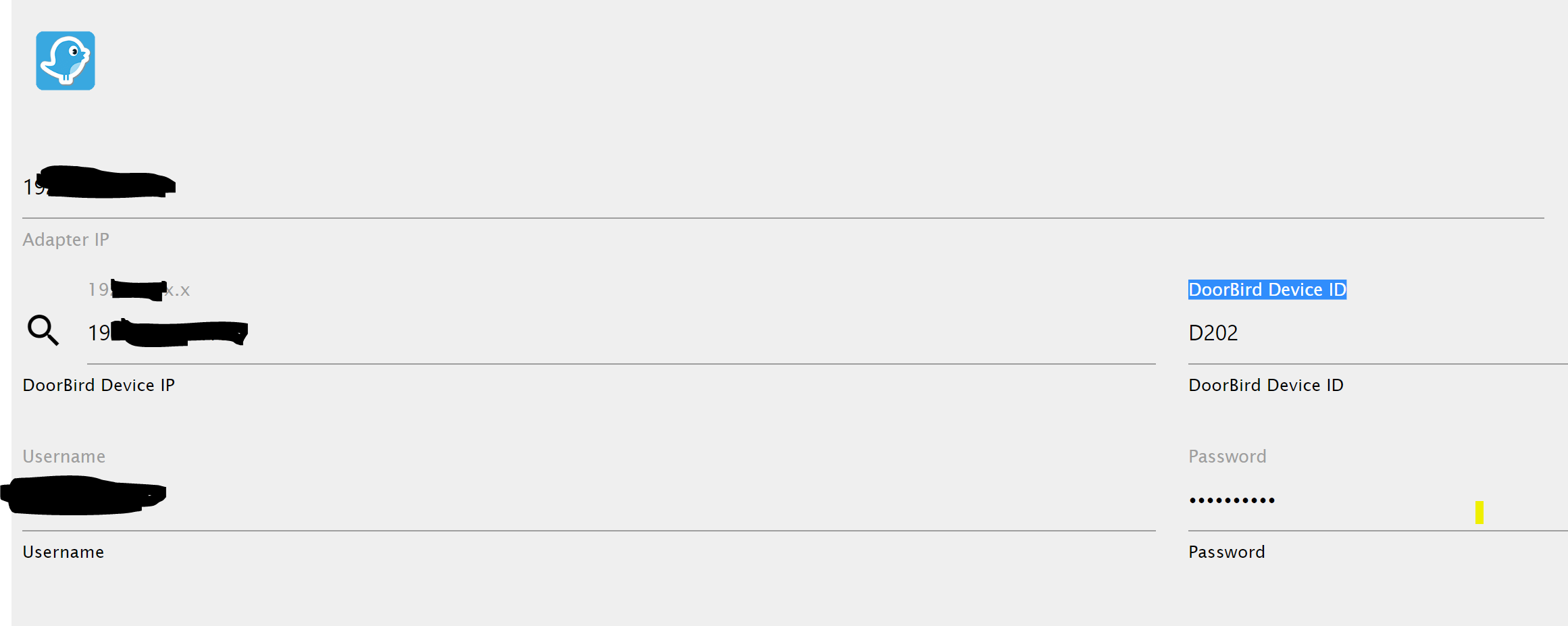

          Hello,
          I'm from Belgium, my German isn't good (at all) so excuse me for replying in English. I have the same issue as someone above...
          Doorbird-instance is created, user settings and the app are correct, everything shows up except for the RING folder
          What am I doing wrong? 🙂
          Thanks in advance!
          Kind regards,
          Jan

            zahnheinrich @Jan Geurts last edited by
            @Jan-Geurts
            I think it's not a problem of iobroker but a problem of a missing http command for ring inside your doorbird settings.

              Jan Geurts @zahnheinrich last edited by
              @zahnheinrich
              I've tried lots of things. Reinstalling the Doorbird-adapter, recreating the instance, reloading the instance, restarting ioBroker. Even when the instance is recreated, it creates the doorbird.0 with the same objects as before: Motion, Relays and info.
              I've tried - as suggested by someone else in this thread - to delete the HTTP(S) calls in the DoorBird administration section and then re-adding the doorbird, nothing changes. So it keeps showing everything except the ring folder (with trigger and snapshot).
              I've tried manually creating a HTTP-call for the ring that points to the object in ioBroker, but that doesn't magically make it show up there...
              I'm quite stuck 😲

                @zahnheinrich
                I have tried the same on a Windows-install of ioBroker and now I noticed what happens in the logs when adding a Doorbird-instance:

                There is no ring object created when creating the instance, however, the app has the 'doorbell' function enabled. HTTP(S) calls are empty right now... Can I add the HTTP(S)-calls manually?
                Thanks in advance!
                Kind regards,
                Jan
                • Jan Geurts
                  Solved! Manually logging in over http (using the API-commands provided in the Doorbird API manual) created the necessary HTTP(S) calls for the iobroker.doorbird-adapter to pick up. Thanks for pointing me partly in the right direction! 😉
