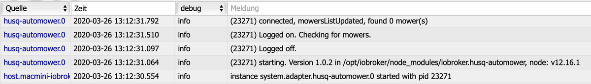

                          RobS last edited by

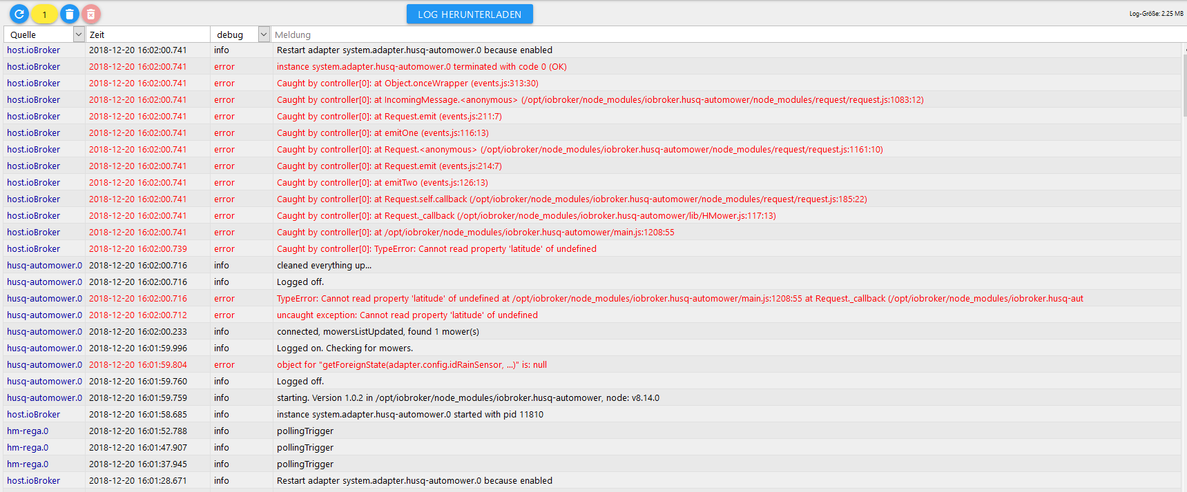

                          Hi greyhound,
                          Danke für den Adapter. Darauf habe ich schon gewartet.

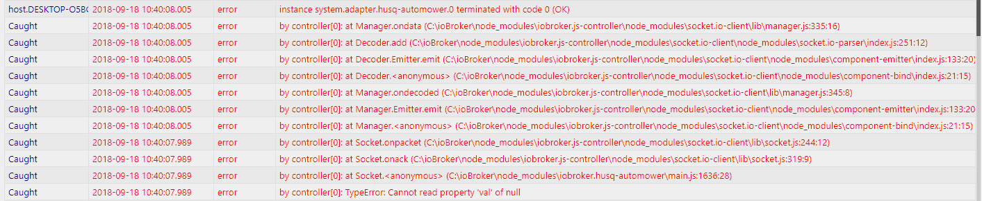

                          Leider bekomme ich nach Start der Instanz folgende Fehlermeldung im log:
                          ! husq-automower.0 2018-06-04 22:21:41.762 info Logged off.
                          ! husq-automower.0 2018-06-04 22:21:41.381 info connected, mowersListUpdated, found 1 mower(s)
                          ! husq-automower.0 2018-06-04 22:21:41.083 info Logged on. Checking for mowers.
                          ! husq-automower.0 2018-06-04 22:21:40.771 error at Receiver._receiver.onmessage (c:\iobroker\node_modules\iobroker.js-controller\node_modules\ws\lib\WebSocket.js:141:47)
                          ! husq-automower.0 2018-06-04 22:21:40.771 error at WebSocket.emit (events.js:211:7)
                          ! husq-automower.0 2018-06-04 22:21:40.771 error at emitOne (events.js:116:13)
                          ! husq-automower.0 2018-06-04 22:21:40.771 error at WebSocket.onMessage (c:\iobroker\node_modules\iobroker.js-controller\node_modules\ws\lib\EventTarget.js:99:16)
                          ! husq-automower.0 2018-06-04 22:21:40.771 error at WebSocket.ws.onmessage (c:\iobroker\node_modules\iobroker.js-controller\node_modules\engine.io-client\lib\transports\websocket.js:147:10)
                          ! husq-automower.0 2018-06-04 22:21:40.771 error at WS.Transport.onData (c:\iobroker\node_modules\iobroker.js-controller\node_modules\engine.io-client\lib\transport.js:137:8)
                          ! husq-automower.0 2018-06-04 22:21:40.771 error at WS.Transport.onPacket (c:\iobroker\node_modules\iobroker.js-controller\node_modules\engine.io-client\lib\transport.js:145:8)
                          ! husq-automower.0 2018-06-04 22:21:40.771 error at WS.Emitter.emit (c:\iobroker\node_modules\iobroker.js-controller\node_modules\component-emitter\index.js:133:20)
                          ! husq-automower.0 2018-06-04 22:21:40.771 error at WS. (c:\iobroker\node_modules\iobroker.js-controller\node_modules\engine.io-client\lib\socket.js:273:10)
                          ! husq-automower.0 2018-06-04 22:21:40.771 error at Socket.onPacket (c:\iobroker\node_modules\iobroker.js-controller\node_modules\engine.io-client\lib\socket.js:450:19)
                          ! husq-automower.0 2018-06-04 22:21:40.771 error Error: server error
                          ! husq-automower.0 2018-06-04 22:21:40.767 error server error
                          ! husq-automower.0 2018-06-04 22:21:40.760 info cleaned everything up…
                          ! husq-automower.0 2018-06-04 22:21:40.759 info Logged off.
                          ! husq-automower.0 2018-06-04 22:21:40.758 error at Manager.ondata (c:\iobroker\node_modules\iobroker.js-controller\node_modules\socket.io-client\lib\manager.js:335:16)
                          ! husq-automower.0 2018-06-04 22:21:40.758 error at Decoder.add (c:\iobroker\node_modules\iobroker.js-controller\node_modules\socket.io-parser\index.js:251:12)
                          ! husq-automower.0 2018-06-04 22:21:40.758 error at Decoder.Emitter.emit (c:\iobroker\node_modules\iobroker.js-controller\node_modules\component-emitter\index.js:133:20)
                          ! husq-automower.0 2018-06-04 22:21:40.758 error at Decoder. (c:\iobroker\node_modules\iobroker.js-controller\node_modules\component-bind\index.js:21:15)
                          ! husq-automower.0 2018-06-04 22:21:40.758 error at Manager.ondecoded (c:\iobroker\node_modules\iobroker.js-controller\node_modules\socket.io-client\lib\manager.js:345:8)
                          ! husq-automower.0 2018-06-04 22:21:40.758 error at Manager.Emitter.emit (c:\iobroker\node_modules\iobroker.js-controller\node_modules\component-emitter\index.js:133:20)
                          ! husq-automower.0 2018-06-04 22:21:40.758 error at Manager. (c:\iobroker\node_modules\iobroker.js-controller\node_modules\component-bind\index.js:21:15)
                          ! husq-automower.0 2018-06-04 22:21:40.758 error at Socket.onpacket (c:\iobroker\node_modules\iobroker.js-controller\node_modules\socket.io-client\lib\socket.js:244:12)
                          ! husq-automower.0 2018-06-04 22:21:40.758 error at Socket.onack (c:\iobroker\node_modules\iobroker.js-controller\node_modules\socket.io-client\lib\socket.js:319:9)
                          ! husq-automower.0 2018-06-04 22:21:40.758 error at Socket. (c:\iobroker\node_modules\iobroker.husq-automower\main.js:1391:49)
                          ! husq-automower.0 2018-06-04 22:21:40.758 error TypeError: Cannot read property 'val' of null
                          ! husq-automower.0 2018-06-04 22:21:40.757 error uncaught exception: Cannot read property 'val' of null
                          ! husq-automower.0 2018-06-04 22:21:40.640 info Logged off.
                          ! husq-automower.0 2018-06-04 22:21:40.619 info starting. Version 1.0.1 in c:/iobroker/node_modules/iobroker.husq-automower, node: v8.11.2
                          ! host.Barebone 2018-06-04 22:21:38.088 info instance system.adapter.husq-automower.0 started with pid 4052
                          Grüße, Rob

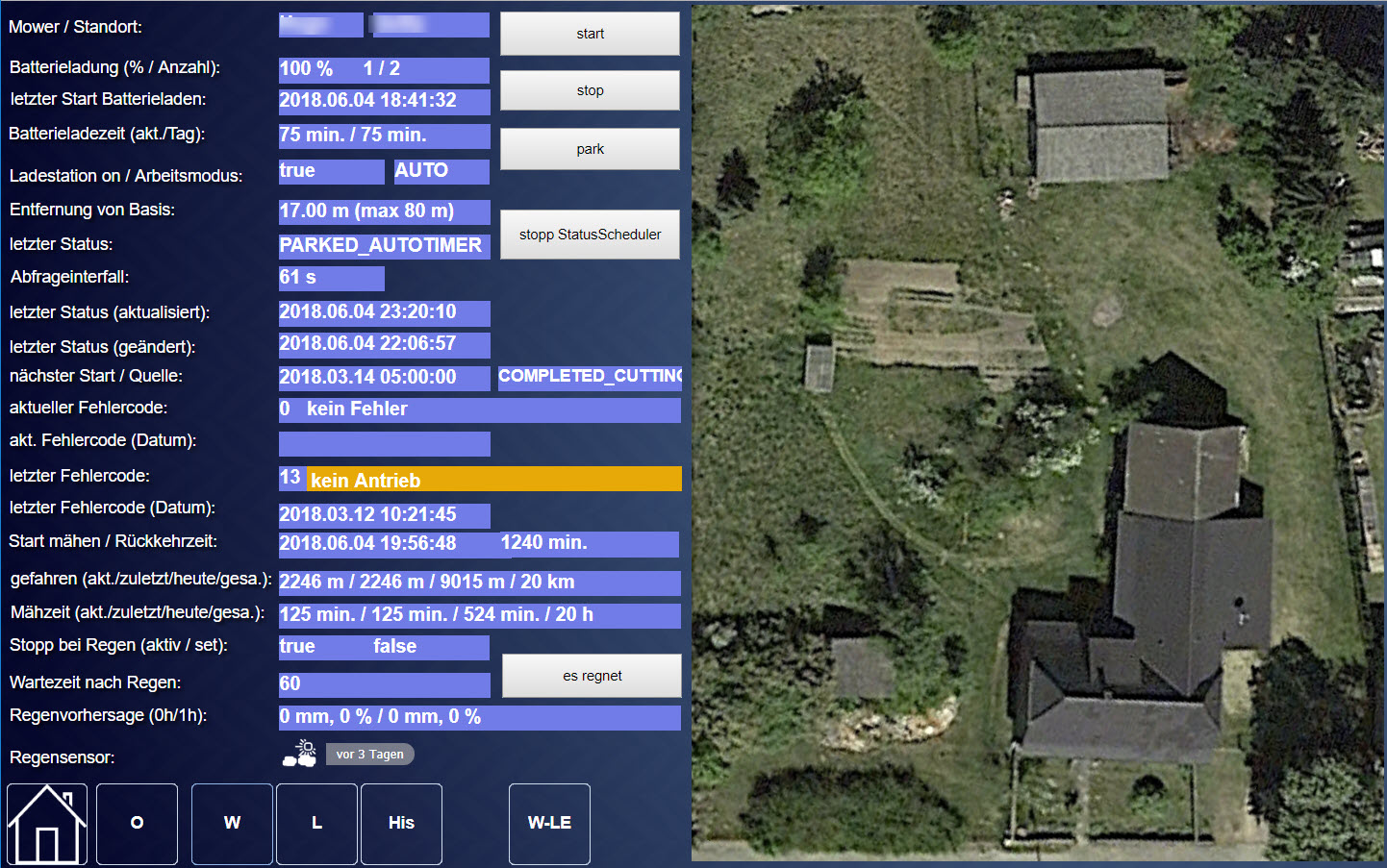

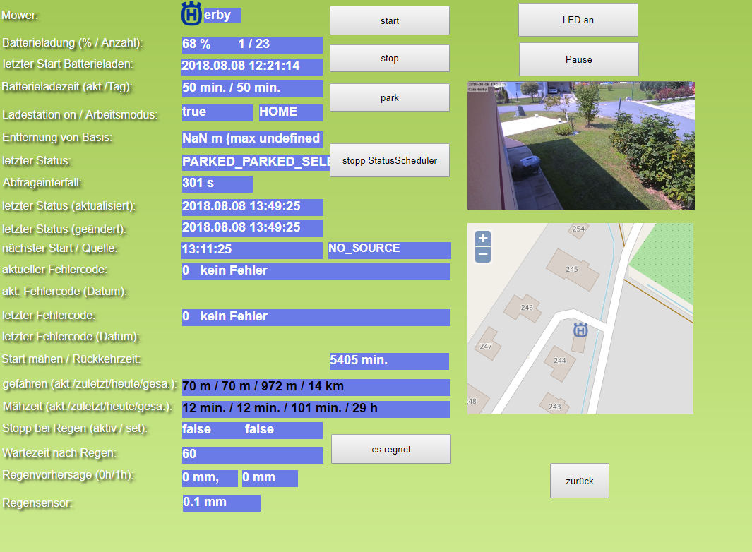

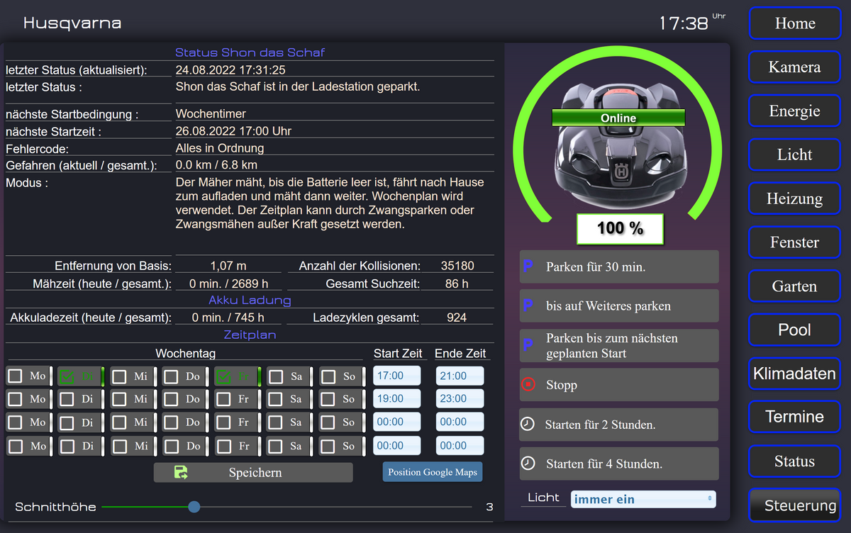

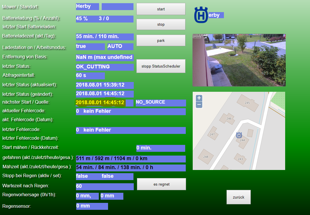

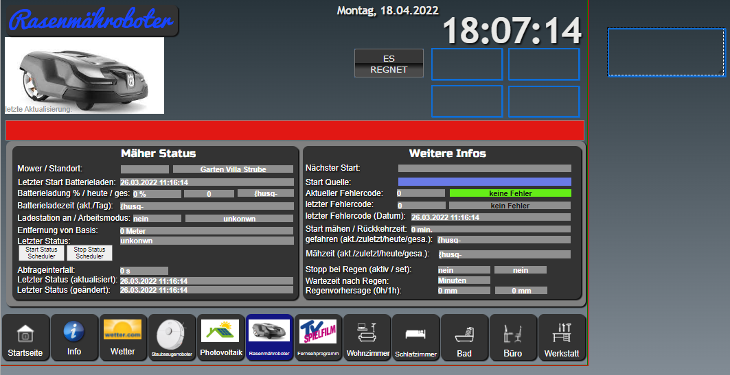

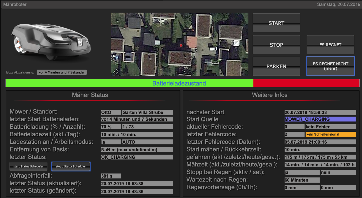

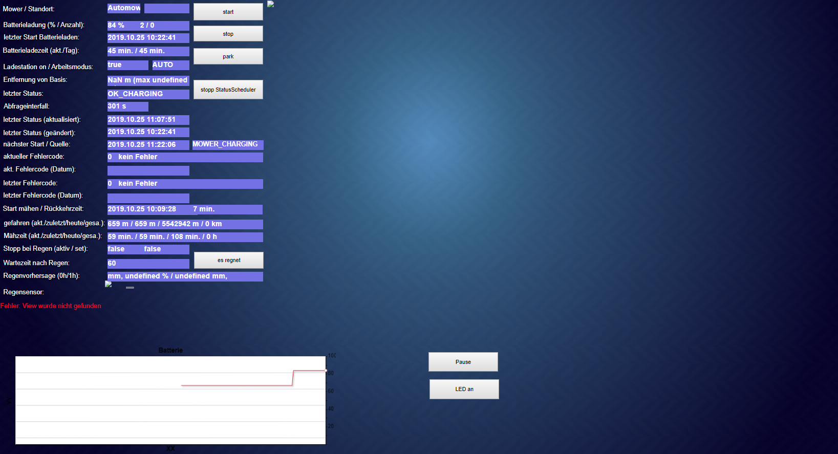

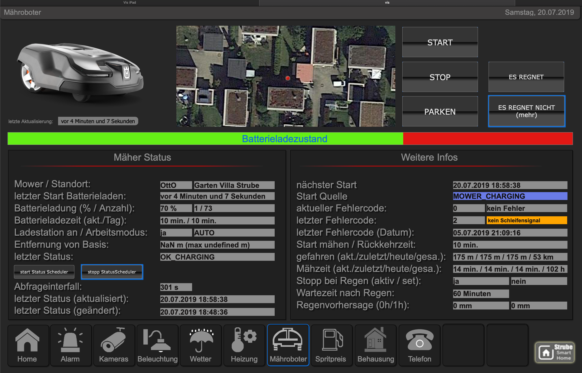

                                und nun zu dem versprochenen Screenshot und der View
                                1591_automower-view-2018-06-04.txt
                                Die View ist noch in Arbeit, das Bild soll als Hintergrund für die Darstellung der Wegepunkte analog zur Handyapp dienen, habe nur noch keine Idee, wie das gehen kann
                                In einer 2. View zeige ich in Google-Maps die aktuelle Position des Mähers an.

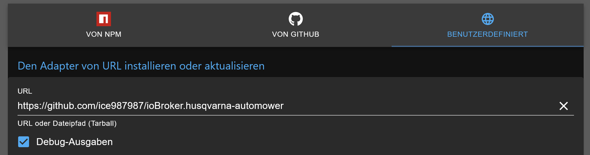

                                        Mit
                                        iobroker url https://github.com/truegreyhound/ioBroker.husq-automower
                                        sollte es gehen.
                                        Der Adapter ist noch nicht ins offizielle Repository aufgenommen, deshalb muss er per URL installiert werden.
                                        In der Adminoberfläche geht es auch, wenn du im Installierenformular auf den Tab "beliebig" gehst und dort die URL eingibst.
