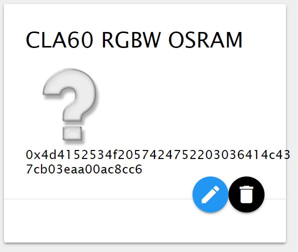

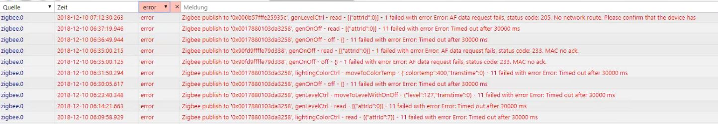

          Leider hab ich immer noch ein Problem. Das Osram Band regiert fast nicht.
          Zwischen den Befehlen muss man immer oft einige Sekunden warten ansonsten passiert nix und es gibt diese Fehlermeldungen:
          zigbee.0	2018-08-17 18:54:09.769	error	Zigbee publish to '0x7cb03eaa000024ef', genLevelCtrl - moveToLevel - {"level":10,"transtime":0} - 3 failed with error Error: Timed out after 30000 ms
          zigbee.0	2018-08-17 18:54:07.973	error	Zigbee publish to '0x7cb03eaa000024ef', genLevelCtrl - moveToLevel - {"level":10,"transtime":0} - 3 failed with error Error: Timed out after 30000 ms
          zigbee.0	2018-08-17 18:54:05.245	error	Zigbee publish to '0x7cb03eaa000024ef', genLevelCtrl - moveToLevel - {"level":10,"transtime":0} - 3 failed with error Error: Timed out after 30000 ms
          zigbee.0	2018-08-17 18:54:02.626	error	Zigbee publish to '0x7cb03eaa000024ef', genLevelCtrl - moveToLevel - {"level":254,"transtime":0} - 3 failed with error Error: Timed out after 30000 ms
          zigbee.0	2018-08-17 18:53:39.936	error	Zigbee publish to '0x7cb03eaa000024ef', genLevelCtrl - moveToLevel - {"level":10,"transtime":0} - 3 failed with error Error: Timed out after 30000 ms
          zigbee.0	2018-08-17 18:53:39.769	debug	Zigbee publish to '0x7cb03eaa000024ef', genLevelCtrl - cmd moveToLevel - payload {"level":10,"transtime":0} - endpoint 3
          zigbee.0	2018-08-17 18:53:39.750	debug	User stateChange zigbee.0.7cb03eaa000024ef.brightness {"val":10,"ack":false,"ts":1534524819742,"q":0,"from":"system.adapter.admin.0","lc":1534524815226}
          zigbee.0	2018-08-17 18:53:37.975	debug	Zigbee publish to '0x7cb03eaa000024ef', genLevelCtrl - cmd moveToLevel - payload {"level":10,"transtime":0} - endpoint 3
          zigbee.0	2018-08-17 18:53:37.962	debug	User stateChange zigbee.0.7cb03eaa000024ef.brightness {"val":10,"ack":false,"ts":1534524817952,"q":0,"from":"system.adapter.admin.0","lc":1534524815226}
          zigbee.0	2018-08-17 18:53:35.246	debug	Zigbee publish to '0x7cb03eaa000024ef', genLevelCtrl - cmd moveToLevel - payload {"level":10,"transtime":0} - endpoint 3
          zigbee.0	2018-08-17 18:53:35.234	debug	User stateChange zigbee.0.7cb03eaa000024ef.brightness {"val":10,"ack":false,"ts":1534524815226,"q":0,"from":"system.adapter.admin.0","lc":1534524815226}
          zigbee.0	2018-08-17 18:53:35.134	error	Zigbee publish to '0x7cb03eaa000024ef', lightingColorCtrl - moveToColor - {"colorx":12019.119,"colory":24981.942,"transtime":0} - 3 failed with error Error: Timed out after 30000 ms
          zigbee.0	2018-08-17 18:53:32.626	debug	Zigbee publish to '0x7cb03eaa000024ef', genLevelCtrl - cmd moveToLevel - payload {"level":254,"transtime":0} - endpoint 3
          zigbee.0	2018-08-17 18:53:32.614	debug	User stateChange zigbee.0.7cb03eaa000024ef.brightness {"val":254,"ack":false,"ts":1534524812605,"q":0,"from":"system.adapter.admin.0","lc":1534524812605}
          zigbee.0	2018-08-17 18:53:27.806	error	Zigbee publish to '0x7cb03eaa000024ef', genLevelCtrl - moveToLevel - {"level":256,"transtime":0} - 3 failed with error TypeError: "value" argument is out of bounds
          zigbee.0	2018-08-17 18:53:27.805	debug	Zigbee publish to '0x7cb03eaa000024ef', genLevelCtrl - cmd moveToLevel - payload {"level":256,"transtime":0} - endpoint 3
          zigbee.0	2018-08-17 18:53:27.794	debug	User stateChange zigbee.0.7cb03eaa000024ef.brightness {"val":256,"ack":false,"ts":1534524807785,"q":0,"from":"system.adapter.admin.0","lc":1534524807785}
          zigbee.0	2018-08-17 18:53:25.157	error	Zigbee publish to '0x7cb03eaa000024ef', lightingColorCtrl - moveToColor - {"colorx":10806.7215,"colory":39458.6235,"transtime":0} - 3 failed with error Error: Timed out after 30000 ms
          zigbee.0	2018-08-17 18:53:16.635	error	Zigbee publish to '0x7cb03eaa000024ef', lightingColorCtrl - moveToColor - {"colorx":12019.119,"colory":24981.942,"transtime":0} - 3 failed with error Error: AF data request fails, status code: 233\. MA
          zigbee.0	2018-08-17 18:53:16.299	debug	Zigbee publish to '0x7cb03eaa000024ef', lightingColorCtrl - cmd moveToColor - payload {"colorx":12019.119,"colory":24981.942,"transtime":0} - endpoint 3
          zigbee.0	2018-08-17 18:53:16.279	debug	User stateChange zigbee.0.7cb03eaa000024ef.color {"val":"66FFE6","ack":false,"ts":1534524796270,"q":0,"from":"system.adapter.admin.0","lc":1534524785113}
          zigbee.0	2018-08-17 18:53:09.938	debug	Zigbee publish to '0x7cb03eaa000024ef', genLevelCtrl - cmd moveToLevel - payload {"level":10,"transtime":0} - endpoint 3
          zigbee.0	2018-08-17 18:53:09.926	debug	User stateChange zigbee.0.7cb03eaa000024ef.brightness {"val":10,"ack":false,"ts":1534524789915,"q":0,"from":"system.adapter.admin.0","lc":1534524789915}
          zigbee.0	2018-08-17 18:53:05.136	debug	Zigbee publish to '0x7cb03eaa000024ef', lightingColorCtrl - cmd moveToColor - payload {"colorx":12019.119,"colory":24981.942,"transtime":0} - endpoint 3
          zigbee.0	2018-08-17 18:53:05.121	debug	User stateChange zigbee.0.7cb03eaa000024ef.color {"val":"66FFE6","ack":false,"ts":1534524785113,"q":0,"from":"system.adapter.admin.0","lc":1534524785113}
          zigbee.0	2018-08-17 18:53:01.918	error	Zigbee publish to '0x7cb03eaa000024ef', lightingColorCtrl - moveToColor - {"colorx":38678.757,"colory":16292.000999999998,"transtime":0} - 3 failed with error Error: Timed out after 30000 ms
          zigbee.0	2018-08-17 18:52:55.159	debug	Zigbee publish to '0x7cb03eaa000024ef', lightingColorCtrl - cmd moveToColor - payload {"colorx":10806.7215,"colory":39458.6235,"transtime":0} - endpoint 3
          zigbee.0	2018-08-17 18:52:55.141	debug	User stateChange zigbee.0.7cb03eaa000024ef.color {"val":"00994D","ack":false,"ts":1534524775128,"q":0,"from":"system.adapter.admin.0","lc":1534524775128}
          zigbee.0	2018-08-17 18:52:36.649	error	Zigbee publish to '0x7cb03eaa000024ef', lightingColorCtrl - moveToColor - {"colorx":22295.007,"colory":14594.6445,"transtime":0} - 3 failed with error Error: Timed out after 30000 ms
          zigbee.0	2018-08-17 18:52:31.919	debug	Zigbee publish to '0x7cb03eaa000024ef', lightingColorCtrl - cmd moveToColor - payload {"colorx":38678.757,"colory":16292.000999999998,"transtime":0} - endpoint 3
          zigbee.0	2018-08-17 18:52:31.907	debug	User stateChange zigbee.0.7cb03eaa000024ef.color {"val":"99004D","ack":false,"ts":1534524751898,"q":0,"from":"system.adapter.admin.0","lc":1534524751898}
          zigbee.0	2018-08-17 18:52:25.281	error	Zigbee publish to '0x7cb03eaa000024ef', lightingColorCtrl - moveToColor - {"colorx":14227.6485,"colory":5092.0695000000005,"transtime":0} - 3 failed with error Error: Timed out after 30000 ms
          zigbee.0	2018-08-17 18:52:21.597	error	Zigbee publish to '0x7cb03eaa000024ef', genOnOff - on - {} - 3 failed with error Error: Timed out after 30000 ms
          zigbee.0	2018-08-17 18:52:06.646	debug	Zigbee publish to '0x7cb03eaa000024ef', lightingColorCtrl - cmd moveToColor - payload {"colorx":22295.007,"colory":14594.6445,"transtime":0} - endpoint 3
          zigbee.0	2018-08-17 18:52:06.633	debug	User stateChange zigbee.0.7cb03eaa000024ef.color {"val":"EB9EFA","ack":false,"ts":1534524726624,"q":0,"from":"system.adapter.admin.0","lc":1534524726624}
          zigbee.0	2018-08-17 18:51:55.287	debug	Zigbee publish to '0x7cb03eaa000024ef', lightingColorCtrl - cmd moveToColor - payload {"colorx":14227.6485,"colory":5092.0695000000005,"transtime":0} - endpoint 3
          zigbee.0	2018-08-17 18:51:55.267	debug	User stateChange zigbee.0.7cb03eaa000024ef.color {"val":"7F0DF2","ack":false,"ts":1534524715256,"q":0,"from":"system.adapter.admin.0","lc":1534522754555}
          zigbee.0	2018-08-17 18:51:51.597	debug	Zigbee publish to '0x7cb03eaa000024ef', genOnOff - cmd on - payload {} - endpoint 3
          zigbee.0	2018-08-17 18:51:51.585	debug	User stateChange zigbee.0.7cb03eaa000024ef.state {"val":true,"ack":false,"ts":1534524711578,"q":0,"from":"system.adapter.admin.0","lc":1534524711578}
          zigbee.0	2018-08-17 18:51:43.337	error	Zigbee publish to '0x7cb03eaa000024ef', genOnOff - off - {} - 3 failed with error Error: Timed out after 30000 ms
          zigbee.0	2018-08-17 18:51:40.563	error	Zigbee publish to '0x7cb03eaa000024ef', genOnOff - on - {} - 3 failed with error Error: Timed out after 30000 ms
          zigbee.0	2018-08-17 18:51:37.784	error	Zigbee publish to '0x7cb03eaa000024ef', lightingColorCtrl - moveToColorTemp - {"colortemp":370,"transtime":0} - 3 failed with error Error: Timed out after 30000 ms
          zigbee.0	2018-08-17 18:51:33.855	error	Zigbee publish to '0x7cb03eaa000024ef', genOnOff - off - {} - 3 failed with error Error: Timed out after 30000 ms
          zigbee.0	2018-08-17 18:51:13.376	error	Zigbee publish to '0x7cb03eaa000024ef', genOnOff - on - {} - 3 failed with error Error: Timed out after 30000 ms

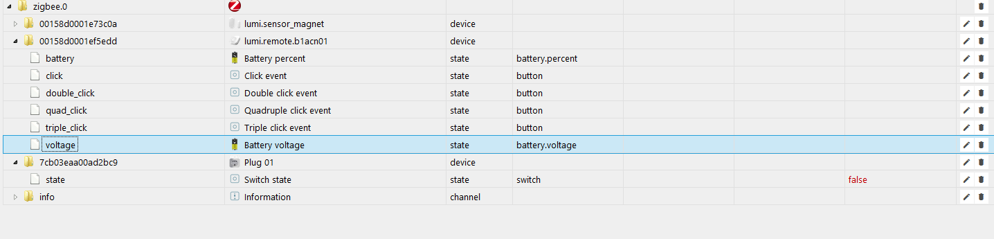

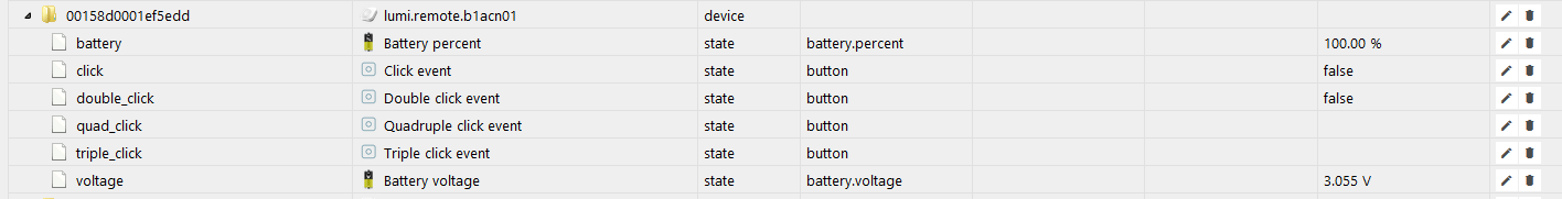

          Wurde ja hier demletzt auch schon von einem anderen user berichtet oder liegt das daran, dass der Empfang schlecht ist?
          Als Verbessrung fände ich noch super wenn man die transtime einstellen könnte, im log ist das ja schon sichtbar, man kann es nur nirgends eingeben.
          Oder ein Command Objekt mit dem man gleich mehrer Parameter abschicken kann, wie beim Philips Hue Adapter, wäre super.

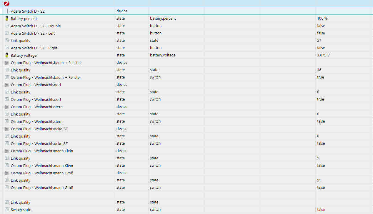

          Ausserdem wäre ein Reachable Objekt für jedes Gerät hilfreich, damit man sieht ob die Geräte noch verbunden sind. Momentan lös ich das über ein Skript, das den aktualisierte Zeit der Batteriespannung überprüft. Leider geht das nicht bei Netzbetrieben Geräten wie zb. Lampen wenn sie aus geschalten sind.
          Und der battery percent Wert ist bei allen meinen aqara Geräten sehr niedrig (zb. noch über 3V Spannung und nur noch 79% Battery kann ja nicht sein). `
          da scheint an der library was nicht zu stimmen.. die Fehler hab ich auch..

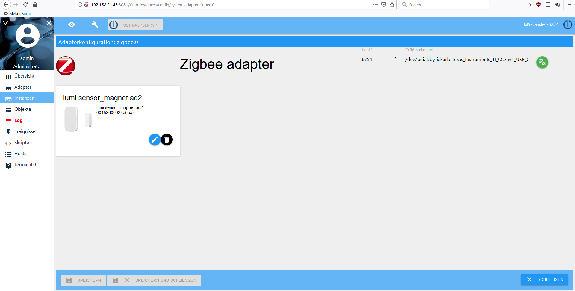

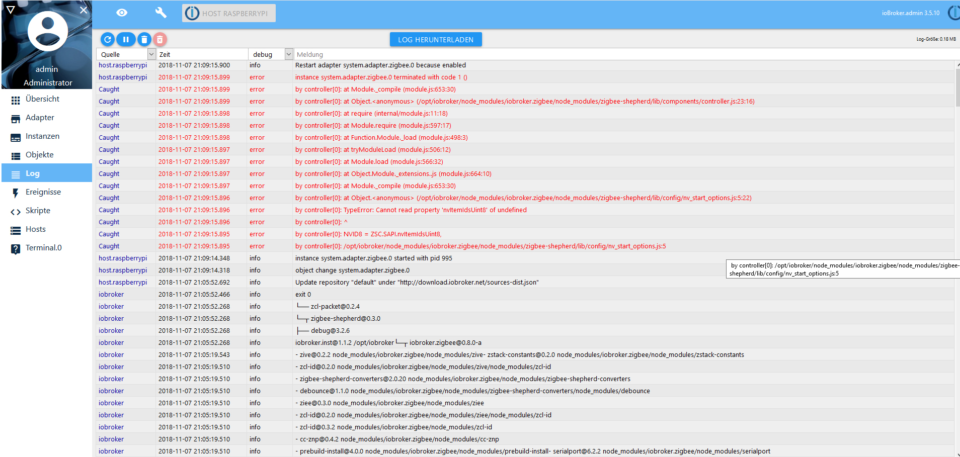

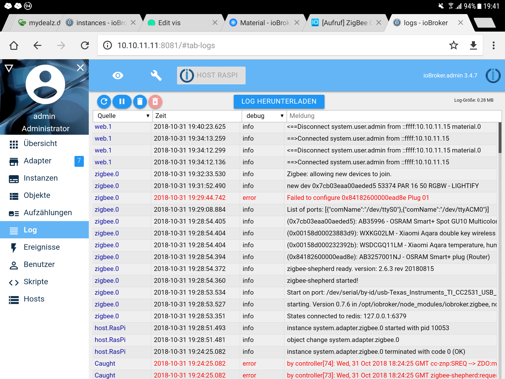

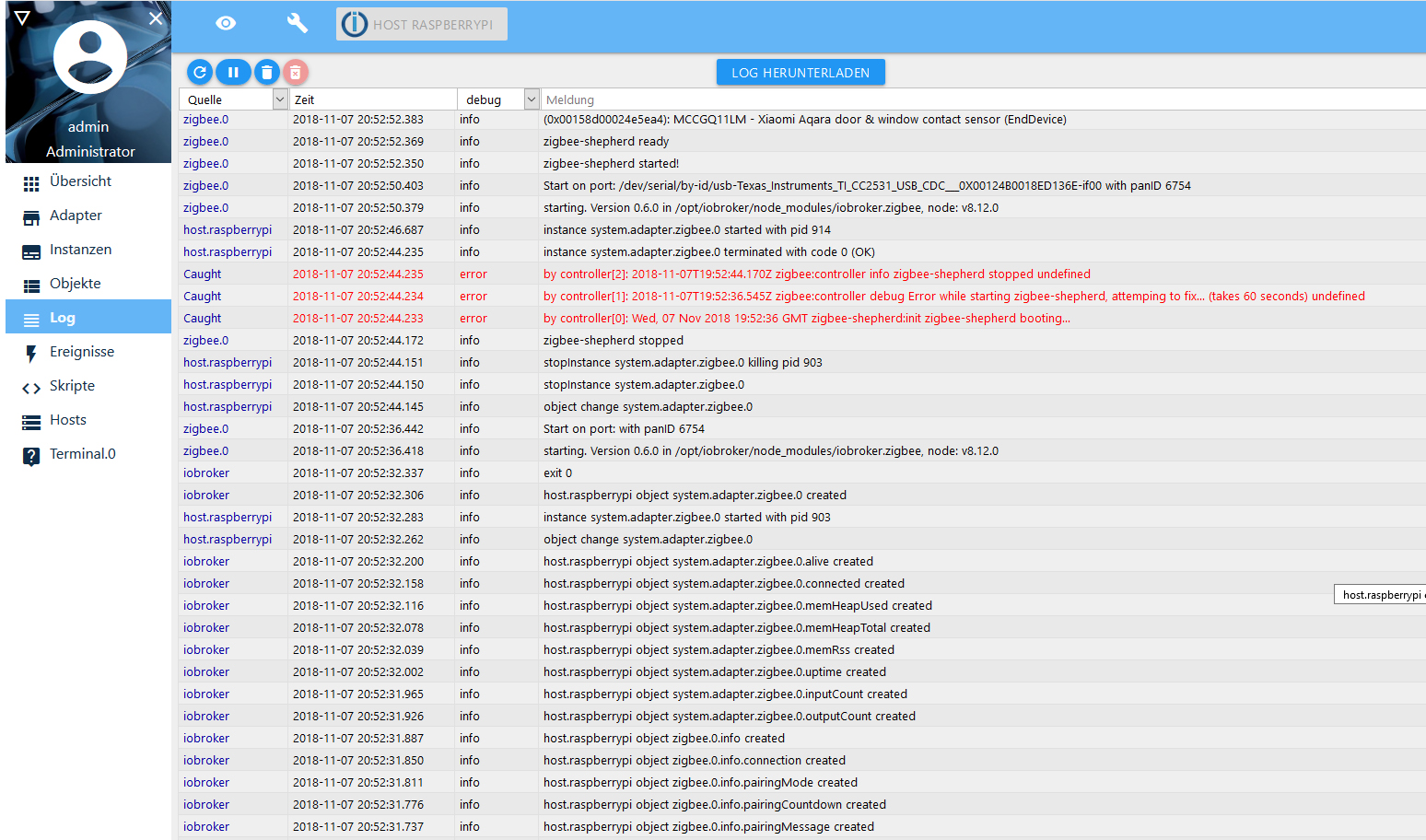

            Hallo Gemeinde,
            bin nun auch auf den Zigbee-Stick-Zug aufgesprungen, da ich meinen Xiaomi Aquara Cube nutzen möchte. Ich nutze Proxmox und Debian 9 in einer VM mit ioBroker als Master-Mschine. Hab den USB-Port easy direkt in der Weboberfläche durchreichen können. Finde via lsusb in der VM auch den Stick nun.
            Habe dann den Adapter installiert und````
            /dev/ttyACM0
            1\. Diese Fehlermeldung hatte ich beim Start. Beim restart der Instanz dann nicht mehr?! Denke, ist jetzt weg. Beobachte ich…
            zigbee.0 2018-08-19 11:44:16.421 error Error while starting zigbee-shepherd!. TypeError: "path" is not defined:
            2\. Diesen Fehler erhalte ich, wenn ich in den Pairing-Modus in der Instanz gehe und den Cube in den Pairing-Modus versetze (Reset-Knopf 5 Sek. halten und loslassen):
            Caught 2018-08-19 11:56:05.713 error by controller[1]: Sun, 19 Aug 2018 09:56:05 GMT cc-znp:SREQ --> ZDO:mgmtPermitJoinReq, { addrmode: 15, dstaddr: 65532, duration: 0, tcsignificance: 0 }
            Caught 2018-08-19 11:56:05.712 error by controller[1]: Sun, 19 Aug 2018 09:56:05 GMT zigbee-shepherd:request REQ --> ZDO:mgmtPermitJoinReq
            Caught 2018-08-19 11:45:35.313 error by controller[1]: Sun, 19 Aug 2018 09:45:35 GMT zigbee:controller info zigbee-shepherd stopped undefined
            Diese Fehlermeldung kann ich als Laie nicht lesen…kann mir da wer weiter helfen?
            Danke euch und Grüße, Thorsten

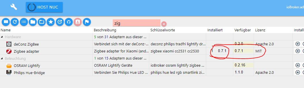

            PS: Hab die Version 0.7.1 vom Adapter drauf. Wurde mir direkt so angeboten im Admin.

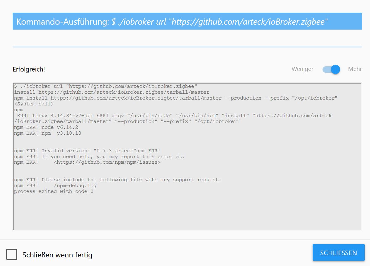

              Lars89 last edited by
              @arteck:
              in neuer Version wird es drinn sein..oder du installierst temporär aus meinem Git
              https://github.com/arteck/ioBroker.zigbee `

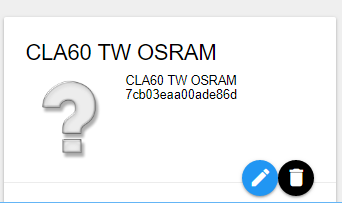

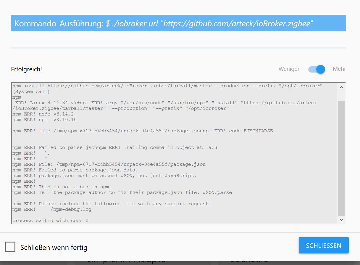

              Hallo, habe gerade mal die Version von ihrer GitHub Seite installiert. Leider ist das Problem immer noch das selbe und wenn ich in den Einstellungen das Häkchen bei "Led aus" setze verlieren alle Geräte die Verbindung zum Stick und die LED bleibt weiter Grün.
              Habe auch das Leuchtmittel noch einmal entfernt und noch einmal neu hinzugefügt, trotzdem nix. Die OSRAM Gu10 LED´s funktionieren einwandfrei.
              Gruß Lars

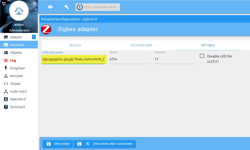

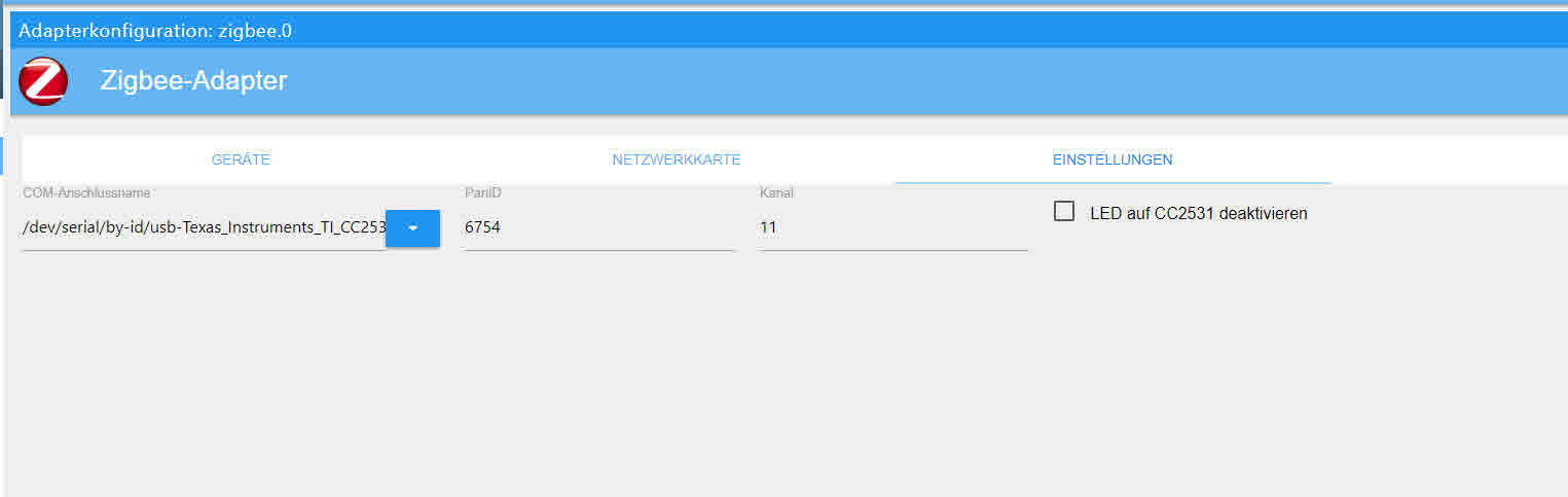

                @Lars: mit meinem cc2531 Stick lässt sich die grüne LED ohne Probleme abschalten. Vielleicht hast du einen anderen Stick bei dem die LED an einem anderen Pin am Mikrokontoller des cc253x Stick liegt.

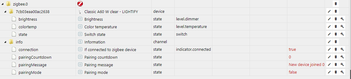

                  Das kann natürlich sein. Ich muss aber auch ehrlich sagen die LED stört mich jetzt nicht großartig. 😉
                  LG Lars
                    Kueppert last edited by
                    Ich hab bei mir die Led wieder eingeschaltet. Ausschalten führte zu fehlen, aber ich sehe gern, dass ein Gerät läuft 🙂
                    Gesendet von meinem HUAWEI RIO-L01 mit Tapatalk
                    • W
                      worfinator last edited by
                      Die LED ist echt hell, aber aus irgendwelchen Gründen schaltet die mein Debian ab, sobald das Device initialisiert ist.
                      Vermute, das liegt an der Firmware die auf meinem Stick aufgeflasht ist. Ich kriege sie also mit der Funktion im Adapter weder aus noch an.
                      Stört mich aber nicht weiter. Mir wäre sie auf jeden Fall zu hell. Ich sehe sie nur leuchten, wenn mein NUC gerade bootet. Ansonsten ist sie bei mir aus…

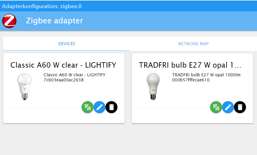

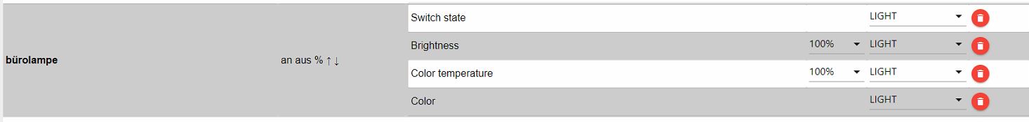

                        Hallo @ All
                        TRADFRI bulb E27 W opal ist im Adapter eingetragen und funktioniert über die Datenpunkte perfekt.
                        Weiss jemand wie ich es anstelle auch Alexa sagen zu können z.B.
                        Alexa, Flurlicht 50 Prozent
                        Geht die Dimmfunktion überhaupt per Sprchanweisung oder nur über die Datenpunkte?
                          @Pocky:
                          Hallo @ All
                          Geht die Dimmfunktion überhaupt per Sprchanweisung oder nur über die Datenpunkte? `
                          doch das geht.. du musst die Birne dem Cloud adapter bekannt geben mit allen Objekten
                            A Former User last edited by
                            Sorry @ arteck
                            Wie soll ich das denn machen?
                            Mit welchen Objekten?
                            Aus dem Zigbee Adapter? Das geht nicht.
                            Welche Objekte soll ich anlegen?
                              @Pocky:
                              Sorry @ arteck
                              Welche Objekte soll ich anlegen? `

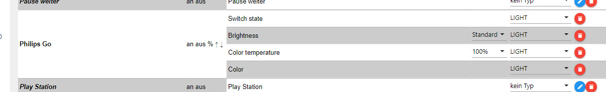

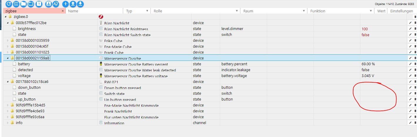

                              so mein kleiner Padawan 😉
                              ersmal lösche die Birne aus dem Cloud Adapter ..dann aus Alexa App..
                              zigbee Objekte auf und die Lampe/Birne was du steuern willst
                              bei jedem Datenpunkt muss du das machen mit der gleichen Bezeichnung
                              dann
                              "smartName": {
                                    "de": "bürolampe",
                                    "smartType": "LIGHT"
                              eintragen .. achte auf die Formatierung und , nicht vergessen
                              dann müsstest du die auch im Cloud adapter sehen
                              jetzt noch nach neuen Geräten suchen in der Alexa App
                                Danke für Deine Antwort.
                                Ich teste das mal.
                                Edit ON
                                Jaaaa, das klappt wunderbar.
                                Wieder was gelernt.
                                Vielen Dank

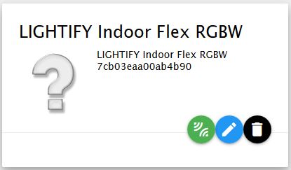

                                    Sinalco last edited by
                                    @worfinator:
                                    Ich hab jetzt mal den Kanal geändert. Hat jetzt aber erstmal nix gebracht, ausser dass ich alle Lampen neu anlernen musste.
                                    Es bleibt dabei, dass der erste Befehlen z.B. an/aus oder Helligkeit immer prima durchgeht es aber ab dem zweiten Befehl in Folge oft Probleme bei der Übertragung gibt.
                                    Vielleicht tritt das nur mit meinen Tradfri Lampen auf, das weiss ich nicht. Allerdings dürfte es am Empfang nicht liegen. Das hat vorher mit dem Tradfri Gateway auch prima funktioniert.
                                    Gibt es eine Möglichkeit im Script den Befehl nochmal zu senden, wenn er fehlschlägt? Könnte mir vielleicht helfen… `
                                    gleiches Problem mit Osram Lightify RGBW LED Band
                                    • W
                                      Ok, danke für den Hinweis, habe Osram Lightify RGBW LED Band mal in dem Github Issue auf die Liste der betroffenen Geräte gesetzt.

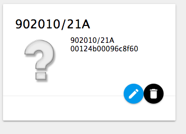

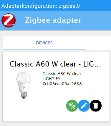

                                        Hallo zusammen, beschäftige mich auch mit dem Adapter und habe auch bereits ein paar Geräte am Laufen.
                                        Da mich jetzt der Spieltrieb gepackt hat, wollte ich jetzt mal ein neues nicht bekanntes Gerät integrieren.
                                        Hab mich an diese Anleitung https://github.com/Koenkk/zigbee2mqtt/w … ew-devices gehalten
                                        und bekomme das Device auch gekoppelt, aber dann ist Schluss. Debug-Modus ist aktiviert. Es taucht aber nichts im Log auf, außer der Pairingmeldung.
                                        Es handelt sich dabei um Tür- Fensterkontakte der Firma Bitronvideo Typ AV2010/21A.
                                        Im Adapter wird er so angezeigt:
                                        In die devices.js habe ich folgendes hinzugefügt:
                                        // Bitron Home
                                        zigbeeModel: ['902010/21A'],
                                        model: '902010/21A',
                                        vendor: 'Bitron Home',
                                        description: 'magnetic door & window contact',
                                        supports: 'contact',
                                        fromZigbee: [],
                                        toZigbee: [],
                                        Kann ich das überhaupt selber, oder muss immer einer der Entwickler neue Geräte integrieren? Wenn ja, wie?
                                        Vielen Dank für eure Hilfe.
                                        Übrigens dickes Lob an alle, die sich so in dem IOBroker-Projekt engagieren - vielen Dank dafür.
                                        Gruß Jörg
                                          gleiches Problem mit Osram Lightify RGBW LED Band `
                                          Vielleicht ein blöder Workaround, aber bis das eigentliche Problem gelöst ist, tut diese Vorgehensweise in meinen Scripten eine sehr gute Wirkung erzielen:
                                           //Set Color Temp
                                            setState("zigbee.0.----------------.colortemp"/*Farbtemperatur Marcs Büro Fenster */, 400,function (err) {
                                                if (err) setState("zigbee.0.----------------.colortemp"/*Farbtemperatur Marcs Büro Fenster */, 400);
                                            //Set Brightness
                                            setState("zigbee.0.----------------.brightness"/*Helligkeit Marcs Büro Fenster */,100,function (err) {
                                                if (err) setStat("zigbee.0.----------------.brightness"/*Helligkeit Marcs Büro Fenster */,100);
                                          Im Endeffekt: Einfach nochmal probieren, wenn es nicht geklappt hat. Stumpf, aber wirkungsvoll!

                                            unserer adapter hat nicht mit dem zigbee2mqtt Projekt zu tun.. wir nutzen nur dessen Libs..
                                            und wenn du keine ahnung von Programmieren hast dann würde ich es sein lassen.. bevor du im dunkeln sitzt 😄
                                            es ist relativ einfach nur du musst wissen was zu tun ist..
                                            du musst die zigbee-shepherd-converters/devices.js anpassen und dann den Adapter ioBroker.zigbee/lib/devstates.js
