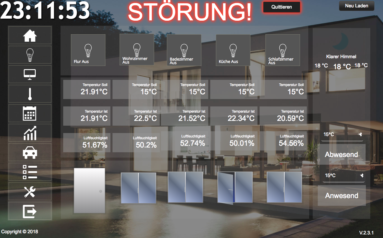

          Ich habe es so realisiert. Wäre das nix ?

                hammfrei last edited by
                [{"tpl":"tplHtml","data":{"g_fixed":true,"g_visibility":true,"g_css_font_text":true,"g_css_background":false,"g_css_shadow_padding":false,"g_css_border":false,"g_gestures":false,"g_signals":false,"visibility-cond":"==","visibility-val":"true","visibility-groups-action":"hide","refreshInterval":"0","signals-cond-0":"==","signals-val-0":true,"signals-icon-0":"/vis/signals/lowbattery.png","signals-icon-size-0":0,"signals-blink-0":false,"signals-horz-0":0,"signals-vert-0":0,"signals-hide-edit-0":false,"signals-cond-1":"==","signals-val-1":true,"signals-icon-1":"/vis/signals/lowbattery.png","signals-icon-size-1":0,"signals-blink-1":false,"signals-horz-1":0,"signals-vert-1":0,"signals-hide-edit-1":false,"signals-cond-2":"==","signals-val-2":true,"signals-icon-2":"/vis/signals/lowbattery.png","signals-icon-size-2":0,"signals-blink-2":false,"signals-horz-2":0,"signals-vert-2":0,"signals-hide-edit-2":false,"html":"
                STÖRUNG!
                ","class":"mdui-red-blink","lc-type":"last-change","lc-is-interval":true,"lc-is-moment":false,"lc-format":"","lc-position-vert":"top","lc-position-horz":"right","lc-offset-vert":0,"lc-offset-horz":0,"lc-font-size":"12px","lc-font-family":"","lc-font-style":"","lc-bkg-color":"","lc-color":"","lc-border-width":"0","lc-border-style":"","lc-border-color":"","lc-border-radius":10,"lc-zindex":0,"visibility-oid":"javascript.0.Automation.Disconnected"},"style":{"left":"438px","top":"-69px","color":"#FFFFFF","height":"173px","width":"439px","text-align":"left","line-height":"2em","z-index":1,"font-size":"xx-large"},"widgetSet":"basic"}]
                Hier das Widget.
                ich habe mir ein Skript geschrieben, dass einen Datenpunkt auf true setzt, sobald irgendwas die Verbindung verliert.
                Anschließend den Dantenpunkt im Widget unter Sichtbatkeit rein.
                Du kannst das Widget natürlich entsprechend bearbeiten, es muss kein "Störung" drin stehen 😉 Muss auch nicht rot blinken.
