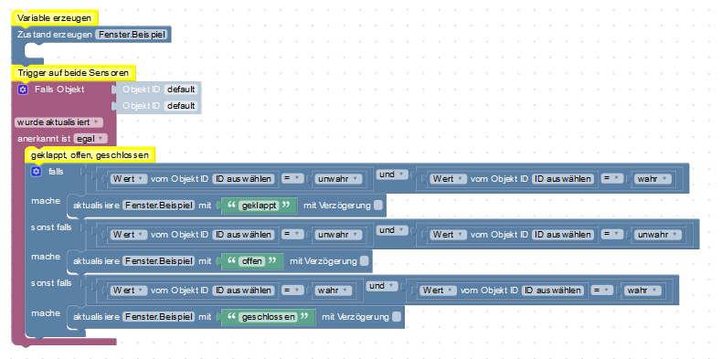

        bassface last edited by
        Moin,
        ich würde es so versuchen:
         <xml xmlns="http://www.w3.org/1999/xhtml"><block type="comment" id="PV@wi;P(7Or}IFr]G;w#" x="-462" y="-413"><field name="COMMENT">Variable erzeugen</field>
            <next><block type="create" id="hugGY.kjQ/6JbAbp0Coq"><field name="NAME">Fenster.Beispiel</field>
                <next><block type="comment" id="RpMUzedZCNLNs1nvcTPp"><field name="COMMENT">Trigger auf beide Sensoren</field>
                    <next><block type="on_ext" id="fvW|9PA`%/Ku(:D{Ja*]"><mutation items="2"></mutation>
                        <value name="OID0"><shadow type="field_oid" id="9MI^=*PdUsRSBiUgrdTM"><field name="oid">default</field></shadow></value>
                        <value name="OID1"><shadow type="field_oid" id="c|b?yGNJrfUJHum.{_vw"><field name="oid">default</field></shadow></value>
                        <statement name="STATEMENT"><block type="comment" id="4{-X-xbR}W-oA.g80Rj)"><field name="COMMENT">geklappt, offen, geschlossen</field>
                            <next><block type="controls_if" id="8.Y]Z%8a[u@``jU=KJn0"><mutation elseif="2"></mutation>
                                <value name="IF0"><block type="logic_operation" id="6#2g!iIGE*p(|-pLgwc;"><field name="OP">AND</field>
                                    <value name="A"><block type="logic_compare" id="Xr07{sCUI~9=X.S-YKGM"><field name="OP">EQ</field>
                                        <value name="A"><block type="get_value" id="0}BQ|J#W|Vw/tT(bNjt%"><field name="ATTR">val</field>
                                            <field name="OID">ID auswählen</field></block></value>
                                        <value name="B"><block type="logic_boolean" id="s]6]r!8A:yN,*bvr6f+{"><field name="BOOL">FALSE</field></block></value></block></value>
                                    <value name="B"><block type="logic_compare" id="e98Sejq:A3AQ:A#GS@.C"><field name="OP">EQ</field>
                                        <value name="A"><block type="get_value" id="QfR[~u%#|Ls}hkSe{w8h"><field name="ATTR">val</field>
                                        <value name="B"><block type="logic_boolean" id="^H![P|cPcmdge|+.*yo%"><field name="BOOL">TRUE</field></block></value></block></value></block></value>
                                <statement name="DO0"><block type="update" id="a6_rcw(oeo?0R{!KboQ]"><mutation delay_input="false"></mutation>
                                    <field name="OID">javascript.0.Fenster.Beispiel</field>
                                    <value name="VALUE"><block type="text" id="Z5rAFVN;NX`P8HwBhMQZ"><field name="TEXT">geklappt</field></block></value></block></statement>
                                <value name="IF1"><block type="logic_operation" id="k@q5C{Lpaee|s*mt8+^a"><field name="OP">AND</field>
                                    <value name="A"><block type="logic_compare" id="]7Lkad!(T0p={_+_HwXF"><field name="OP">EQ</field>
                                        <value name="A"><block type="get_value" id=".K^*@R+;*QibAU[0.9+_"><field name="ATTR">val</field>
                                        <value name="B"><block type="logic_boolean" id=",tO!n!:nl,[Ip/aL!wX)"><field name="BOOL">FALSE</field></block></value></block></value>
                                    <value name="B"><block type="logic_compare" id="Ro%]a)~T2f1ssk7p-H~3"><field name="OP">EQ</field>
                                        <value name="A"><block type="get_value" id=".0M-VQgDL)ad3(R^d(VN"><field name="ATTR">val</field>
                                        <value name="B"><block type="logic_boolean" id="yD/JCW`;myUubZxKZ@(L"><field name="BOOL">FALSE</field></block></value></block></value></block></value>
                                <statement name="DO1"><block type="update" id="W5tQbsYs9^`ZWjx]`OBn"><mutation delay_input="false"></mutation>
                                    <value name="VALUE"><block type="text" id="IT`QVa.4WL1^LFH;@9%9"><field name="TEXT">offen</field></block></value></block></statement>
                                <value name="IF2"><block type="logic_operation" id="m:]a)s.C{D;7o~JJ27L@"><field name="OP">AND</field>
                                    <value name="A"><block type="logic_compare" id="^PqvNp!a_YLTXW=eMf{P"><field name="OP">EQ</field>
                                        <value name="A"><block type="get_value" id="N}L}/|]wJ@7K7v*wMq-F"><field name="ATTR">val</field>
                                        <value name="B"><block type="logic_boolean" id="dL!C)uUUW+/FN+-z,0.6"><field name="BOOL">FALSE</field></block></value></block></value>
                                    <value name="B"><block type="logic_compare" id="j0xXDheR61i8vDfT8vn4"><field name="OP">EQ</field>
                                        <value name="A"><block type="get_value" id="u22,f18P,,#F~P;FRVK?"><field name="ATTR">val</field>
                                        <value name="B"><block type="logic_boolean" id="=1dQnj(#f]Auc.^}hE+2"><field name="BOOL">TRUE</field></block></value></block></value></block></value>
                                <statement name="DO2"><block type="update" id="0z~WEv|~p-dn4hXzA_!s"><mutation delay_input="false"></mutation>
                                    <value name="VALUE"><block type="text" id="QhMt4p4iTcaD!{AxyiH5"><field name="TEXT">geschlossen</field></block></value></block></statement></block></next></block></statement></block></next></block></next></block></next></block></xml>
        Geht bestimmt auch noch eleganter…
