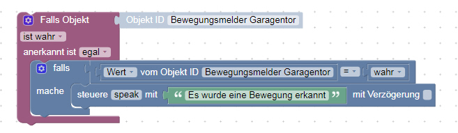

          Ist eigentlichg ganz simpel:
          on({id: 'sonoff.0.BewmeldGarage.POWER2', val: true}, function (obj) {
            var value = obj.state.val;
            if (getState("sonoff.0.BewmeldGarage.POWER2").val == true) {
              setState("alexa2.0.Echo-Devices.G090LF11822612E9.Commands.speak"/*speak*/, 'Es wurde eine Bewegung erkannt');
          //JTNDeG1sJTIweG1sbnMlM0QlMjJodHRwJTNBJTJGJTJGd3d3LnczLm9yZyUyRjE5OTklMkZ4aHRtbCUyMiUzRSUzQ2Jsb2NrJTIwdHlwZSUzRCUyMm9uX2V4dCUyMiUyMGlkJTNEJTIyTlVhZ2clMjV1NFV1MSU3QnJBOEMlNUJvJTI1eiUyMiUyMHglM0QlMjItMTEyJTIyJTIweSUzRCUyMi0yMTIlMjIlM0UlM0NtdXRhdGlvbiUyMGl0ZW1zJTNEJTIyMSUyMiUzRSUzQyUyRm11dGF0aW9uJTNFJTNDZmllbGQlMjBuYW1lJTNEJTIyQ09ORElUSU9OJTIyJTNFdHJ1ZSUzQyUyRmZpZWxkJTNFJTNDZmllbGQlMjBuYW1lJTNEJTIyQUNLX0NPTkRJVElPTiUyMiUzRSUzQyUyRmZpZWxkJTNFJTNDdmFsdWUlMjBuYW1lJTNEJTIyT0lEMCUyMiUzRSUzQ3NoYWRvdyUyMHR5cGUlM0QlMjJmaWVsZF9vaWQlMjIlMjBpZCUzRCUyMiU3RDAqTlUlMjN4MiolNjAlM0JXSXJqU1k2T2olMjIlM0UlM0NmaWVsZCUyMG5hbWUlM0QlMjJvaWQlMjIlM0Vzb25vZmYuMC5CZXdtZWxkR2FyYWdlLlBPV0VSMiUzQyUyRmZpZWxkJTNFJTNDJTJGc2hhZG93JTNFJTNDJTJGdmFsdWUlM0UlM0NzdGF0ZW1lbnQlMjBuYW1lJTNEJTIyU1RBVEVNRU5UJTIyJTNFJTNDYmxvY2slMjB0eXBlJTNEJTIyY29udHJvbHNfaWYlMjIlMjBpZCUzRCUyMiUyQzMlNUJDJTI1Ti1JciFVNkdEYUJjbCUzRFMlMjIlM0UlM0N2YWx1ZSUyMG5hbWUlM0QlMjJJRjAlMjIlM0UlM0NibG9jayUyMHR5cGUlM0QlMjJsb2dpY19jb21wYXJlJTIyJTIwaWQlM0QlMjI1biUyQkt1JTVCJTJCQVAuJTJDd1cqJTdCenZfN18lMjIlM0UlM0NmaWVsZCUyMG5hbWUlM0QlMjJPUCUyMiUzRUVRJTNDJTJGZmllbGQlM0UlM0N2YWx1ZSUyMG5hbWUlM0QlMjJBJTIyJTNFJTNDYmxvY2slMjB0eXBlJTNEJTIyZ2V0X3ZhbHVlJTIyJTIwaWQlM0QlMjJIJTdEaiUzRChVWCE2JTVELnpPUGslNUIoNmMyJTIyJTNFJTNDZmllbGQlMjBuYW1lJTNEJTIyQVRUUiUyMiUzRXZhbCUzQyUyRmZpZWxkJTNFJTNDZmllbGQlMjBuYW1lJTNEJTIyT0lEJTIyJTNFc29ub2ZmLjAuQmV3bWVsZEdhcmFnZS5QT1dFUjIlM0MlMkZmaWVsZCUzRSUzQyUyRmJsb2NrJTNFJTNDJTJGdmFsdWUlM0UlM0N2YWx1ZSUyMG5hbWUlM0QlMjJCJTIyJTNFJTNDYmxvY2slMjB0eXBlJTNEJTIybG9naWNfYm9vbGVhbiUyMiUyMGlkJTNEJTIybFElMkZJWG5YYyUzQUNLRkhyaTclM0J1eSU1RSUyMiUzRSUzQ2ZpZWxkJTIwbmFtZSUzRCUyMkJPT0wlMjIlM0VUUlVFJTNDJTJGZmllbGQlM0UlM0MlMkZibG9jayUzRSUzQyUyRnZhbHVlJTNFJTNDJTJGYmxvY2slM0UlM0MlMkZ2YWx1ZSUzRSUzQ3N0YXRlbWVudCUyMG5hbWUlM0QlMjJETzAlMjIlM0UlM0NibG9jayUyMHR5cGUlM0QlMjJjb250cm9sJTIyJTIwaWQlM0QlMjIlNDBuOXlvfktmeEJmOXprcmhDOSU0MC0lMjIlM0UlM0NtdXRhdGlvbiUyMGRlbGF5X2lucHV0JTNEJTIyZmFsc2UlMjIlM0UlM0MlMkZtdXRhdGlvbiUzRSUzQ2ZpZWxkJTIwbmFtZSUzRCUyMk9JRCUyMiUzRWFsZXhhMi4wLkVjaG8tRGV2aWNlcy5HMDkwTEYxMTgyMjYxMkU5LkNvbW1hbmRzLnNwZWFrJTNDJTJGZmllbGQlM0UlM0NmaWVsZCUyMG5hbWUlM0QlMjJXSVRIX0RFTEFZJTIyJTNFRkFMU0UlM0MlMkZmaWVsZCUzRSUzQ3ZhbHVlJTIwbmFtZSUzRCUyMlZBTFVFJTIyJTNFJTNDYmxvY2slMjB0eXBlJTNEJTIydGV4dCUyMiUyMGlkJTNEJTIyYVBFMCUyQ1BuUVlEOCU1REJkVVhfNWhOJTIyJTNFJTNDZmllbGQlMjBuYW1lJTNEJTIyVEVYVCUyMiUzRUVzJTIwd3VyZGUlMjBlaW5lJTIwQmV3ZWd1bmclMjBlcmthbm50JTNDJTJGZmllbGQlM0UlM0MlMkZibG9jayUzRSUzQyUyRnZhbHVlJTNFJTNDJTJGYmxvY2slM0UlM0MlMkZzdGF0ZW1lbnQlM0UlM0MlMkZibG9jayUzRSUzQyUyRnN0YXRlbWVudCUzRSUzQyUyRmJsb2NrJTNFJTNDJTJGeG1sJTNF

              Jan1 last edited by
              @MagicSven:
              Da sind gleich 2 Fehler drin 😉
              Trigger auf Wahr macht kein Sinn, dwenn unten nochmal eine Falls auf Wahr prüft, da das schon der Trigger macht.
              Besser Trigger auf geändert, oder aktualisiert und dann bei der Falls das Wahr weg lassen, denn das macht die eh schon.
              Was man da noch einbaut, soll der TE entscheiden, das war auf alle Fälle mal seine Grundbedingung 😄

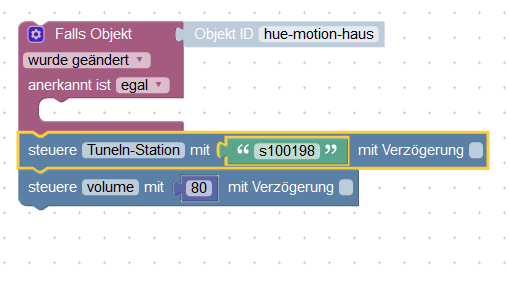

                  Mein allererstes Blockly und ich brauche Hilfe :lol:
                  Ich habe über Node-Red den HUE Motion Sensor eingebunden. Datenpunkt true und false.
                  Nun möchte ich morgens wenn ich an dem Ding vorbei gehe, dass er 1Live spielt.
                  Wenn ich das Blockly starte macht er das auch.
                  Simuliere ich eine Bewegung passiert nichts, Datenpunkte gehen von false auf true und wieder zurück, aber keine Musik von Alexa.
                    die beiden blauen Blöcke müssen in das Maul des roten, sonst passiert das nur beim Start des Skriptes 😉

                      Ich würde euch alle hier heiraten wenn ich könnte….Danke für den Tipp....jetzt geht es
