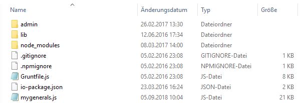

        Wo genau liegen denn die Files?
        • htrecksler
          htrecksler Forum Testing last edited by
          C:\Program Files\iobroker\node_modules\iobroker.mygenerals
