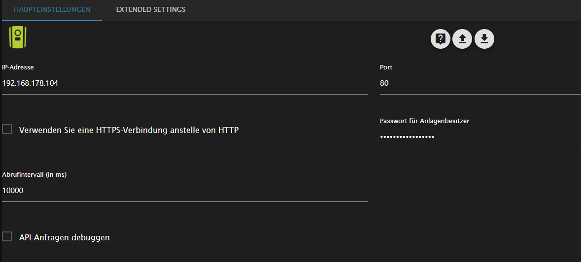

                            paradoxe Situation @mule last edited by paradoxe Situation
                            Hallo zusammen, was muss ich hir ändern, damit ich diese Warnmeldung nicht mehr im Log von ioB sehen?
                            Daten sehe und bekomme ich.
                            Requesting settings - [{"moduleid":"devices:local","processdataids":["Dc_P","DigitalIn","EM_State","HomeBat_P","HomeGrid_P","HomeOwn_P","HomePv_P","Home_P","Inverter:State","LimitEvuAbs"]},{"moduleid":"devices:local:ac","processdataids":["CosPhi","Frequency","L1_I","L1_P","L1_U","L2_I","L2_P","L2_U","L3_I","L3_P","L3_U","P","Q","S"]},{"moduleid":"devices:local:battery","processdataids":["Cycles","SoC","I","U","P"]},{"moduleid":"devices:local:pv1","processdataids":["I","U","P"]},{"moduleid":"devices:local:pv2","processdataids":["I","U","P"]},{"moduleid":"scb:export","processdataids":["PortalConActive"]},{"moduleid":"scb:statistic:EnergyFlow","processdataids":["Statistic:Autarky:Day","Statistic:Autarky:Month","Statistic:Autarky:Total","Statistic:Autarky:Year","Statistic:EnergyHome:Day","Statistic:EnergyHome:Month","Statistic:EnergyHome:Total","Statistic:EnergyHome:Year","Statistic:EnergyHomeBat:Day","Statistic:EnergyHomeBat:Month","Statistic:EnergyHomeBat:Total","Statistic:EnergyHomeBat:Year","Statistic:EnergyHomeGrid:Day","Statistic:EnergyHomeGrid:Month","Statistic:EnergyHomeGrid:Total","Statistic:EnergyHomeGrid:Year","Statistic:EnergyHomePv:Day","Statistic:EnergyHomePv:Month","Statistic:EnergyHomePv:Total","Statistic:EnergyHomePv:Year","Statistic:OwnConsumptionRate:Day","Statistic:OwnConsumptionRate:Month","Statistic:OwnConsumptionRate:Total","Statistic:OwnConsumptionRate:Year","Statistic:Yield:Day","Statistic:Yield:Month","Statistic:Yield:Total","Statistic:Yield:Year","Statistic:CO2Saving:Day","Statistic:CO2Saving:Month","Statistic:CO2Saving:Year","Statistic:CO2Saving:Total"]}]) failed with code 503: {"message":"internal communication error, try again later"}

                              FernetMenta @paradoxe Situation last edited by
                              @paradoxe-situation kannst du nicht ändern, da dieser Adapter nicht mehr gepflegt wird und Fehler hat. Ich habe aus diesem Grund einen neuen geschrieben: plenticore-g3

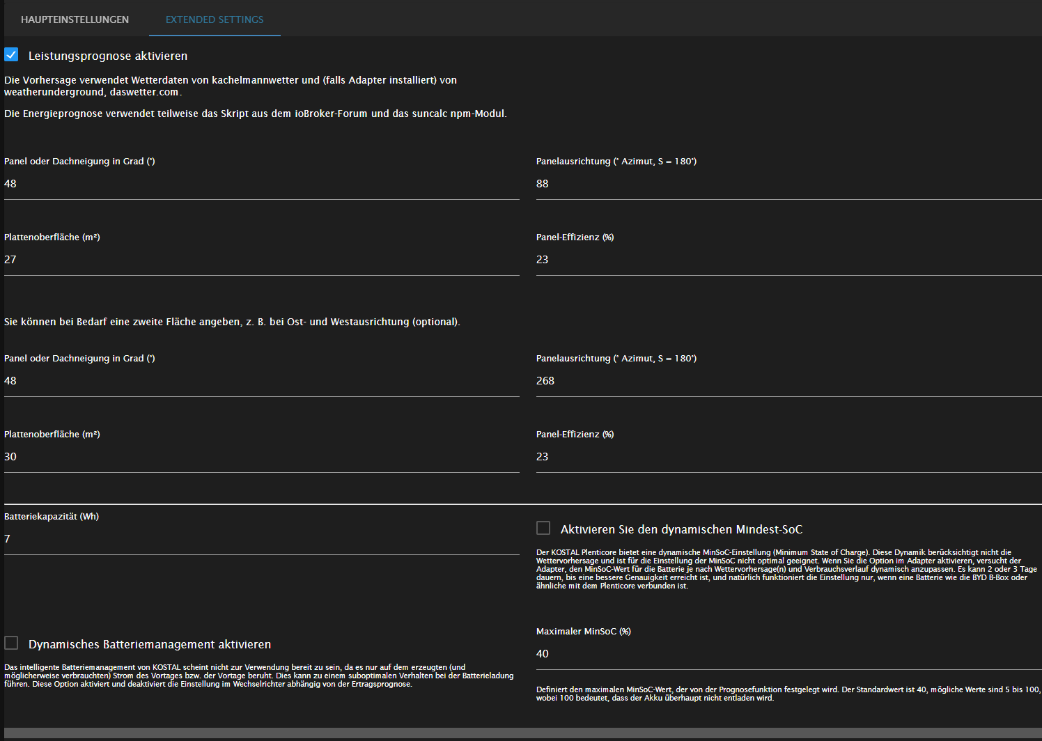

                                @fernetmenta Ich habe einen PLENTICORE plus 5.5 und bin mit dem Adapter seit Jahren fehlerfrei zufrieden. Ist dein Adapter mit meinem WR kompatibel?
                                Neben den klassischen Werten, die ich parallel schon immer auch per modbus beziehe, hat der Plenticore Adapter auch noch eine Ertragsprognose. Hat das dein Adapter auch?
                                Gibt es irgendwo - bei github habe ich nix gefunden - eine Feature Übersicht und ggf. ein Screenshot vom Objektbaum?

                                  @diginix
                                  Ich denke schon. Ist die gleiche API, nur ggf andere Datenpunkte. Darum habe ich es so gemacht, dass ein Benutzer selber bestimmen kann, welche Datenpunkte er haben möchte. Man kann alles aus ProcessData uind Settings (siehe API doc) abrufen. Die Bedeutung kann man in den meisten Fällen direkt aus den Namen ableiten.
                                  Hier ist der Testing thread: https://forum.iobroker.net/topic/80275/beta-iobroker-plenticore-g3
                                  Und die Doku: https://github.com/FernetMenta/ioBroker.plenticore-g3
