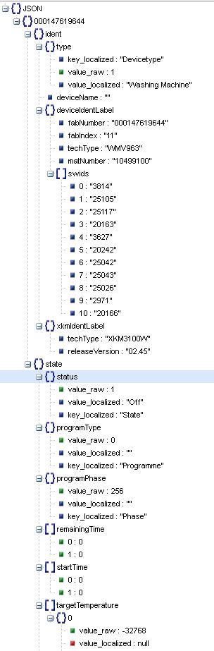

                    Ist es das Objekt aus dem ersten Beitrag ? Im JSON-Viewer sieht es so aus (ohne "body: "):
                    Der Zugriff auf z.B. state.status.value_raw würde so erfolgen:
                    var status_value_raw = obj["000147619644"].state.status.value_raw;

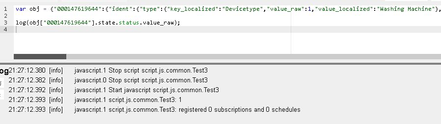

                          wenn ich das so aufbaue:var obj = {"000147619644":{"ident":{"type":{"key_localized":"Devicetype","value_raw":1,"value_localized":"Washing Machine"},"deviceName":"","deviceIdentLabel":{"fabNumber":"000147619644","fabIndex":"11","techType":"WMV963","matNumber":"10499100","swids":["3814","25105","25117","20163","3627","20242","25042","25043","25026","2971","20166"]},"xkmIdentLabel":{"techType":"XKM3100W","releaseVersion":"02.45"}},"state":{"status":{"value_raw":1,"value_localized":"Off","key_localized":"State"},"programType":{"value_raw":0,"value_localized":"","key_localized":"Programme"},"programPhase":{"value_raw":256,"value_localized":"","key_localized":"Phase"},"remainingTime":[0,0],"startTime":[0,0],"targetTemperature":[{"value_raw":-32768,"value_localized":null,"unit":"Celsius"}],"temperature":[{"value_raw":-32768,"value_localized":null,"unit":"Celsius"},{"value_raw":-32768,"value_localized":null,"unit":"Celsius"},{"value_raw":-32768,"value_localized":null,"unit":"Celsius"}],"signalInfo":false,"signalFailure":false,"signalDoor":false,"remoteEnable":{"fullRemoteControl":true,"smartGrid":true},"light":0,"elapsedTime":[0,0],"spinningSpeed":0,"dryingStep":{"value_raw":null,"value_localized":"","key_localized":"Drying level"},"ventilationStep":{"value_raw":null,"value_localized":"","key_localized":"Power Level"}}}}; log(obj["000147619644"].state.status.value_raw);klappte es bei mir auch.````

                          hier mal der Code:````
