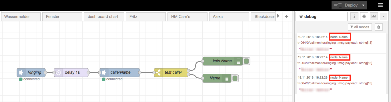

              rewenode last edited by
              So vielleicht?
              "id": "fd13fd3c.16996",
              "type": "ioBroker in",
              "z": "e623b6a3.561b78",
              "name": "Ringing",
              "topic": "tr-064.0.callmonitor.ringing",
              "payloadType": "value",
              "onlyack": "",
              "func": "all",
              "gap": "",
              "x": 140,
              "y": 180,
              "wires": [
              "c2cee8ea.b2dbe"
              "id": "c2cee8ea.b2dbe",
              "type": "delay",
              "name": "",
              "pauseType": "delay",
              "timeout": "1",
              "timeoutUnits": "seconds",
              "rate": "1",
              "nbRateUnits": "1",
              "rateUnits": "second",
              "randomFirst": "1",
              "randomLast": "5",
              "randomUnits": "seconds",
              "drop": false,
              "x": 280,
              "y": 180,
              "wires": [
              "72e39a37.37dafc"
              "id": "72e39a37.37dafc",
              "type": "ioBroker get",
              "name": "callerName",
              "topic": "tr-064.0.callmonitor.inbound.callerName",
              "attrname": "payload",
              "x": 450,
              "y": 180,
              "wires": [
              "e01eb3e1.501308"
              "id": "fe446ec3.474d1",
              "type": "debug",
              "name": "kein Name",
              "active": true,
              "tosidebar": true,
              "console": false,
              "tostatus": false,
              "complete": "payload",
              "x": 810,
              "y": 140,
              "wires": []
              "id": "e01eb3e1.501308",
              "type": "switch",
              "name": "test caller",
              "property": "payload",
              "propertyType": "msg",
              "rules": [
              "t": "eq",
              "v": "",
              "vt": "str"
              "t": "neq",
              "v": "",
              "vt": "str"
              "checkall": "true",
              "repair": false,
              "outputs": 2,
              "x": 630,
              "y": 180,
              "wires": [
              "fe446ec3.474d1"
              "c81aec48.51142"
              "outputLabels": [
              "kein Name",
              "Name"
              "id": "c81aec48.51142",
              "type": "debug",
              "name": "Name",
              "active": true,
              "tosidebar": true,
              "console": false,
              "tostatus": false,
              "x": 790,
              "y": 200,
              "wires": []
