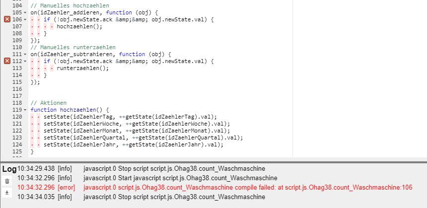

      on(idZaehler_addieren, function (obj) {
      if (!obj.newState.ack && obj.newState.val) {
      hochzaehlen();
      // Manuelles runterzaehlen
      on(idZaehler_subtrahieren, function (obj) {
      runterzaehlen();

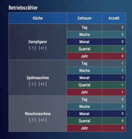

      Habe drei Skripts für drei Geräte. Entsprechend hier ein Tabelle für VIS mit +/- Steuerung zur manuellen Korrektur:
      ! [{"tpl":"tplBasicState","data":{"oid":"javascript.0.Status.Spuelmaschine.Zaehler.addieren","visibility-cond":"==","visibility-val":1,"value":"true","html":"[ +1 ]","name":"Zähler Spülmaschine erhöhen","class":""},"style":{"left":211,"top":1494,"z-index":"40","color":"rgba(250,250,250,0.6)","font-family":"RobotoCondensed-Regular, Futura","font-style":"","font-size":"14px","width":"auto","height":"auto"},"widgetSet":"basic"},{"tpl":"tplBasicState","data":{"oid":"javascript.0.Status.Spuelmaschine.Zaehler.subtrahieren","visibility-cond":"==","visibility-val":1,"value":"true","html":"[ -1 ]","name":"Zähler Spülmaschine vermindern","class":""},"style":{"left":177,"top":1494,"z-index":"40","color":"rgba(250,250,250,0.6)","font-family":"RobotoCondensed-Regular, Futura","font-style":"","font-size":"14px","width":"auto","height":"auto"},"widgetSet":"basic"},{"tpl":"tplBasicState","data":{"oid":"javascript.0.Status.Waschmaschine.Zaehler.subtrahieren","visibility-cond":"==","visibility-val":1,"value":"true","html":"[ -1 ]","name":"Zähler Waschmaschine vermindern","class":""},"style":{"left":177,"top":1619,"z-index":"40","color":"rgba(250,250,250,0.6)","font-family":"RobotoCondensed-Regular, Futura","font-style":"","font-size":"14px","width":"auto","height":"auto"},"widgetSet":"basic"},{"tpl":"tplBasicState","data":{"oid":"javascript.0.Status.Waschmaschine.Zaehler.addieren","visibility-cond":"==","visibility-val":1,"value":"true","html":"[ +1 ]","name":"Zähler Waschmaschine erhöhen","class":""},"style":{"left":211,"top":1619,"z-index":"40","color":"rgba(250,250,250,0.6)","font-family":"RobotoCondensed-Regular, Futura","font-style":"","font-size":"14px","width":"auto","height":"auto"},"widgetSet":"basic"},{"tpl":"tplBasicState","data":{"oid":"javascript.0.Status.Dampfgarer.Zaehler.subtrahieren","visibility-cond":"==","visibility-val":1,"value":"true","html":"[ -1 ]","name":"Zähler Dampfgarer vermindern","class":""},"style":{"left":177,"top":1369,"z-index":"40","color":"rgba(250,250,250,0.6)","font-family":"RobotoCondensed-Regular, Futura","font-style":"","font-size":"14px","width":"auto","height":"auto"},"widgetSet":"basic"},{"tpl":"tplBasicState","data":{"oid":"javascript.0.Status.Dampfgarer.Zaehler.addieren","visibility-cond":"==","visibility-val":1,"value":"true","html":"[ +1 ]","name":"Zähler Dampfgarer erhöhen","class":""},"style":{"left":211,"top":1369,"z-index":"40","color":"rgba(250,250,250,0.6)","font-family":"RobotoCondensed-Regular, Futura","font-style":"","font-size":"14px","width":"auto","height":"auto"},"widgetSet":"basic"},{"tpl":"tplHtml","data":{"visibility-cond":"==","visibility-val":1,"refreshInterval":"0","html":"\n\n\n\n\n\n \n \n \n \n \n\n\n\n \n \n \n \n \n \n \n \n \n \n \n \n \n \n \n \n \n \n \n \n \n \n \n \n \n \n \n \n \n \n \n \n \n \n \n \n \n \n \n \n \n \n \n \n \n \n \n \n\n \n \n \n \n \n \n \n \n \n \n \n \n \n \n \n \n \n \n \n \n \n \n \n\n\n","name":"Tabelle"},"style":{"left":"106px","top":"1221px","z-index":"20","color":"rgba(250,250,250,1);","font-family":"","width":"auto","height":"auto","font-size":"12px"},"widgetSet":"basic"}] ! Und hier die CSS dazu: ! >!
      /* --- Tabelle Anzahl / Zaehler (wie Strom)/
      #anzahl {
      text-align: center;
      border-collapse: collapse; /
      kein Doppelrand, sonst "seperate"/
      line-height: 100%;
      font-family: RobotoCondensed-Regular, Futura;
      ! #anzahl thead {
      font-size: 120%;
      text-align: center;
      margin: 0 0 10px 0;
      ! #anzahl caption { /
      Raumnamen /
      font-size: 150%;
      text-align: left;
      margin: 10px 0 10px 0;
      Grösse /
      /Geräte Spalte/
      #anzahl td.anzahl_Messpunkt,
      #anzahl th.anzahl_Messpunkt {
      width: 200px;
      height: auto;
      font-size: 14px;
      font-weight: normal;
      /color: red;/
      ! /Zeitraum Spalte/
      #anzahl td.anzahl_Zeitraum,
      #anzahl th.anzahl_Zeitraum {
      width: 120px;
      font-size: 14px;
      /color: green;/
      ! /Anzahl Spaltenüberschrift/
      #anzahl th:nth-child(3) {
      width: 80px;
      height: auto;
      font-size: 14px;
      /color: yellow;/
      ! /Zahlen rechtsbündig mit Padding zum Rand/
      #anzahl tr.anzahl_Zeitraum_aktuell td,
      #anzahl tr.anzahl_Zeitraum_Tag td,
      #anzahl tr.anzahl_Zeitraum_Woche td,
      #anzahl tr.anzahl_Zeitraum_Monat td,
      #anzahl tr.anzahl_Zeitraum_Quartal td,
      #anzahl tr.anzahl_Zeitraum_Jahr td{
      text-align: right;
      padding-right: 0.7em;
      padding-top: 0.5em;
      padding-bottom: 0.5em;
      ! #anzahl .anzahl_Spaltentitel { /Spaltentitel/
      line-height: 250%;
      Farben /
      #anzahl,
      #anzahl th,
      #anzahl td {
      border: 1px solid grey;
      #anzahl th {
      color: rgba(250,250,250,1);
      font-weight: 800;/
      ! #anzahl td {
      color: rgba(220,220,220,1);
      font-weight: 400; /
      background: rgba(000,100,200,0.5); /
      blau /
      ! tbody.anzahl_kueche {
      background: rgba(80,80,80,0.4);
      Dampfgarer /
      #anzahl tr:nth-child(2) {
      background: rgba(200,200,200,0.25);
      Spülmaschine /
      #anzahl tr:nth-child(6) {
      background: rgba(200,200,200,0.1);
      Waschmaschine /
      #anzahl tr:nth-child(11) {
      Zeiträume */
      #anzahl tr.anzahl_Zeitraum_Tag {
      background: rgba(0,250,0,0.2);
      ! #anzahl tr.anzahl_Zeitraum_Woche {
      background: rgba(0,200,200,0.2);
      ! #anzahl tr.anzahl_Zeitraum_Monat{
      background: rgba(0,0,80,0.5);
      ! #anzahl tr.anzahl_Zeitraum_Quartal {
      background: rgba(0,150,0,0.2);
      ! #anzahl tr.anzahl_Zeitraum_Jahr {
      background: rgba(180,0,0,0.5);
      ! ! Vielleicht kann es jemand brauchen. ! Gruß ! Pix ! 02.01.2016 zweite Version mit manuellen Korrekturmöglichkeit der Zählerstände über VIS-Widgets (+/-) ! Fehler getState bei Pushsendung korrigiert ! <caption>Betriebszähler</caption> | Küche | Zeitraum | Anzahl | | --- | --- | --- | | Dampfgarer | Tag | {javascript.0.Status.Dampfgarer.Zaehler.Tag} | | Woche | {javascript.0.Status.Dampfgarer.Zaehler.Woche} | | Monat | {javascript.0.Status.Dampfgarer.Zaehler.Monat} | | Quartal | {javascript.0.Status.Dampfgarer.Zaehler.Quartal} | | Jahr | {javascript.0.Status.Dampfgarer.Zaehler.Jahr} | | Spülmaschine | Tag | {javascript.0.Status.Spuelmaschine.Zaehler.Tag} | | Woche | {javascript.0.Status.Spuelmaschine.Zaehler.Woche} | | Monat | {javascript.0.Status.Spuelmaschine.Zaehler.Monat} | | Quartal | {javascript.0.Status.Spuelmaschine.Zaehler.Quartal} | | Jahr | {javascript.0.Status.Spuelmaschine.Zaehler.Jahr} | | Waschmaschine | Tag | {javascript.0.Status.Waschmaschine.Zaehler.Tag} | | Woche | {javascript.0.Status.Waschmaschine.Zaehler.Woche} | | Monat | {javascript.0.Status.Waschmaschine.Zaehler.Monat} | | Quartal | {javascript.0.Status.Waschmaschine.Zaehler.Quartal} | | Jahr | {javascript.0.Status.Waschmaschine.Zaehler.Jahr} | !
        filename="Bildschirmfoto 2016-01-02 um 13.45.32.jpg" index="0">~~

        ! ! Vielleicht kann es jemand brauchen. ! Gruß ! Pix ! 02.01.2016 zweite Version mit manuellen Korrekturmöglichkeit der Zählerstände über VIS-Widgets (+/-) ! Fehler getState bei Pushsendung korrigiert ! Hallo Pix ! wollte gerade dein Script hier bei mir implementieren, aber frage mich gerade was im Script die ! ` > // aus Status_Geraete.js ` ! bedeuten soll? Ist das ein separates Script?!? :? ! danke schon mal in voraus ! <caption>Betriebszähler</caption> | Küche | Zeitraum | Anzahl | | --- | --- | --- | | Dampfgarer | Tag | {javascript.0.Status.Dampfgarer.Zaehler.Tag} | | Woche | {javascript.0.Status.Dampfgarer.Zaehler.Woche} | | Monat | {javascript.0.Status.Dampfgarer.Zaehler.Monat} | | Quartal | {javascript.0.Status.Dampfgarer.Zaehler.Quartal} | | Jahr | {javascript.0.Status.Dampfgarer.Zaehler.Jahr} | | Spülmaschine | Tag | {javascript.0.Status.Spuelmaschine.Zaehler.Tag} | | Woche | {javascript.0.Status.Spuelmaschine.Zaehler.Woche} | | Monat | {javascript.0.Status.Spuelmaschine.Zaehler.Monat} | | Quartal | {javascript.0.Status.Spuelmaschine.Zaehler.Quartal} | | Jahr | {javascript.0.Status.Spuelmaschine.Zaehler.Jahr} | | Waschmaschine | Tag | {javascript.0.Status.Waschmaschine.Zaehler.Tag} | | Woche | {javascript.0.Status.Waschmaschine.Zaehler.Woche} | | Monat | {javascript.0.Status.Waschmaschine.Zaehler.Monat} | | Quartal | {javascript.0.Status.Waschmaschine.Zaehler.Quartal} | | Jahr | {javascript.0.Status.Waschmaschine.Zaehler.Jahr} | ! `

              al-79 last edited by
              wollte dieses Script gerade auch einbauen - habe dies von der iobroker-Seite und dort die Scripte Sammlung….
              Leider erhalte ich schon beim copy&paste folgende Hinweise / Fehler (die mit dem roten Kreuz)
              Nach dem starten des Scriptes erfolgt dann die untere zusätzliche Fehlermeldung...
                tempestas last edited by
                &, damit kann das Skript nichts anfangen.
                Dr. Google hilft auch hier weiter:
                https://wiki.selfhtml.org/wiki/HTML/Reg … ne_Zeichen
                -->&&eintragen statt````
                Wenn du oben ins Skript schaust, siehst du auch, dass da nicht && steht.
