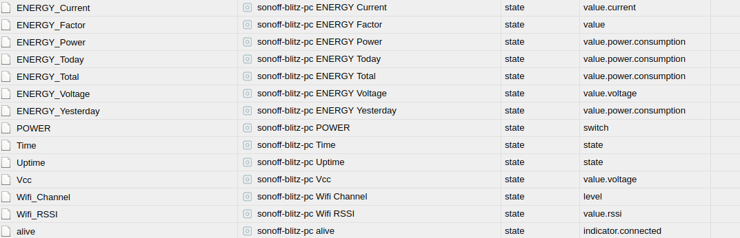

            Hi
            mir sind gerade ein paar Logs aufgefallen:
            sourceanalytix.0	2019-02-06 12:24:00.200	info	Object array of trigger : {"type":"state","common":{"name":"Letzte Regeneration Über","type":"number","role":"number","desc":"Letzte Regeneration Über","read":true,"write":true,"def":0,"min":0,"unit"
            sourceanalytix.0	2019-02-06 12:24:00.200	info	Object array from trigger : ["smartmeter.0.1-0:1_8_0_255.value","smartmeter.1.1_8_1.value"]
            sourceanalytix.0	2019-02-06 12:24:00.200	info	Object array of trigger : {"type":"state","common":{"name":"Letzte Regeneration","type":"string","role":"string","desc":"Letzte Regeneration vor x h","read":true,"write":true,"def":0,"min":0,"unit":"
            sourceanalytix.0	2019-02-06 12:24:00.199	info	Object array from trigger : ["smartmeter.0.1-0:1_8_0_255.value","smartmeter.1.1_8_1.value"]
            sourceanalytix.0	2019-02-06 12:24:00.199	info	Object array of trigger : {"type":"state","common":{"name":"Restzeit/-menge Reg.Schritt","type":"number","role":"number","desc":"Restzeit/-menge Reg.Schritt","read":true,"write":true,"def":0,"min":0,
            sourceanalytix.0	2019-02-06 12:24:00.199	info	Object array of trigger : {"type":"state","common":{"name":"Kapazitätszahl","type":"number","role":"number","desc":"Kapazitätszahl","read":true,"write":true,"def":0,"min":0,"unit":"m³*°dH"},"from":"s
            sourceanalytix.0	2019-02-06 12:24:00.197	info	Object array from trigger : ["smartmeter.0.1-0:1_8_0_255.value","smartmeter.1.1_8_1.value"]
            sourceanalytix.0	2019-02-06 12:24:00.197	info	Object array of trigger : {"type":"state","common":{"name":"Restkapazität","type":"number","role":"number","desc":"Restkapazität","read":true,"write":true,"def":0,"min":0,"unit":"m³*°dH"},"from":"sys
            sourceanalytix.0	2019-02-06 12:24:00.197	info	Object array of trigger : {"type":"state","common":{"name":"Aktueller Durchfluss","type":"number","role":"number","desc":"Aktueller Durchfluss","read":true,"write":true,"def":0,"min":0,"unit":"m³/h",
            sourceanalytix.0	2019-02-06 12:24:00.196	info	Object array from trigger : ["smartmeter.0.1-0:1_8_0_255.value","smartmeter.1.1_8_1.value"]
            sourceanalytix.0	2019-02-06 12:24:00.196	info	Object array of trigger : {"type":"state","common":{"name":"Regeneration aktiv","type":"number","role":"number","desc":"Regeneration aktiv","read":true,"write":true,"def":0,"min":0,"unit":""},"from":
            sourceanalytix.0	2019-02-06 12:24:00.193	info	Object array of trigger : {"type":"state","common":{"name":"Voraussichtliche nächste Regeneration","type":"string","role":"string","desc":"Voraussichtliche nächste Regeneration","read":true,"write":t
            sourceanalytix.0	2019-02-06 12:24:00.192	info	Object array from trigger : ["smartmeter.0.1-0:1_8_0_255.value","smartmeter.1.1_8_1.value"]
            sourceanalytix.0	2019-02-06 12:24:00.192	info	Object array of trigger : {"type":"state","common":{"name":"0= Austauscher gestört/in Regeneration 1= Austauscher in Betrieb","type":"number","role":"number","desc":"0= Austauscher gestört/in Regener
            sourceanalytix.0	2019-02-06 12:24:00.192	info	Object array of trigger : {"type":"state","common":{"name":"Aktuelle Restkapazität Austauscher","type":"number","role":"number","desc":"Aktuelle Restkapazität Austauscher","read":true,"write":true,"d
            sourceanalytix.0	2019-02-06 12:24:00.192	info	Object array of trigger : {"type":"state","common":{"name":"Ergebnis letzter E-Mail Versand 0=keine Mail versandt 1=Mail erfolgreich versandt 2=Benutzerdaten fehlerhaft 3= kein Internetzugang/Server
            sourceanalytix.0	2019-02-06 12:24:00.191	info	Object array from trigger : ["smartmeter.0.1-0:1_8_0_255.value","smartmeter.1.1_8_1.value"]
            warum "vergreift" sich denn sourceanalytix an meiner Wasserenthärtungsanlage?
            Eigestellt ist bei den Datenpunkten nichts

                Mal ne blöde Fragen..
                Welchen Datenpunkt muss ich loggen um eine Tägliche / Monatliche /Jährliche Auswertung zu erhalten?
                Vermutlich ENERGY_TODAY?
                Oder passiert das Live mit Current?
                ![](</s><URL url=)https://i.postimg.cc/xTktVh29/Download.png" />
                • Homer.J.
                  Homer.J. last edited by
                  @UncleB:
                  ![](</s><URL url=)https://i.postimg.cc/xTktVh29/Download.png" /> ` Energy total Rest geht von alleine.
