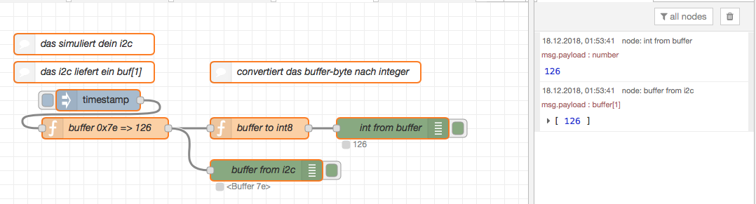

        Du musst also lediglich dein bufferbyte zurück nach int8 konvertieren, das kannst du z.B. so machen:
        [{"id":"5a33628b.2780dc","type":"function","z":"6afed17e.ffe838","name":"buffer 0x7e => 126 ","func":"var buf = new Buffer(1);\nbuf.writeInt8(0x7e, 0);\nmsg.payload = buf;\nreturn msg;","outputs":1,"noerr":0,"x":390,"y":180,"wires":[["cac70295.1dfce","fd7a7c41.1e68e8"]]},{"id":"edfe5e88.96bd2","type":"inject","z":"6afed17e.ffe838","name":"","topic":"","payload":"","payloadType":"date","repeat":"","crontab":"","once":false,"onceDelay":0.1,"x":380,"y":140,"wires":[["5a33628b.2780dc"]]},{"id":"cac70295.1dfce","type":"function","z":"6afed17e.ffe838","name":"buffer to int8","func":"msg.payload = msg.payload.readInt8();\nreturn msg;","outputs":1,"noerr":0,"x":610,"y":180,"wires":[["9a8a088a.f95868"]]},{"id":"9a8a088a.f95868","type":"debug","z":"6afed17e.ffe838","name":"int from buffer","active":true,"tosidebar":true,"console":false,"tostatus":true,"complete":"payload","x":800,"y":180,"wires":[]},{"id":"fd7a7c41.1e68e8","type":"debug","z":"6afed17e.ffe838","name":"buffer from i2c","active":true,"tosidebar":true,"console":false,"tostatus":true,"complete":"payload","x":620,"y":240,"wires":[]},{"id":"6aff5297.e075e4","type":"comment","z":"6afed17e.ffe838","name":"das simuliert dein i2c","info":"","x":360,"y":60,"wires":[]},{"id":"8f89ae3f.6c71e","type":"comment","z":"6afed17e.ffe838","name":"das i2c liefert ein buf[1]","info":"","x":360,"y":100,"wires":[]},{"id":"95fc6ee4.aafac","type":"comment","z":"6afed17e.ffe838","name":"convertiert das buffer-byte nach integer","info":"","x":690,"y":100,"wires":[]}]
         ![3999_i2c.png](/assets/uploads/files/3999_i2c.png)
        Du musst eigentlich nur das mittlere function-node an dein i2c node hängen und gut is.
        Ich konnte jetzt nicht prüfen, ob das i2c das payload selber als buffer liefert (gehe ich mal von aus) oder ob es den buffer da als property innerhalb von payload gibt.
