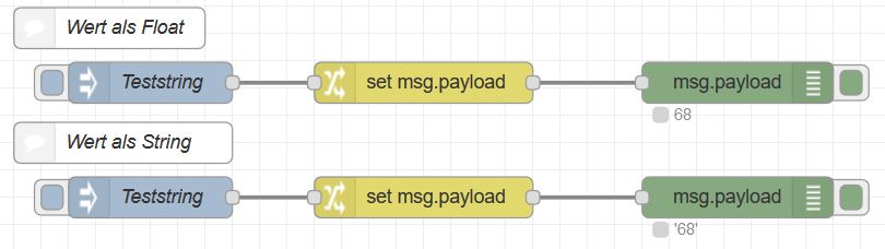

          Und hier noch die Lösung mit einem change-Node. Damit tue ich mich noch etwas schwerer. Aber ich lerne täglich dazu.
          [{"id":"1233a82b.0f69f8","type":"change","z":"3f55344e.eced9c","name":"","rules":[{"t":"set","p":"payload","pt":"msg","to":"(\t$n := $substringAfter(payload, "strValue=");\t$n2 := $substringBefore($n, " unit");\t$n3 := $substring($n2, 1);\t$l := $length($n3)-1;\t$n4 := $substring($n3, -0, $l);\t$nf := $number($n4);\t)","tot":"jsonata"}],"action":"","property":"","from":"","to":"","reg":false,"x":360,"y":676,"wires":[["ec0f7be6.0f69b"]]},{"id":"3f388d3c.679f92","type":"inject","z":"3f55344e.eced9c","name":"Teststring","topic":"","payload":" <eta version="&quot;1.0&quot;" xmlns="&quot;http://www.eta.co.at/rest/v1&quot;"><value uri="&quot;//user/var/120/10601/0/0/13434&quot;" strvalue="&quot;68&quot;" unit="&quot;°C&quot;" decplaces="&quot;0&quot;" scalefactor="&quot;10&quot;" advtextoffset="&quot;0&quot;">680</value></eta>","payloadType":"str","repeat":"","crontab":"","once":false,"onceDelay":0.1,"x":160,"y":676,"wires":[["1233a82b.0f69f8"]]},{"id":"ec0f7be6.0f69b","type":"debug","z":"3f55344e.eced9c","name":"","active":true,"tosidebar":true,"console":false,"tostatus":true,"complete":"payload","x":590,"y":676,"wires":[]},{"id":"b424926b.04b468","type":"comment","z":"3f55344e.eced9c","name":"Wert als Float","info":"","x":130,"y":636,"wires":[]},{"id":"2f5177.8ac9f68a","type":"change","z":"3f55344e.eced9c","name":"","rules":[{"t":"set","p":"payload","pt":"msg","to":"(\t$n := $substringAfter(payload, "strValue=");\t$n2 := $substringBefore($n, " unit");\t$n3 := $substring($n2, 1);\t$l := $length($n3)-1;\t$n4 := $substring($n3, -0, $l);\t)","tot":"jsonata"}],"action":"","property":"","from":"","to":"","reg":false,"x":360,"y":760,"wires":[["46bccbb1.e5a214"]]},{"id":"2448112.7f9af6e","type":"inject","z":"3f55344e.eced9c","name":"Teststring","topic":"","payload":" <eta version="&quot;1.0&quot;" xmlns="&quot;http://www.eta.co.at/rest/v1&quot;"><value uri="&quot;//user/var/120/10601/0/0/13434&quot;" strvalue="&quot;68&quot;" unit="&quot;°C&quot;" decplaces="&quot;0&quot;" scalefactor="&quot;10&quot;" advtextoffset="&quot;0&quot;">680</value></eta>","payloadType":"str","repeat":"","crontab":"","once":false,"onceDelay":0.1,"x":160,"y":760,"wires":[["2f5177.8ac9f68a"]]},{"id":"46bccbb1.e5a214","type":"debug","z":"3f55344e.eced9c","name":"","active":true,"tosidebar":true,"console":false,"tostatus":true,"complete":"payload","x":590,"y":760,"wires":[]},{"id":"2f50c72e.a10b8","type":"comment","z":"3f55344e.eced9c","name":"Wert als String","info":"","x":140,"y":720,"wires":[]}]
           ![3639_sc23.jpg](/assets/uploads/files/3639_sc23.jpg)

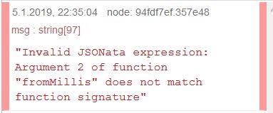

            danke für deine Hilfe, ich habe den Function Node gewählt und an sich funktioniert es soweit schon was jedoch noch nicht passt und ich selbst auch nicht hinbekomme ist die folgende Fehlermeldung. Aus meiner Sicht liegt es daran, dass es ein JSON Ausdruck und keine Number ist - die Änderung hat bei mir aber leider nicht geklappt.
            Invalid JSONata expression: Unable to cast value to a number: "?xml version=\"1.0\" encoding=\"utf-8\"?>\n<eta version="\&quot;1.0\&quot;" xmlns="\&quot;http://www.eta.co.at/rest/v1\&quot;">\n  <error>Invalid permission</error>\n</eta>"

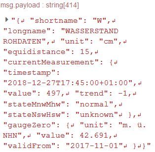

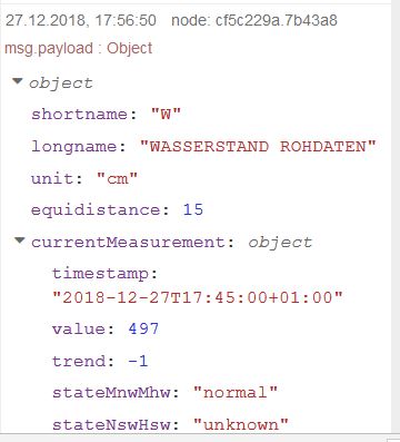

              Ich habe mir noch einmal Gedanken gemacht. Wahrscheinlich frägst Du über das http-Node Daten ab. Die Rückmeldewerte werden dir im Json-Format zur Verfügung gestellt. Um daraus jetzt ein String zu machen gibt es ein fertiges Node.
              Nur den ganzen Budenzauber braucht man nicht, da man die JSON-Werte direkt als Variable verarbeiten kann.
              Ich habe es mal an einem einfachen Beispiel versucht nachzustellen:
              Abfrage des Rheinpegels
              Die JSON-Daten kann man direkt als Wert übernehmen.
              Der Wert steht in meinem Beispiel für den Rheinpegelstand (value:) in der Variablen: msg.payload.gaugeZero.value

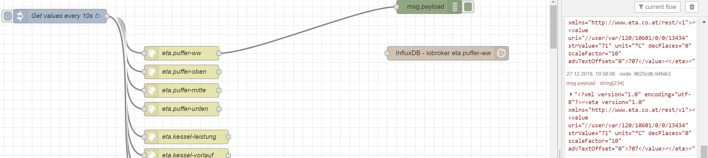

                anbei meine hoffentlich konkreteren Punkte:
                Ich frage zyklisch über einen http request node meine Heizungssteuerung ab. Der http request Node liefert mir einen XML-String zurück aus welchem ich einen Wert (strValue) als Number benötige. Dieser Wert soll dann in influxDB geschrieben werden
                XML in Heizungssteuerung
                 <eta xmlns="http://www.eta.co.at/rest/v1" version="1.0"><value uri="//user/var/120/10601/0/0/13434" strvalue="71" unit="°C" decplaces="0" scalefactor="10" advtextoffset="0">708</value></eta>
                String aus http request node
                 <eta version="1.0" xmlns="http://www.eta.co.at/rest/v1"><value uri="//user/var/120/10601/0/0/13434" strvalue="71" unit="°C" decplaces="0" scalefactor="10" advtextoffset="0">707</value></eta>
                Meine Problemstellung, welche ich nicht gelöst bekomme ist dass ich aus diesem String den Wert von strValue als Number zur Übergabe in influxDB benötige und keinen Plan habe wie ich da hinkommen soll. Eventuell ist mein Ansatz mit dem http request node auch schon nicht der richtige?!?

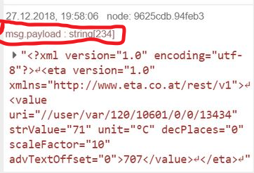

                    Garf last edited by
                    O.K. versuchen wir es weiter.
                    Halten wir fest: wir haben als Rückmeldung mit einem Stringwert zu tun.
                    Bitte hänge an das http-Node entweder das function-Node, oder eins von den change-Nodes und dann ein debug-Node, damit wir uns die Ausgabe ansehen können. Das Node für die influx-DB kenne ich nicht, da müssen wir mal schauen wie und in welchem Format die Daten übergeben werden müssen. Ich benutze als DB phpMyAdmin und aus Erfahrung kann ich dir sagen, dass die Werteübergabe absolut fehlerfrei erfolgen muss.
                    Daher bitte erst einmal ohne die Anbindung an die Datenbank testen. Da müssen wir sicher im function-Node noch etwas an der Ausgabe arbeiten.

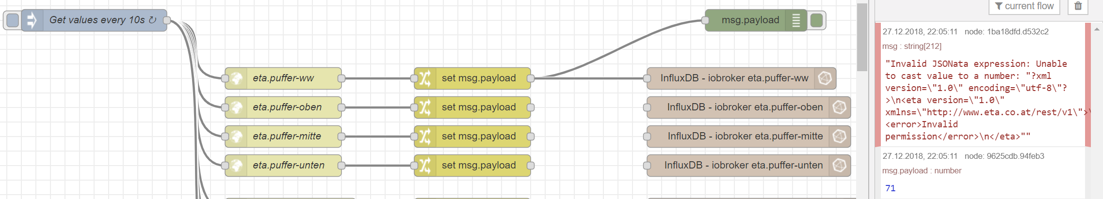

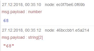

                      andreasploetz last edited by
                      Hallo ihr beiden,
                      lustigerweise funktioniert nun der angehängte Flow. D.h. es werden Werte (strValue) als Number in influxDB geschrieben, trotzdem bekomme ich immer noch einen Fehler im Debug. Den Change Node habe ich von dir übernommen und nicht geändert.
                      Aber warum bekomme ich da jetzt einen Fehler aber in der Datenbank kommt der Wert richtig als Number an?!?

                        Garf last edited by
                        Du müsstest mal nachsehen von welchem Node die Fehlermeldung kommt.
                        Die zweite Meldung kommt mit Sicherheit aus dem debug-Node.
                        Dafür mal auf die Nummer hinter Node: in der Message klicken, dann erhält das fehlermeldende Node einen gestrichelten Rahmen.
