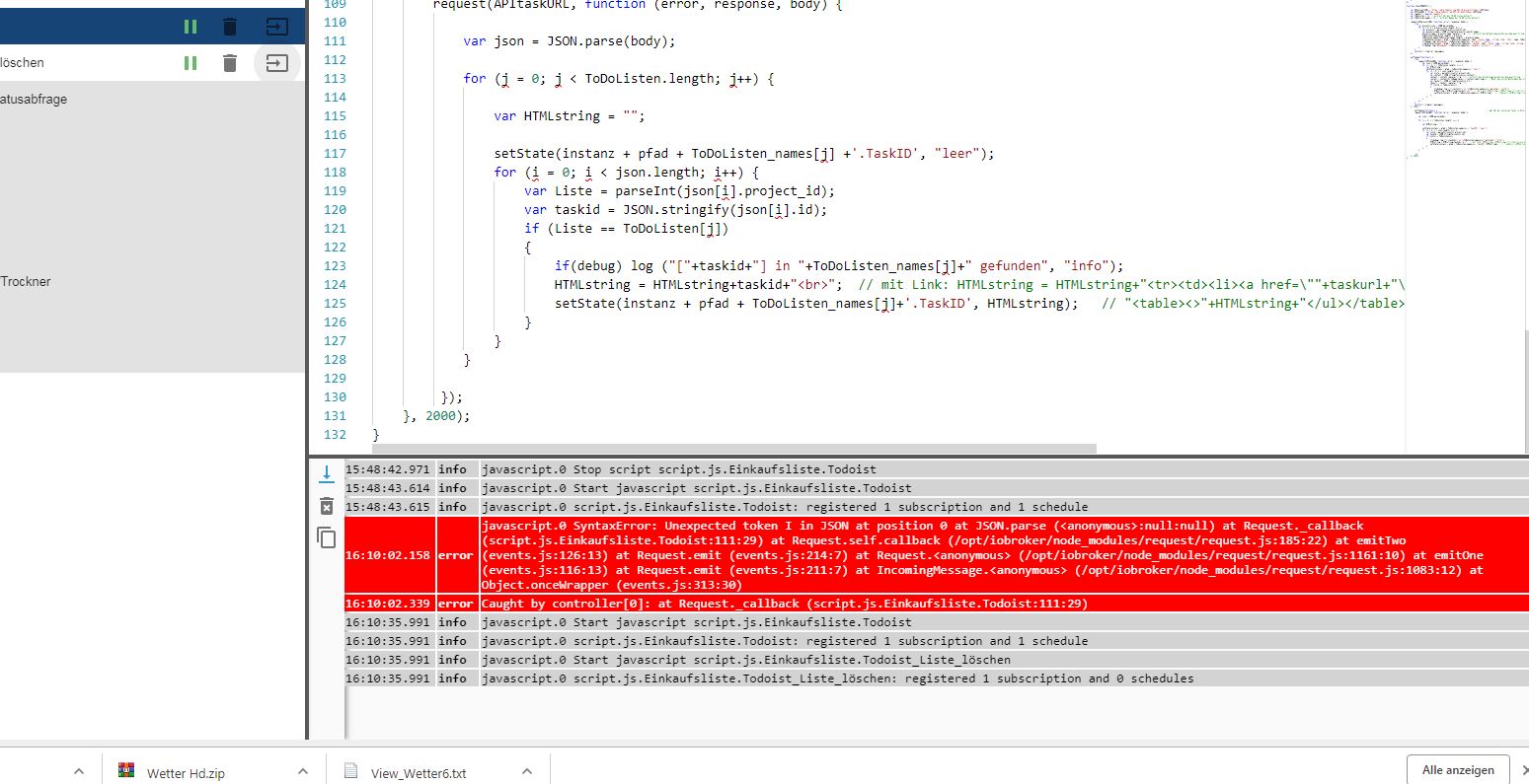

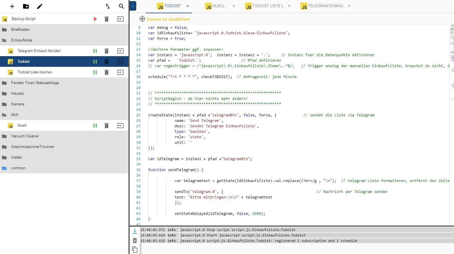

      Hier ein paar Screenshots
      DasWetter und todoist
      LOG
      >! ~~[spoiler]~~2019-01-06 04:00:02.513 - error: javascript.0 uncaught exception: Unexpected token I in JSON at position 0
      >! 2019-01-06 04:00:02.513 - error: javascript.0 SyntaxError: Unexpected token I in JSON at position 0
      >! at JSON.parse (:null:null)
      >! at Request._callback (script.js.Einkaufsliste.Todoist:112:29)
      >! at Request.self.callback (/opt/iobroker/node_modules/iobroker.javascript/node_modules/request/request.js:185:22)
      >! at emitTwo (events.js:126:13)
      >! at Request.emit (events.js:214:7)
      >! at Request. (/opt/iobroker/node_modules/iobroker.javascript/node_modules/request/request.js:1161:10)
      >! at emitOne (events.js:116:13)
      >! at Request.emit (events.js:211:7)
      >! at IncomingMessage. (/opt/iobroker/node_modules/iobroker.javascript/node_modules/request/request.js:1083:12)
      >! at Object.onceWrapper (events.js:313:30)
      >! 2019-01-06 04:00:02.712 - info: javascript.0 terminating
      >! 2019-01-06 04:00:02.734 - debug: daswetter.0 statesDB connected
      >! 2019-01-06 04:00:02.738 - info: dwd.0 starting. Version 2.4.3 in /opt/iobroker/node_modules/iobroker.dwd, node: v8.14.0
      >! 2019-01-06 04:00:03.560 - error: Caught by controller[0]: SyntaxError: Unexpected token I in JSON at position 0
      >! 2019-01-06 04:00:03.560 - error: Caught by controller[0]: at JSON.parse (:null:null)
      >! 2019-01-06 04:00:03.560 - error: Caught by controller[0]: at Request._callback (script.js.Einkaufsliste.Todoist:112:29)
      >! 2019-01-06 04:00:03.560 - error: Caught by controller[0]: at Request.self.callback (/opt/iobroker/node_modules/iobroker.javascript/node_modules/request/request.js:185:22)
      >! 2019-01-06 04:00:03.560 - error: Caught by controller[0]: at emitTwo (events.js:126:13)
      >! 2019-01-06 04:00:03.560 - error: Caught by controller[0]: at Request.emit (events.js:214:7)
      >! 2019-01-06 04:00:03.560 - error: Caught by controller[0]: at Request. (/opt/iobroker/node_modules/iobroker.javascript/node_modules/request/request.js:1161:10)
      >! 2019-01-06 04:00:03.560 - error: Caught by controller[0]: at emitOne (events.js:116:13)
      >! 2019-01-06 04:00:03.560 - error: Caught by controller[0]: at Request.emit (events.js:211:7)
      >! 2019-01-06 04:00:03.560 - error: Caught by controller[0]: at IncomingMessage. (/opt/iobroker/node_modules/iobroker.javascript/node_modules/request/request.js:1083:12)
      >! 2019-01-06 04:00:03.560 - error: Caught by controller[0]: at Object.onceWrapper (events.js:313:30)
      >! 2019-01-06 04:00:03.560 - error: host.debianiobroker instance system.adapter.javascript.0 terminated with code 0 (OK)[/spoiler]
        [4720_2000.jpg](/assets/uploads/files/4720_2000.jpg)
        [4720_2001.jpg](/assets/uploads/files/4720_2001.jpg)
        [4720_2010.jpg](/assets/uploads/files/4720_2010.jpg)  [/i][/i][/i][/i][/i]

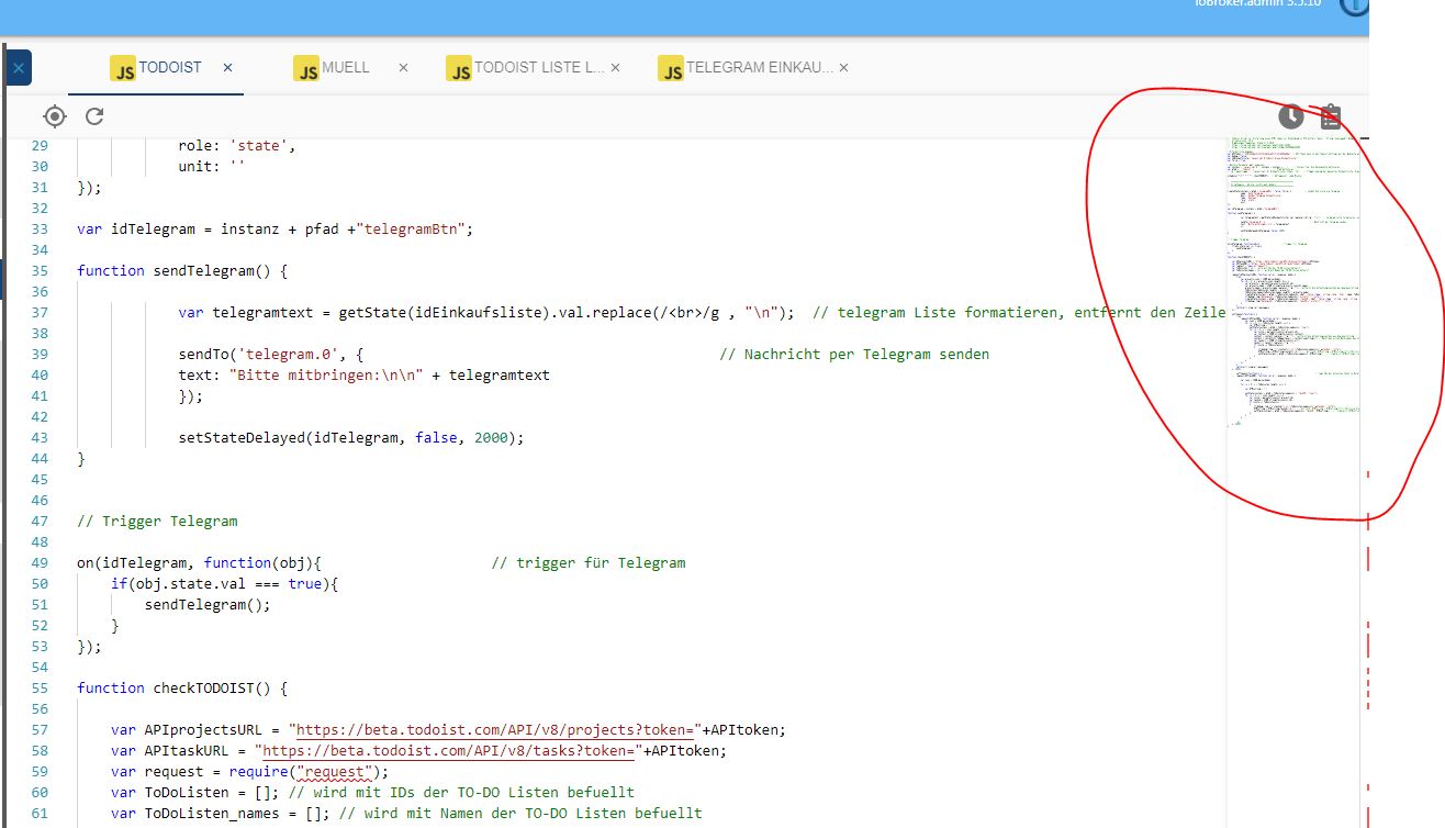

      • wendy2702
        wendy2702 last edited by
        Ich nutze das Script nicht aber hast du im JavaScript Editor mal geschaut ob es irgendwelche Fehlermeldungen gibt?
        Werden bei DasWetter die Werte denn noch aktualisiert?
        Ich sehe auf dem Screenshot (bitte besser logs als TXT posten) auf Anhieb keinen Fehler. Würde den Log Level für Das Wetter mal wieder in „Info“ ändern.
        • thexbrain
          thexbrain last edited by
          Im JavaScript Editor sehe ich keine Fehlermeldungen.
          Bei DasWetter werden die Werte aktualisiert. Ich habe es jetzt in info geändert.
          • wendy2702
            Auch nicht wenn du im rechten Fenster scrollst?
            Ich komme erst morgen an einen PC zum testen. Am IPad ist das bescheiden.
            • thexbrain
              @wendy2702:
              Ich komme erst morgen an einen PC zum testen. Am IPad ist das bescheiden. `
              Du meinst in dem kleinen rechten Fenster?
              Nein da auch nicht.
              • wendy2702
                Ist das die neue JavaScript Version 4.0.x ?
                Meinte das Fenster in dem das Script steht.
