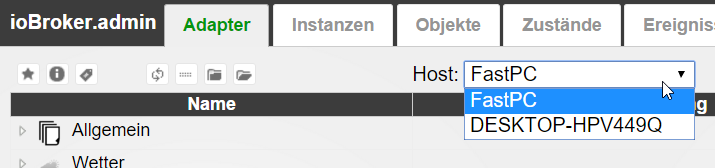

                          • Bluefox
                            Bluefox last edited by
                            @tom57:
                            Schade, dass ich Nodered nicht 2-mal installieren kann. `
                            sollte gehen. Hast du bei der Erzeugung vom Instanz richtigen Host ausgewählt?

                              • Bluefox
                                @tom57:
                                Hallo Bluefox,
                                Wie installiere ich denn Nodered 2 Mal?
                                Im Admin-Menü wird nicht nach dem Host gefragt und ich bekomme die Meldung: … siehe screenshot.
                                In der Shell auf rasp1 (dort ist die erste node-red Instanz installiert): `
                                Du kannst vor dem "+" drucken erst Host auswählen:

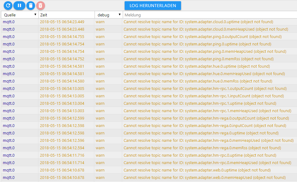

                                        was bedeuten diesen ganzen "Fehler" ?
                                        mqtt.0	2017-07-04 16:33:12.716	warn	Cannot resolve topic name for ID: undefined (object not found)
                                        mqtt.0	2017-07-04 16:33:04.836	warn	Cannot resolve topic name for ID: null (object not found)
                                        mqtt.0	2017-07-04 15:06:44.860	warn	Cannot resolve topic name for ID: undefined (object not found)
                                        mqtt.0	2017-07-04 15:06:43.706	warn	Cannot resolve topic name for ID: undefined (object not found)
                                        mqtt.0	2017-07-04 15:06:34.663	warn	Cannot resolve topic name for ID: null (object not found)
                                        mqtt.0	2017-07-04 15:05:41.290	warn	Cannot resolve topic name for ID: web.0.connected (object not found)
                                        mqtt.0	2017-07-04 15:05:41.252	warn	Cannot resolve topic name for ID: undefined (object not found)
                                        mqtt.0	2017-07-04 15:05:33.586	warn	Cannot resolve topic name for ID: null (object not found)
                                        mqtt.0	2017-07-04 15:03:20.643	warn	Cannot resolve topic name for ID: web.0.connected (object not found)
                                        mqtt.0	2017-07-04 15:03:20.641	warn	Cannot resolve topic name for ID: web.0.connected (object not found)
                                        mqtt.0	2017-07-04 15:03:20.639	warn	Cannot resolve topic name for ID: web.0.connected (object not found)
                                        mqtt.0	2017-07-04 15:03:18.741	warn	Cannot resolve topic name for ID: web.0.connected (object not found)
                                        mqtt.0	2017-07-04 15:03:18.738	warn	Cannot resolve topic name for ID: web.0.connected (object not found)
                                        mqtt.0	2017-07-04 15:03:18.735	warn	Cannot resolve topic name for ID: web.0.connected (object not found)
                                        mqtt.0	2017-07-04 15:03:13.988	warn	Cannot resolve topic name for ID: undefined (object not found)
                                        mqtt.0	2017-07-04 15:02:50.346	warn	Cannot resolve topic name for ID: null (object not found)
                                        mqtt.0	2017-07-04 14:59:27.600	warn	Cannot resolve topic name for ID: web.0.connected (object not found)
                                          mikiline last edited by
                                          auch nochmals nachgefragt…... wie bekomm ich das aus dem Log raus?
                                          Benutze den MQTT nur für meinen Sonoff......
                                            sorry für den PUSH aber ich hab das Zeug als warn im Log und das nervt.
                                            Wieso kommen diese überhaput? Kann ich das abstellen (ohne den Adapter zu deaktivieren :P)
