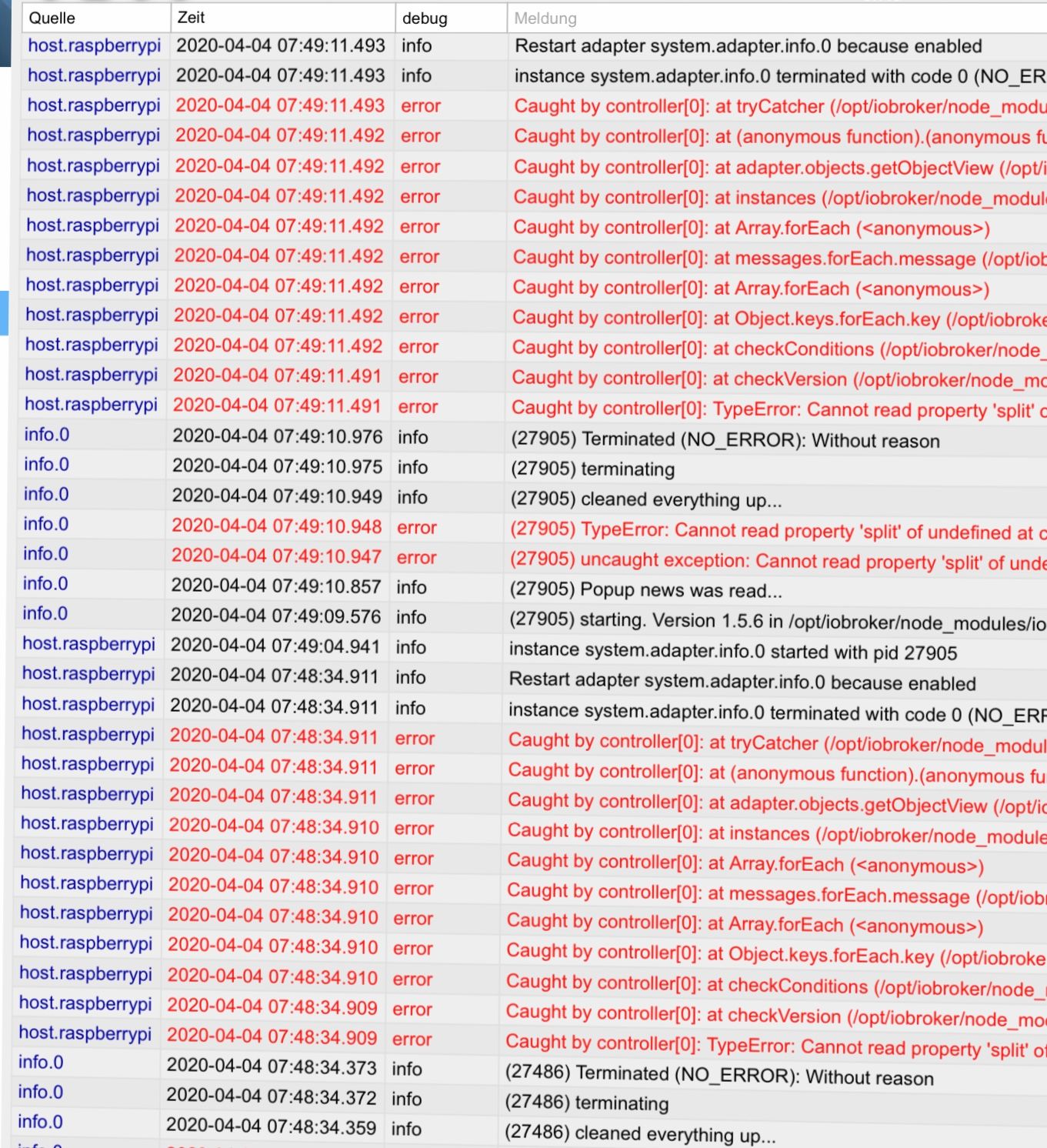

    4. Fehlermeldung im Log

                                  host.iobroker	2020-05-07 20:53:15.856	info	Restart adapter system.adapter.zigbee.0 because enabled
                                  host.iobroker	2020-05-07 20:53:15.855	error	instance system.adapter.zigbee.0 terminated with code 1 (JS_CONTROLLER_STOPPED)
                                  host.iobroker	2020-05-07 20:53:15.855	error	Caught by controller[0]: at Module.load (internal/modules/cjs/loader.js:977:32)
                                  host.iobroker	2020-05-07 20:53:15.855	error	Caught by controller[0]: at Object.Module._extensions..js (internal/modules/cjs/loader.js:1153:10)
                                  host.iobroker	2020-05-07 20:53:15.855	error	Caught by controller[0]: at Module._compile (internal/modules/cjs/loader.js:1133:30)
                                  host.iobroker	2020-05-07 20:53:15.854	error	Caught by controller[0]: at Object.<anonymous> (/opt/iobroker/node_modules/@serialport/bindings/lib/linux.js:2:36)
                                  host.iobroker	2020-05-07 20:53:15.854	error	Caught by controller[0]: at bindings (/opt/iobroker/node_modules/bindings/bindings.js:112:48)
                                  host.iobroker	2020-05-07 20:53:15.854	error	Caught by controller[0]: at require (internal/modules/cjs/helpers.js:77:18)
                                  host.iobroker	2020-05-07 20:53:15.854	error	Caught by controller[0]: at Module.require (internal/modules/cjs/loader.js:1019:19)
                                  host.iobroker	2020-05-07 20:53:15.854	error	Caught by controller[0]: at Function.Module._load (internal/modules/cjs/loader.js:877:14)
                                  host.iobroker	2020-05-07 20:53:15.854	error	Caught by controller[0]: at Module.load (internal/modules/cjs/loader.js:977:32)
                                  host.iobroker	2020-05-07 20:53:15.853	error	Caught by controller[0]: at Object.Module._extensions..node (internal/modules/cjs/loader.js:1183:18)
                                  host.iobroker	2020-05-07 20:53:15.853	error	Caught by controller[0]: the module (for instance, using `npm rebuild` or `npm install`).
                                  host.iobroker	2020-05-07 20:53:15.853	error	Caught by controller[0]: NODE_MODULE_VERSION 72. Please try re-compiling or re-installing
                                  host.iobroker	2020-05-07 20:53:15.853	error	Caught by controller[0]: NODE_MODULE_VERSION 64. This version of Node.js requires
                                  host.iobroker	2020-05-07 20:53:15.853	error	Caught by controller[0]: was compiled against a different Node.js version using
                                  host.iobroker	2020-05-07 20:53:15.852	error	Caught by controller[0]: Error: The module '/opt/iobroker/node_modules/@serialport/bindings/build/Release/bindings.node'
                                  host.iobroker	2020-05-07 20:53:15.852	error	Caught by controller[0]: ^
                                  host.iobroker	2020-05-07 20:53:15.852	error	Caught by controller[0]: throw e;
                                  host.iobroker	2020-05-07 20:53:15.851	error	Caught by controller[0]: /opt/iobroker/node_modules/bindings/bindings.js:121
                                  host.iobroker	2020-05-07 20:53:15.459	info	instance system.adapter.zigbee.0 started with pid 3641
