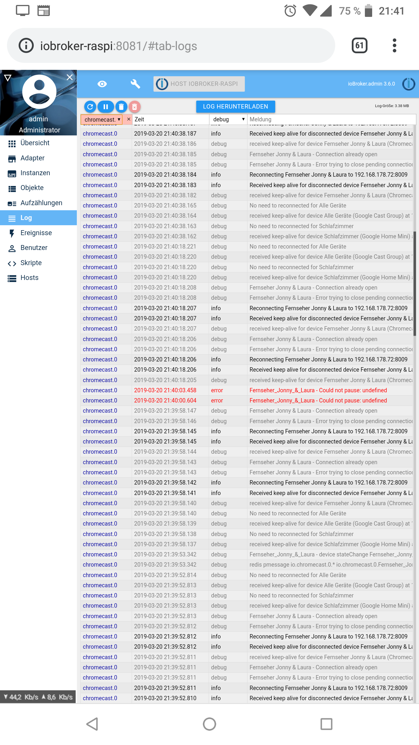

          Hier einmal das Debug log als der Fehler wieder aufgetreten ist

            @Xyolyp sagte in Chromecast Instanz muss neugestartet werden:
            Bitte als Text, dann sieht man mehr

              Um ziemlich genau 21:40 Uhr ist der Fehler aufgetreten. Im Spoiler ist das Debug Log
              2019-03-20 21:39:52.805  - info: chromecast.0 Received keep alive for disconnected device Fernseher Jonny & Laura
              2019-03-20 21:39:52.806  - info: chromecast.0 Reconnecting Fernseher Jonny & Laura to 192.168.178.72:8009
              2019-03-20 21:39:52.806  - debug: chromecast.0 Fernseher Jonny & Laura - Error trying to close pending connection (expected) - TypeError: Cannot read property 'destroy' of null
              2019-03-20 21:39:52.806  - debug: chromecast.0 Fernseher Jonny & Laura - Connection already open
              2019-03-20 21:39:52.808  - debug: chromecast.0 received keep-alive for device Schlafzimmer (Google Home Mini) at 192.168.178.86:8009
              2019-03-20 21:39:52.808  - debug: chromecast.0 No need to reconnected for Schlafzimmer
              2019-03-20 21:39:52.809  - debug: chromecast.0 received keep-alive for device Alle Geräte (Google Cast Group) at 192.168.178.86:42155
              2019-03-20 21:39:52.809  - debug: chromecast.0 No need to reconnected for Alle Geräte
              2019-03-20 21:39:53.340  - debug: chromecast.0 redis pmessage  io.chromecast.0.* io.chromecast.0.Fernseher_Jonny_&_Laura.player.pause {"val":true,"ack":false,"ts":1553114393338,"q":0,"from":"system.adapter.javascript.0","user":"system.user.admin","lc":1552235605443}
              2019-03-20 21:39:53.341  - debug: chromecast.0 Fernseher_Jonny_&_Laura - device stateChange Fernseher_Jonny_&_Laura.player.pause {"val":true,"ack":false,"ts":1553114393338,"q":0,"from":"system.adapter.javascript.0","user":"system.user.admin","lc":1552235605443}
              2019-03-20 21:39:58.129  - debug: chromecast.0 received keep-alive for device Schlafzimmer (Google Home Mini) at 192.168.178.86:8009
              2019-03-20 21:39:58.130  - debug: chromecast.0 No need to reconnected for Schlafzimmer
              2019-03-20 21:39:58.131  - debug: chromecast.0 received keep-alive for device Alle Geräte (Google Cast Group) at 192.168.178.86:42155
              2019-03-20 21:39:58.131  - debug: chromecast.0 No need to reconnected for Alle Geräte
              2019-03-20 21:39:58.132  - debug: chromecast.0 received keep-alive for device Fernseher Jonny & Laura (Chromecast) at 192.168.178.72:8009
              2019-03-20 21:39:58.133  - info: chromecast.0 Received keep alive for disconnected device Fernseher Jonny & Laura
              2019-03-20 21:39:58.133  - info: chromecast.0 Reconnecting Fernseher Jonny & Laura to 192.168.178.72:8009
              2019-03-20 21:39:58.134  - debug: chromecast.0 Fernseher Jonny & Laura - Error trying to close pending connection (expected) - TypeError: Cannot read property 'destroy' of null
              2019-03-20 21:39:58.134  - debug: chromecast.0 Fernseher Jonny & Laura - Connection already open
              2019-03-20 21:39:58.135  - debug: chromecast.0 received keep-alive for device Fernseher Jonny & Laura (Chromecast) at 192.168.178.72:8009
              2019-03-20 21:39:58.135  - info: chromecast.0 Received keep alive for disconnected device Fernseher Jonny & Laura
              2019-03-20 21:39:58.136  - info: chromecast.0 Reconnecting Fernseher Jonny & Laura to 192.168.178.72:8009
              2019-03-20 21:39:58.136  - debug: chromecast.0 Fernseher Jonny & Laura - Error trying to close pending connection (expected) - TypeError: Cannot read property 'destroy' of null
              2019-03-20 21:39:58.137  - debug: chromecast.0 Fernseher Jonny & Laura - Connection already open
              2019-03-20 21:39:58.247  - info: google-sharedlocations.0 Polling locations.
              2019-03-20 21:39:59.037  - info: google-sharedlocations.0 Checking fences.
              2019-03-20 21:40:00.604  - error: chromecast.0 Fernseher_Jonny_&_Laura - Could not pause: undefined
              2019-03-20 21:40:03.342  - error: chromecast.0 Fernseher_Jonny_&_Laura - Could not pause: undefined
              2019-03-20 21:40:18.200  - debug: chromecast.0 received keep-alive for device Fernseher Jonny & Laura (Chromecast) at 192.168.178.72:8009
              2019-03-20 21:40:18.200  - info: chromecast.0 Received keep alive for disconnected device Fernseher Jonny & Laura
              2019-03-20 21:40:18.201  - info: chromecast.0 Reconnecting Fernseher Jonny & Laura to 192.168.178.72:8009
              2019-03-20 21:40:18.201  - debug: chromecast.0 Fernseher Jonny & Laura - Error trying to close pending connection (expected) - TypeError: Cannot read property 'destroy' of null
              2019-03-20 21:40:18.202  - debug: chromecast.0 Fernseher Jonny & Laura - Connection already open
              2019-03-20 21:40:18.203  - debug: chromecast.0 received keep-alive for device Fernseher Jonny & Laura (Chromecast) at 192.168.178.72:8009
              2019-03-20 21:40:18.203  - info: chromecast.0 Received keep alive for disconnected device Fernseher Jonny & Laura
              2019-03-20 21:40:18.203  - info: chromecast.0 Reconnecting Fernseher Jonny & Laura to 192.168.178.72:8009
              2019-03-20 21:40:18.204  - debug: chromecast.0 Fernseher Jonny & Laura - Error trying to close pending connection (expected) - TypeError: Cannot read property 'destroy' of null
              2019-03-20 21:40:18.205  - debug: chromecast.0 Fernseher Jonny & Laura - Connection already open
              2019-03-20 21:40:18.216  - debug: chromecast.0 received keep-alive for device Schlafzimmer (Google Home Mini) at 192.168.178.86:8009
              2019-03-20 21:40:18.217  - debug: chromecast.0 No need to reconnected for Schlafzimmer
              2019-03-20 21:40:18.218  - debug: chromecast.0 received keep-alive for device Alle Geräte (Google Cast Group) at 192.168.178.86:42155
              2019-03-20 21:40:18.219  - debug: chromecast.0 No need to reconnected for Alle Geräte
              2019-03-20 21:40:38.160  - debug: chromecast.0 received keep-alive for device Schlafzimmer (Google Home Mini) at 192.168.178.86:8009
              2019-03-20 21:40:38.160  - debug: chromecast.0 No need to reconnected for Schlafzimmer
              2019-03-20 21:40:38.161  - debug: chromecast.0 received keep-alive for device Alle Geräte (Google Cast Group) at 192.168.178.86:42155
              2019-03-20 21:40:38.162  - debug: chromecast.0 No need to reconnected for Alle Geräte
              2019-03-20 21:40:38.177  - debug: chromecast.0 received keep-alive for device Fernseher Jonny & Laura (Chromecast) at 192.168.178.72:8009
