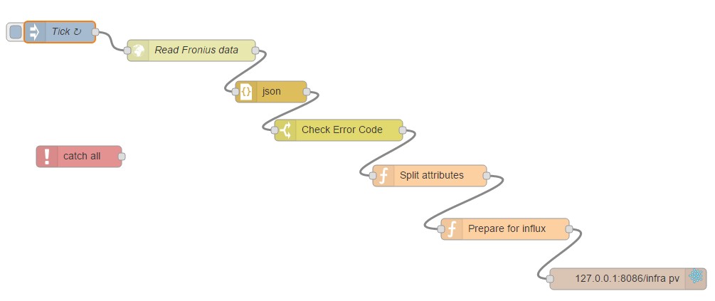

                            moebius last edited by
                            Ein flow zum Transfer der Inverterdaten nach InfluxDB
                            ! "id": "2a7e3123.ad03ae",
                            ! "type": "tab",
                            ! "label": "Read fronius"
                            ! "id": "fd6b509c.77443",
                            ! "type": "inject",
                            ! "z": "2a7e3123.ad03ae",
                            ! "name": "Tick",
                            ! "topic": "",
                            ! "payload": "",
                            ! "payloadType": "date",
                            ! "repeat": "",
                            ! "crontab": "*/1 4-22 * * *",
                            ! "once": false,
                            ! "x": 288,
                            ! "y": 212,
                            ! "wires": [
                            ! "22d2788d.d27808"
                            ! "id": "22d2788d.d27808",
                            ! "type": "http request",
                            ! "name": "Read Fronius data",
                            ! "method": "GET",
                            ! "url": "http://192.168.4.181/solar_api/v1/GetIn … verterData",
                            ! "tls": "",
                            ! "x": 473,
                            ! "y": 238,
                            ! "wires": [
                            ! "9686437.4938ec"
                            ! "id": "9686437.4938ec",
                            ! "type": "json",
                            ! "name": "",
                            ! "x": 585,
                            ! "y": 296,
                            ! "wires": [
                            ! "bb4056ca.6f3138"
                            ! "id": "bb4056ca.6f3138",
                            ! "type": "switch",
                            ! "name": "Check Error Code",
                            ! "property": "payload.Body.Data.DeviceStatus.ErrorCode",
                            ! "propertyType": "msg",
                            ! "rules": [
                            ! "t": "eq",
                            ! "v": "0",
                            ! "vt": "num"
                            ! "checkall": "true",
                            ! "outputs": 1,
                            ! "x": 680,
                            ! "y": 350,
                            ! "wires": [
                            ! "29bf8fb4.dba5"
                            ! "id": "c2c27a4e.27dc28",
                            ! "type": "catch",
                            ! "name": "",
                            ! "scope": null,
                            ! "x": 315,
                            ! "y": 387,
                            ! "wires": [
                            ! "id": "29bf8fb4.dba5",
                            ! "type": "function",
                            ! "name": "Split attributes",
                            ! "func": "\nvar newmsg = {};\nnewmsg.topic = msg.topic;\nnewmsg.payload = {};\n\nvar src = msg.payload.Body.Data;\nfor (var key in src) {\n newmsg.payload[key] = src[key]\n}\nreturn newmsg;",
                            ! "outputs": 1,
                            ! "noerr": 0,
                            ! "x": 808,
                            ! "y": 414,
                            ! "wires": [
                            ! "dbda39b3.e5aa38"
                            ! "id": "dbda39b3.e5aa38",
                            ! "name": "Prepare for influx",
                            ! "func": "\nvar newmsg = {};\nnewmsg.topic = msg.topic;\nvar vals = {};\n\nvar src = msg.payload;\nfor (var key in src) {\n if(typeof src[key].Value != "undefined")\n vals[key] = src[key].Value\n}\nnewmsg.payload = vals\nreturn newmsg;",
                            ! "outputs": 1,
                            ! "noerr": 0,
                            ! "x": 914,
                            ! "y": 489,
                            ! "wires": [
                            ! "aff49a5e.3ee358"
                            ! "id": "aff49a5e.3ee358",
                            ! "type": "influxdb out",
                            ! "influxdb": "d898da53.9e89f8",
                            ! "name": "",
                            ! "measurement": "pv",
                            ! "x": 1087,
                            ! "y": 559,
                            ! "wires": []
                            ! "id": "d898da53.9e89f8",
                            ! "type": "influxdb",
                            ! "z": "",
                            ! "hostname": "127.0.0.1",
                            ! "port": "8086",
                            ! "protocol": "http",
                            ! "database": "infra",
                            ! "name": ""
