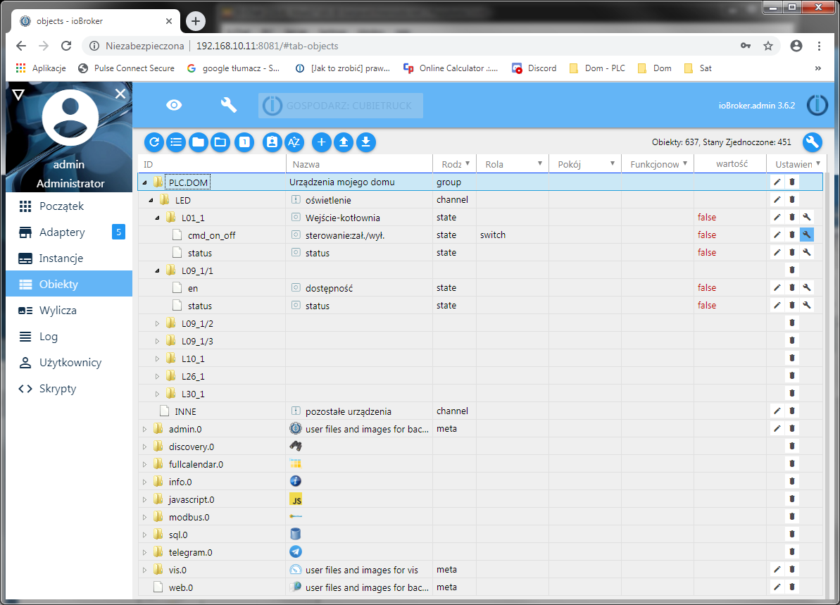

      I try to update my nodejs in my iobroker from version 6 to version 8.
      And now i have big problem - after every iobroker restart objects disappear from a objcets tree in "obiekty" ("Objects") card.
      See picture before restart:
      .. and after (missing objects and states):
      upgrade version are:
      node/nodejs: 8.16.0
      npm (downgrade) 4.6.1
      ioBroker.admin 3.6.2
      Any idea for them ?

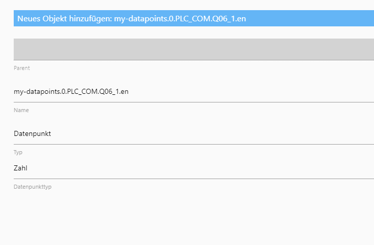

            No, it isn't any adapter. It's my own structure. On nodejs6 all works very well. After upgrade (with npm rebuild) to nodejs8 (and nodejs 10 too) not work.
            Yesterday i removed all (nodejs and iobroker) and install from begin nodejs8 and iobroker from install script. And still not work.
            Other question - where are property place to add my own data structure (like in top picture called "PLC.DOM"?

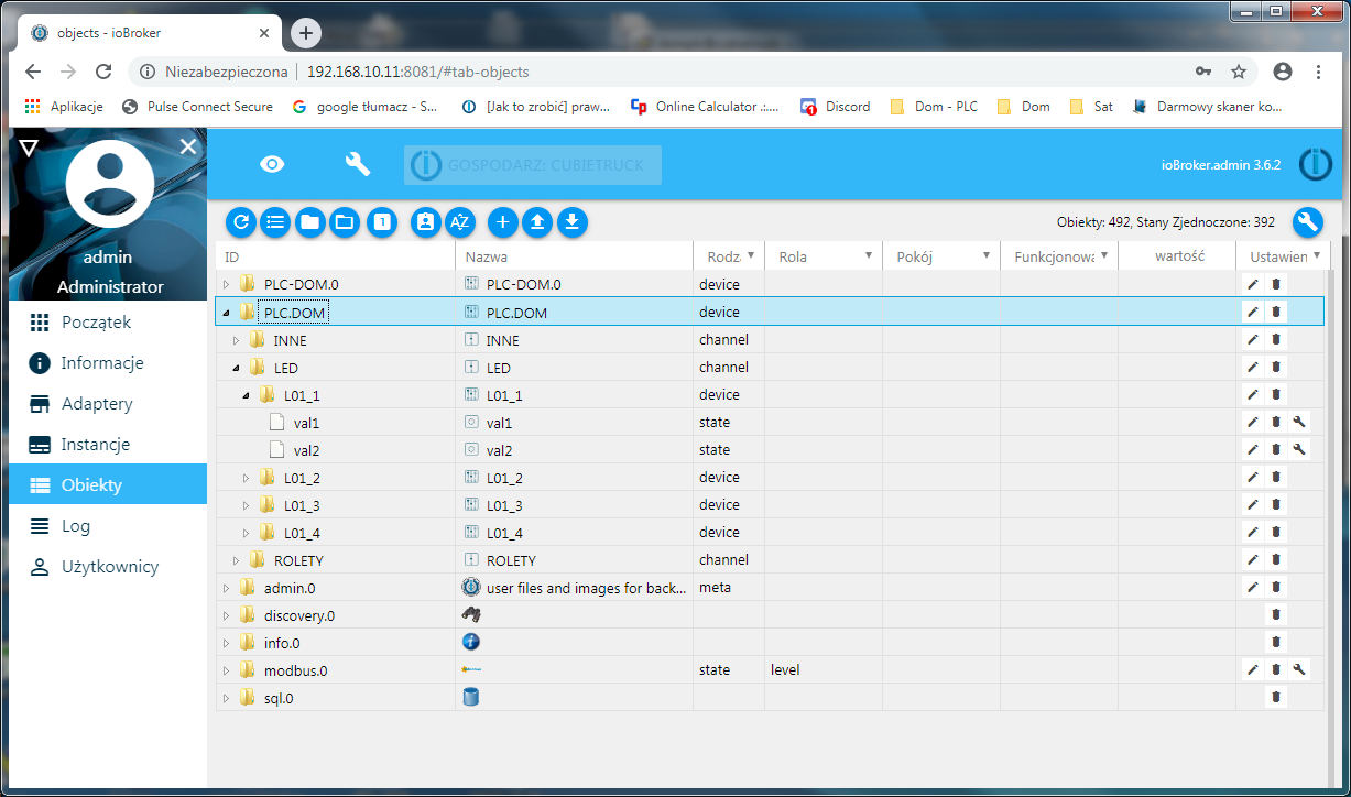

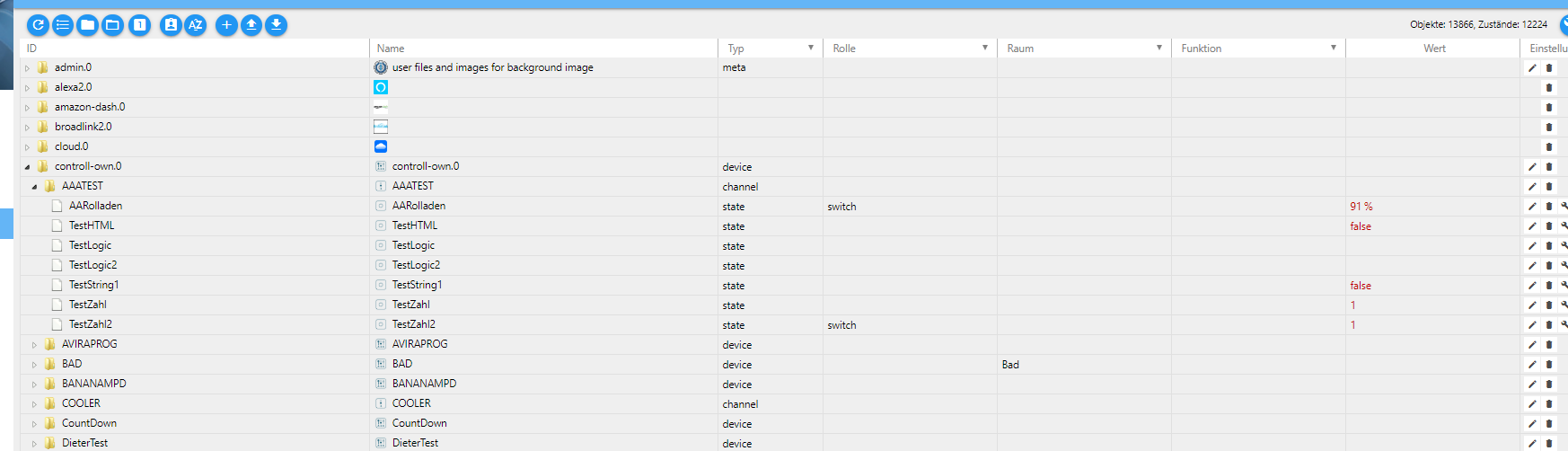

              @mguc I think your structure seems to right - this is e.g. my strukture
              "controll-own.0 is the start of my datapoints
              one difference is that your typ (rodz...) is a GROUP - I don't know what this means - try to make a new strukture

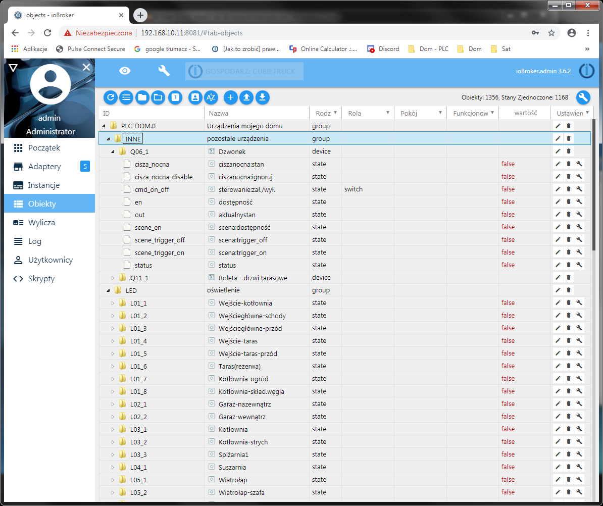

              make a new datapoint like - my-datapoints.0.PLC_COM.Q06_1.en and save it - than you have a new strukture whre you can use
              make sure that nothin on the righjt side is marked -
              also choose "Datenpunkt" and "zahl" even if it is already standing there - mark it - sometime there a problems
              maybe this helps

                Thanks for info. For test i created 2 nodes: "DOM-PLC.0" and "DOM.PLC". For create I use only "device", "channel", "data point" from edit window.
                A now it's look some like that:
                After up to 4 server reboot (and refresh browser window) all still looks fine.
                Maybe incorrect was used other words for "rules" like group, meta and others.
                I don't know is "DOM.PLC" is correct name, but it's work 😉
                Thanks for help.
