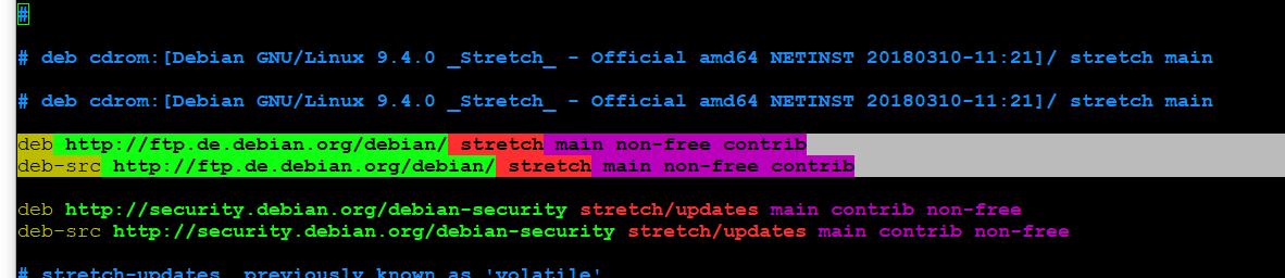

                                  • liv-in-sky
                                    liv-in-sky @Kuddel last edited by liv-in-sky
                                    @Kuddel
                                    da fehlt was
                                    deb http://ftp.de.debian.org/debian/ stretch main non-free contrib
                                    deb-src http://ftp.de.debian.org/debian/ stretch main non-free contrib
                                    • liv-in-sky
                                      @Kuddel nachrag - das ganze sieht so aus
                                      # deb cdrom:[Debian GNU/Linux 9.4.0 _Stretch_ - Official amd64 NETINST 20180310-11:21]/ stretch main
                                      deb http://security.debian.org/debian-security stretch/updates main contrib non-free
                                      deb-src http://security.debian.org/debian-security stretch/updates main contrib non-free
                                      # stretch-updates, previously known as 'volatile'
                                      deb http://ftp.de.debian.org/debian/ stretch-updates main contrib non-free
                                      deb-src http://ftp.de.debian.org/debian/ stretch-updates main contrib non-free
                                      # deb http://download.proxmox.com/debian/pve stretch pve-no-subscription
                                        Kuddel @liv-in-sky last edited by
                                        @liv-in-sky jetzt hat die Installation funktioniert. Danke
