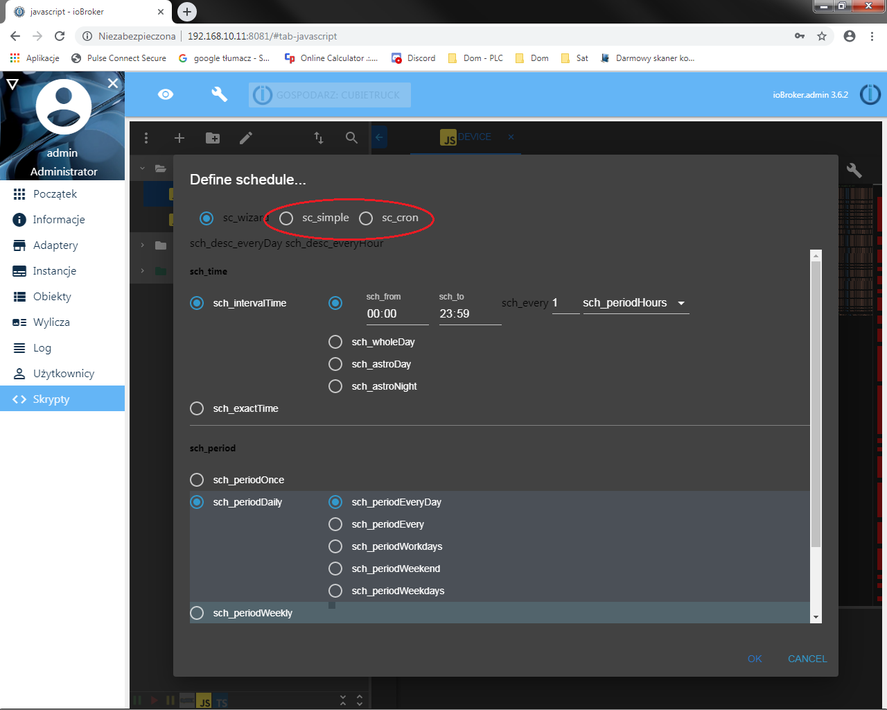

      When i try to edit js script in scripts tab after pressed CRON icon:

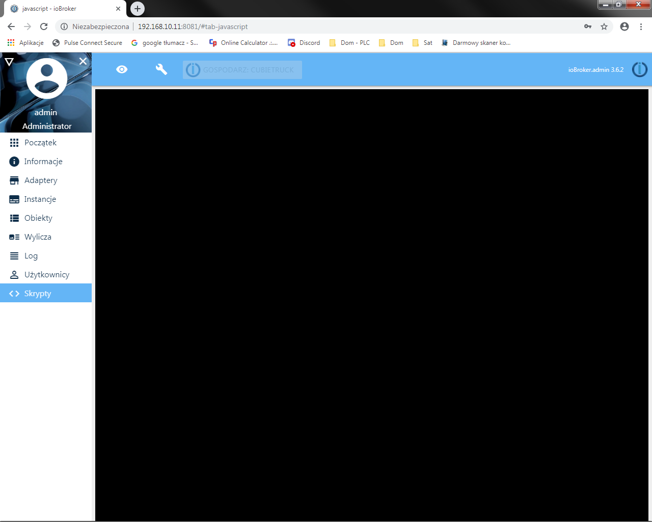

      and change to sc_simple or sc_cron i see.. nothing:
      (it's dark mode example - for light mode is the same problem...)
      • AlCalzone
        AlCalzone Developer @mguc last edited by
        @mguc That looks like an error. Please open the browser console (F12) and check if there are any errors logged.
