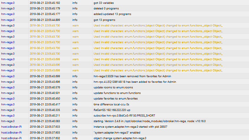

          wie von dir oben beschrieben, Instanz neugestartet und log-File durchsucht. Ich finde aber nur die dargestellten Einträge.

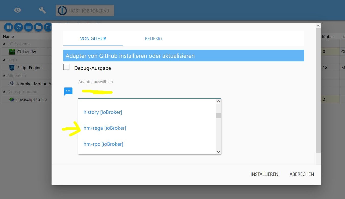

          • foxriver76
            foxriver76 Developer @mguenther last edited by foxriver76

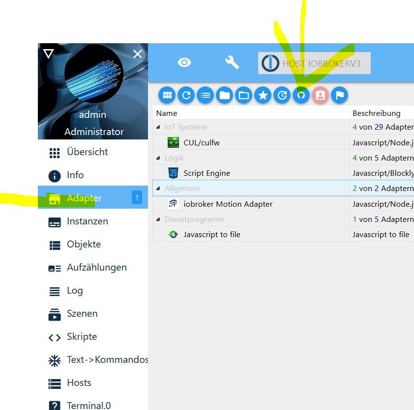

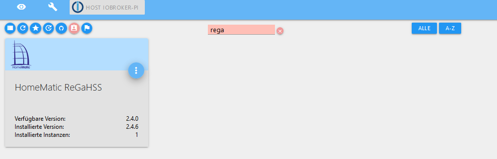

            @mguenther hast du auch das mit dem Upload Button gemacht? Sonst wird der neue Code bei GitHub Installationen nicht angezogen.
            Ansonsten muss ich nochmal schauen.

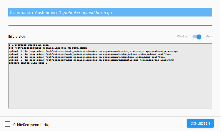

                mguenther @foxriver76 last edited by
                @foxriver76
                sorry, ich hab den upload vergessen - mach ich heute Abend.
                  @foxriver76
                  hmmm - upload durchgeführt:

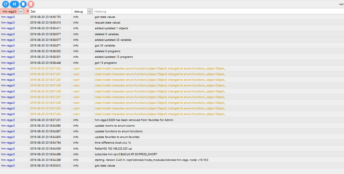

                  das ist der Log-File:
                    mguenther @foxriver76 last edited by mguenther

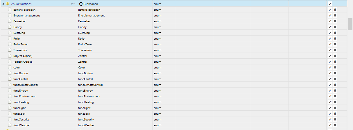

                    {"1219": {"Name": "%24%7BfuncButton%7D","TypeName":"ENUM_FUNCTIONS", "EnumInfo": "", "Channels": [{"Address":"LEQ1285980:1","Interface":"BidCos-Wired"},{"Address":"LEQ1285980:2","Interface":"BidCos-Wired"},{"Address":"LEQ1285980:3","Interface":"BidCos-Wired"},{"Address":"LEQ1285980:4","Interface":"BidCos-Wired"},{"Address":"LEQ1285980:5","Interface":"BidCos-Wired"},{"Address":"LEQ1285980:6","Interface":"BidCos-Wired"},{"Address":"LEQ1285980:7","Interface":"BidCos-Wired"},{"Address":"LEQ1285980:8","Interface":"BidCos-Wired"},{"Address":"LEQ1285980:9","Interface":"BidCos-Wired"},{"Address":"LEQ1285980:10","Interface":"BidCos-Wired"},{"Address":"LEQ1285980:11","Interface":"BidCos-Wired"},{"Address":"LEQ1285980:12","Interface":"BidCos-Wired"},{"Address":"LEQ1286149:1","Interface":"BidCos-Wired"},{"Address":"LEQ1286149:2","Interface":"BidCos-Wired"},{"Address":"LEQ1286149:3","Interface":"BidCos-Wired"},{"Address":"LEQ1286149:4","Interface":"BidCos-Wired"},{"Address":"LEQ1286149:5","Interface":"BidCos-Wired"},{"Address":"LEQ1286149:6","Interface":"BidCos-Wired"},{"Address":"LEQ1286149:7","Interface":"BidCos-Wired"},{"Address":"LEQ1286149:8","Interface":"BidCos-Wired"},{"Address":"LEQ1286149:9","Interface":"BidCos-Wired"},{"Address":"LEQ1286149:10","Interface":"BidCos-Wired"},{"Address":"LEQ1286149:11","Interface":"BidCos-Wired"},{"Address":"LEQ1286149:12","Interface":"BidCos-Wired"},{"Address":"MEQ0064673:1","Interface":"BidCos-Wired"},{"Address":"MEQ0064673:2","Interface":"BidCos-Wired"},{"Address":"MEQ0064673:3","Interface":"BidCos-Wired"},{"Address":"MEQ0064673:4","Interface":"BidCos-Wired"},{"Address":"MEQ0064673:5","Interface":"BidCos-Wired"},{"Address":"MEQ0064673:6","Interface":"BidCos-Wired"},{"Address":"MEQ0064673:7","Interface":"BidCos-Wired"},{"Address":"MEQ0064673:8","Interface":"BidCos-Wired"},{"Address":"MEQ0064673:9","Interface":"BidCos-Wired"},{"Address":"MEQ0064673:10","Interface":"BidCos-Wired"},{"Address":"MEQ0064673:11","Interface":"BidCos-Wired"},{"Address":"MEQ0064673:12","Interface":"BidCos-Wired"},{"Address":"NEQ1486579:1","Interface":"BidCos-RF"},{"Address":"NEQ1486579:2","Interface":"BidCos-RF"},{"Address":"NEQ1486579:3","Interface":"BidCos-RF"},{"Address":"NEQ1486579:4","Interface":"BidCos-RF"},{"Address":"NEQ1486579:5","Interface":"BidCos-RF"},{"Address":"NEQ1486579:6","Interface":"BidCos-RF"},{"Address":"NEQ1486579:7","Interface":"BidCos-RF"},{"Address":"NEQ1486579:8","Interface":"BidCos-RF"},{"Address":"NEQ1466608:1","Interface":"BidCos-Wired"},{"Address":"NEQ1466583:1","Interface":"BidCos-Wired"},{"Address":"NEQ1466573:1","Interface":"BidCos-Wired"},{"Address":"NEQ1466608:2","Interface":"BidCos-Wired"},{"Address":"NEQ1466573:2","Interface":"BidCos-Wired"},{"Address":"NEQ1466583:2","Interface":"BidCos-Wired"},{"Address":"BidCoS-RF:1","Interface":"BidCos-RF"},{"Address":"BidCoS-Wir:1","Interface":"BidCos-Wired"},{"Address":"BidCoS-Wir:2","Interface":"BidCos-Wired"},{"Address":"BidCoS-Wir:3","Interface":"BidCos-Wired"},{"Address":"NEQ1469583:3","Interface":"BidCos-RF"},{"Address":"NEQ1469606:5","Interface":"BidCos-RF"},{"Address":"NEQ1469583:1","Interface":"BidCos-RF"},{"Address":"NEQ1469606:1","Interface":"BidCos-RF"},{"Address":"NEQ1469583:5","Interface":"BidCos-RF"},{"Address":"NEQ1469583:4","Interface":"BidCos-RF"},{"Address":"NEQ1469606:6","Interface":"BidCos-RF"},{"Address":"NEQ1469583:2","Interface":"BidCos-RF"},{"Address":"NEQ1469606:2","Interface":"BidCos-RF"},{"Address":"NEQ1469583:6","Interface":"BidCos-RF"},{"Address":"NEQ1469606:3","Interface":"BidCos-RF"},{"Address":"NEQ1469606:4","Interface":"BidCos-RF"}]},
                    "1220": {"Name": "%24%7BfuncCentral%7D","TypeName":"ENUM_FUNCTIONS", "EnumInfo": "", "Channels": [{"Address":"BidCoS-RF:10","Interface":"BidCos-RF"},{"Address":"BidCoS-RF:11","Interface":"BidCos-RF"},{"Address":"BidCoS-RF:12","Interface":"BidCos-RF"},{"Address":"BidCoS-RF:13","Interface":"BidCos-RF"},{"Address":"BidCoS-RF:14","Interface":"BidCos-RF"},{"Address":"BidCoS-RF:15","Interface":"BidCos-RF"},{"Address":"BidCoS-RF:16","Interface":"BidCos-RF"},{"Address":"BidCoS-RF:17","Interface":"BidCos-RF"},{"Address":"BidCoS-RF:18","Interface":"BidCos-RF"},{"Address":"BidCoS-RF:19","Interface":"BidCos-RF"},{"Address":"BidCoS-RF:2","Interface":"BidCos-RF"},{"Address":"BidCoS-RF:20","Interface":"BidCos-RF"},{"Address":"BidCoS-RF:21","Interface":"BidCos-RF"},{"Address":"BidCoS-RF:22","Interface":"BidCos-RF"},{"Address":"BidCoS-RF:23","Interface":"BidCos-RF"},{"Address":"BidCoS-RF:24","Interface":"BidCos-RF"},{"Address":"BidCoS-RF:25","Interface":"BidCos-RF"},{"Address":"BidCoS-RF:26","Interface":"BidCos-RF"},{"Address":"BidCoS-RF:27","Interface":"BidCos-RF"},{"Address":"BidCoS-RF:28","Interface":"BidCos-RF"},{"Address":"BidCoS-RF:29","Interface":"BidCos-RF"},{"Address":"BidCoS-RF:3","Interface":"BidCos-RF"},{"Address":"BidCoS-RF:30","Interface":"BidCos-RF"},{"Address":"BidCoS-RF:31","Interface":"BidCos-RF"},{"Address":"BidCoS-RF:32","Interface":"BidCos-RF"},{"Address":"BidCoS-RF:33","Interface":"BidCos-RF"},{"Address":"BidCoS-RF:34","Interface":"BidCos-RF"},{"Address":"BidCoS-RF:35","Interface":"BidCos-RF"},{"Address":"BidCoS-RF:36","Interface":"BidCos-RF"},{"Address":"BidCoS-RF:37","Interface":"BidCos-RF"},{"Address":"BidCoS-RF:38","Interface":"BidCos-RF"},{"Address":"BidCoS-RF:39","Interface":"BidCos-RF"},{"Address":"BidCoS-RF:4","Interface":"BidCos-RF"},{"Address":"BidCoS-RF:40","Interface":"BidCos-RF"},{"Address":"BidCoS-RF:41","Interface":"BidCos-RF"},{"Address":"BidCoS-RF:42","Interface":"BidCos-RF"},{"Address":"BidCoS-RF:43","Interface":"BidCos-RF"},{"Address":"BidCoS-RF:44","Interface":"BidCos-RF"},{"Address":"BidCoS-RF:45","Interface":"BidCos-RF"},{"Address":"BidCoS-RF:46","Interface":"BidCos-RF"},{"Address":"BidCoS-RF:47","Interface":"BidCos-RF"},{"Address":"BidCoS-RF:48","Interface":"BidCos-RF"},{"Address":"BidCoS-RF:49","Interface":"BidCos-RF"},{"Address":"BidCoS-RF:5","Interface":"BidCos-RF"},{"Address":"BidCoS-RF:50","Interface":"BidCos-RF"},{"Address":"BidCoS-RF:6","Interface":"BidCos-RF"},{"Address":"BidCoS-RF:7","Interface":"BidCos-RF"},{"Address":"BidCoS-RF:8","Interface":"BidCos-RF"},{"Address":"BidCoS-RF:9","Interface":"BidCos-RF"},{"Address":"BidCoS-Wir:10","Interface":"BidCos-Wired"},{"Address":"BidCoS-Wir:11","Interface":"BidCos-Wired"},{"Address":"BidCoS-Wir:12","Interface":"BidCos-Wired"},{"Address":"BidCoS-Wir:13","Interface":"BidCos-Wired"},{"Address":"BidCoS-Wir:14","Interface":"BidCos-Wired"},{"Address":"BidCoS-Wir:15","Interface":"BidCos-Wired"},{"Address":"BidCoS-Wir:16","Interface":"BidCos-Wired"},{"Address":"BidCoS-Wir:17","Interface":"BidCos-Wired"},{"Address":"BidCoS-Wir:18","Interface":"BidCos-Wired"},{"Address":"BidCoS-Wir:19","Interface":"BidCos-Wired"},{"Address":"BidCoS-Wir:20","Interface":"BidCos-Wired"},{"Address":"BidCoS-Wir:21","Interface":"BidCos-Wired"},{"Address":"BidCoS-Wir:22","Interface":"BidCos-Wired"},{"Address":"BidCoS-Wir:23","Interface":"BidCos-Wired"},{"Address":"BidCoS-Wir:24","Interface":"BidCos-Wired"},{"Address":"BidCoS-Wir:25","Interface":"BidCos-Wired"},{"Address":"BidCoS-Wir:26","Interface":"BidCos-Wired"},{"Address":"BidCoS-Wir:27","Interface":"BidCos-Wired"},{"Address":"BidCoS-Wir:28","Interface":"BidCos-Wired"},{"Address":"BidCoS-Wir:29","Interface":"BidCos-Wired"},{"Address":"BidCoS-Wir:30","Interface":"BidCos-Wired"},{"Address":"BidCoS-Wir:31","Interface":"BidCos-Wired"},{"Address":"BidCoS-Wir:32","Interface":"BidCos-Wired"},{"Address":"BidCoS-Wir:33","Interface":"BidCos-Wired"},{"Address":"BidCoS-Wir:34","Interface":"BidCos-Wired"},{"Address":"BidCoS-Wir:35","Interface":"BidCos-Wired"},{"Address":"BidCoS-Wir:36","Interface":"BidCos-Wired"},{"Address":"BidCoS-Wir:37","Interface":"BidCos-Wired"},{"Address":"BidCoS-Wir:38","Interface":"BidCos-Wired"},{"Address":"BidCoS-Wir:39","Interface":"BidCos-Wired"},{"Address":"BidCoS-Wir:4","Interface":"BidCos-Wired"},{"Address":"BidCoS-Wir:40","Interface":"BidCos-Wired"},{"Address":"BidCoS-Wir:41","Interface":"BidCos-Wired"},{"Address":"BidCoS-Wir:42","Interface":"BidCos-Wired"},{"Address":"BidCoS-Wir:43","Interface":"BidCos-Wired"},{"Address":"BidCoS-Wir:44","Interface":"BidCos-Wired"},{"Address":"BidCoS-Wir:45","Interface":"BidCos-Wired"},{"Address":"BidCoS-Wir:46","Interface":"BidCos-Wired"},{"Address":"BidCoS-Wir:47","Interface":"BidCos-Wired"},{"Address":"BidCoS-Wir:48","Interface":"BidCos-Wired"},{"Address":"BidCoS-Wir:49","Interface":"BidCos-Wired"},{"Address":"BidCoS-Wir:5","Interface":"BidCos-Wired"},{"Address":"BidCoS-Wir:50","Interface":"BidCos-Wired"},{"Address":"BidCoS-Wir:6","Interface":"BidCos-Wired"},{"Address":"BidCoS-Wir:7","Interface":"BidCos-Wired"},{"Address":"BidCoS-Wir:8","Interface":"BidCos-Wired"},{"Address":"BidCoS-Wir:9","Interface":"BidCos-Wired"},{"Address":"NEQ1466573:3","Interface":"BidCos-Wired"},{"Address":"NEQ1466583:4","Interface":"BidCos-Wired"},{"Address":"BidCoS-RF:1","Interface":"BidCos-RF"},{"Address":"BidCoS-Wir:1","Interface":"BidCos-Wired"},{"Address":"BidCoS-Wir:2","Interface":"BidCos-Wired"},{"Address":"BidCoS-Wir:3","Interface":"BidCos-Wired"}]},
                    "1214": {"Name": "%24%7BfuncClimateControl%7D","TypeName":"ENUM_FUNCTIONS", "EnumInfo": "", "Channels": []},
                    "1216": {"Name": "%24%7BfuncEnvironment%7D","TypeName":"ENUM_FUNCTIONS", "EnumInfo": "", "Channels": []},
                    "1213": {"Name": "%24%7BfuncHeating%7D","TypeName":"ENUM_FUNCTIONS", "EnumInfo": "", "Channels": []},
                    "1212": {"Name": "%24%7BfuncLight%7D","TypeName":"ENUM_FUNCTIONS", "EnumInfo": "", "Channels": [{"Address":"LEQ1285980:13","Interface":"BidCos-Wired"},{"Address":"LEQ1285980:14","Interface":"BidCos-Wired"},{"Address":"LEQ1285980:15","Interface":"BidCos-Wired"},{"Address":"LEQ1285980:16","Interface":"BidCos-Wired"},{"Address":"LEQ1285980:17","Interface":"BidCos-Wired"},{"Address":"LEQ1285980:18","Interface":"BidCos-Wired"},{"Address":"LEQ1285980:19","Interface":"BidCos-Wired"},{"Address":"LEQ1286149:13","Interface":"BidCos-Wired"},{"Address":"LEQ1286149:14","Interface":"BidCos-Wired"},{"Address":"LEQ1286149:15","Interface":"BidCos-Wired"},{"Address":"LEQ1286149:16","Interface":"BidCos-Wired"},{"Address":"LEQ1286149:17","Interface":"BidCos-Wired"},{"Address":"LEQ1286149:18","Interface":"BidCos-Wired"},{"Address":"LEQ1286149:19","Interface":"BidCos-Wired"},{"Address":"MEQ0064673:13","Interface":"BidCos-Wired"},{"Address":"MEQ0064673:14","Interface":"BidCos-Wired"},{"Address":"MEQ0064673:15","Interface":"BidCos-Wired"},{"Address":"MEQ0064673:16","Interface":"BidCos-Wired"},{"Address":"MEQ0064673:17","Interface":"BidCos-Wired"},{"Address":"MEQ0064673:18","Interface":"BidCos-Wired"},{"Address":"MEQ0064673:19","Interface":"BidCos-Wired"},{"Address":"NEQ1486579:7","Interface":"BidCos-RF"},{"Address":"NEQ1486579:8","Interface":"BidCos-RF"},{"Address":"NEQ1466608:3","Interface":"BidCos-Wired"},{"Address":"OEQ0248749:1","Interface":"BidCos-RF"},{"Address":"NEQ1466583:3","Interface":"BidCos-Wired"},{"Address":"NEQ1581944:1","Interface":"BidCos-RF"},{"Address":"NEQ1581953:1","Interface":"BidCos-RF"},{"Address":"NEQ1582012:1","Interface":"BidCos-RF"},{"Address":"NEQ1466608:4","Interface":"BidCos-Wired"},{"Address":"NEQ1466573:4","Interface":"BidCos-Wired"},{"Address":"BidCoS-RF:1","Interface":"BidCos-RF"},{"Address":"BidCoS-Wir:1","Interface":"BidCos-Wired"},{"Address":"BidCoS-Wir:2","Interface":"BidCos-Wired"},{"Address":"BidCoS-Wir:3","Interface":"BidCos-Wired"}]},
                    "1218": {"Name": "%24%7BfuncLock%7D","TypeName":"ENUM_FUNCTIONS", "EnumInfo": "", "Channels": [{"Address":"61A7D709AC75E3:0","Interface":"HmIP-RF"},{"Address":"61A7D709AC75E3:1","Interface":"HmIP-RF"},{"Address":"61A7D709AC75E3:10","Interface":"HmIP-RF"},{"Address":"61A7D709AC75E3:11","Interface":"HmIP-RF"},{"Address":"61A7D709AC75E3:12","Interface":"HmIP-RF"},{"Address":"61A7D709AC75E3:13","Interface":"HmIP-RF"},{"Address":"61A7D709AC75E3:14","Interface":"HmIP-RF"},{"Address":"61A7D709AC75E3:15","Interface":"HmIP-RF"},{"Address":"61A7D709AC75E3:16","Interface":"HmIP-RF"},{"Address":"61A7D709AC75E3:17","Interface":"HmIP-RF"},{"Address":"61A7D709AC75E3:18","Interface":"HmIP-RF"},{"Address":"61A7D709AC75E3:19","Interface":"HmIP-RF"},{"Address":"61A7D709AC75E3:2","Interface":"HmIP-RF"},{"Address":"61A7D709AC75E3:20","Interface":"HmIP-RF"},{"Address":"61A7D709AC75E3:21","Interface":"HmIP-RF"},{"Address":"61A7D709AC75E3:22","Interface":"HmIP-RF"},{"Address":"61A7D709AC75E3:23","Interface":"HmIP-RF"},{"Address":"61A7D709AC75E3:24","Interface":"HmIP-RF"},{"Address":"61A7D709AC75E3:25","Interface":"HmIP-RF"},{"Address":"61A7D709AC75E3:26","Interface":"HmIP-RF"},{"Address":"61A7D709AC75E3:27","Interface":"HmIP-RF"},{"Address":"61A7D709AC75E3:28","Interface":"HmIP-RF"},{"Address":"61A7D709AC75E3:29","Interface":"HmIP-RF"},{"Address":"61A7D709AC75E3:3","Interface":"HmIP-RF"},{"Address":"61A7D709AC75E3:30","Interface":"HmIP-RF"},{"Address":"61A7D709AC75E3:31","Interface":"HmIP-RF"},{"Address":"61A7D709AC75E3:32","Interface":"HmIP-RF"},{"Address":"61A7D709AC75E3:33","Interface":"HmIP-RF"},{"Address":"61A7D709AC75E3:34","Interface":"HmIP-RF"},{"Address":"61A7D709AC75E3:35","Interface":"HmIP-RF"},{"Address":"61A7D709AC75E3:36","Interface":"HmIP-RF"},{"Address":"61A7D709AC75E3:37","Interface":"HmIP-RF"},{"Address":"61A7D709AC75E3:38","Interface":"HmIP-RF"},{"Address":"61A7D709AC75E3:39","Interface":"HmIP-RF"},{"Address":"61A7D709AC75E3:4","Interface":"HmIP-RF"},{"Address":"61A7D709AC75E3:40","Interface":"HmIP-RF"},{"Address":"61A7D709AC75E3:41","Interface":"HmIP-RF"},{"Address":"61A7D709AC75E3:42","Interface":"HmIP-RF"},{"Address":"61A7D709AC75E3:43","Interface":"HmIP-RF"},{"Address":"61A7D709AC75E3:44","Interface":"HmIP-RF"},{"Address":"61A7D709AC75E3:45","Interface":"HmIP-RF"},{"Address":"61A7D709AC75E3:46","Interface":"HmIP-RF"},{"Address":"61A7D709AC75E3:47","Interface":"HmIP-RF"},{"Address":"61A7D709AC75E3:48","Interface":"HmIP-RF"},{"Address":"61A7D709AC75E3:49","Interface":"HmIP-RF"},{"Address":"61A7D709AC75E3:5","Interface":"HmIP-RF"},{"Address":"61A7D709AC75E3:50","Interface":"HmIP-RF"},{"Address":"61A7D709AC75E3:6","Interface":"HmIP-RF"},{"Address":"61A7D709AC75E3:7","Interface":"HmIP-RF"},{"Address":"61A7D709AC75E3:8","Interface":"HmIP-RF"},{"Address":"61A7D709AC75E3:9","Interface":"HmIP-RF"}]},
                    "1217": {"Name": "%24%7BfuncSecurity%7D","TypeName":"ENUM_FUNCTIONS", "EnumInfo": "", "Channels": [{"Address":"NEQ1544423:1","Interface":"BidCos-RF"},{"Address":"NEQ1544508:1","Interface":"BidCos-RF"},{"Address":"NEQ0120731:1","Interface":"BidCos-RF"},{"Address":"NEQ0121152:1","Interface":"BidCos-RF"},{"Address":"OEQ0248749:1","Interface":"BidCos-RF"},{"Address":"BidCoS-RF:1","Interface":"BidCos-RF"},{"Address":"BidCoS-Wir:1","Interface":"BidCos-Wired"},{"Address":"BidCoS-Wir:2","Interface":"BidCos-Wired"},{"Address":"BidCoS-Wir:3","Interface":"BidCos-Wired"}]},
                    "1215": {"Name": "%24%7BfuncWeather%7D","TypeName":"ENUM_FUNCTIONS", "EnumInfo": "", "Channels": [{"Address":"NEQ0534165:1","Interface":"BidCos-RF"},{"Address":"NEQ0534165:2","Interface":"BidCos-RF"},{"Address":"NEQ0534165:3","Interface":"BidCos-RF"},{"Address":"NEQ0534165:4","Interface":"BidCos-RF"},{"Address":"NEQ0534165:5","Interface":"BidCos-RF"}]},
                    "22595": {"Name": "Batterie%20betrieben","TypeName":"ENUM_FUNCTIONS", "EnumInfo": "f%FCr%20Skript%20Batterie%20leer", "Channels": [{"Address":"NEQ1544423:1","Interface":"BidCos-RF"},{"Address":"NEQ1544508:1","Interface":"BidCos-RF"},{"Address":"NEQ0120731:1","Interface":"BidCos-RF"},{"Address":"NEQ0121152:1","Interface":"BidCos-RF"},{"Address":"NEQ1486579:1","Interface":"BidCos-RF"},{"Address":"NEQ1486579:2","Interface":"BidCos-RF"},{"Address":"NEQ1486579:3","Interface":"BidCos-RF"},{"Address":"NEQ1486579:4","Interface":"BidCos-RF"},{"Address":"NEQ1486579:5","Interface":"BidCos-RF"},{"Address":"NEQ1486579:6","Interface":"BidCos-RF"},{"Address":"NEQ1486579:7","Interface":"BidCos-RF"},{"Address":"NEQ1486579:8","Interface":"BidCos-RF"},{"Address":"NEQ0534165:1","Interface":"BidCos-RF"},{"Address":"NEQ0534165:2","Interface":"BidCos-RF"},{"Address":"NEQ0534165:3","Interface":"BidCos-RF"},{"Address":"NEQ0534165:4","Interface":"BidCos-RF"},{"Address":"NEQ0534165:5","Interface":"BidCos-RF"},{"Address":"NEQ1762403:1","Interface":"BidCos-RF"},{"Address":"NEQ1760908:1","Interface":"BidCos-RF"},{"Address":"NEQ1761144:1","Interface":"BidCos-RF"},{"Address":"NEQ1469583:3","Interface":"BidCos-RF"},{"Address":"NEQ1469606:5","Interface":"BidCos-RF"},{"Address":"NEQ1469583:1","Interface":"BidCos-RF"},{"Address":"NEQ1469606:1","Interface":"BidCos-RF"},{"Address":"NEQ1469583:5","Interface":"BidCos-RF"},{"Address":"NEQ1469583:4","Interface":"BidCos-RF"},{"Address":"NEQ1469606:6","Interface":"BidCos-RF"},{"Address":"NEQ1469583:2","Interface":"BidCos-RF"},{"Address":"NEQ1469606:2","Interface":"BidCos-RF"},{"Address":"NEQ1469583:6","Interface":"BidCos-RF"},{"Address":"NEQ1469606:3","Interface":"BidCos-RF"},{"Address":"NEQ1469606:4","Interface":"BidCos-RF"}]},
                    "1221": {"Name": "Energiemanagement","TypeName":"ENUM_FUNCTIONS", "EnumInfo": "", "Channels": [{"Address":"OEQ1443250:1","Interface":"BidCos-RF"},{"Address":"OEQ1443232:1","Interface":"BidCos-RF"},{"Address":"OEQ1443255:1","Interface":"BidCos-RF"},{"Address":"OEQ0478768:1","Interface":"BidCos-RF"}]},
                    "10092": {"Name": "Fernseher","TypeName":"ENUM_FUNCTIONS", "EnumInfo": "", "Channels": [{"Address":"NEQ1486579:1","Interface":"BidCos-RF"},{"Address":"NEQ1486579:2","Interface":"BidCos-RF"},{"Address":"NEQ1663025:1","Interface":"BidCos-RF"},{"Address":"NEQ1663025:2","Interface":"BidCos-RF"},{"Address":"NEQ1663025:3","Interface":"BidCos-RF"},{"Address":"NEQ1663025:4","Interface":"BidCos-RF"},{"Address":"NEQ1663025:5","Interface":"BidCos-RF"},{"Address":"NEQ1663025:6","Interface":"BidCos-RF"},{"Address":"OEQ1977935:1","Interface":"BidCos-RF"},{"Address":"OEQ1977935:2","Interface":"BidCos-RF"},{"Address":"OEQ1977935:3","Interface":"BidCos-RF"},{"Address":"OEQ1977935:4","Interface":"BidCos-RF"},{"Address":"OEQ1977935:5","Interface":"BidCos-RF"},{"Address":"OEQ1977935:6","Interface":"BidCos-RF"}]},
                    "11614": {"Name": "Handy","TypeName":"ENUM_FUNCTIONS", "EnumInfo": "", "Channels": []},
                    "32516": {"Name": "Lueftung","TypeName":"ENUM_FUNCTIONS", "EnumInfo": "", "Channels": [{"Address":"BidCoS-RF:49","Interface":"BidCos-RF"},{"Address":"BidCoS-RF:50","Interface":"BidCos-RF"}]},
                    "2010": {"Name": "Rollo","TypeName":"ENUM_FUNCTIONS", "EnumInfo": "", "Channels": [{"Address":"MEQ0078280:3","Interface":"BidCos-Wired"},{"Address":"MEQ0079473:3","Interface":"BidCos-Wired"},{"Address":"MEQ0079491:3","Interface":"BidCos-Wired"},{"Address":"MEQ0078539:3","Interface":"BidCos-Wired"},{"Address":"MEQ0078279:3","Interface":"BidCos-Wired"},{"Address":"MEQ0078684:3","Interface":"BidCos-Wired"},{"Address":"MEQ0079545:3","Interface":"BidCos-Wired"},{"Address":"MEQ0079495:3","Interface":"BidCos-Wired"},{"Address":"MEQ0079542:3","Interface":"BidCos-Wired"},{"Address":"MEQ0078653:3","Interface":"BidCos-Wired"},{"Address":"MEQ0079453:3","Interface":"BidCos-Wired"}]},
                    "2011": {"Name": "Rollo%20Taster","TypeName":"ENUM_FUNCTIONS", "EnumInfo": "", "Channels": [{"Address":"MEQ0078280:1","Interface":"BidCos-Wired"},{"Address":"MEQ0078280:2","Interface":"BidCos-Wired"},{"Address":"MEQ0079473:1","Interface":"BidCos-Wired"},{"Address":"MEQ0079473:2","Interface":"BidCos-Wired"},{"Address":"MEQ0079491:1","Interface":"BidCos-Wired"},{"Address":"MEQ0079491:2","Interface":"BidCos-Wired"},{"Address":"MEQ0078539:1","Interface":"BidCos-Wired"},{"Address":"MEQ0078539:2","Interface":"BidCos-Wired"},{"Address":"MEQ0078279:1","Interface":"BidCos-Wired"},{"Address":"MEQ0078279:2","Interface":"BidCos-Wired"},{"Address":"MEQ0078684:1","Interface":"BidCos-Wired"},{"Address":"MEQ0078684:2","Interface":"BidCos-Wired"},{"Address":"MEQ0079545:1","Interface":"BidCos-Wired"},{"Address":"MEQ0079545:2","Interface":"BidCos-Wired"},{"Address":"MEQ0079495:1","Interface":"BidCos-Wired"},{"Address":"MEQ0079495:2","Interface":"BidCos-Wired"},{"Address":"MEQ0079542:1","Interface":"BidCos-Wired"},{"Address":"MEQ0079542:2","Interface":"BidCos-Wired"},{"Address":"MEQ0078653:1","Interface":"BidCos-Wired"},{"Address":"MEQ0078653:2","Interface":"BidCos-Wired"},{"Address":"MEQ0079453:1","Interface":"BidCos-Wired"},{"Address":"MEQ0079453:2","Interface":"BidCos-Wired"}]},
                    "3743": {"Name": "Tuersensor","TypeName":"ENUM_FUNCTIONS", "EnumInfo": "", "Channels": [{"Address":"NEQ1762403:1","Interface":"BidCos-RF"},{"Address":"NEQ1760908:1","Interface":"BidCos-RF"},{"Address":"NEQ1761144:1","Interface":"BidCos-RF"}]}}

                        @foxriver76 werde heute und morgen mindestens zu nix kommen. Danke fürs Daten liefern - wenn du das Problem deinerseits schnell beheben möchtest nutze am besten die Umbenennen-Technik.
