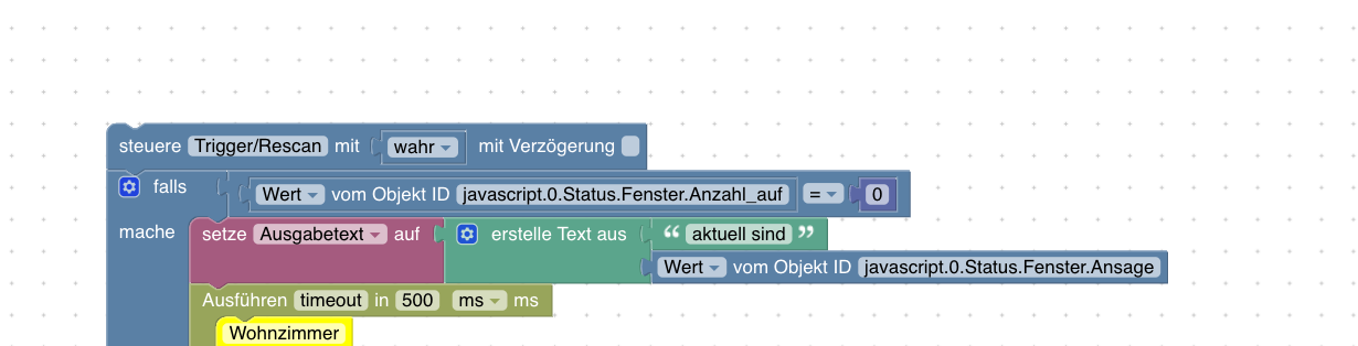

      Hier noch der ausführende Blockly:
        <variables>
          <variable type="" id="8/qE?_.0uV[^E2]DmWJ{">Ausgabetext</variable>
          <variable type="undefined" id="timeout">timeout</variable>
          <variable type="undefined" id="timeout2">timeout2</variable>
        </variables>
        <block type="control" id="@J7@ob/rsR9OCYN+!hI7" x="-513" y="-1063">
          <field name="OID">alexa2.0.History.#trigger</field>
            <block type="logic_boolean" id="oI]KS-#7{`Lh(W#]MB7C">
            <block type="controls_if" id="{_JT|3Mpv*tSOVWD3Pz6">
                <block type="logic_compare" id="D?,*QGBBwauCm,Qte=Q-">
                  <field name="OP">EQ</field>
                    <block type="get_value" id="]irLwLWGul].x{m`.#.@">
                      <field name="OID">javascript.0.Status.Fenster.Anzahl_auf</field>
                    <block type="math_number" id="5LL6xi4F_7}-aEi^jHY@">
                      <field name="NUM">0</field>
                <block type="variables_set" id="5VFfHYTB!S7A^A*?SicA">
                  <field name="VAR" id="8/qE?_.0uV[^E2]DmWJ{" variabletype="">Ausgabetext</field>
                    <block type="text_join" id="4?k[0reCRn.mjkxHg41~">
                      <value name="ADD0">
                        <block type="text" id="75Z)Wn`YF@;38~bIM;pA">
                          <field name="TEXT">aktuell sind</field>
                      <value name="ADD1">
                        <block type="get_value" id="Vh/8rxU]yD!3mT}0y[eC">
                          <field name="OID">javascript.0.Status.Fenster.Ansage</field>
                    <block type="timeouts_settimeout" id="xA_MJ^@=AB=-WtDTe(3}">
                      <field name="DELAY">500</field>
                      <field name="UNIT">ms</field>
                        <block type="comment" id="s30b2{fSQ:a0uC3`+QWU">
                          <field name="COMMENT">Wohnzimmer</field>
                            <block type="controls_if" id="l(E24=q]l]b,GJDj4dSj">
                                <block type="logic_compare" id="MKwJn0C!O]xc!~.9|B`*">
                                    <block type="get_value" id="p-SHbJ5Dmwr6djxg2ohH">
                                      <field name="OID">alexa2.0.History.name</field>
                                    <block type="text" id="?}A;8(IyMF%F@(t]Kc~+">
                                      <field name="TEXT">Echo im Wohnzimmer</field>
                                <block type="control" id="*:v3HBKA07feJ,T]E*CR">
                                  <field name="OID">alexa2.0.Echo-Devices.G2A0RF03745603AP.Commands.speak-volume</field>
                                    <block type="math_number" id="MsV6O9gIHcS!5``lHIBc">
                                      <field name="NUM">40</field>
                                    <block type="control" id=")M^jLcZ!hCpj,X={-`nV">
                                      <field name="OID">alexa2.0.Echo-Devices.G2A0RF03745603AP.Commands.speak</field>
                                        <block type="variables_get" id="p)bNOdcZFVoq1e^M5V-.">
                                <block type="comment" id="24mOHp`Pl!sIG*2Ro^CG">
                                  <field name="COMMENT">Wohnzimmer Show</field>
                                    <block type="controls_if" id="3=XmFd}jdwc!em|Y4RVN">
                                        <block type="logic_compare" id="JWjp],xrEuQh^S=No]Fe">
                                            <block type="get_value" id="^tb-(m.St/S5a,1kIi.J">
                                            <block type="text" id="2rmyM;!Q{.pI}GP-SP|%">
                                              <field name="TEXT">Echo Show</field>
                                        <block type="control" id="/r+Sampj-mq+JTIEb^Jf" disabled="true">
                                          <field name="OID">alexa2.0.Echo-Devices.G0913L0592730345.Commands.speak-volume</field>
                                            <block type="math_number" id="cJwZie[vn_f9k|v@9hnq">
                                            <block type="control" id="%4#|wDN[PK6i}Jtu_oIZ">
                                              <field name="OID">alexa2.0.Echo-Devices.G0913L0592730345.Commands.speak</field>
                                                <block type="variables_get" id="7!aNg#4^0Ku!ti3bLOUh">
                                        <block type="comment" id="As,dG(xO[B@wIYcyAG?h">
                                          <field name="COMMENT">Küche</field>
                                            <block type="controls_if" id="wrH-}P(84mn7Y/rg8A[.">
                                                <block type="logic_compare" id="kg.QKB751NaS#Ihk1Vlg">
                                                    <block type="get_value" id="qnTz1Oe31sq:NXjmbxIJ">
                                                    <block type="text" id="3=W.?c8BZN+QrGX4xL}h">
                                                      <field name="TEXT">Echo Dot Küche</field>
                                                <block type="control" id="}?dK++*V.7JQcjG{3uhB">
                                                  <field name="OID">alexa2.0.Echo-Devices.G090LF0965020FXA.Commands.speak</field>
                                                    <block type="variables_get" id="qHoN]~u1FI@iDQs*2C2v">
                                                <block type="comment" id="_amxz6B=9F}_2uEGsK}`">
                                                  <field name="COMMENT">Badezimmer</field>
                                                    <block type="controls_if" id=".n7JtGwDJDGfaeyl!8*B">
                                                        <block type="logic_compare" id="I-@9%{Ng!%}9rE#IESc;">
                                                            <block type="get_value" id="c?dSeG!fu]W8UO@?D4I3">
                                                            <block type="text" id="MivGV@*kt)3rY9COKpKA">
                                                              <field name="TEXT">Echo Dot Badezimmer</field>
                                                        <block type="control" id="zTwXc~r8Ldt0u-5TNcVn">
                                                          <field name="OID">alexa2.0.Echo-Devices.G090L911750408WX.Commands.speak</field>
                                                            <block type="variables_get" id="*X*~qQG3]~[NC{WMMndW">
                                                        <block type="comment" id="CJNG59[?CJ|U-=Bf]c)z">
                                                          <field name="COMMENT">Oben</field>
                                                            <block type="controls_if" id="OC]k1_}iDlExQPVc=(ib">
                                                                <block type="logic_compare" id="OBIXw6hJ@]2Xr`HBIz5h">
                                                                    <block type="get_value" id="=x~5W)ns/VV;c|RFqQcE">
                                                                    <block type="text" id="IxW:hplIvDQm1ax=@X+M">
                                                                      <field name="TEXT">Echo Dot oben</field>
                                                                <block type="control" id="g+2]wvsrhR8vxv7c,kJ_">
                                                                  <field name="OID">alexa2.0.Echo-Devices.G090L911743607RA.Commands.speak</field>
                                                                    <block type="variables_get" id="5q6/z~S`0DeJ6sYrWhj1">
                                                                <block type="comment" id="H=6r:HZpL-h.,hq!RDwm">
                                                                  <field name="COMMENT">Schlafzimmer</field>
                                                                    <block type="controls_if" id="T,e@q~MMg;]@}O8m;!,(">
                                                                        <block type="logic_compare" id="8#)iZJ[r;E|g}y2!V5l0">
                                                                            <block type="get_value" id=":bc$q{-hECHLgV5UPQQx">
                                                                            <block type="text" id="-ei;WistBFu8C*xZu=r_">
                                                                              <field name="TEXT">Echo Dot Schlafzimmer</field>
                                                                        <block type="control" id=")H|V9lr911Tq6AN$1w1k">

                in Deinem Blockly ist gar kein Trigger ? Startest Du das ganze Blockly bei einer Abfrage ?

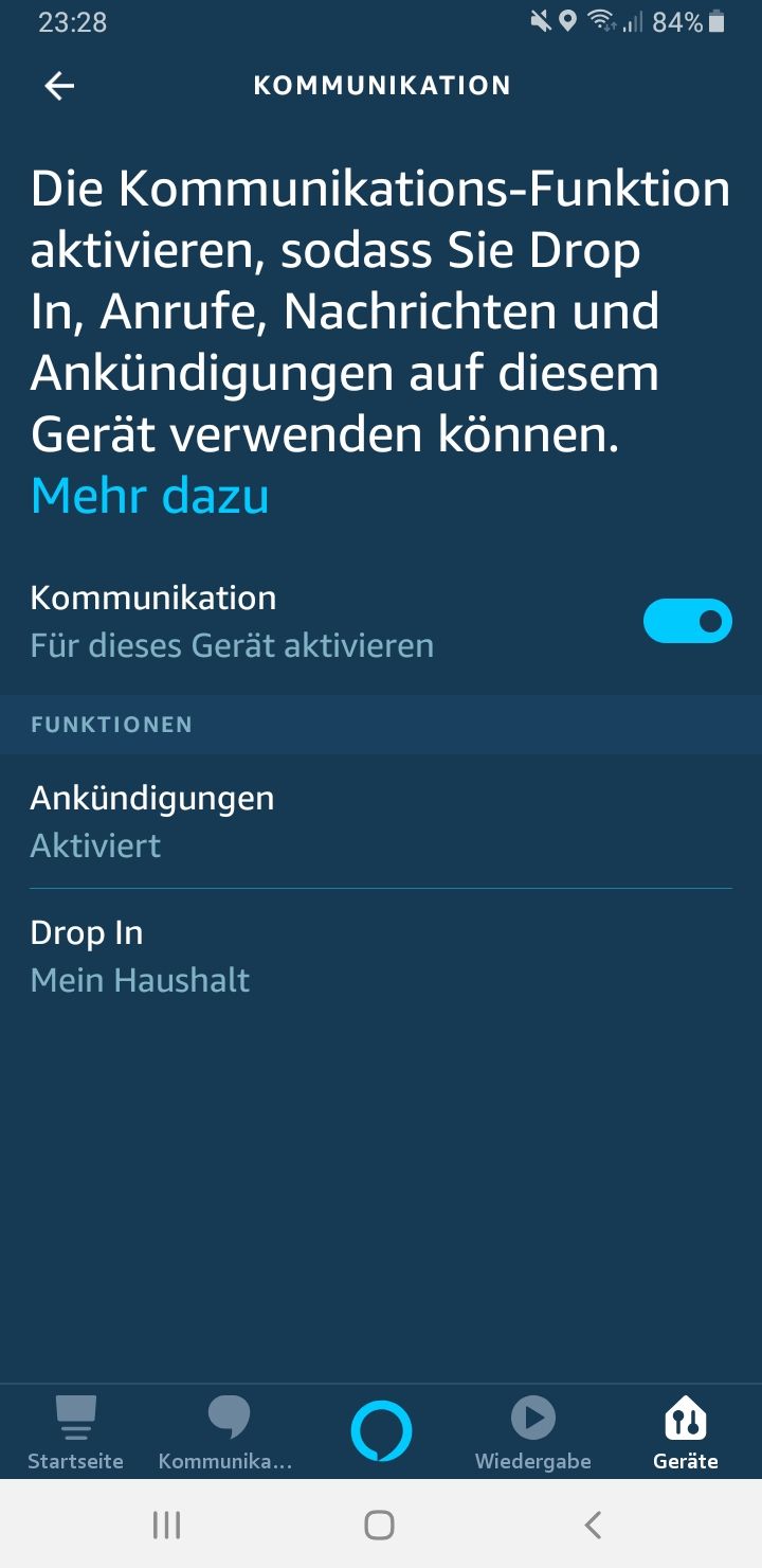

                    Eventuell bitte nicht stören an oder Kommunikation in der Alexa App aus ?

                      Kommunikation ist an.
