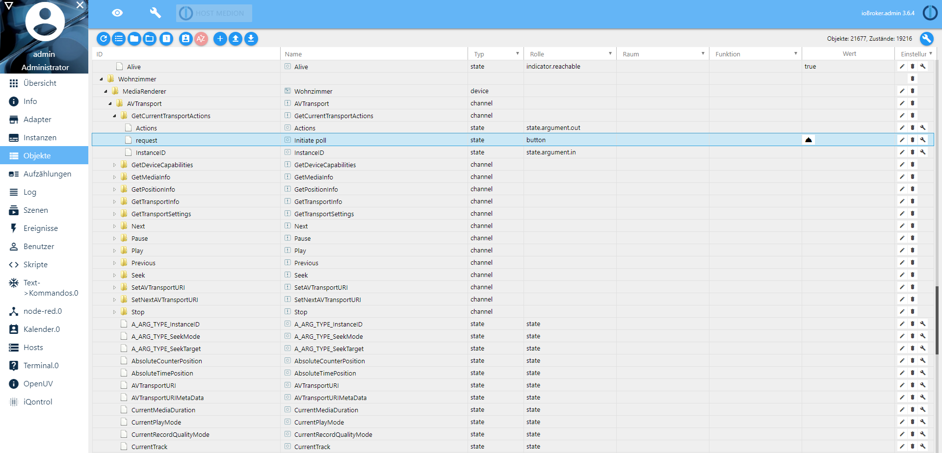

      Hallo, bekomme bei meinen Yamaha keine Werte:
      2019-08-29 10:46:08.275  - debug: upnp.0 Send Command for upnp.0.Wohnzimmer.MediaRenderer.AVTransport.GetCurrentTransportActions.request
      2019-08-29 10:46:08.309  - debug: upnp.0 get all states of the arguments as string
      2019-08-29 10:46:08.313  - debug: upnp.0 Options for request: {"uri":"http://192.168.178.25:49154/AVTransport/ctrl","headers":{"Content-Type":"text/xml; charset=\"utf-8\"","SOAPAction":"\"urn:schemas-upnp-org:service:AVTransport:1#GetCurrentTransportActions\"","USER-AGENT":"UPnP/1.0, ioBroker.upnp"},"method":"POST","body":" \n        <s:Envelope s:encodingStyle=\"http://schemas.xmlsoap.org/soap/encoding/\" xmlns:s=\"http://schemas.xmlsoap.org/soap/envelope/\">\n            <s:Body><u:GetCurrentTransportActions xmlns:u=\"urn:schemas-upnp-org:service:AVTransport:1\"><InstanceID>null</InstanceID></u:GetCurrentTransportActions></s:Body>\n        </s:Envelope>"}
      2019-08-29 10:46:08.314  - warn: upnp.0 Unexpected answer from upnp service: {"statusCode":500,"body":"<?xml version=\"1.0\" encoding=\"utf-8\"?><s:Envelope xmlns:s=\"http://schemas.xmlsoap.org/soap/envelope/\" s:encodingStyle=\"http://schemas.xmlsoap.org/soap/encoding/\"><s:Body><s:Fault><faultcode>s:Client</faultcode><faultstring>UPnPError</faultstring><detail><u:UPnPError xmlns:u=\"urn:schemas-upnp-org:control-1-0\"><u:errorCode>718</u:errorCode><u:errorDescription>Invalid InstaceID</u:errorDescription></u:UPnPError></detail></s:Fault></s:Body></s:Envelope>","headers":{"server":"Network_Module/1.0 (RX-V481)","content-type":"text/xml; charset=\"utf-8\"","ext":"","content-length":"453","connection":"close"},"request":{"uri":{"protocol":"http:","slashes":true,"auth":null,"host":"192.168.178.25:49154","port":"49154","hostname":"192.168.178.25","hash":null,"search":null,"query":null,"pathname":"/AVTransport/ctrl","path":"/AVTransport/ctrl","href":"http://192.168.178.25:49154/AVTransport/ctrl"},"method":"POST","headers":{"Content-Type":"text/xml; charset=\"utf-8\"","SOAPAction":"\"urn:schemas-upnp-org:service:AVTransport:1#GetCurrentTransportActions\"","USER-AGENT":"UPnP/1.0, ioBroker.upnp","content-length":329}}}
       Sent message: {"uri":"http://192.168.178.25:49154/AVTransport/ctrl","headers":{"Content-Type":"text/xml; charset=\"utf-8\"","SOAPAction":"\"urn:schemas-upnp-org:service:AVTransport:1#GetCurrentTransportActions\"","USER-AGENT":"UPnP/1.0, ioBroker.upnp"},"method":"POST","body":" \n        <s:Envelope s:encodingStyle=\"http://schemas.xmlsoap.org/soap/encoding/\" xmlns:s=\"http://schemas.xmlsoap.org/soap/envelope/\">\n            <s:Body><u:GetCurrentTransportActions xmlns:u=\"urn:schemas-upnp-org:service:AVTransport:1\"><InstanceID>null</InstanceID></u:GetCurrentTransportActions></s:Body>\n        </s:Envelope>"}
      2019-08-29 10:46:08.350  - debug: upnp.0 All tasks processed
      2019-08-29 10:46:10.000  - debug: upnp.0 Started processTasks with 1 tasks

        Du musst bei jeder Action für den MediaRenderer eine InstanceID mitgeben.
        Generell ist der Aufbau so das für eine Action alle Argumente als Objekt darunter liegen. Die Rolle "state.argument.in" steht für Argumente die man angeben muss damit ein Befehl ausgeführt wird, während "state.argument.out" die Argumente sind die man als Antwort bekommt.
