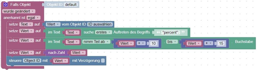

        @ein-michael sagte in Bestimmten Teil aus Datenpunkt auslesen:
        Wie setze ich mein Vorhaben um?
        Zum Beispiel so:
        Die Objekt IDs musst du natürlich anpassen.
        Hier noch der Code zum Importieren:
        <variables>
        <variable type="" id="tjq?oPs()ymNXzGQ4bf?">Text</variable>
        <variable type="" id="NicV5Nqp(O%5kefuWX)">Wert</variable>
        </variables>
        <block type="on_ext" id="8Rctl7eB0,O_@IbmE,q^" x="-487" y="63">
        <value name="OID0">
        <shadow type="field_oid" id="GjiqpMwB6S]v|Qo7jR2q">
        <block type="variables_set" id="R)MuZ-s$k5tx0TwSTV"> <field name="VAR" id="tjq?oPs()ymNXzGQ4bf?" variabletype="">Text</field> <value name="VALUE"> <block type="get_value" id="XVw2N?@%MY#_tc*-u.47"> <field name="ATTR">val</field> <field name="OID">ID auswählen</field> </block> </value> <next> <block type="variables_set" id="g@T^pE[!kaJQ+bl1j30J"> <field name="VAR" id="NicV5Nqp(O%5kefuW*X)" variabletype="">Wert</field> <value name="VALUE"> <block type="text_indexOf" id="}.W-JS?Ef-cY_T6S(^}q"> <field name="END">FIRST</field> <value name="VALUE"> <block type="variables_get" id="G,Y1?0%CJQ{pJ|(KNBc">
        <value name="FIND">
        <shadow type="text" id="o,Lc/4dp9w:]p
        ?DLy@A">
        <field name="TEXT">"percent":</field>
        <block type="variables_set" id="KZu6E9ya_jslf7KLZ;+w">
        <block type="text_getSubstring" id="uZ8oVzB*]H?#R_0Y4[^J">
        <mutation at1="true" at2="true"></mutation>
        <field name="WHERE1">FROM_START</field>
        <field name="WHERE2">FROM_START</field>
        <value name="STRING">
        <block type="variables_get" id="pPSf;{M}R^q-sf0hth!z">
        <value name="AT1">
        <block type="math_arithmetic" id="uZ^Qd}3nA$48?t/aTQaN">
        <field name="OP">ADD</field>
        <shadow type="math_number" id="5aM~9tVWzwHAjeQ.GV4w">
        <field name="NUM">1</field>
        <block type="variables_get" id="l-8N1]=GKxKa};6P2z,{">
        <field name="VAR" id="NicV5Nqp(O%5kefuWX)" variabletype="">Wert</field>
        <shadow type="math_number" id="89g=[L5A[E+8=K:mS-W4">
        <field name="NUM">10</field>
        <value name="AT2">
        <block type="math_arithmetic" id="ihUTbI=K.Ocyo!|Ce{|e">
        <shadow type="math_number" id="6H:ra{Q;LDtsp@d+N`XX">
        <block type="variables_get" id="p0M}f);aZFu+:_s4x~x-">
        <shadow type="math_number" id="5)?6A2Q$AxTwqAL)}1Ec">
        <field name="NUM">15</field>
        <block type="variables_set" id="JZCn31Iy;hhW_{#VND(^">
        <block type="convert_tonumber" id="KO3nuLNJ7J+_l5B,6,ea">
        <block type="variables_get" id="lp^r2D|HW95-Rcd}Nu}d">
        <block type="control" id="TOd#R8d%6/[s)0;Qa|d-">
        <block type="variables_get" id="G%wag.?%KDMuewB3n70+">

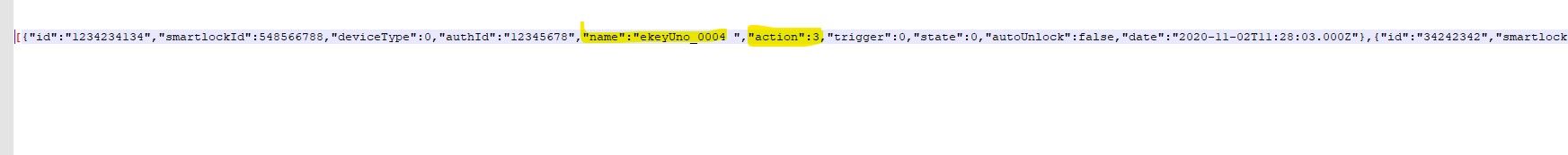

            du hattest hier im Thread schon mal geholfen. Vlt kannst du dir mein "Problem" einmal anschauen.
            In einem Datenpunkt wird kontinuierlich das Log weggeschrieben. Jeder neue Eintrag wird in {} eingefasst und beinhaltet
            10 Felder.
            Ich will für diese 10 Felder einzelne Datenpunke anlegen und nach jedem neuen Logeintrag die Datenfelder mit den letzten
            Einträgen aktualisieren.
            Hast du eine Idee wie ich das hinbekomme?
            VG
            [{"id":"99999999999999","smartlockId":1234567,"deviceType":0,"authId":"1234567","name":"userA ","action":3,"trigger":0,"state":0,"autoUnlock":false,"date":"2020-11-02T07:07:06.000Z"},{"id":"99999999999999","smartlockId":1234567,"deviceType":0,"authId":"1234567","name":"userA ","action":3,"trigger":0,"state":0,"autoUnlock":false,"date":"2020-11-02T06:31:00.000Z"},{"id":"99999999999999","smartlockId":1234567,"deviceType":0,"name":"","action":1,"trigger":1,"state":0,"autoUnlock":false,"date":"2020-11-02T06:10:31.000Z"}]

                    ahfreezer @paul53 last edited by
                    THX
                    das klappt soweit...den namen liest er auch brav aus...aber wie bekomme ich noch die Action in ein separates Datenfeld?
                      paul53 @ahfreezer last edited by paul53
                      @ahfreezer sagte:
                         setState(idAction, obj.action, true); // Typ: Zahl
                        Wie peinlich...jetzt hab ich es verstanden!
                        Danke dir vielmals... das hilft mir sehr weiter!
