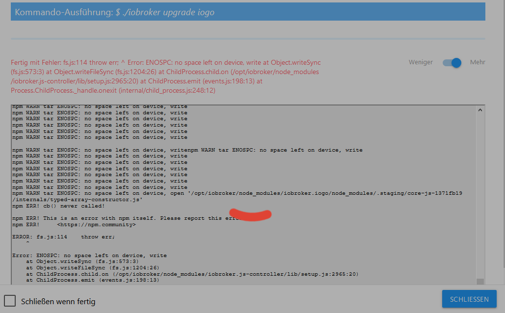

      Gestern schon versucht den iogo Adapter zu aktualisieren mit dem Ergebnis
      $ ./iobroker upgrade iogo
      Update iogo from @0.4.4 to @0.4.5
      NPM version: 6.9.0
      npm install iobroker.iogo@0.4.5 --production --save --prefix "/opt/iobroker" (System call)
      npm WARN
       @typescript-eslint/eslint-plugin@1.12.0 requires a peer of eslint@^5.0.0 but none is installed. You must install peer dependencies yourself.npm WARN @typescript-eslint/parser@1.12.0 requires a peer of eslint@^5.0.0 but none is installed. You must install peer dependencies yourself.
      npm WARN
       optional
       SKIPPING OPTIONAL DEPENDENCY: osx-temperature-sensor@1.0.4 (node_modules/osx-temperature-sensor):npm WARN notsup SKIPPING OPTIONAL DEPENDENCY: Unsupported platform for osx-temperature-sensor@1.0.4: wanted {"os":"darwin","arch":"any"} (current: {"os":"linux","arch":"x64"})
      npm install --production (System call) in "/opt/iobroker/node_modules/iobroker.iogo"
      npm WARN deprecated gulp-util@3.0.8: gulp-util is deprecated - replace it, following the guidelines at https://medium.com/gulpjs/gulp-util-ca3b1f9f9ac5
      npm WARN deprecated natives@1.1.6: This module relies on Node.js's internals and will break at some point. Do not use it, and update to graceful-fs@4.x.
      npm WARN deprecated minimatch@2.0.10: Please update to minimatch 3.0.2 or higher to avoid a RegExp DoS issue
      npm
      WARN deprecated minimatch@0.2.14: Please update to minimatch 3.0.2 or higher to avoid a RegExp DoS issue
      npm WARN deprecated graceful-fs@1.2.3: please upgrade to graceful-fs 4 for compatibility with current and future versions of Node.js
      npm WARN
       tar ENOSPC: no space left on device, writenpm WARN tar ENOSPC: no space left on device, write
      npm WARN tar ENOSPC: no space left on device, writenpm WARN tar ENOSPC: no space left on device, write
      npm WARN
      npm
      npm WARN tar
      npm WARN
      npm WARN
      npm ERR! cb() never called!
      npm ERR! This is an error with npm itself. Please report this error at:
      npm ERR!     <https://npm.community>
      got /opt/iobroker/node_modules/iobroker.iogo/admin
      upload [3] iogo.admin /opt/iobroker/node_modules/iobroker.iogo/admin/words.js words.js application/javascript
      Update "system.adapter.iogo.0"
      upload [2] iogo.admin /opt/iobroker/node_modules/iobroker.iogo/admin/iogo.png iogo.png image/png
      upload [1] iogo.admin /opt/iobroker/node_modules/iobroker.iogo/admin/index_m.html index_m.html text/html
      upload [0] iogo.admin /opt/iobroker/node_modules/iobroker.iogo/admin/index.html index.html text/html
      Adapter "iogo" updated
      process exited with code 0
      Heute Nacht Punkt 0.00 Uhr ist dann IoBroker abgekackt
      2019-09-13 00:00:00.364 - error: iogo.0 uncaught exception: Function DocumentReference.set() called with invalid data. Unsupported field value: undefined (found in field min)
      2019-09-13 00:00:00.364 - error: iogo.0 FirebaseError: Function DocumentReference.set() called with invalid data. Unsupported field value: undefined (found in field min)
      at new FirestoreError (/opt/iobroker/node_modules/@firebase/firestore/dist/index.node.cjs.js:354:28)
      at ParseContext.createError (/opt/iobroker/node_modules/@firebase/firestore/dist/index.node.cjs.js:19832:16)
      at UserDataConverter.parseScalarValue (/opt/iobroker/node_modules/@firebase/firestore/dist/index.node.cjs.js:20179:27)
      at UserDataConverter.parseData (/opt/iobroker/node_modules/@firebase/firestore/dist/index.node.cjs.js:20045:29)
      at /opt/iobroker/node_modules/@firebase/firestore/dist/index.node.cjs.js:20061:41
      at forEach (/opt/iobroker/node_modules/@firebase/firestore/dist/index.node.cjs.js:458:13)
      at UserDataConverter.parseObject (/opt/iobroker/node_modules/@firebase/firestore/dist/index.node.cjs.js:20060:13)
      at UserDataConverter.parseData (/opt/iobroker/node_modules/@firebase/firestore/dist/index.node.cjs.js:20019:25)
      at UserDataConverter.parseSetData (/opt/iobroker/node_modules/@firebase/firestore/dist/index.node.cjs.js:19884:31)
      at DocumentReference.set (/opt/iobroker/node_modules/@firebase/firestore/dist/index.node.cjs.js:20829:45)
      2019-09-13 00:00:00.365 - info: iogo.0 cleaned everything up...
      2019-09-13 00:00:00.365 - info: iogo.0 triggered listener removed
      2019-09-13 00:00:00.369 - info: iogo.0 listener removed
      2019-09-13 00:00:00.375 - info: iogo.0 signed out
      2019-09-13 00:00:00.392 - info: iogo.0 triggered listener removed
      2019-09-13 00:00:00.392 - info: iogo.0 listener removed
      2019-09-13 00:00:00.099 - info: host.IoBroker instance system.adapter.dwd.0 started with pid 24147
      2019-09-13 00:00:00.379 - info: javascript.0 script.js.Visualisierung.Wegezeit_Arbeit_Landstraße: Anzahl Wegepunkte: 28
      2019-09-13 00:00:00.445 - info: javascript.0 script.js.Visualisierung.Wegezeit_Arbeit_Autobahn: Anzahl Wegepunkte: 19
      2019-09-13 00:00:00.284 - info: host.IoBroker instance system.adapter.daswetter.0 started with pid 24155
      2019-09-13 00:00:00.500 - info: sourceanalytix.0 Updated SourceAnalytix configuration for : wiffi-wz.0.root.192_168_178_33.w_counter_1
      2019-09-13 00:00:00.503 - info: sourceanalytix.0 Setting start value Day for device : wiffi-wz.0.root.192_168_178_33.w_counter_2 succeeded with value + 2591.14
      2019-09-13 00:00:00.512 - info: influxdb.0 enabled logging of wiffi-wz.0.root.192_168_178_33.w_counter_1, Alias=false
      2019-09-13 00:00:00.515 - warn: iogo.0 You are not logged in
      2019-09-13 00:00:00.362 - info: host.IoBroker instance system.adapter.ical.0 started with pid 24157
      2019-09-13 00:00:00.494 - info: host.IoBroker instance system.adapter.feiertage.0 started with pid 24169
      2019-09-13 00:00:00.535 - info: iogo.0 terminating
      2019-09-13 00:00:00.544 - info: sourceanalytix.0 Setting start value Day for device : wiffi-wz.0.root.192_168_178_33.w_counter_1 succeeded with value + 112242.41
      2019-09-13 00:00:00.966 - error: Caught by controller[0]: { FirebaseError: Function DocumentReference.set() called with invalid data. Unsupported field value: undefined (found in field min)
      2019-09-13 00:00:02.143 - info: javascript.0 script.js.common.System.Logfiles2: Start new Tail process. File path to current log: [/opt/iobroker/log/iobroker.2019-09-13.log]
      2019-09-13 00:00:00.967 - error: Caught by controller[0]: at new FirestoreError (/opt/iobroker/node_modules/@firebase/firestore/dist/index.node.cjs.js:354:28)
      2019-09-13 00:00:00.967 - error: Caught by controller[0]: at ParseContext.createError (/opt/iobroker/node_modules/@firebase/firestore/dist/index.node.cjs.js:19832:16)
      2019-09-13 00:00:00.967 - error: Caught by controller[0]: at UserDataConverter.parseScalarValue (/opt/iobroker/node_modules/@firebase/firestore/dist/index.node.cjs.js:20179:27)
      2019-09-13 00:00:00.967 - error: Caught by controller[0]: at UserDataConverter.parseData (/opt/iobroker/node_modules/@firebase/firestore/dist/index.node.cjs.js:20045:29)
      2019-09-13 00:00:00.967 - error: Caught by controller[0]: at /opt/iobroker/node_modules/@firebase/firestore/dist/index.node.cjs.js:20061:41
      2019-09-13 00:00:00.967 - error: Caught by controller[0]: at forEach (/opt/iobroker/node_modules/@firebase/firestore/dist/index.node.cjs.js:458:13)
      2019-09-13 00:00:01.012 - error: Caught by controller[0]: at UserDataConverter.parseObject (/opt/iobroker/node_modules/@firebase/firestore/dist/index.node.cjs.js:20060:13)
      2019-09-13 00:00:01.012 - error: Caught by controller[0]: at UserDataConverter.parseData (/opt/iobroker/node_modules/@firebase/firestore/dist/index.node.cjs.js:20019:25)
      2019-09-13 00:00:01.012 - error: Caught by controller[0]: at UserDataConverter.parseSetData (/opt/iobroker/node_modules/@firebase/firestore/dist/index.node.cjs.js:19884:31)
      2019-09-13 00:00:01.012 - error: Caught by controller[0]: at DocumentReference.set (/opt/iobroker/node_modules/@firebase/firestore/dist/index.node.cjs.js:20829:45)
      2019-09-13 00:00:01.012 - error: Caught by controller[0]: code: 'invalid-argument',
      2019-09-13 00:00:01.012 - error: Caught by controller[0]: name: 'FirebaseError',
      2019-09-13 00:00:01.012 - error: Caught by controller[0]: toString: [Function] }
      2019-09-13 00:00:01.012 - error: host.IoBroker instance system.adapter.iogo.0 terminated with code 0 (OK)
      Hab nun ein Backup eingespielt und nochmal versucht
      vm in proxmox
      node.js10.16
      npm6.9.0
      admin 3.6.4
      rootdisk 15G
      Iobroker 6.5G
      Ram 3G von 4,5
        host.IoBroker install adapter iogo
        host.IoBroker object system.adapter.iogo created
        host.IoBroker create instance iogo
        host.IoBroker object iogo.0.info.ts created
        host.IoBroker object iogo.0.info.connection created
        host.IoBroker object system.adapter.iogo.0.outputCount created
        host.IoBroker object system.adapter.iogo.0.inputCount created
        host.IoBroker object system.adapter.iogo.0.uptime created
        host.IoBroker object system.adapter.iogo.0.memRss created
        host.IoBroker object system.adapter.iogo.0.memHeapTotal created
        host.IoBroker object system.adapter.iogo.0.memHeapUsed created
        host.IoBroker object system.adapter.iogo.0.cputime created
        host.IoBroker object system.adapter.iogo.0.cpu created
        host.IoBroker object system.adapter.iogo.0.connected created
        host.IoBroker object system.adapter.iogo.0.alive created
        host.IoBroker object system.adapter.iogo.0 created
        scheint wieder zu funktionieren
        • crunchip
          Den Adapter habe ich nun mal komplett gelöscht und neu installiert
          $ ./iobroker add iogo  --host IoBroker
          NPM version: 6.9.0
          node-pre-gyp
           WARN Using request for node-pre-gyp https download
          npm WARN @typescript-eslint/eslint-plugin@1.12.0 requires a peer of eslint@^5.0.0 but none is installed. You must install peer dependencies yourself.npm WARN @typescript-eslint/parser@1.12.0 requires a peer of eslint@^5.0.0 but none is installed. You must install peer dependencies yourself.
          npm
           WARN optional SKIPPING OPTIONAL DEPENDENCY: osx-temperature-sensor@1.0.4 (node_modules/osx-temperature-sensor):
