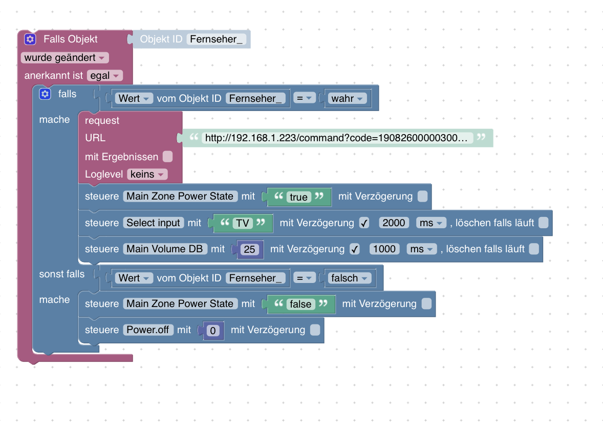

      Hi!
      Ich versuche meinen Samsung per Alexa einzuschalten, aber irgendwo ist der Wurm drin:
      Hier mal mein Skript:
      "Fernseher_" ist ein virtueller Knoten (Objekt)
      Hier das Log:
      undefined2019-10-15 08:51:10.811 - warn: javascript.0 Wrong type of denon.0.zoneMain.powerZone: "number". Please fix, while deprecated and will not work in next versions.
      2019-10-15 08:51:10.818 - warn: javascript.0 at setState (/opt/iobroker/node_modules/iobroker.javascript/lib/sandbox.js:1258:20)
      2019-10-15 08:51:10.819 - warn: javascript.0 at Object. (script.js.Weldscripts.Alexa_Fernseher_ein:9:5)
      2019-10-15 08:51:10.819 - warn: javascript.0 at Object.callback (/opt/iobroker/node_modules/iobroker.javascript/lib/sandbox.js:963:38)
      2019-10-15 08:51:10.819 - warn: javascript.0 at Object.stateChange (/opt/iobroker/node_modules/iobroker.javascript/main.js:364:25)
      2019-10-15 08:51:10.820 - warn: javascript.0 at Object.change (/opt/iobroker/node_modules/iobroker.js-controller/lib/adapter.js:3706:37)
      2019-10-15 08:51:10.820 - warn: javascript.0 at Socket. (/opt/iobroker/node_modules/iobroker.js-controller/lib/states/statesInMemClient.js:52:30)
      2019-10-15 08:51:10.820 - warn: javascript.0 at Socket.Emitter.emit (/opt/iobroker/node_modules/socket.io-client/node_modules/component-emitter/index.js:133:20)
      2019-10-15 08:51:10.820 - warn: javascript.0 at Socket.onevent (/opt/iobroker/node_modules/socket.io-client/lib/socket.js:270:10)
      2019-10-15 08:51:10.821 - warn: javascript.0 at Socket.onpacket (/opt/iobroker/node_modules/socket.io-client/lib/socket.js:228:12)
      2019-10-15 08:51:10.821 - warn: javascript.0 at Manager. (/opt/iobroker/node_modules/component-bind/index.js:21:15)
      2019-10-15 08:51:10.821 - warn: javascript.0 at Manager.Emitter.emit (/opt/iobroker/node_modules/socket.io-client/node_modules/component-emitter/index.js:133:20)
      2019-10-15 08:51:10.821 - warn: javascript.0 at Manager.ondecoded (/opt/iobroker/node_modules/socket.io-client/lib/manager.js:332:8)
      2019-10-15 08:51:10.821 - warn: javascript.0 at Decoder. (/opt/iobroker/node_modules/component-bind/index.js:21:15)
      2019-10-15 08:51:10.822 - warn: javascript.0 at Decoder.Emitter.emit (/opt/iobroker/node_modules/component-emitter/index.js:134:20)
      2019-10-15 08:51:10.822 - warn: javascript.0 at Decoder.add (/opt/iobroker/node_modules/socket.io-parser/index.js:246:12)
      2019-10-15 08:51:10.822 - warn: javascript.0 at Manager.ondata (/opt/iobroker/node_modules/socket.io-client/lib/manager.js:322:16)
      2019-10-15 08:51:10.822 - warn: javascript.0 at Socket. (/opt/iobroker/node_modules/component-bind/index.js:21:15)
      2019-10-15 08:51:10.822 - warn: javascript.0 at Socket.Emitter.emit (/opt/iobroker/node_modules/engine.io-client/node_modules/component-emitter/index.js:133:20)
      2019-10-15 08:51:10.823 - warn: javascript.0 at Socket.onPacket (/opt/iobroker/node_modules/engine.io-client/lib/socket.js:451:14)
      2019-10-15 08:51:10.823 - warn: javascript.0 at WS. (/opt/iobroker/node_modules/engine.io-client/lib/socket.js:268:10)
      2019-10-15 08:51:10.823 - warn: javascript.0 at WS.Emitter.emit (/opt/iobroker/node_modules/engine.io-client/node_modules/component-emitter/index.js:133:20)
      2019-10-15 08:51:10.823 - warn: javascript.0 at WS.Transport.onPacket (/opt/iobroker/node_modules/engine.io-client/lib/transport.js:145:8)
      2019-10-15 08:51:10.823 - warn: javascript.0 at WS.Transport.onData (/opt/iobroker/node_modules/engine.io-client/lib/transport.js:137:8)
      2019-10-15 08:51:10.824 - warn: javascript.0 at WebSocket.ws.onmessage (/opt/iobroker/node_modules/engine.io-client/lib/transports/websocket.js:146:10)
      2019-10-15 08:51:10.824 - warn: javascript.0 at WebSocket.onMessage (/opt/iobroker/node_modules/ws/lib/WebSocket.js:442:14)
      2019-10-15 08:51:10.824 - warn: javascript.0 at WebSocket.emit (events.js:198:13)
      2019-10-15 08:51:10.824 - warn: javascript.0 at Receiver.ontext (/opt/iobroker/node_modules/ws/lib/WebSocket.js:841:10)
      2019-10-15 08:51:10.824 - warn: javascript.0 at /opt/iobroker/node_modules/ws/lib/Receiver.js:536:18
      2019-10-15 08:51:10.825 - warn: javascript.0 at Receiver.applyExtensions (/opt/iobroker/node_modules/ws/lib/Receiver.js:371:5)
      2019-10-15 08:51:10.825 - warn: javascript.0 at /opt/iobroker/node_modules/ws/lib/Receiver.js:508:14
      2019-10-15 08:51:10.825 - warn: javascript.0 at Receiver.flush (/opt/iobroker/node_modules/ws/lib/Receiver.js:347:3)
      2019-10-15 08:51:10.825 - warn: javascript.0 at Receiver.finish (/opt/iobroker/node_modules/ws/lib/Receiver.js:541:12)
      2019-10-15 08:51:10.825 - warn: javascript.0 at Receiver.expectHandler (/opt/iobroker/node_modules/ws/lib/Receiver.js:499:31)
      2019-10-15 08:51:10.825 - warn: javascript.0 at Receiver.add (/opt/iobroker/node_modules/ws/lib/Receiver.js:103:24)
      2019-10-15 08:51:10.826 - warn: javascript.0 at Socket.realHandler (/opt/iobroker/node_modules/ws/lib/WebSocket.js:825:20)
      2019-10-15 08:51:10.826 - warn: javascript.0 at Socket.emit (events.js:198:13)
      2019-10-15 08:51:10.826 - warn: javascript.0 at addChunk (_stream_readable.js:288:12)
      2019-10-15 08:51:10.826 - warn: javascript.0 at readableAddChunk (_stream_readable.js:269:11)
      2019-10-15 08:51:10.826 - warn: javascript.0 at Socket.Readable.push (_stream_readable.js:224:10)
      2019-10-15 08:51:10.827 - warn: javascript.0 at TCP.onStreamRead [as onread] (internal/stream_base_commons.js:94:17)
      2019-10-15 08:51:10.830 - error: javascript.0 script.js.Weldscripts.Alexa_Fernseher_ein: TypeError [ERR_UNESCAPED_CHARACTERS]: Request path contains unescaped characters
      Wenn ich die Url im Browser aufrufe, dann schaltet sich der Fernseher an, also an dem liegt es nicht!
      Der Denon Verstärker funktioniert ein/aus!
      Vielen Dank
      Jürgen

        a) - setz den Trigger-Baustein mal auf "geändert" statt auf "aktualisiert"
        b) - wird der Wert des Datenpunktes "Fernseher_" sauber gesetzt?
        LG SRo769
          jwedenig Most Active last edited by
          Hi!
          Trigger Baustein auf geändert hat nix bewirkt
          Datenpunkt schaltet schön von true auf false, alles wunderbar soweit

              jwedenig Most Active @jwedenig last edited by
              Der Fernseher schaltet auch aus, nur ein leider nicht.
              Und das LOG füllt sich halt auch mit Warnmeldungen

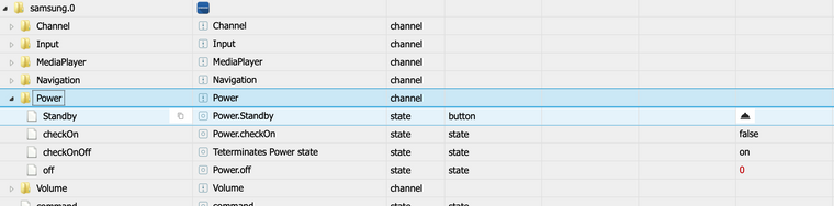

                  jwedenig Most Active last edited by jwedenig
                  Über den IP Befehl des Samsung Adapters, und "ein"mit dem http Befehl, welcher ein IR Signal an mein Mediola Gateway sendet, da man ja leider den Samsung Fernseher nicht anders einschalten kann mangels Netzwerkverfügbarkeit

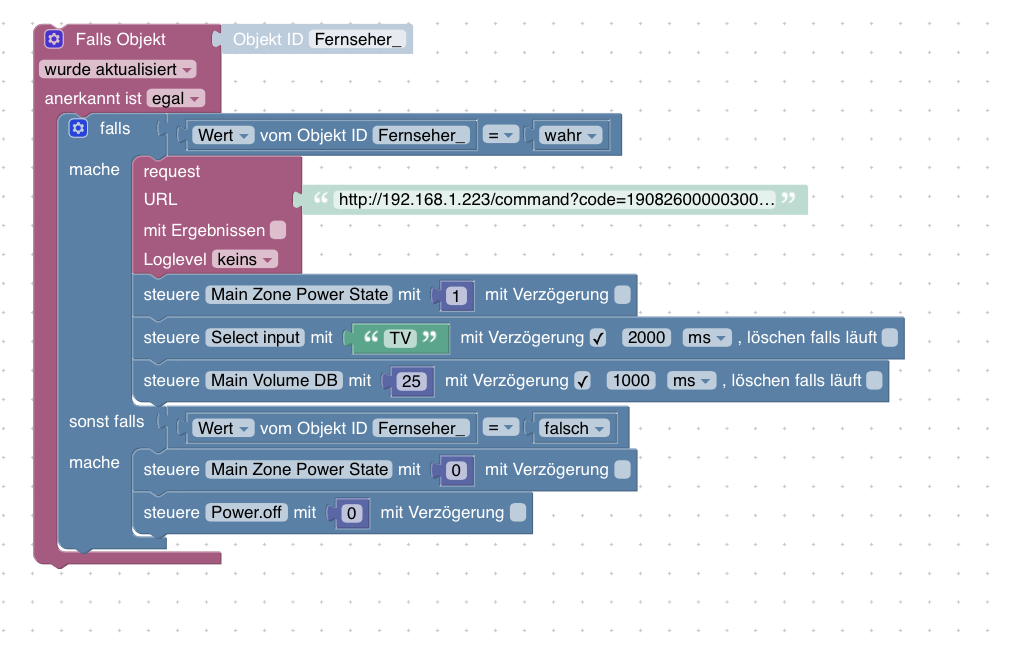

                    letztlich meckert das script nur über den Fehler "TypeError [ERR_UNESCAPED_CHARACTERS]: Request path contains unescaped characters" - d.h., der kann den Netzwerkpfad aufgrund eines Fehlers nicht auflösen bzw. die Aktion auslösen.
                    Hast du auch den aus Blockly herauskopierten Pfad im Browser getestet?
                    Zusätzlich ist der Datenpunkt "MainPowerZone" noch falsch definiert. Er wird mit einer Zahl beschrieben, ist vielleicht aber als Bool o.ä. ausgelegt.
                        ja, stimmt, Power zone wird mit true/false definiert, ist aber scheinbar egal, weil der DENON ja funktioniert
                          habs jetzt geändert:

                            2019-10-15 09:48:47.852 - error: javascript.0 script.js.Weldscripts.Alexa_Fernseher_ein: TypeError [ERR_UNESCAPED_CHARACTERS]: Request path contains unescaped characters
                            2019-10-15 09:49:11.101 - warn: javascript.0 Wrong type of denon.0.zoneMain.powerZone: "string". Please fix, while deprecated and will not work in next versions.
                            2019-10-15 09:49:11.109 - warn: javascript.0 at setState (/opt/iobroker/node_modules/iobroker.javascript/lib/sandbox.js:1258:20)

                            • UweRLP
                              UweRLP last edited by
                              Du benutzt Texte als true/false mußt aber unter Logik den Baustein wahr/unwahr nutzen. Vermutlich ist der Text bei select input "TV" auch nicht richtig, was ist select input für ein Objekt?

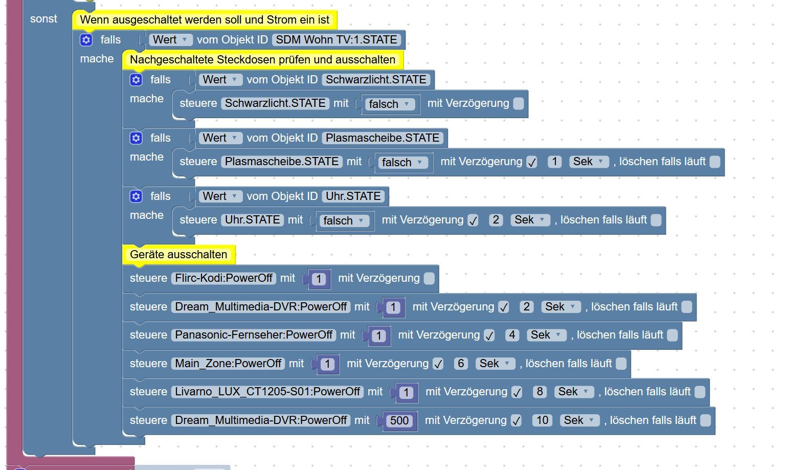

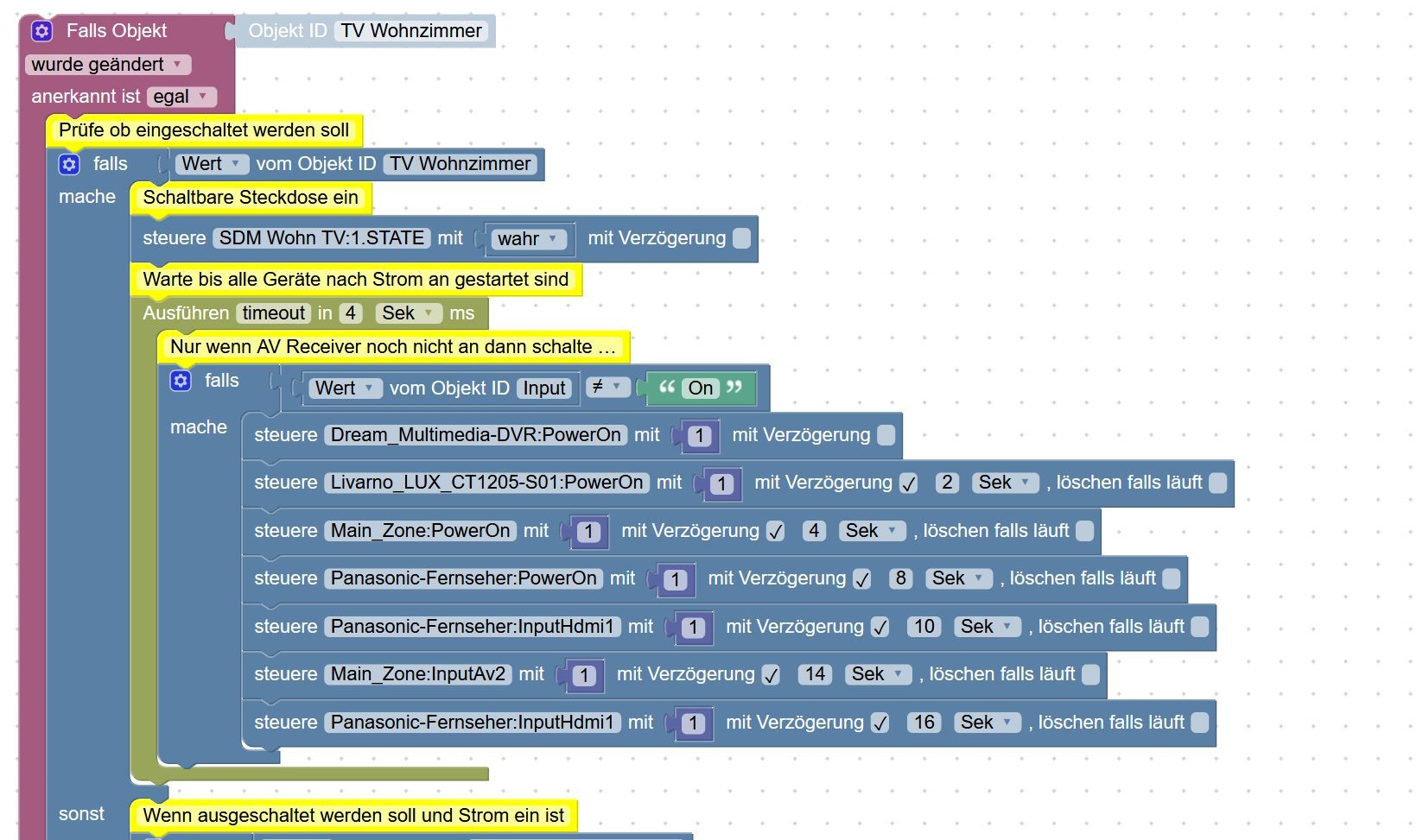

                              • UweRLP
                                Hier mein Blocky zum Ein-/Auschalten meiner Anlage. Ich mußte es leider in zwei Bilder aufteilen...
                                Vielleicht hilft es dir, habe dazu noch ein paar Kommentare eingefügt.
                                  Mein Denon reagiert auf "0"und "1" als auch auf "true" und False"
                                  das Problem ist dass der "request Url" Befehl nicht funktioniert.
                                  Mhhh, Scheibenkleister

                                          Aber es gibt doch einen Samsung Adapter besteht da nicht die Mölglichkeit den TV einzuschalten?
                                          BBTown J 2 Replies Last reply Reply Quote 0
                                            kommen die Datenpunkte nicht genau von diesem Adapter? (samsung.0)
                                            @jwedenig was passiert denn bei "Power.off=1" ?
