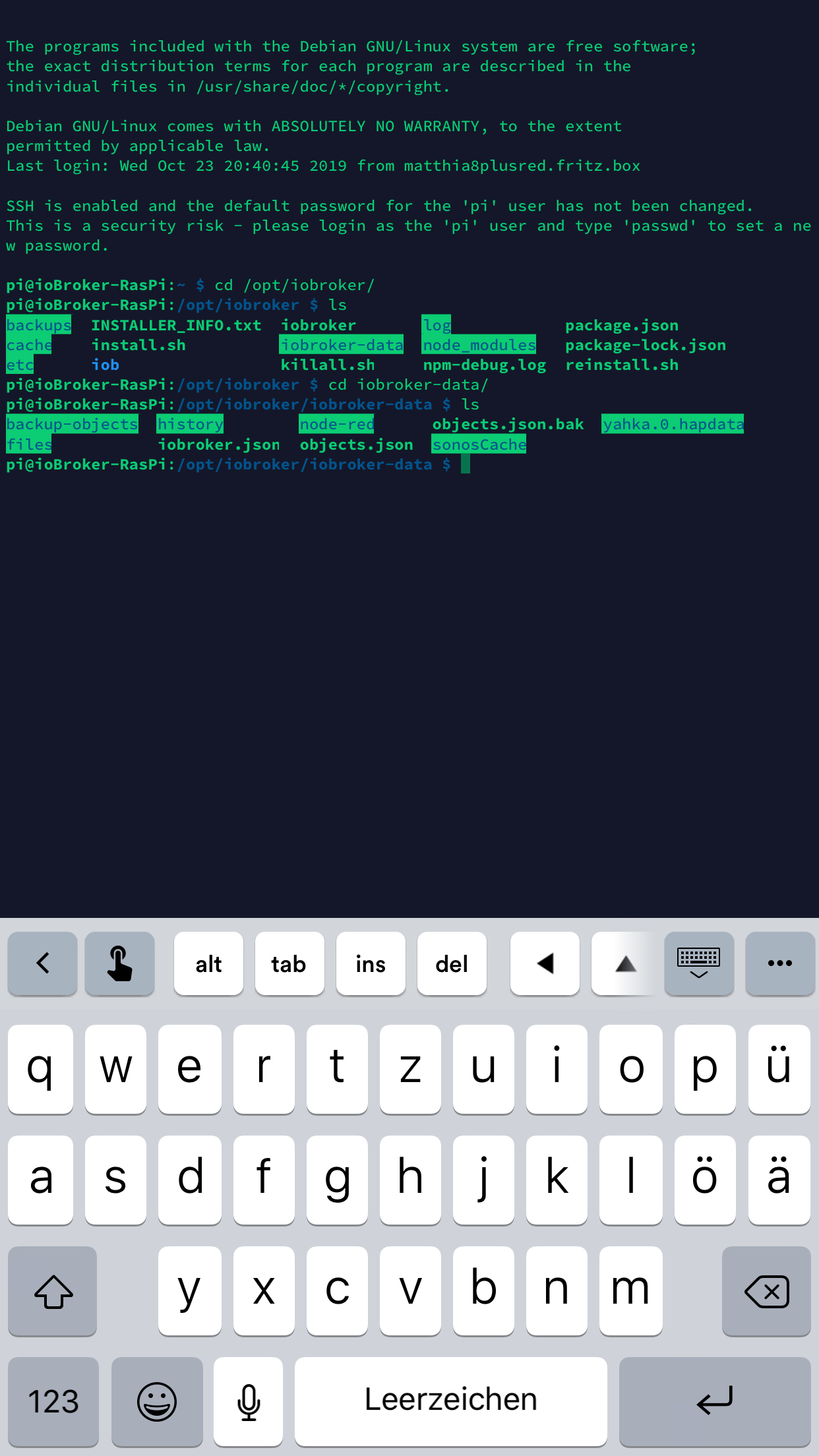

          Matze1708 @Glasfaser last edited by Negalein
          @Glasfaser
          Das hier wäre noch da
          pi@ioBroker-RasPi:~ $ cd /opt/iobroker/
          pi@ioBroker-RasPi:/opt/iobroker $ cd iobroker-data/
          pi@ioBroker-RasPi:/opt/iobroker/iobroker-data $ ls
          backup-objects  history        node-red      objects.json.bak  yahka.0.hapdata
          files           iobroker.json  objects.json  sonosCache
