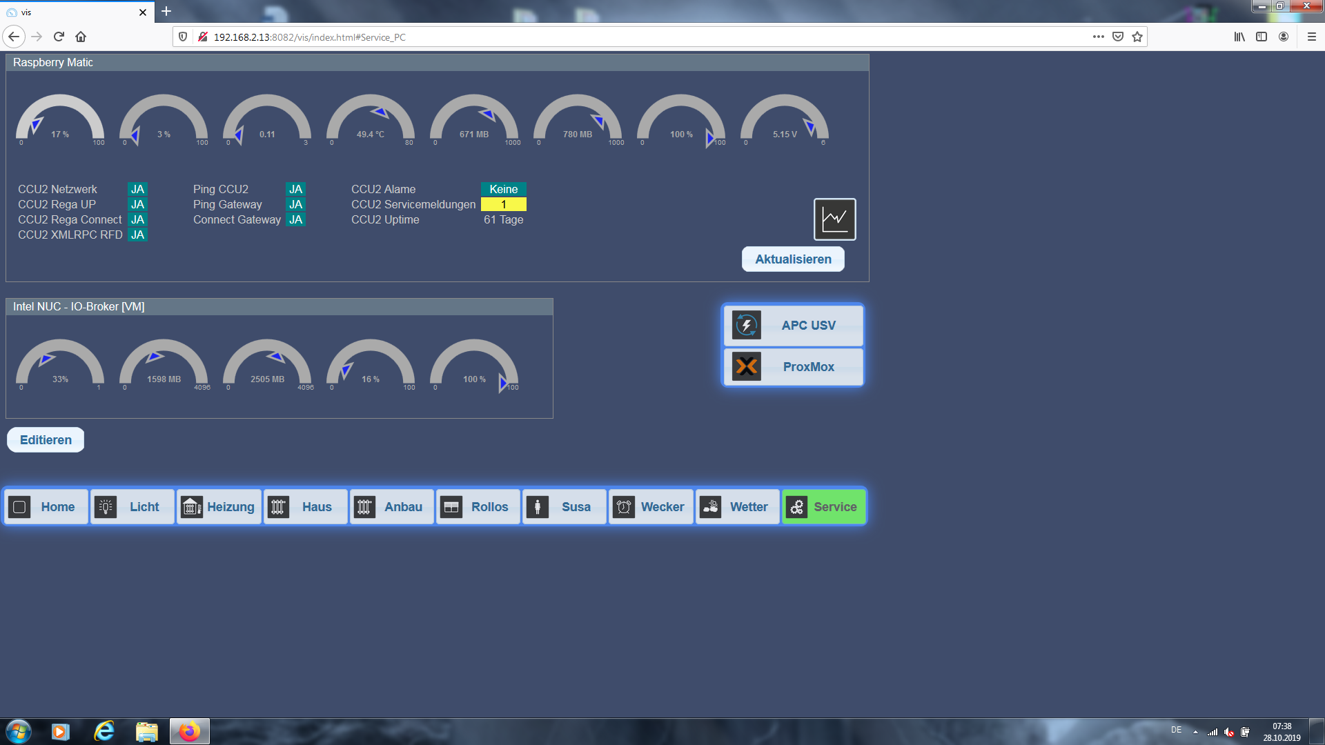

      Aufgrund einer längeren Dienstreise kam ich erst gestern wieder sinnvoll an meine Maschine. 7 Updates standen an
      Snapshot - IOBroker stop, iobroker update und dann manuell die datapter durch via IOBroker upgrade Adaptername
      Nach dem Start funktionierten die jzstgae Widgets nicht mehr. keine Farbe, die beschreibung fehlt
      Das problem ist browserunabhängig (Firefox, chrome) und auch PC Unabhängig (auf 2 rechnern, einmal unter win7 und einmalunter win10)
      so ist die datstellung :
      und dies ist der export eines dieser widgets:
      [{"tpl":"tplJustgageJustGage","data":{"g_fixed":false,"g_visibility":false,"g_css_font_text":false,"g_css_background":false,"g_css_shadow_padding":false,"g_css_border":false,"g_gestures":false,"g_signals":false,"visibility-cond":"==","visibility-val":1,"visibility-groups-action":"hide","is_tdp":false,"factor":"1","balance1":"50","balance2":"50","signals-cond-0":"==","signals-val-0":true,"signals-icon-0":"/vis/signals/lowbattery.png","signals-icon-size-0":0,"signals-blink-0":false,"signals-horz-0":0,"signals-vert-0":0,"signals-hide-edit-0":false,"signals-cond-1":"==","signals-val-1":true,"signals-icon-1":"/vis/signals/lowbattery.png","signals-icon-size-1":0,"signals-blink-1":false,"signals-horz-1":0,"signals-vert-1":0,"signals-hide-edit-1":false,"signals-cond-2":"==","signals-val-2":true,"signals-icon-2":"/vis/signals/lowbattery.png","signals-icon-size-2":0,"signals-blink-2":false,"signals-horz-2":0,"signals-vert-2":0,"signals-hide-edit-2":false,"oid":"javascript.1.WRAPPER.SYSTEM.DUTY_CCU","min_oid":0,"max_oid":"100","unit":" %","title":"Duty Cycle CCU","pointer":true,"pointerColor":"#1d25ed","gaugeWidthScale":"70","hideInnerShadow":true,"shadowSize":"30","label_oid":"","valueFontColor":"#AAAAAA","color1":"#008287","color2":"yellow","color3":"#ed4d61","sector1":"30","sector2":"70","fullBri":false,"gaugeColor":"#cccccc","noGradient":true,"valueFontFamily":"","valueOffsetY":"18","is_comma":false,"digits":"0","titleFontColor":"#cccccc","lc-type":"last-change","lc-is-interval":true,"lc-is-moment":false,"lc-format":"","lc-position-vert":"top","lc-position-horz":"right","lc-offset-vert":0,"lc-offset-horz":0,"lc-font-size":"12px","lc-font-family":"","lc-font-style":"","lc-bkg-color":"","lc-color":"","lc-border-width":"0","lc-border-style":"","lc-border-color":"","lc-border-radius":10,"lc-zindex":0},"style":{"left":"7px","top":"33px","width":"160px","height":"139px"},"widgetSet":"justgage"}]
      Hat diesen Effekt noch jemand oder an welcher Schaube hier könnte ich drehen ?
      gruss,Black

            sehr interessant.... bei mir tuns nun die Farbverlufe wieder nachdem ich deins importiert hatte, aber die Titeldarstellung tuts immer noch nicht .
            der muss sich ja über verschluckt haben beim Update.
