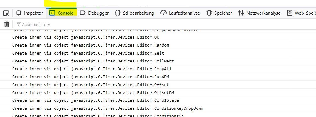

                Lade die VIS Seite im Browser neu und öffne mit F12 die Konsole .
                Schau mal nach ob Error Meldungen oder Warnungen kommen was den Loop vielleicht verursacht .
                bmueller77 1 Reply Last reply Reply Quote 0

                  Hier die Meldungen. Frage: Was hat Vis mit dem Objekte-Tab zu tun?
                  Version vis-canvas-gauges: 0.1.5 index.html:4053:25

                  2019-10-29T22:04:54.228Z Connected => authenticate conn.js:273:25
                  2019-10-29T22:04:54.534Z Authenticated: true conn.js:293:33
                  Request 0 states. vis.js:3284:33
                  Create inner vis object bring.0.0ea4746a-598a-4d8d-920f-96f35028903f.content vis.js:3134:29

                  Create inner vis object javascript.0.MyObjects_Light_Wohnzimmer3 vis.js:3134:29
                  Create inner vis object hue-extended.0.lights.006-schlafzimmer_decke_1.action._commands vis.js:3134:29
                  Create inner vis object hue-extended.0.lights.006-schlafzimmer_decke_1.action.xy vis.js:3134:29
                  Create inner vis object hue-extended.0.lights.006-schlafzimmer_decke_1.action.level vis.js:3134:29
                  Create inner vis object javascript.0.MyObjects_Light_Schlafzimmer1 vis.js:3134:29
                  Create inner vis object hs100.0.192_168_2_81.state vis.js:3134:29
                  Create inner vis object hs100.0.192_168_2_99.state vis.js:3134:29
                  Create inner vis object hs100.0.192_168_2_98.state vis.js:3134:29
                  Create inner vis object hs100.0.192_168_2_84.state vis.js:3134:29
                  Create inner vis object mihome.0.devices.magnet_158d00030ae2cc.state vis.js:3134:29
                  Create inner vis object mihome.0.devices.magnet_158d00030ae312.state vis.js:3134:29
                  Create inner vis object hs100.0.192_168_2_96.state vis.js:3134:29
                  Create inner vis object radar2.0.Wasserkocher vis.js:3134:29
                  Create inner vis object hs100.0.192_168_2_83.state vis.js:3134:29
                  Create inner vis object mihome-vacuum.0.info.connection vis.js:3134:29
                  Create inner vis object ping.0.raspberryvm.192_168_2_10 vis.js:3134:29
                  Create inner vis object ping.0.raspberryvm.192_168_2_11 vis.js:3134:29
                  Create inner vis object ping.0.raspberryvm.192_168_2_13 vis.js:3134:29
                  Create inner vis object ping.0.raspberryvm.192_168_2_12 vis.js:3134:29
                  Create inner vis object cloud.0.info.connection vis.js:3134:29
                  Create inner vis object tr-064.0.states.externalIP vis.js:3134:29
                  Create inner vis object tr-064.0.devices.BMMobile.active vis.js:3134:29
                  Create inner vis object radar2.0.Raumfeld_Bad vis.js:3134:29
                  Create inner vis object radar2.0.BMGHM3 vis.js:3134:29
                  Create inner vis object radar2.0.Raumfeld_Flur vis.js:3134:29
                  Create inner vis object radar2.0.BMGHM1 vis.js:3134:29
                  Create inner vis object radar2.0.Raumfeld_Schlafzimmer vis.js:3134:29
                  Create inner vis object radar2.0.Schlafzimmer_Hub vis.js:3134:29
                  Create inner vis object tr-064.0.devices.Raumfeld-Connector.active vis.js:3134:29
                  Create inner vis object radar2.0.BMGHM2 vis.js:3134:29
                  Create inner vis object ping.0.raspberryvm.192_168_2_201 vis.js:3134:29
                  Create inner vis object radar2.0.Raumfeld_Expand vis.js:3134:29
                  Create inner vis object radar2.0.BMPRINTER vis.js:3134:29
                  Create inner vis object scene.Door_locked vis.js:3134:29
                  Create inner vis object nuki2.0.door__wohnungstür_björn.status.closed vis.js:3134:29
                  Create inner vis object nuki2.0.door__wohnungstür_björn.status.batteryCritical vis.js:3134:29
                  Create inner vis object hs100.0.192_168_2_84.power vis.js:3134:29
                  Create inner vis object mihome-vacuum.0.RoboRockStatus vis.js:3134:29
                  Create inner vis object hue.0.MyBridge.Flur.on vis.js:3134:29
                  Create inner vis object mihome.0.devices.weather_v1_158d00036b9154.temperature vis.js:3134:29
                  Create inner vis object mihome.0.devices.weather_v1_158d000346b9cb.temperature vis.js:3134:29
                  Create inner vis object javascript.0.MyObjects_TargetTemperature_SleepingRoom vis.js:3134:29
                  Create inner vis object javascript.0.MyObjects_TargetTemperature_Bathroom vis.js:3134:29
                  Create inner vis object hue-extended.0.lights.022-hue_play_mitte.action._commands vis.js:3134:29
                  Create inner vis object hue-extended.0.lights.022-hue_play_mitte.action.xy vis.js:3134:29
                  Create inner vis object hue-extended.0.lights.022-hue_play_mitte.action.level vis.js:3134:29
                  Create inner vis object javascript.0.MyObjects_Light_Play2 vis.js:3134:29
                  Create inner vis object hue-extended.0.lights.021-hue_play_links.action._commands vis.js:3134:29
                  Create inner vis object hue-extended.0.lights.021-hue_play_links.action.xy vis.js:3134:29
                  Create inner vis object hue-extended.0.lights.021-hue_play_links.action.level vis.js:3134:29
                  Create inner vis object javascript.0.MyObjects_Light_Play1 vis.js:3134:29
                  Create inner vis object hue-extended.0.lights.023-hue_play_rechts.action._commands vis.js:3134:29
                  Create inner vis object hue-extended.0.lights.023-hue_play_rechts.action.xy vis.js:3134:29
                  Create inner vis object hue-extended.0.lights.023-hue_play_rechts.action.level vis.js:3134:29
                  Create inner vis object javascript.0.MyObjects_Light_Play3 vis.js:3134:29
                  Create inner vis object javascript.0.MyObjects_SleepingRoom_Cumulated_Temperature vis.js:3134:29
                  Create inner vis object javascript.0.MyObjects_SleepingRoom_TempChange vis.js:3134:29
                  Create inner vis object mihome.0.devices.weather_v1_158d000346c1cf.temperature vis.js:3134:29
                  Create inner vis object javascript.0.MyObjects_BathRoom_TempChange vis.js:3134:29
                  Create inner vis object hue-extended.0.lights.020-deckenlampe_im_flur.action._commands vis.js:3134:29
                  Create inner vis object hue-extended.0.lights.020-deckenlampe_im_flur.action.xy vis.js:3134:29
                  Create inner vis object hs100.0.192_168_2_87.state vis.js:3134:29
                  Create inner vis object hs100.0.192_168_2_87.power vis.js:3134:29
                  Create inner vis object hs100.0.192_168_2_87.totalMonthNow vis.js:3134:29
                  Create inner vis object hs100.0.192_168_2_83.power vis.js:3134:29
                  Create inner vis object hs100.0.192_168_2_83.totalMonthNow vis.js:3134:29
                  Create inner vis object hs100.0.192_168_2_88.state vis.js:3134:29
                  Create inner vis object hs100.0.192_168_2_88.power vis.js:3134:29
                  Create inner vis object hs100.0.192_168_2_88.totalMonthNow vis.js:3134:29
                  Create inner vis object hs100.0.192_168_2_85.state vis.js:3134:29
                  Create inner vis object hs100.0.192_168_2_85.power vis.js:3134:29
                  Create inner vis object hs100.0.192_168_2_85.totalMonthNow vis.js:3134:29
                  Create inner vis object hs100.0.192_168_2_89.state vis.js:3134:29
                  Create inner vis object hs100.0.192_168_2_89.power vis.js:3134:29
                  Create inner vis object hs100.0.192_168_2_89.totalMonthNow vis.js:3134:29
                  Create inner vis object hs100.0.192_168_2_91.state vis.js:3134:29
                  Create inner vis object hs100.0.192_168_2_91.power vis.js:3134:29
                  Create inner vis object hs100.0.192_168_2_91.totalMonthNow vis.js:3134:29
                  Create inner vis object hs100.0.192_168_2_90.state vis.js:3134:29
                  Create inner vis object hs100.0.192_168_2_90.power vis.js:3134:29
                  Create inner vis object hs100.0.192_168_2_90.totalMonthNow vis.js:3134:29
                  Create inner vis object hs100.0.192_168_2_81.power vis.js:3134:29
                  Create inner vis object hs100.0.192_168_2_81.totalMonthNow vis.js:3134:29
                  Create inner vis object hs100.0.192_168_2_82.state vis.js:3134:29
                  Create inner vis object hs100.0.192_168_2_82.power vis.js:3134:29
                  Create inner vis object hs100.0.192_168_2_82.totalMonthNow vis.js:3134:29
                  Create inner vis object hs100.0.192_168_2_97.state vis.js:3134:29
                  Create inner vis object hs100.0.192_168_2_94.state vis.js:3134:29
                  Create inner vis object hs100.0.192_168_2_95.state vis.js:3134:29
                  Create inner vis object javascript.0.MyObjects_TotalPowerConsumption vis.js:3134:29
                  Create inner vis object javascript.0.MyObjects_MonthlyPowerConsumption vis.js:3134:29
                  Create inner vis object javascript.0.MyObjects_ActualPowerConsumption vis.js:3134:29
                  Create inner vis object hs100.0.192_168_2_84.totalMonthNow vis.js:3134:29
                  Create inner vis object hs100.0.192_168_2_80.power vis.js:3134:29
                  Create inner vis object hs100.0.192_168_2_80.totalMonthNow vis.js:3134:29
                  Create inner vis object daswetter.0.NextHours.Location_1.Day_1.current.windchill_value vis.js:3134:29
                  Create inner vis object daswetter.0.NextHours.Location_1.Day_1.current.WindSpeed vis.js:3134:29
                  Create inner vis object daswetter.0.NextHours.Location_1.Day_1.current.pressure_value vis.js:3134:29
                  Create inner vis object daswetter.0.NextHours.Location_1.Day_1.current.humidity_value vis.js:3134:29
                  Create inner vis object daswetter.0.NextHours.Location_1.Day_1.current.rain_value vis.js:3134:29
                  Create inner vis object daswetter.0.NextHours.Location_1.Day_1.current.WindDir vis.js:3134:29
                  Create inner vis object daswetter.0.NextHours.Location_1.Day_1.sun_in vis.js:3134:29
                  Create inner vis object daswetter.0.NextHours.Location_1.Day_1.sun_out vis.js:3134:29
                  Create inner vis object daswetter.0.NextHours.Location_1.Day_1.current.clouds_value vis.js:3134:29
                  Create inner vis object daswetter.0.NextHours.Location_1.Day_1.moon_in vis.js:3134:29
                  Create inner vis object daswetter.0.NextHours.Location_1.Day_1.moon_out vis.js:3134:29
                  Create inner vis object daswetter.0.NextHours.Location_1.Day_1.sunshineDuration vis.js:3134:29
                  Create inner vis object parser.0.MoonDirection vis.js:3134:29
                  Create inner vis object daswetter.0.NextHours.Location_1.Day_1.sun_mid vis.js:3134:29
                  Create inner vis object weatherunderground.0.forecastHourly.0h.uv vis.js:3134:29
                  Create inner vis object mihome.0.devices.weather_v1_158d000346b9bd.temperature vis.js:3134:29
                  Create inner vis object javascript.0.MyObjects_Moonphase vis.js:3134:29
                  Create inner vis object javascript.0.MyObjects_Moonphase_Direction vis.js:3134:29
                  Create inner vis object mihome.0.devices.weather_v1_158d000346b9bd.humidity vis.js:3134:29
                  Create inner vis object mihome.0.devices.weather_v1_158d000322a232.temperature vis.js:3134:29
                  Create inner vis object mihome.0.devices.weather_v1_158d000322a232.humidity vis.js:3134:29
                  Create inner vis object mihome.0.devices.weather_v1_158d000346c1cf.humidity vis.js:3134:29
                  Create inner vis object mihome.0.devices.weather_v1_158d000346c39f.temperature vis.js:3134:29
                  Create inner vis object mihome.0.devices.weather_v1_158d000346c39f.humidity vis.js:3134:29
                  Create inner vis object mihome.0.devices.weather_v1_158d00036cb1b9.temperature vis.js:3134:29
                  Create inner vis object mihome.0.devices.weather_v1_158d00036cb1b9.humidity vis.js:3134:29
                  Create inner vis object javascript.0.MyObjects_SleepingRoom_Cumulated_Humidity vis.js:3134:29
                  Create inner vis object javascript.0.MyObjects_Outside_Cumulated_Temperature vis.js:3134:29
                  Create inner vis object javascript.0.MyObjects_Outside_Cumulated_Humidity vis.js:3134:29
                  Create inner vis object weatherunderground.0.forecast.0d.precipitationChance vis.js:3134:29
                  Create inner vis object parser.0.MoonDistance vis.js:3134:29
                  Create inner vis object javascript.0.MyObjects_MoonDistanceDirection vis.js:3134:29
                  Create inner vis object parser.0.MoonPhase vis.js:3134:29
                  [1572386695575] Request 41 states. vis.js:2713:21
                  [1572386696044] Request 102 states. vis.js:2713:21
                  Version vis-hqwidgets: 1.1.2 hqwidgets.js:899:21
                  XML-Verarbeitungsfehler: nicht wohlgeformt
                  Adresse: http://192.168.2.60:8082/vis/index.html#Home
                  Zeile Nr. 1, Spalte 1: 2 index.html:1:1
                  Video gallery initializing videoloader.js:13:9
                  TypeError: _0x149c96.body is null
                  videoloader.js:433:41
                  Das Skript von "https://ads.ayads.co/ajs.php?zid=20225" wurde geladen, obwohl sein MIME-Typ ("text/html") kein für JavaScript gültiger MIME-Typ ist.
                  1212181257-Frankfurt-am-Main
                  Laden fehlgeschlagen für das <script> mit der Quelle "https://pagead2.googlesyndication.com/pagead/js/adsbygoogle.js". 1212181257-Frankfurt-am-Main:97:1
                  Anfrage für Zugriff auf Cookies oder Speicher für "https://ads.ayads.co/ajs.php?zid=20225" wurde blockiert, weil sie von einem Element zur Aktivitätenverfolgung (Tracker) stammt und das Blockieren von Seitenelementen aktiviert ist.
                  index.html

                      • Glasfaser
                        Glasfaser @bmueller77 last edited by Glasfaser
                        @bmueller77 sagte in Loop beim Laden von Objekten im Admin-UI:
                        seit ca. 2 Wochen lädt mein "Objekte"-Tab quasi ewig, wenn ich ihn aufrufen möchte. Noch bevor die Daten angezeigt werden, macht die Seite einen Refresh.
                        Sieht erstmal gut aus …..
                        Kannst du den Fehler ein wenig genauer noch beschreiben oder mit Screenshot beschreiben wie es auftritt .
                        Anderen Browser mal getestet .
                        Hast du mal zum testen einige Adapter ausgeschaltet (… z.b History ) und dann mal überprüft ob es weiter vorkommt .
                        Starte mal den Raspberry neu und schau im ioBroker Log , ob Error oder Warmeldungen vorkommen !?
                        • bmueller77
                          bmueller77 @Glasfaser last edited by
                          @Glasfaser
                          Hab's hinbekommen. Problem war der ble-Adapter. Der hat bei mir knapp 27.000 devices und channels, fast 60.000 states und mehr als 118.000 Objekte angelegt. Woher er die Anzahl hatte, ist mir schleierhaft. Hab zwar viele Geräte, aber so viele dann auch nicht. Die Deinstallation ist zwar mehrfach abgebrochen und sauber bzw. vollständig habe ich nicht deinstallieren können, aber die Objekte sind weg und damit funktioniert auch der Objekte-Tab wieder.
