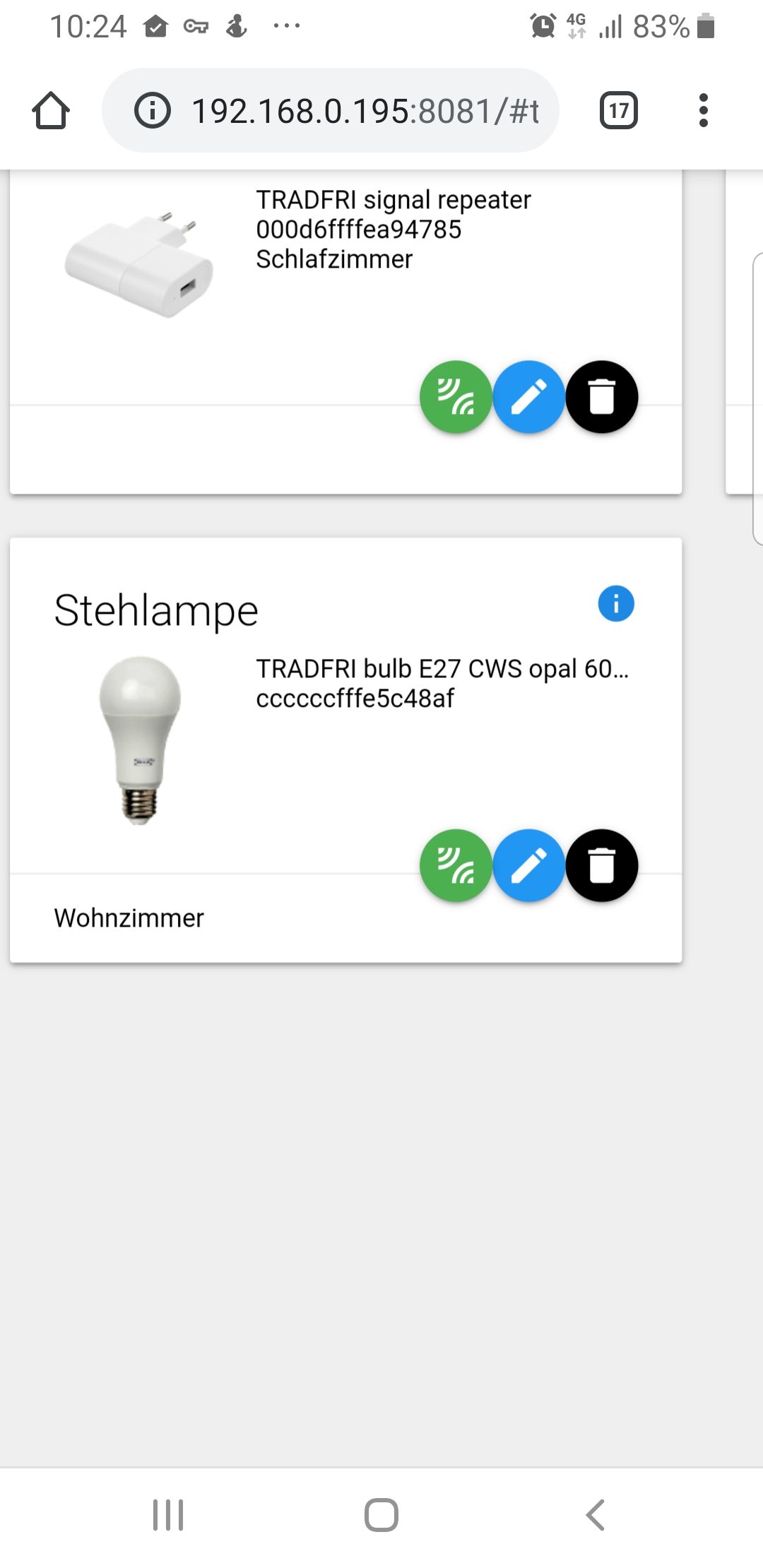

          arteck Developer Most Active @marcuskl last edited by
          @marcuskl zegmal die Kachel vom adapter der Lampe..
          marcuskl 1 Reply Last reply Reply Quote 0
          • marcuskl
            marcuskl @arteck last edited by
