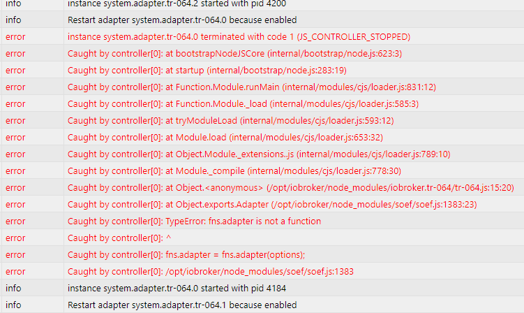

              tobin1997 last edited by
              @sigi234 Danke für die schnelle Hilfe.
              Ich habe den Adapter gestoppt, und den community Adapter installiert, bekomme immer noch folgendes im Log:
              host.raspberrypi	2019-12-09 21:12:23.044	error	Caught by controller[0]: at process._tickCallback (internal/process/next_tick.js:68:7)
              host.raspberrypi	2019-12-09 21:12:23.043	error	Caught by controller[0]: at promise.then (/opt/iobroker/node_modules/standard-as-callback/built/index.js:19:49)
              host.raspberrypi	2019-12-09 21:12:23.043	error	Caught by controller[0]: at tryCatcher (/opt/iobroker/node_modules/standard-as-callback/built/utils.js:11:23)
              host.raspberrypi	2019-12-09 21:12:23.042	error	Caught by controller[0]: at client.(anonymous function)._0xdf4d8 (/opt/iobroker/node_modules/iobroker.objects-redis/index.js:17:76303)
              host.raspberrypi	2019-12-09 21:12:23.041	error	Caught by controller[0]: at /opt/iobroker/node_modules/iobroker.tr-064/node_modules/soef/soef.js:609:26
              host.raspberrypi	2019-12-09 21:12:23.040	error	Caught by controller[0]: at Devices.setState (/opt/iobroker/node_modules/iobroker.tr-064/node_modules/soef/soef.js:642:36)
              host.raspberrypi	2019-12-09 21:12:23.038	error	Caught by controller[0]: TypeError: Cannot read property 'val' of undefined

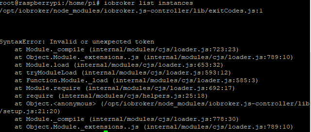

                          tobin1997 @Glasfaser last edited by
                          • Glasfaser
                            Glasfaser @tobin1997 last edited by
                            @tobin1997
                            gehe mal in das richtige Verzeichniss :
                            cd /opt/iobroker
                            iobroker list instances
                              @Glasfaser
                              root@raspberrypi:/# cd /opt/iobroker/
                              root@raspberrypi:/opt/iobroker# iobroker list instances
                              /opt/iobroker/node_modules/iobroker.js-controller/lib/exitCodes.js:1
                              SyntaxError: Invalid or unexpected token
                                 at Module._compile (internal/modules/cjs/loader.js:723:23)
                                 at Object.Module._extensions..js (internal/modules/cjs/loader.js:789:10)
                                 at Module.load (internal/modules/cjs/loader.js:653:32)
                                 at tryModuleLoad (internal/modules/cjs/loader.js:593:12)
                                 at Function.Module._load (internal/modules/cjs/loader.js:585:3)
                                 at Module.require (internal/modules/cjs/loader.js:692:17)
                                 at require (internal/modules/cjs/helpers.js:25:18)
                                 at Object.<anonymous> (/opt/iobroker/node_modules/iobroker.js-controller/lib/setup.js:21:20)
                                 at Module._compile (internal/modules/cjs/loader.js:778:30)
